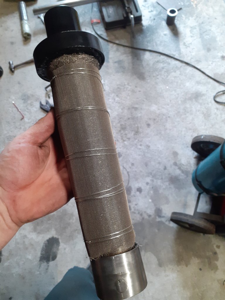

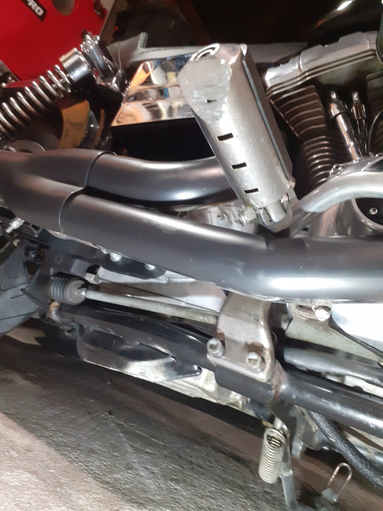

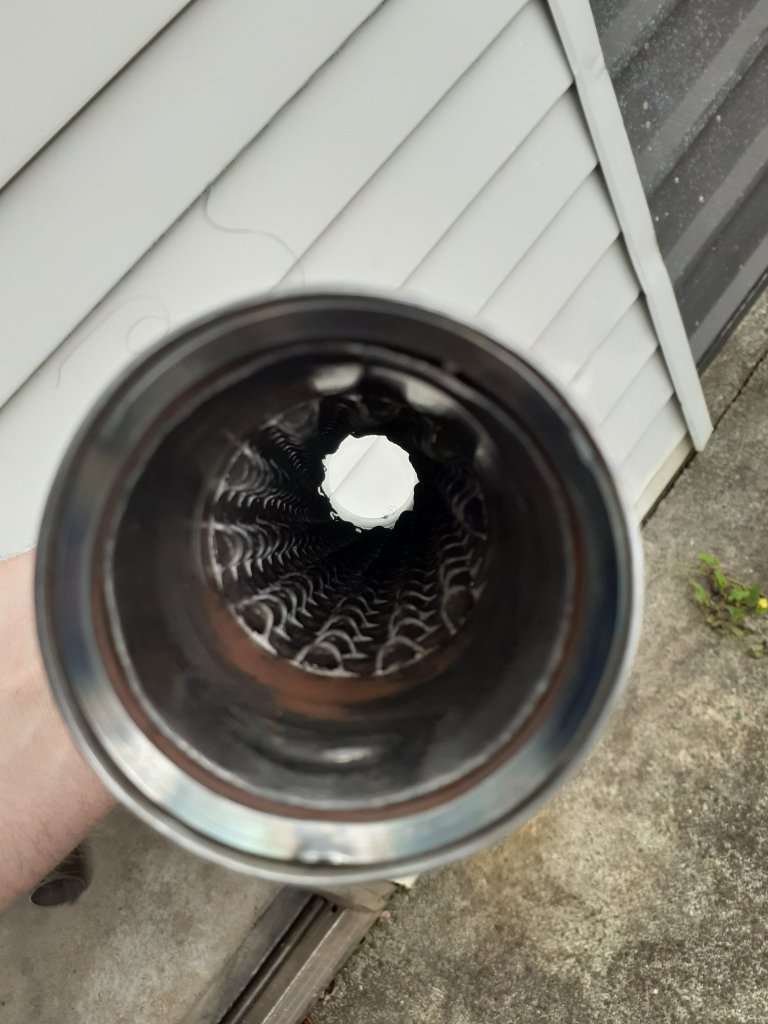

Popular Post cletus Posted April 21, 2025 Author Popular Post Posted April 21, 2025 V3 of exhaust baffles The one that came in it was 2-1/4" louvered, but the louvers faced the wrong way for noise reduction Made previously mentioned 2" one with holes, steel wool that blew out then wrapped in fiberglass header wrap, this survived well but was still a bit rowdy This one is 2" louvered , with them faced for noise reduction, wrapped in stainless muffler packing wool, with a stainless mesh over the top of that 12 Quote

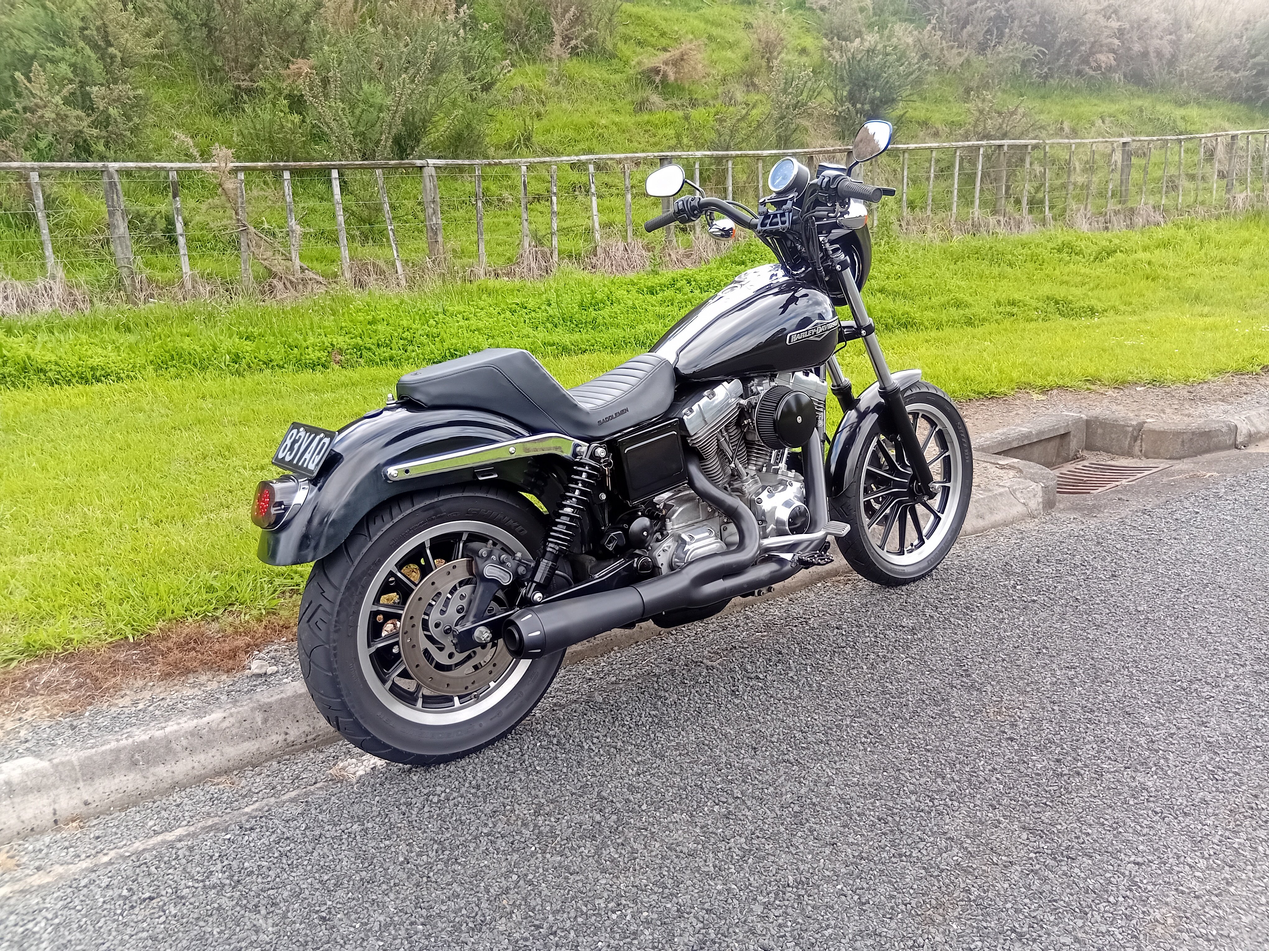

Popular Post cletus Posted April 25, 2025 Author Popular Post Posted April 25, 2025 Had this for sale on trademe for ages with surprisingly little interest, I rode it to work a few times and decided it's too good to sell cheap just for the sake of getting rid of it So it gets to stay 8 6 1 Quote

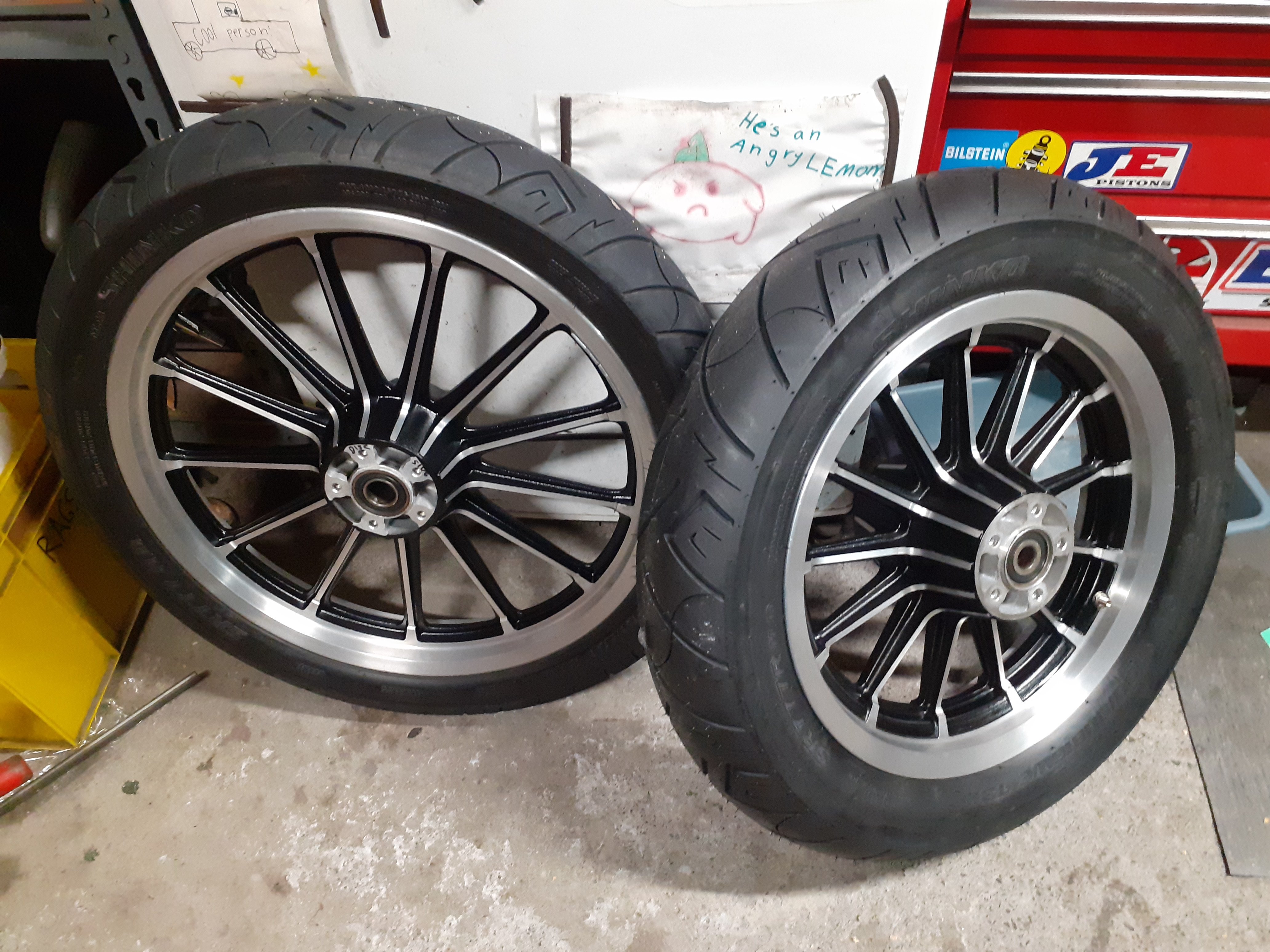

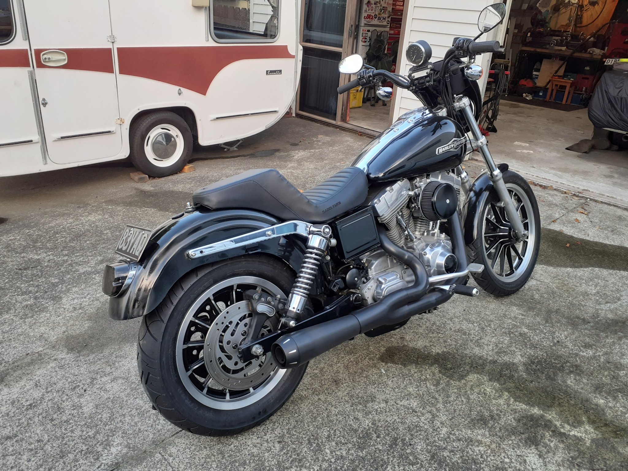

Popular Post cletus Posted May 28, 2025 Author Popular Post Posted May 28, 2025 New tyre fitted While it's off, may as well tidy some stuff up Mucked around for ages deciding what to do with the wheel colour/finish as it needs to tie in with whatever colour I end up painting the bike Anyway decided on this, the FXDX which is the sportier version of this bike had this wheel finish, black spokes with a machined face which I replicated with satin black and scotchbrite pads. The rear one I brush painted it to avoid paint on the faces but got it on there anyway, so the front one I sprayed with a gun and scraped /wiped with thinners the paint off the faces This took forever Front disc is on minimum thickness, one other mod I'd like to do is twin discs on the front so will worry about that later 10 Quote

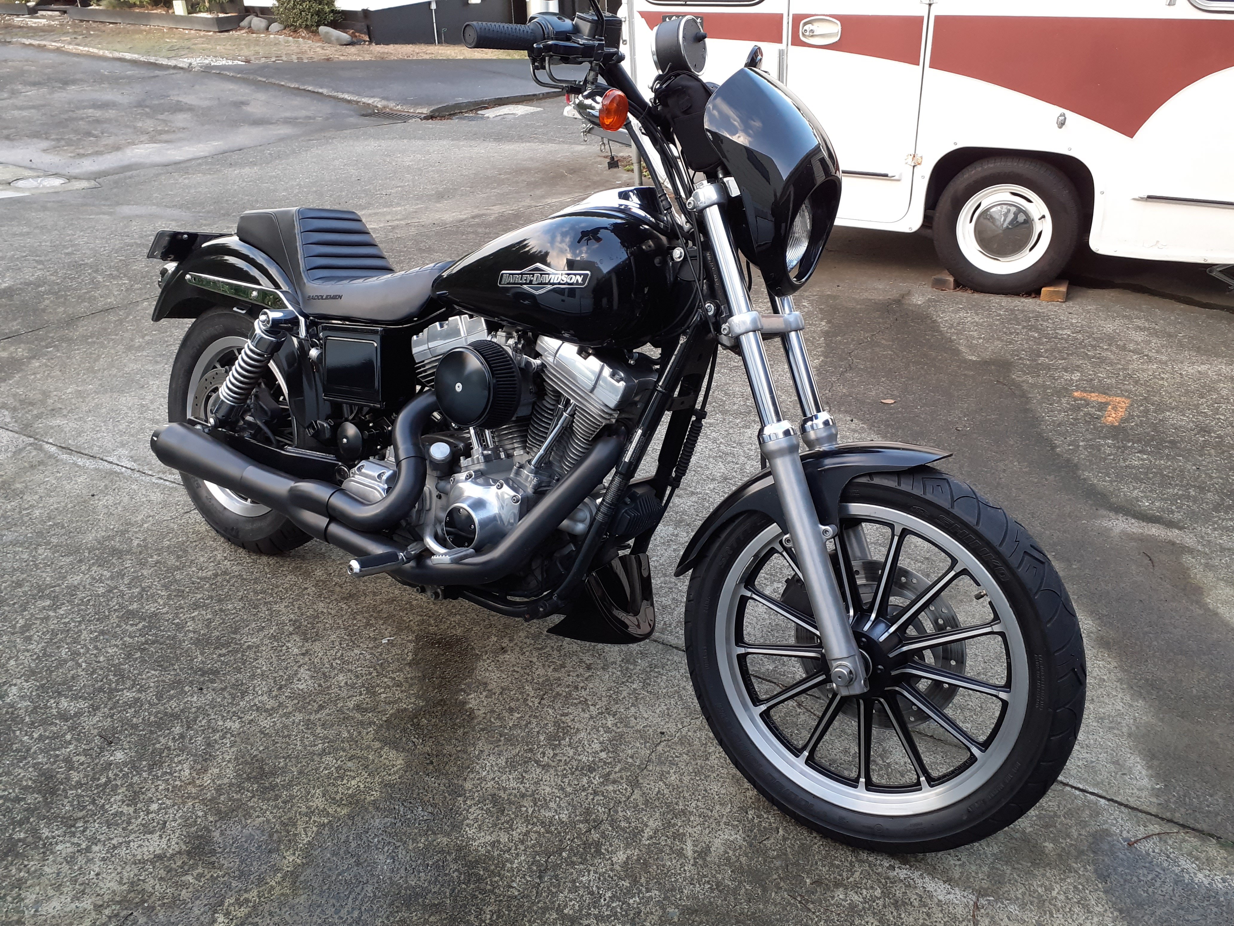

Popular Post cletus Posted May 31, 2025 Author Popular Post Posted May 31, 2025 Wheels done, chin spoiler, black battery cover, painted the starter cover, fitted a direct solenoid button thing on the starter to stop the annoying "sounds like the battery is flat" noise when it's cold, new front pads 14 Quote

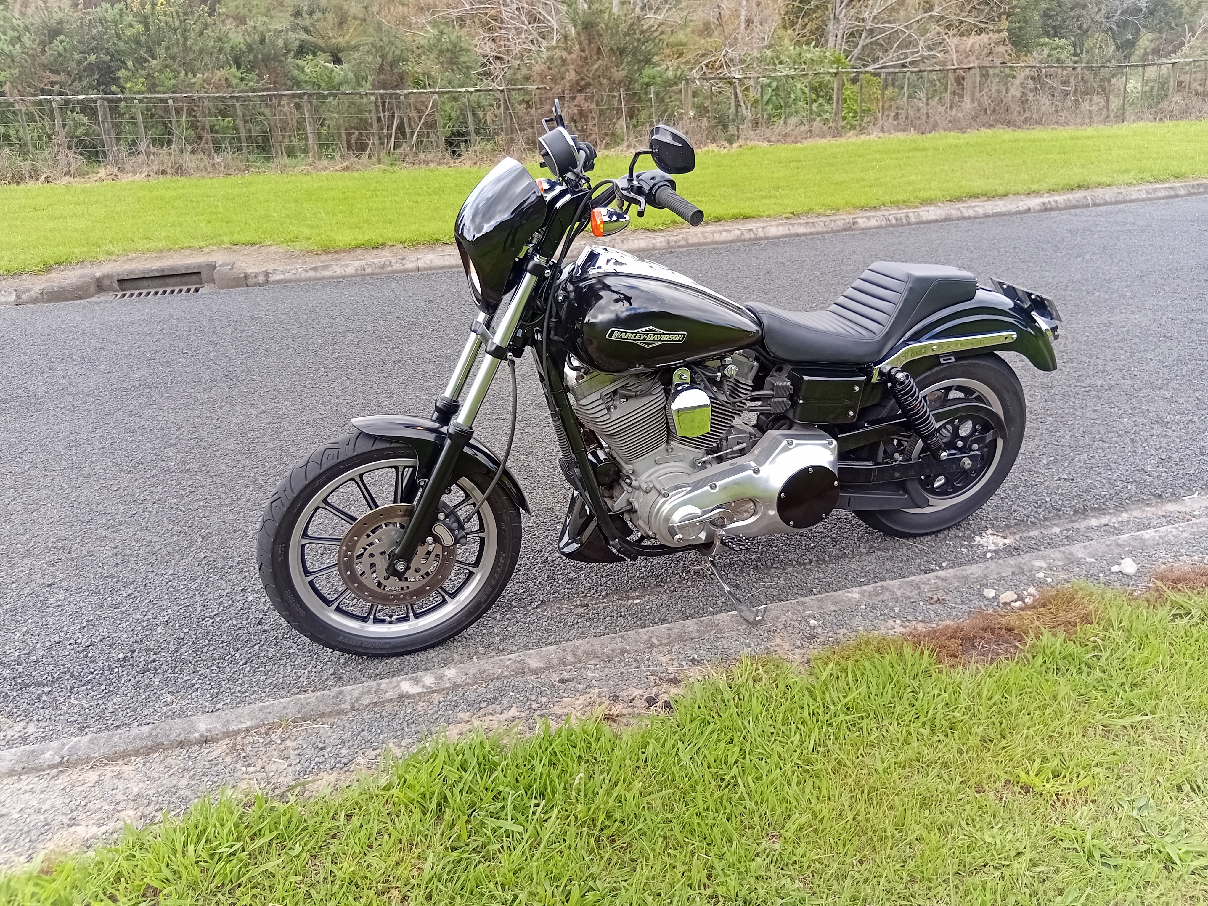

Popular Post cletus Posted October 4, 2025 Author Popular Post Posted October 4, 2025 Honda =wof again no issues Chev = wof again no issues Falcon= had a tidy up and a bit of rust fixed,paint touched up, a diff bush = wof again HD= got some upgraded suspension and fork seals etc, head bearings goosed so front end rebuild time ,then wof Currently having a conundrum on finish, I had to get a new lower tree because the steering stop was broken it polished up OK but I think I'll blast and paint the fork legs and trees black Or get vapor blasted Or polish all of it I think I'll paint I black as I have no imagination and painting things black is my go to . And I don't like polishing things Also when I removed the fork springs someone had used a couple of 3/4 sockets to preload the springs ,lol 7 6 Quote

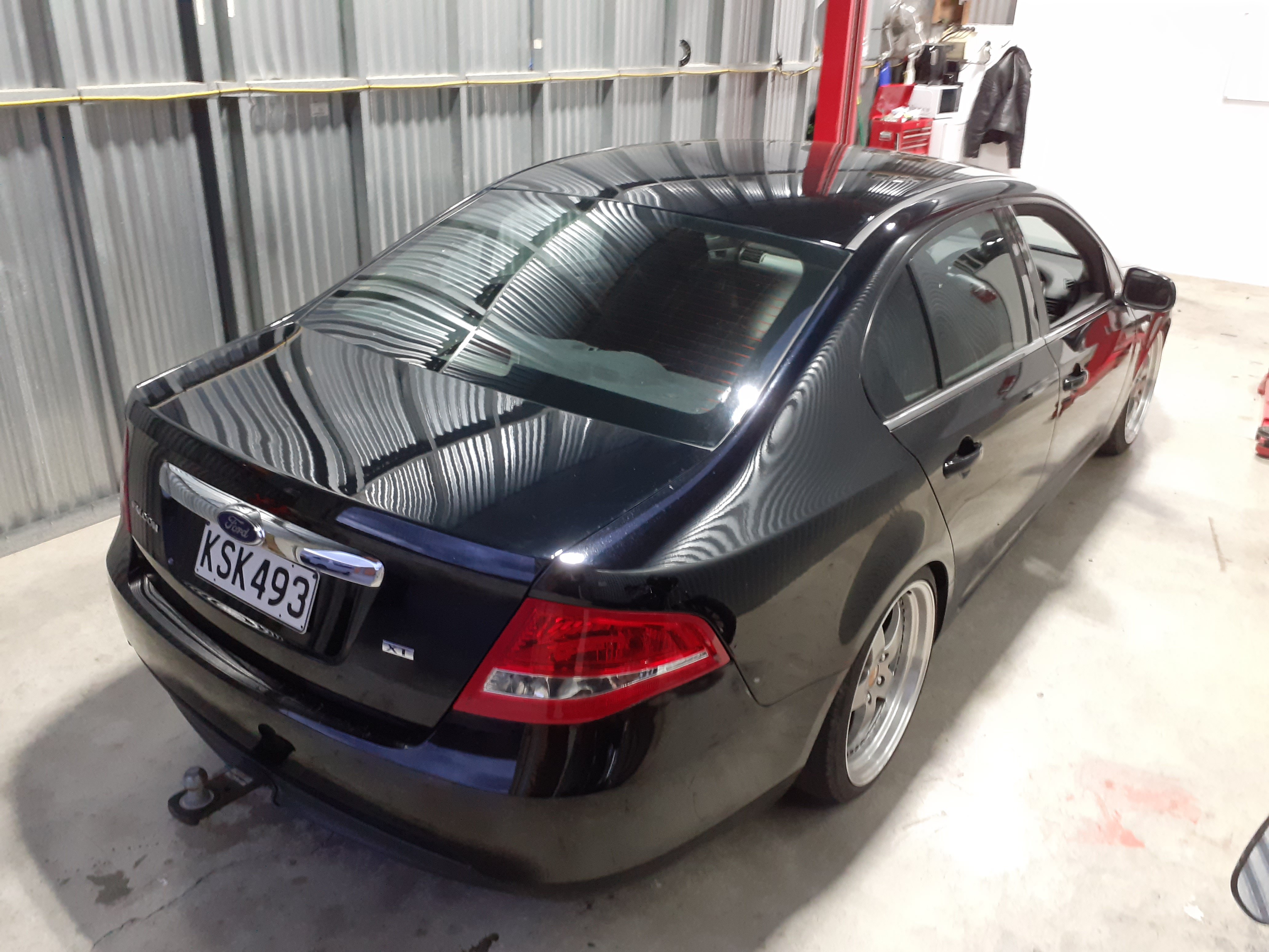

Popular Post cletus Posted October 4, 2025 Author Popular Post Posted October 4, 2025 It had a trans rebuild a few months ago and now a bit getting the paint sorted, the clear coat was failing Boss asked if I wanted a newer car but I couldn't think of anything I'd want to replace it with so, fix it it is It is comfortable and I like it, so seemed dumb to get rid of it 15 Quote
JustHarry Posted October 5, 2025 Posted October 5, 2025 16 hours ago, cletus said: It had a trans rebuild a few months ago and now a bit getting the paint sorted, the clear coat was failing Boss asked if I wanted a newer car but I couldn't think of anything I'd want to replace it with so, fix it it is It is comfortable and I like it, so seemed dumb to get rid of it Are fg falcons knows for having trans problems? Quote
cletus Posted October 5, 2025 Author Posted October 5, 2025 Not as far as I know, it's done 220k so it was probably just a bit worn out. It's a ZF 6 speed so I think they are a common rwd box of the era It still drove OK, it started to go into limp mode a few times , turning it off and on again would fix it but it got to the point of every time I got on the motorway it would do it 2 2 Quote
cletus Posted October 11, 2025 Author Posted October 11, 2025 Today was meant to be reassembly day but I woke up late and mucked around, had to go get some fork oil and a socket for the top nut , then decided to go for a ride on the way back so didn't get started till 5pm, got the head bearings and trees back on, went to reassemble the forks , thought I'd better check the fork tubes, one is bent. Not the leaking one either Oh well, I'd kind of thought about doing taller forks , so now there's a new pair of 50mm longer tubes on their way 6 Quote

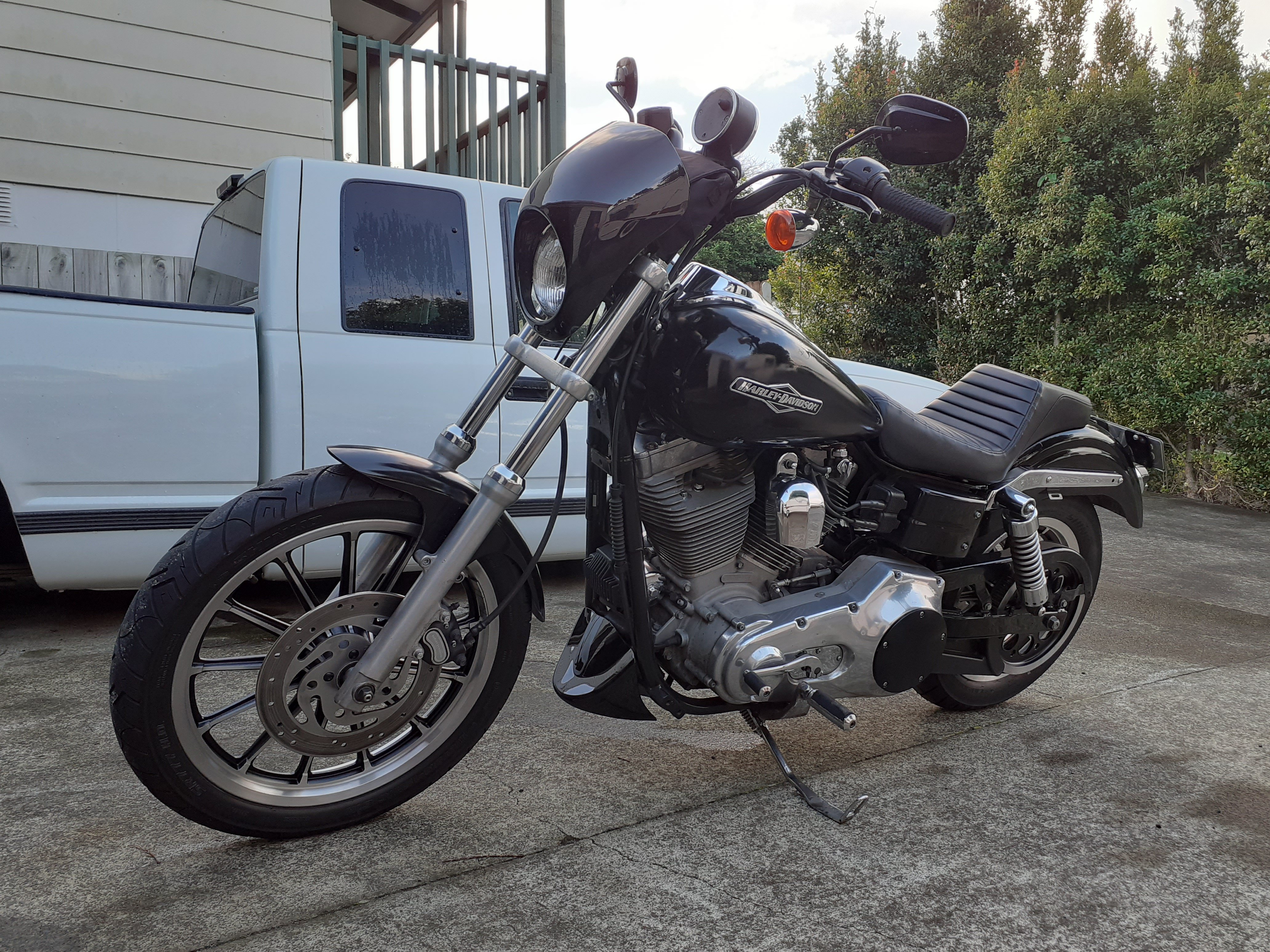

Popular Post cletus Posted October 25, 2025 Author Popular Post Posted October 25, 2025 Parts turned up so the front is all crispy fresh again New head bearings,lower tree, legs etc blasted and painted, 50mm longer forks, new bushes and seals,heavy duty progressive springs and 20w oil. Rear end got some new drag specialties adjustable shocks so it's a bit taller all round. Rides much nicer, the front might be a little bit stiff, I'll see how it goes but putting lighter oil in can fix that It's got a lot more ground clearance so the lean angle has improved noticeably 12 Quote
cletus Posted October 27, 2025 Author Posted October 27, 2025 20w oil was a bit much, too harsh over smaller bumps Put 10w in and it's better Wof booked tomorrow, technically needs a cert for adj suspension so stock ones back on for now , I might do a brake upgrade later so will get cert once it's finished /probably never 2 1 Quote
