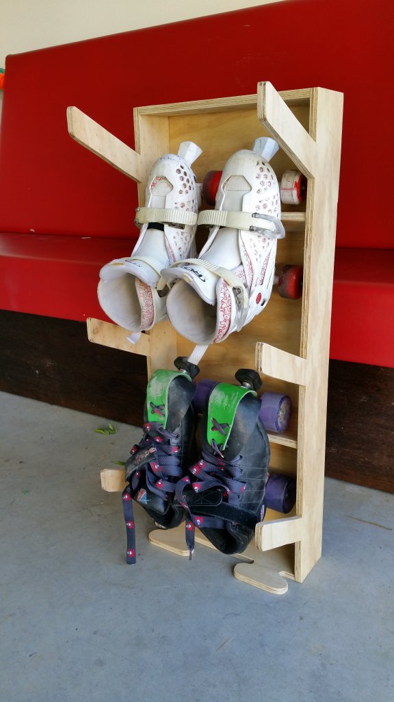

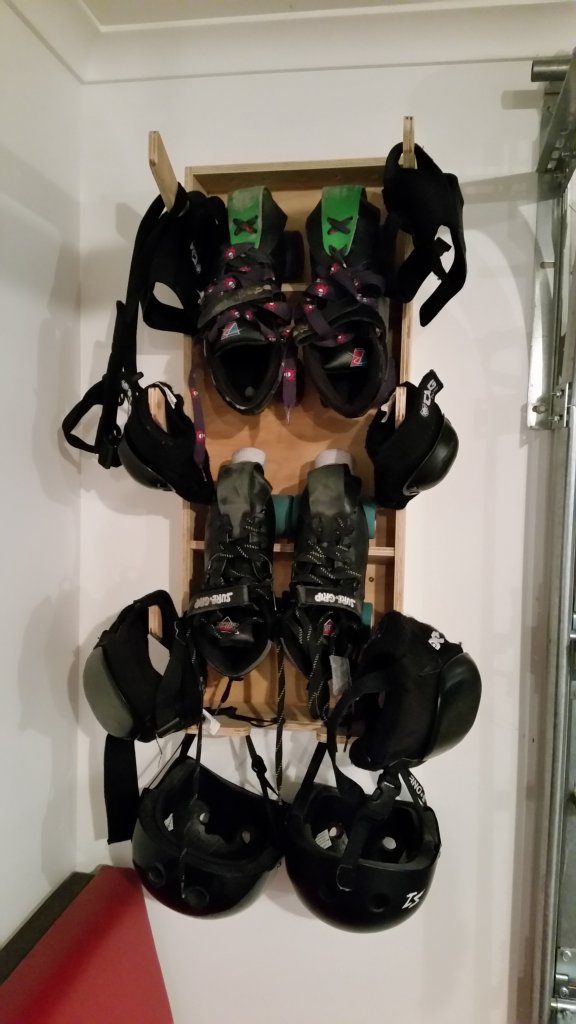

Popular Post Kimjon Posted May 6, 2018 Popular Post Posted May 6, 2018 My wife plays roller derby. She needed a place to store her gear. So: Boom...getting me some tonight 14 Quote

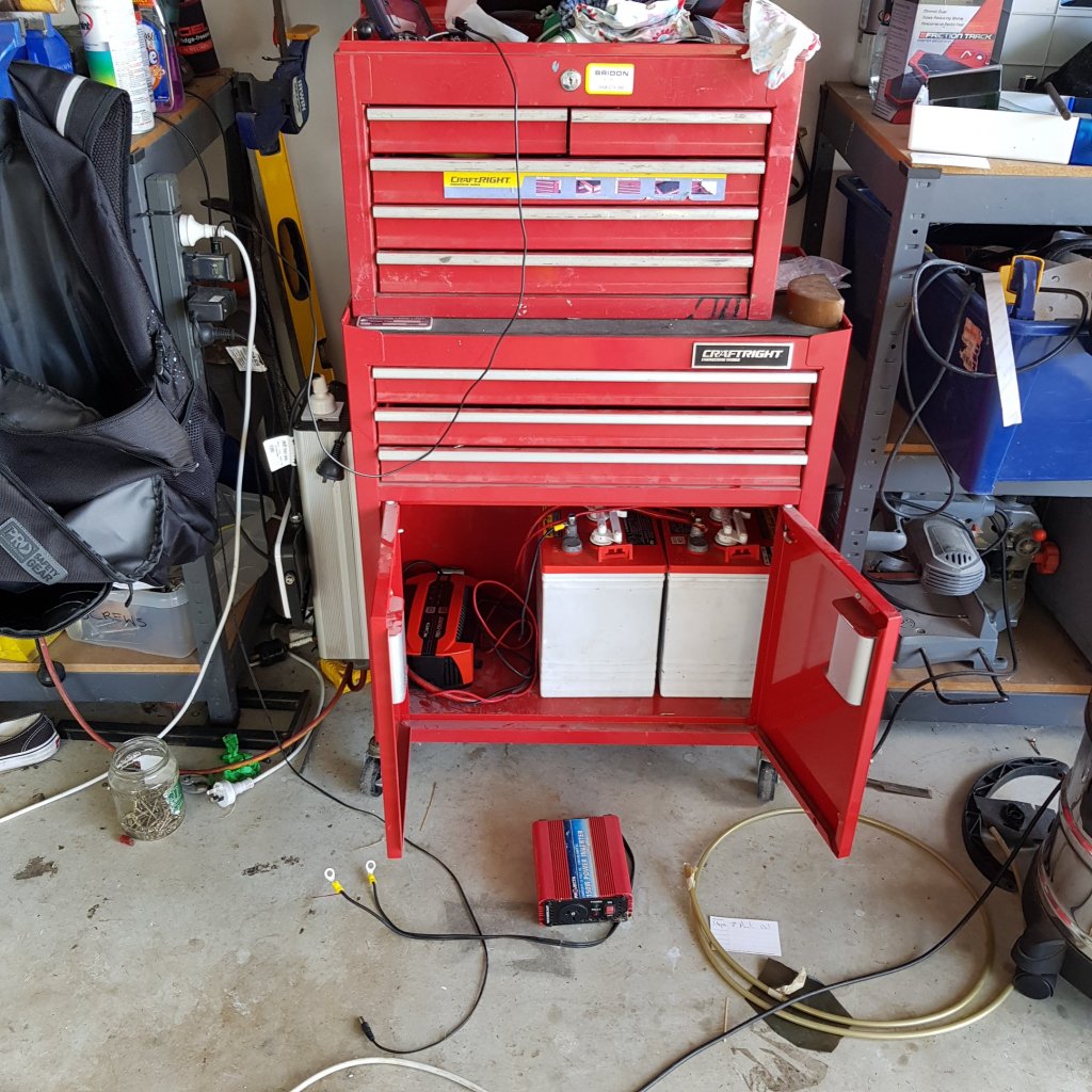

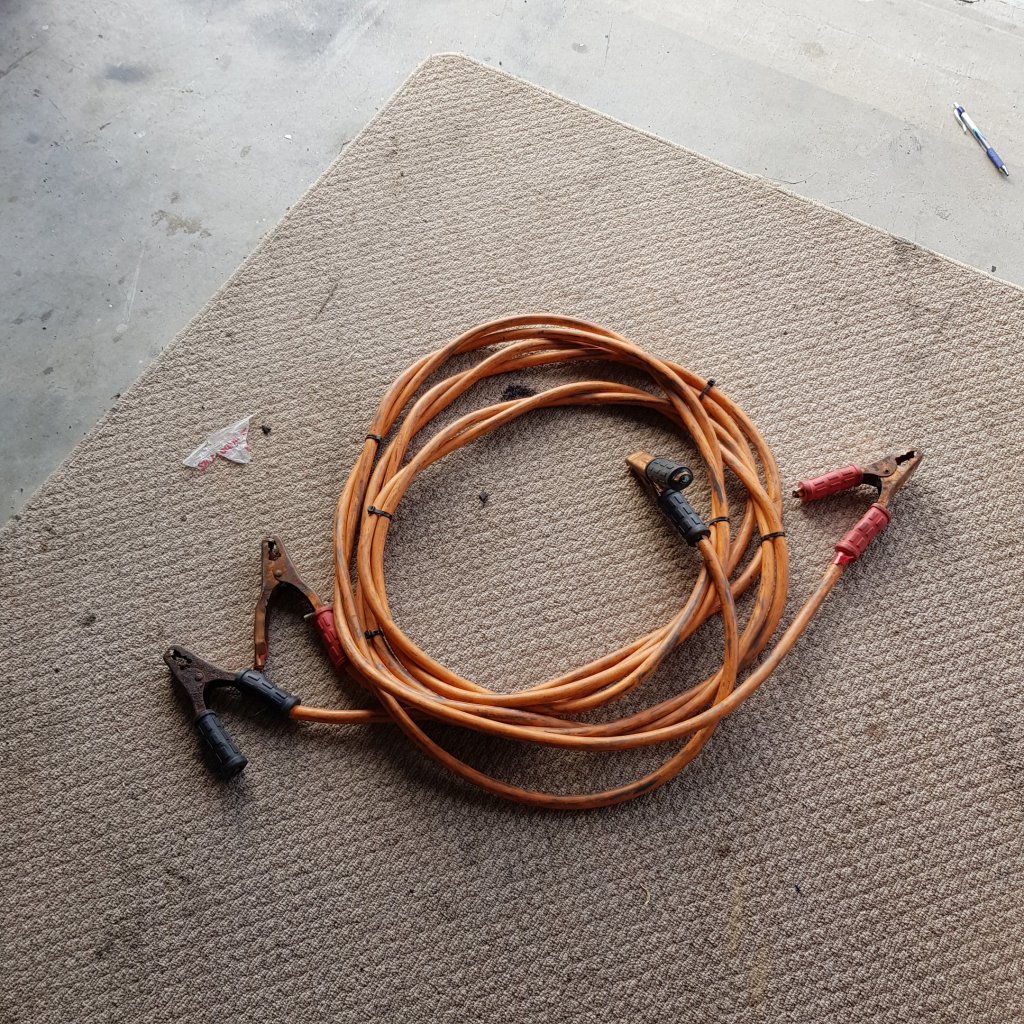

Muncie Posted May 8, 2018 Posted May 8, 2018 The bottom of my toolbox had been useless too small to fit my power tools and socket sets in finally had a brain fart moment and a purpose for some stuff I had been hoarding. Mini power station. 2 big arse 6 volt batteries a hardwired charger and a big boy inverter and a smaller one to run smaller stuff a bit more efficiently, I have had a few power cuts where I am with builders spearing underground cables with diggers it's been pretty damn handy. Plan is to add a solar panel and run a few circuits in the house off it lights etc possibly a 12v setup to avoid diving in to the mains stuff. It's also a mint as a jump pack with these 6metre 35mm cable leads (every one needs these) 7 Quote

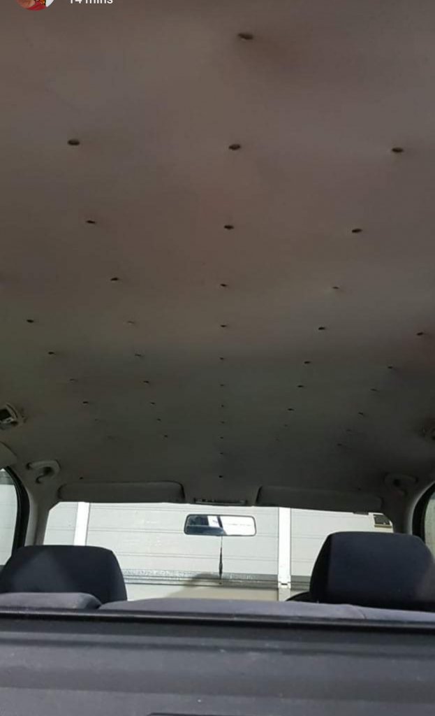

Popular Post Muncie Posted May 12, 2018 Popular Post Posted May 12, 2018 Going to post this here for anyone whose putting up with a sagging hood lining as it turned out better than I was expecting for $7 only one spot I hit a roof structure and had to shorten the brass thumb tacks haha. Stringlined the center rear view mirror to center of rear hatch then used a 1m ruler to place tacks every 150mm it settled nicely. Wont be putting any upholstery specialists out of business but it beats driving with cloth on ya head. 10 Quote
moparmuppet Posted May 12, 2018 Posted May 12, 2018 Geez that's rough... I used a staple gun 3 1 Quote
Muncie Posted May 12, 2018 Posted May 12, 2018 3 hours ago, moparmuppet said: Geez that's rough... I used a staple gun Maaaaate $7 wasn't gonna be Danske Mobler spec. I used a staple gun on my Rover SD1 went thru the bloody roof skin. 4 1 3 1 Quote

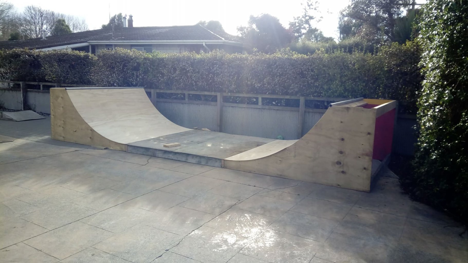

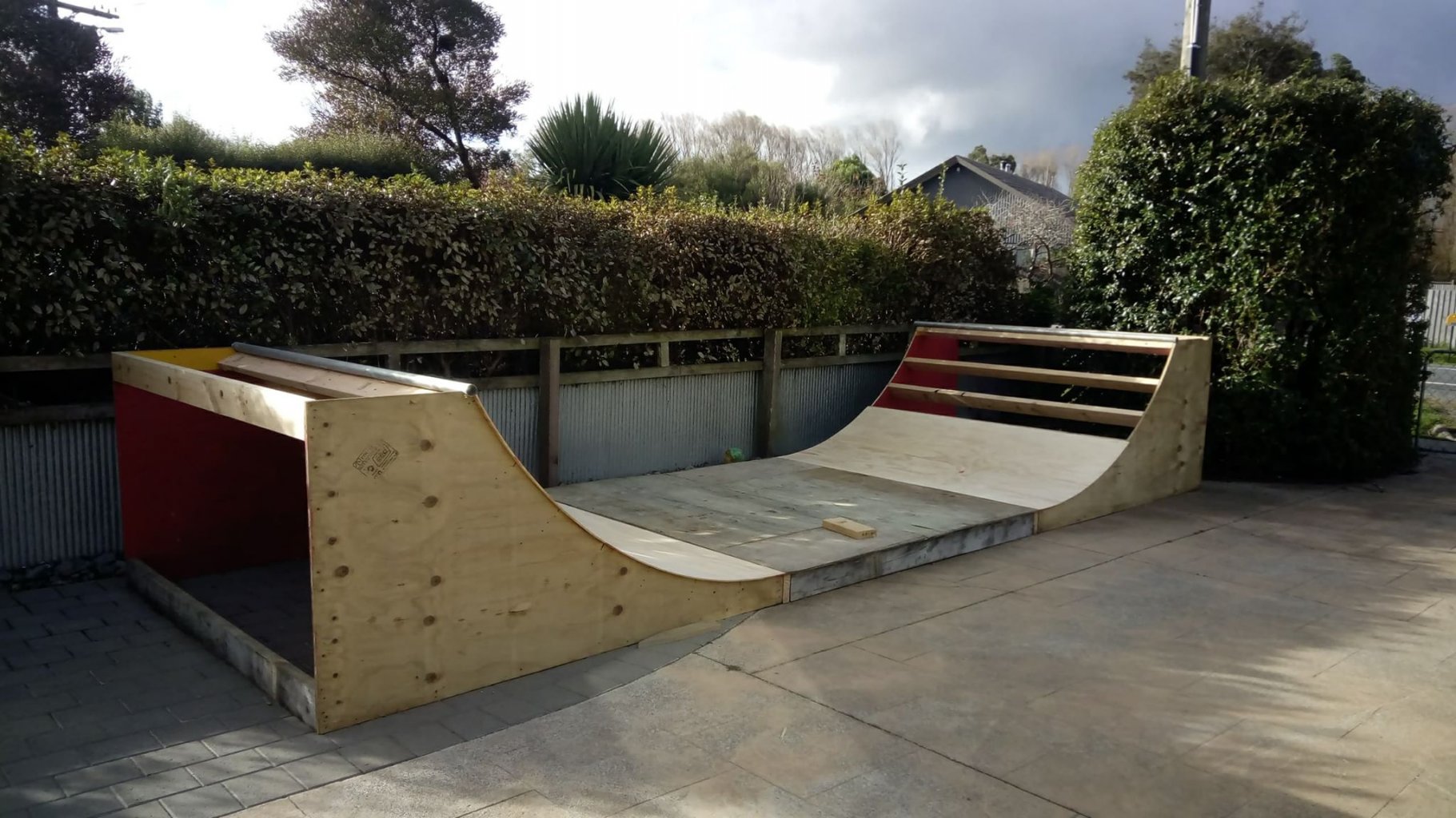

Popular Post Valiant Posted May 27, 2018 Popular Post Posted May 27, 2018 During the week I purchased 8 sheets of 7mm downgrade plywood for the curved sections. The flat was bits of 12mm I'd scrounged previously. Progress from this weekend. Looking good. Kids are excited. Â 21 Quote

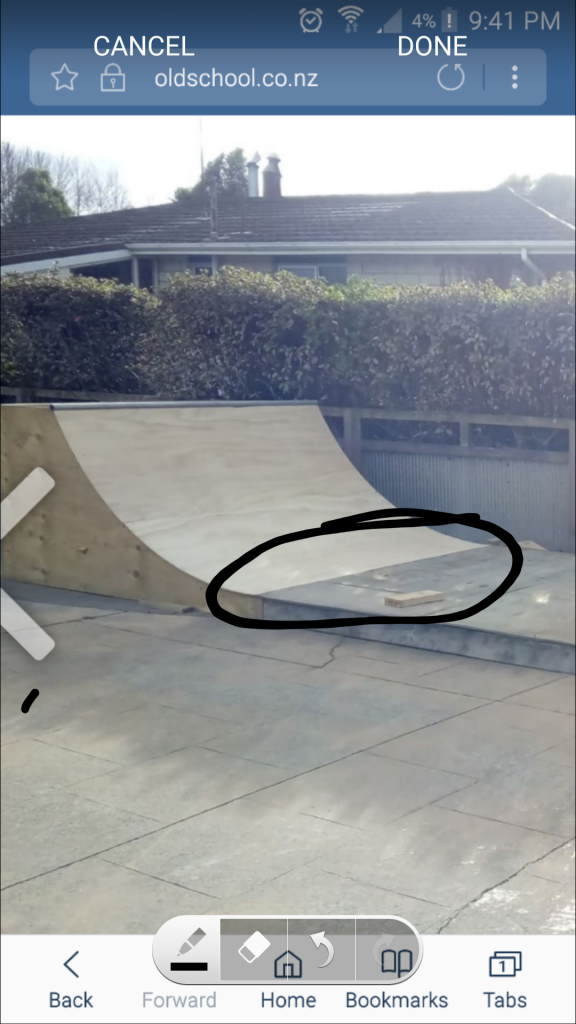

Kimjon Posted May 27, 2018 Posted May 27, 2018 Looking good. You're going to want 2 or better still 3 layers of ply on that bad boy. The transition between flat and curve tends to get a pounding and holes in the ply develop really quick in that area if there's not enough layers. 2 Quote
Valiant Posted May 27, 2018 Posted May 27, 2018 It's going to be two layers to start with, if it's a problem I'll add an extra later over the top. I just didn't get as much done today as would have liked. Â Thanks for the tip. 1 Quote
SOHC Posted May 27, 2018 Posted May 27, 2018 They usually do a cople layers of 10mm at 45 degrees, get more from each sheet that way to. Quote
63Ragtop Posted May 28, 2018 Posted May 28, 2018 and stronger when layed long ways, shit this takes me back! I somehow managed to talk my olds into building one of these in our back yard when I was 14-15, good shit man, now get them gommits away from those scooters! Â 5 Quote

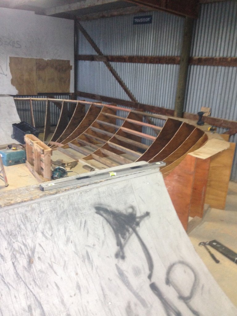

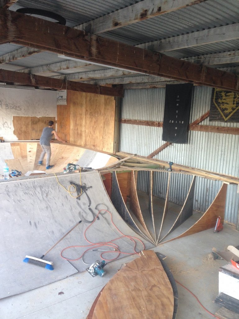

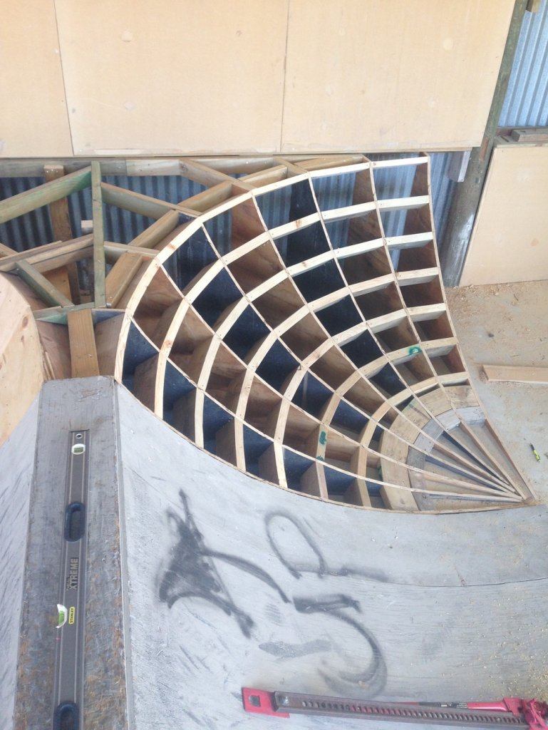

Popular Post mutiny Posted May 28, 2018 Popular Post Posted May 28, 2018 turn her into a bowl. heres a bowl corner i built quite some years ago  9 1 Quote
mutiny Posted May 28, 2018 Posted May 28, 2018 and heres a video of the place as it sits now. well actually there is a couple of new additions  https://www.facebook.com/jan.beranek.10/videos/10211448553637460/ Quote
Valiant Posted May 28, 2018 Posted May 28, 2018 That's a few steps above my skills/budget. looks like an awesome job. Quote
