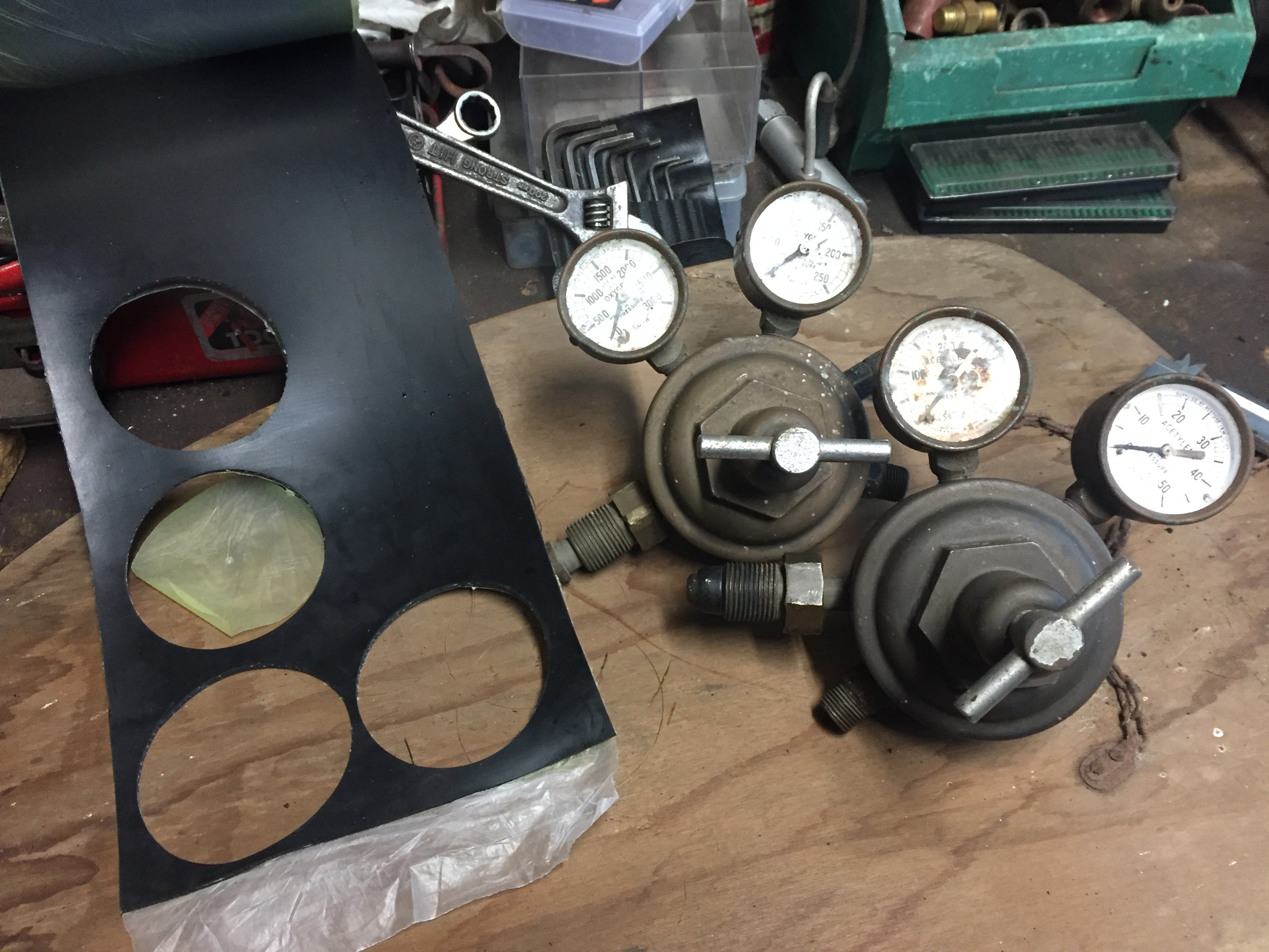

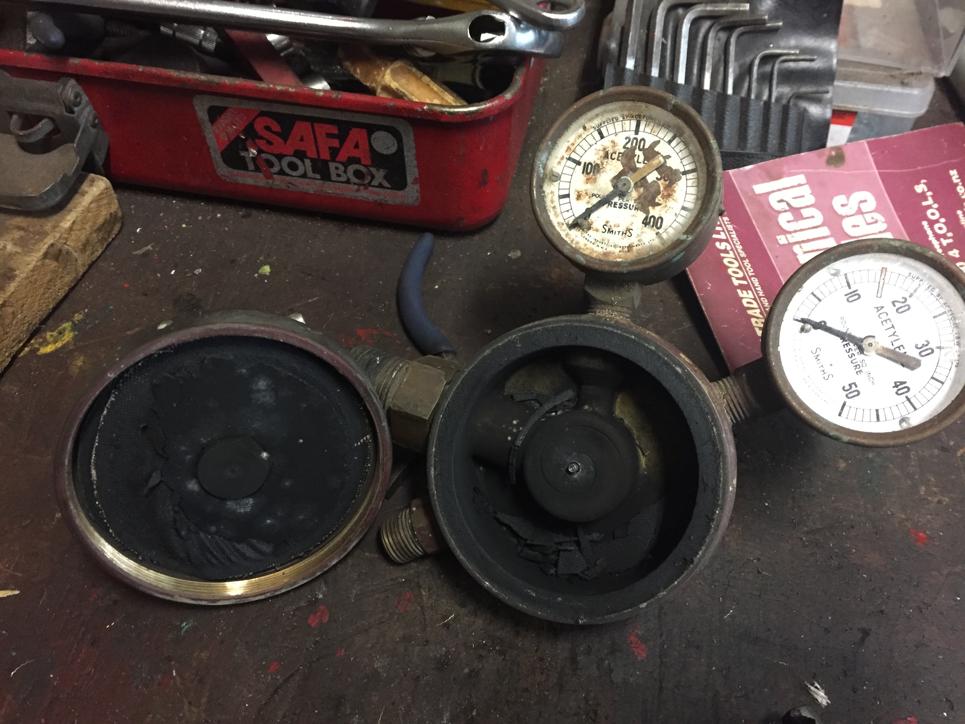

Popular Post SOHC Posted November 5, 2020 Popular Post Posted November 5, 2020 Finally found the proper 2ply 3.2mm synthetic shit, took a couple practice runs to get the cutter right but now they work. 16 Quote
ajg193 Posted November 5, 2020 Posted November 5, 2020 Does it really make sense mucking around using 80 year old gauges and regulators in a safety critical application? What's a new or even somewhat recent set cost? A couple hundred bucks? Quote
tortron Posted November 5, 2020 Posted November 5, 2020 GEnuine smiths gauges tho (that have had no oil in them for 50 years) Rudi mixes it by sense of smell tho Quote
ajg193 Posted November 5, 2020 Posted November 5, 2020 https://www.trademe.co.nz/a/marketplace/business-farming-industry/industrial/manufacturing-metalwork/welders/listing/2850145610?bof=aRYHuxcx $75 delivered for a brand new acetylene regulator Same price for oxygen, can get them used for even less Quote
Popular Post SOHC Posted November 5, 2020 Popular Post Posted November 5, 2020 14 minutes ago, ajg193 said: Does it really make sense mucking around using 80 year old gauges and regulators in a safety critical application? What's a new or even somewhat recent set cost? A couple hundred bucks? If it lasted that long it must be good? Thees old regulators have relief valves in them and way better valve seats, can be stripped down to clean the build up of shit easy. I got a brand new set of BOC regulators 3 years ago and they have failed, before that I had another set that started leaking after a year. Some of the cheep ones have cardboard faces is the gauges and the flow is terrible as I do a lot of brazing almost every day, when end I go to the shed I will get a pic of my regulator graveyard 13 Quote
NickJ Posted November 6, 2020 Posted November 6, 2020 How did you cut them, looks really neat? We do plenty of that kind of stuff with the waterjet cos its a pain most other ways Quote
SOHC Posted November 6, 2020 Posted November 6, 2020 7 minutes ago, NickJ said: How did you cut them, looks really neat? We do plenty of that kind of stuff with the waterjet cos its a pain most other ways I have a circle cutter knife thing Quote
