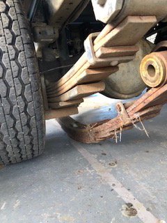

Unclejake Posted September 8, 2020 Posted September 8, 2020 Thanks chaps. Air assist will be about $2k (including freight and installation) but it's convenient as the truck will only be off the road for a day. New custom made springs are probably a similar value, but high risk if they don't fit. No one does CoF inspections on the Island so all we can get are WoFs. We have an exemption for passenger vehicles that would otherwise need CoFs..... but one day I may bring the truck back to the mainland as its actually a bloody good wagon. I will have a think. Re-setting the original springs might be the best plan.... but that's weeks without a truck and probably ~$1k in freight Quote

Unclejake Posted September 9, 2020 Posted September 9, 2020 They would work mate. I could probably get those made pretty easily. Everything on this Dyna is about 30%bigger than Landcruiser. It's a ute sized vehicle with a truck chassis and suspension. Unsprung weights are huge. I can barely lift a wheel.... and there's six of the bastards. Part of the hideous ride will be because truck.... but add passengers in the cab and it's noticeably worse I am lucky in that I carry a fixed weight in the rear. I estimate 350kg of tools (plus the alloy box body) sits on the rear chassis 1 Quote

MaxPower Posted September 21, 2020 Posted September 21, 2020 On 10/09/2020 at 11:03, Unclejake said: Everything on this Dyna is about 30%bigger than Landcruiser. It's a ute sized vehicle with a truck chassis and suspension. Unsprung weights are huge. I can barely lift a wheel.... and there's six of the bastards. heres some 2" cobra land cruiser 70 series lift springs next to my 95 2wd dyna, they look like they would fit but you would need to use the bottom two fat dyna leafs. another hori way would be to mount some coil springs in between your diff and bumpstops ftw. cruiser shackle extenders would be simple to fit too. sorry for non airbag chat. also keen for an island mish one day 1 Quote

Unclejake Posted September 21, 2020 Posted September 21, 2020 @MaxPower, that was an incredibly generous thing for you to have done. Thank you. There's heaps of landcruiser springs around here, but I glanced at a couple and decided they wouldn't fit. I will have a better look in the weekend. perhaps I was mistaken. My 4x4 Dyna front springs are 1,160mm long, 72mm wide, with 2 x 9mm (at centre) parabolic leaves and an eye bolt i/d of 23mm Rear springs are a bit of unknown Quote
