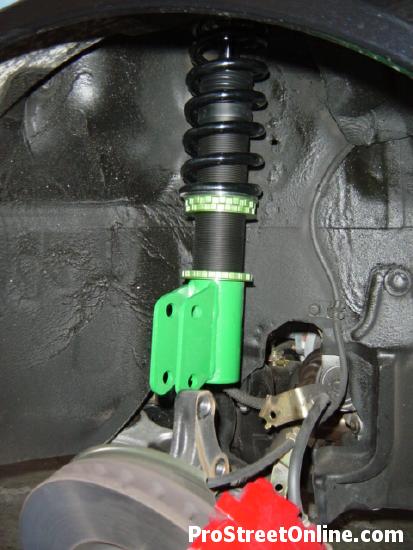

Roman Posted February 24, 2021 Posted February 24, 2021 Hi, In the case of coilover suspension like this, where there's a height adjustable section at the bottom (which means the shock assembly can be completely removed from the part that mounts to the hub) Would it be okay to cut off those mounting points for the hub, and put some new ones on to fit a different hub bolt spacing/angle? I'd assume it would need tig and crack test.  Quote

cletus Posted February 24, 2021 Posted February 24, 2021 1 hour ago, Roman said: Hi, In the case of coilover suspension like this, where there's a height adjustable section at the bottom (which means the shock assembly can be completely removed from the part that mounts to the hub) Would it be okay to cut off those mounting points for the hub, and put some new ones on to fit a different hub bolt spacing/angle? I'd assume it would need tig and crack test.  Yep that could be done if you do it like you say If it was me I'd try and incorporate some extra gussets rather than just 2 bits of flat bar butt welded on , some coilover brands do this, some do not 1 Quote
Roman Posted February 24, 2021 Posted February 24, 2021 Okay thanks. Yeah definitely make a U shaped piece and some gussets or whatever... would be one hell of a thing to have snap off haha. Quote
