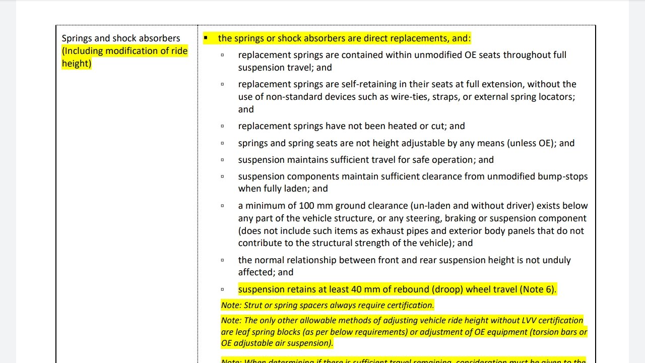

Mof Posted May 18, 2020 Posted May 18, 2020 Lift springs are direct replacement? A bit vague https://www.lvvta.org.nz/documents/suplementary_information/LVVTA_LVV_Cert_Threshold.pdf Quote
JustHarry Posted May 18, 2020 Posted May 18, 2020 Just now, Mof said: Woah, sorry seems they've just changed the wording. Damn now I guess I'm up for cert Generally you get away with bigger lifts if it's done right and your not a fuckwit Also friendly wof places help 1 Quote
Mof Posted May 18, 2020 Posted May 18, 2020 Depends who you get at the place too. Used to fail, show them old lvv Threshold sheet, pass. Last guy I had would not let it go, eventually had to resort to "oh I'll give it to you this time, but next time...." Quote

KKtrips Posted May 25, 2020 Posted May 25, 2020 On 18/05/2020 at 20:44, Mof said: Lift springs are direct replacement? A bit vague https://www.lvvta.org.nz/documents/suplementary_information/LVVTA_LVV_Cert_Threshold.pdf What's vague? I can clarify. Also only the bits in yellow are changed from previous threshold doc. Quote
Mof Posted May 25, 2020 Posted May 25, 2020 Yes now that I re read it it doesn't seem vague, in fact it could be interpreted as being incredibly specific. What constitutes direct replacement? Aftermarket shocks? Aftermarket shocks that are "OEM replacement"? How do you prove that they are? OEM shocks? I mean if you really get specific then only the actual shocks that are removed from the vehicle are direct replacement for those shocks. I feel that you can clarify all you like, but this is the threshold sheet, it's not up to you. It's up to the wof testers, and they interpret these things in an incredibly broad spectrum. Quote
ajg193 Posted May 25, 2020 Posted May 25, 2020 If it bolts in without needing any modifications then it would be a direct replacement? /technically if you're nit picking, all springs need to be cut and heated by the manufacturer, so that line should really state something along the lines of "replacement springs have not been heated or cut after initial manufacturing" Quote
