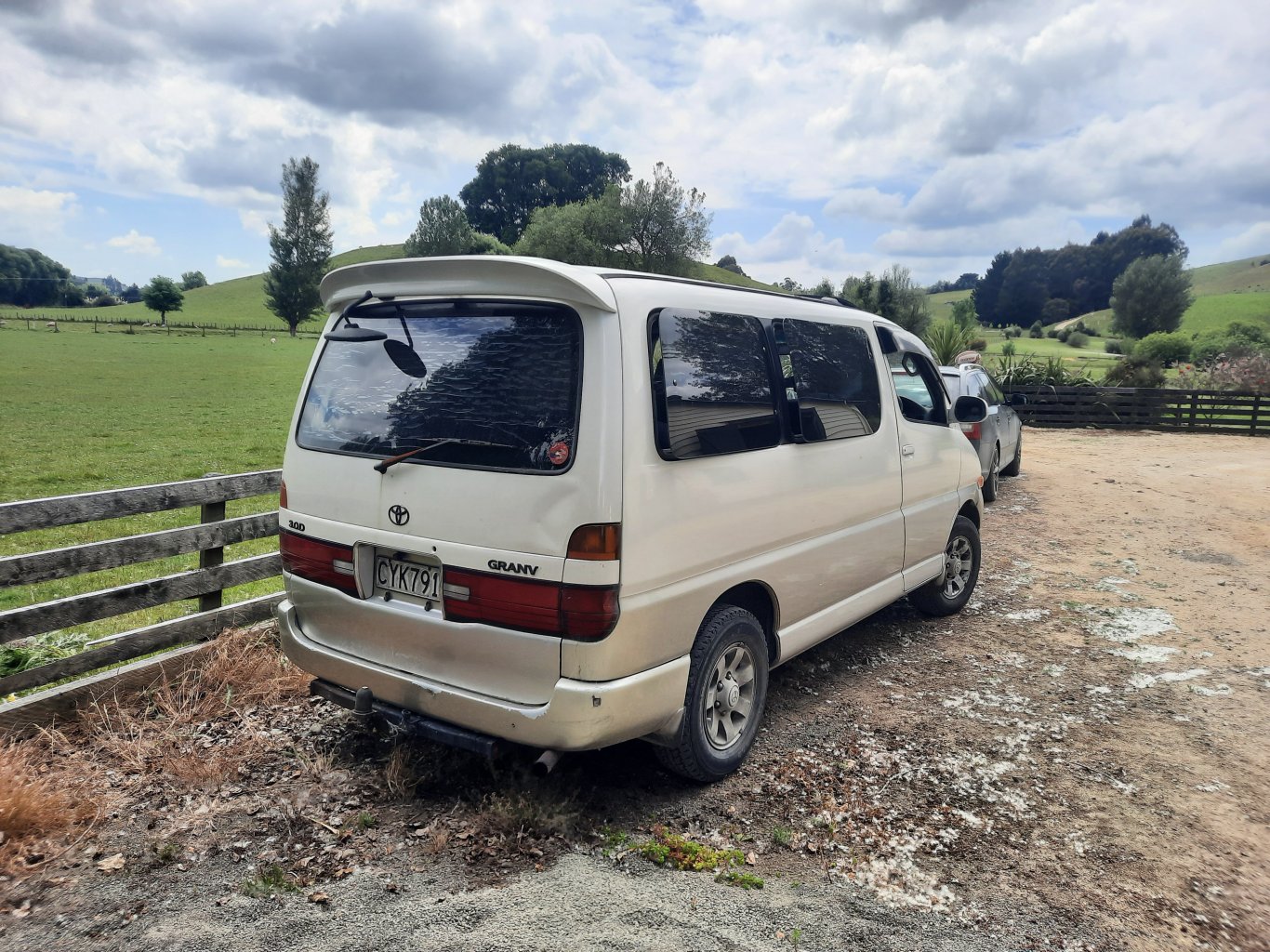

After years of thinking about it, I finally bit the bullet and bought a van! Not just any van either, it's a luxury 1997 Toyota Granvia 4wd with 1KZ turbo deeeez.
I've been living in Queenstown for 6 months now and realised a couple of things:
1. I need my racecar in the South Island
2. 4WD vans are super handy for towing and mountain bike missions
Being the smooth-brained creature I am, it seemed like a great idea to buy a van in the North Island so I could tow the AE86 down after Christmas.
Enter: Francis Jellybean GranV a.k.a the Lizard Lounge.
@DodgySam and @Ogre were GCs and went to check it out for me in Rotorua. The consensus was that it's dirty, but mechanically solid. The guy wanted to move it on, so we struck up a deal and I sent him a few macaroons in the electronic-post.
@UTERUS collected it for me and my parents drove it back to Palmy North, where it's be sitting until I got here for the Christmas break.
Someone marked their territory before it got back to Palmy...

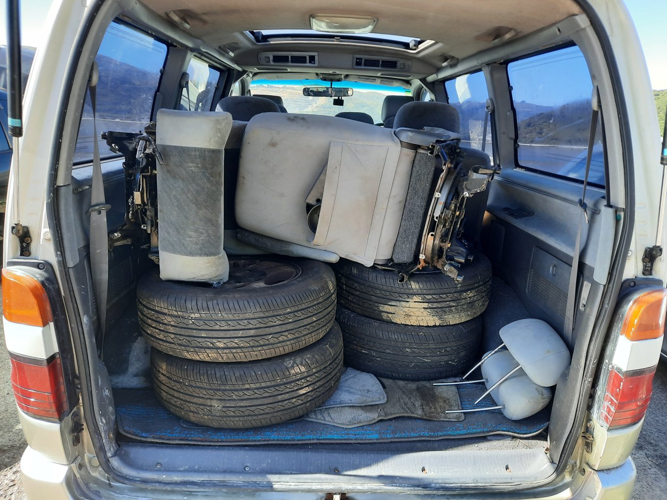

The answer is "kind of". The seat bases mount to the floor the same, but the actual seat rails are slightly different. That's annoying since seat rails are $15ea at pickapart and complete sears are $55ea.
I bought both complete front seats, even though the upholstery was ripped and stained and figured there would be a way to make them work.

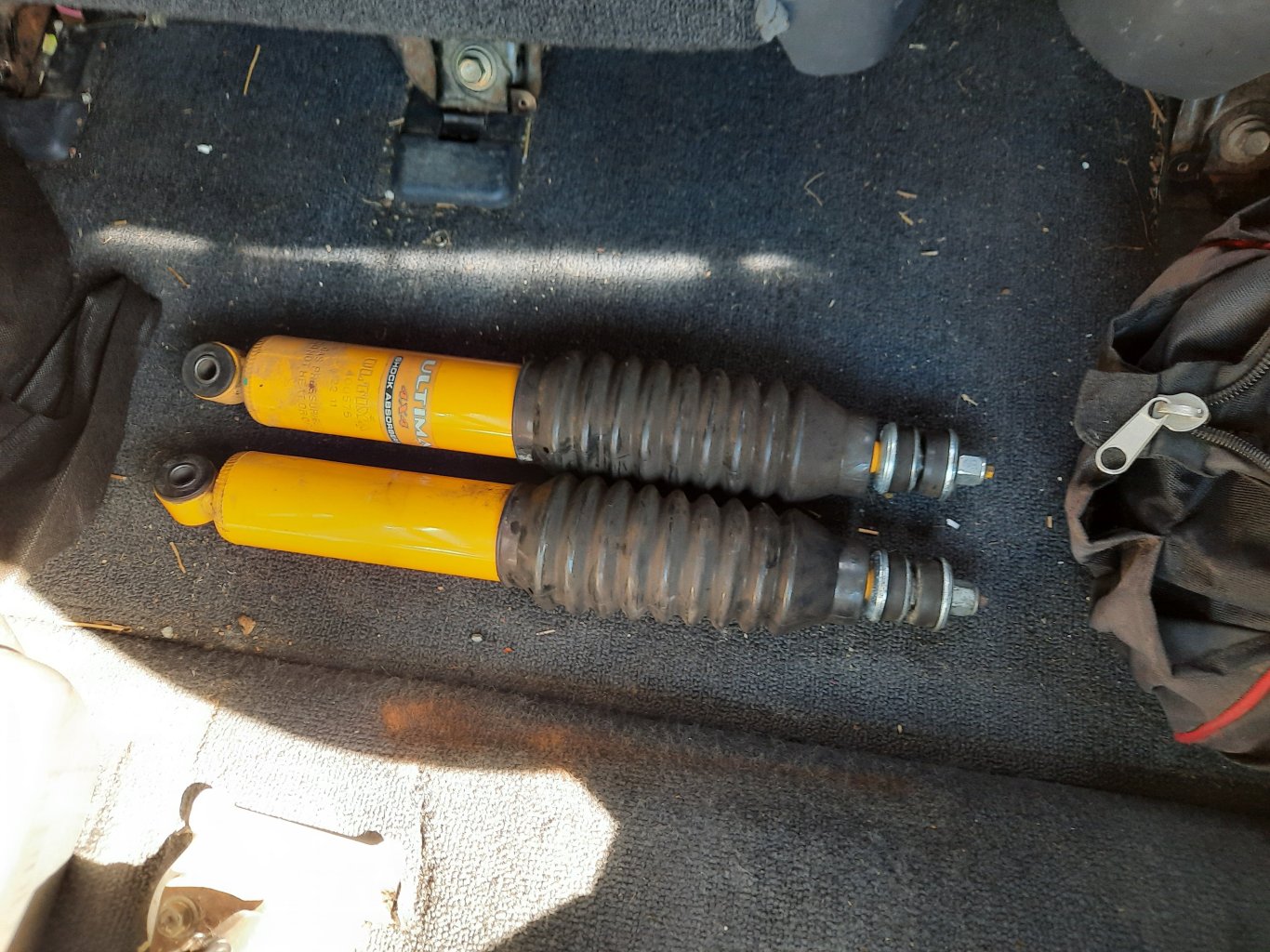

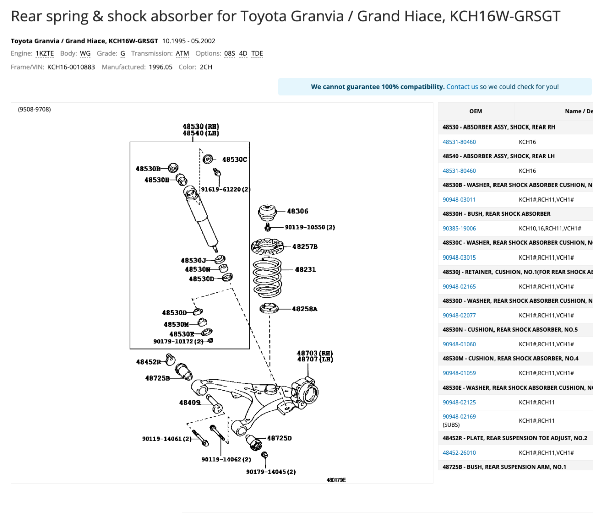

I may have got carried away buying things... the front shocks were a score!

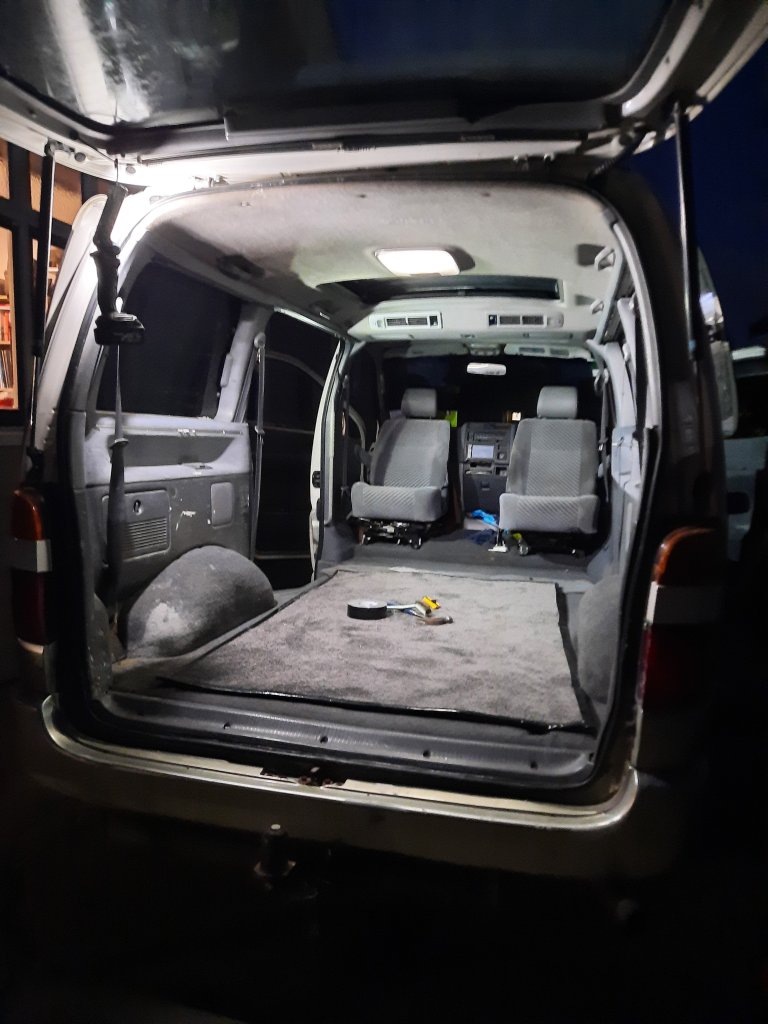

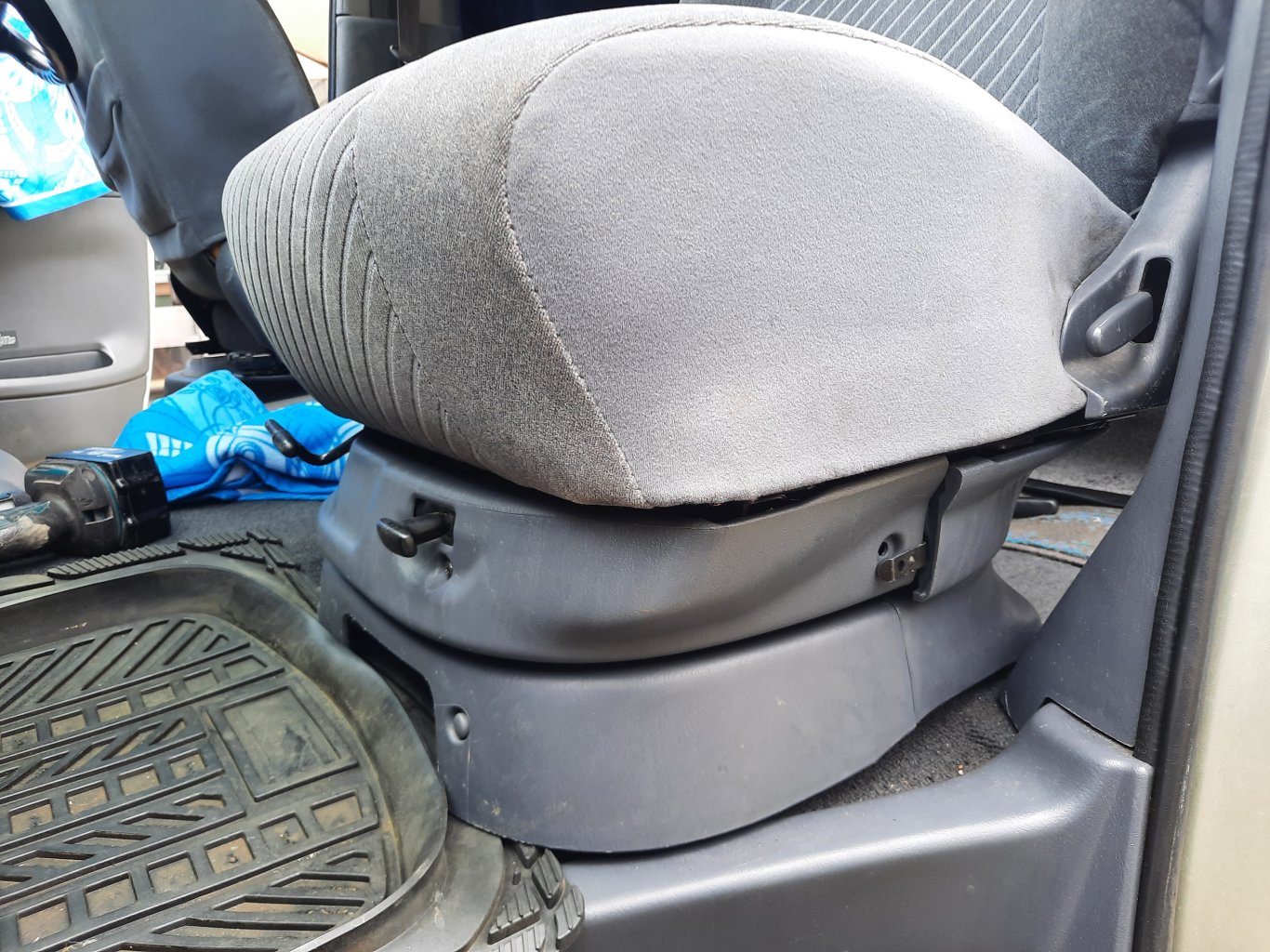

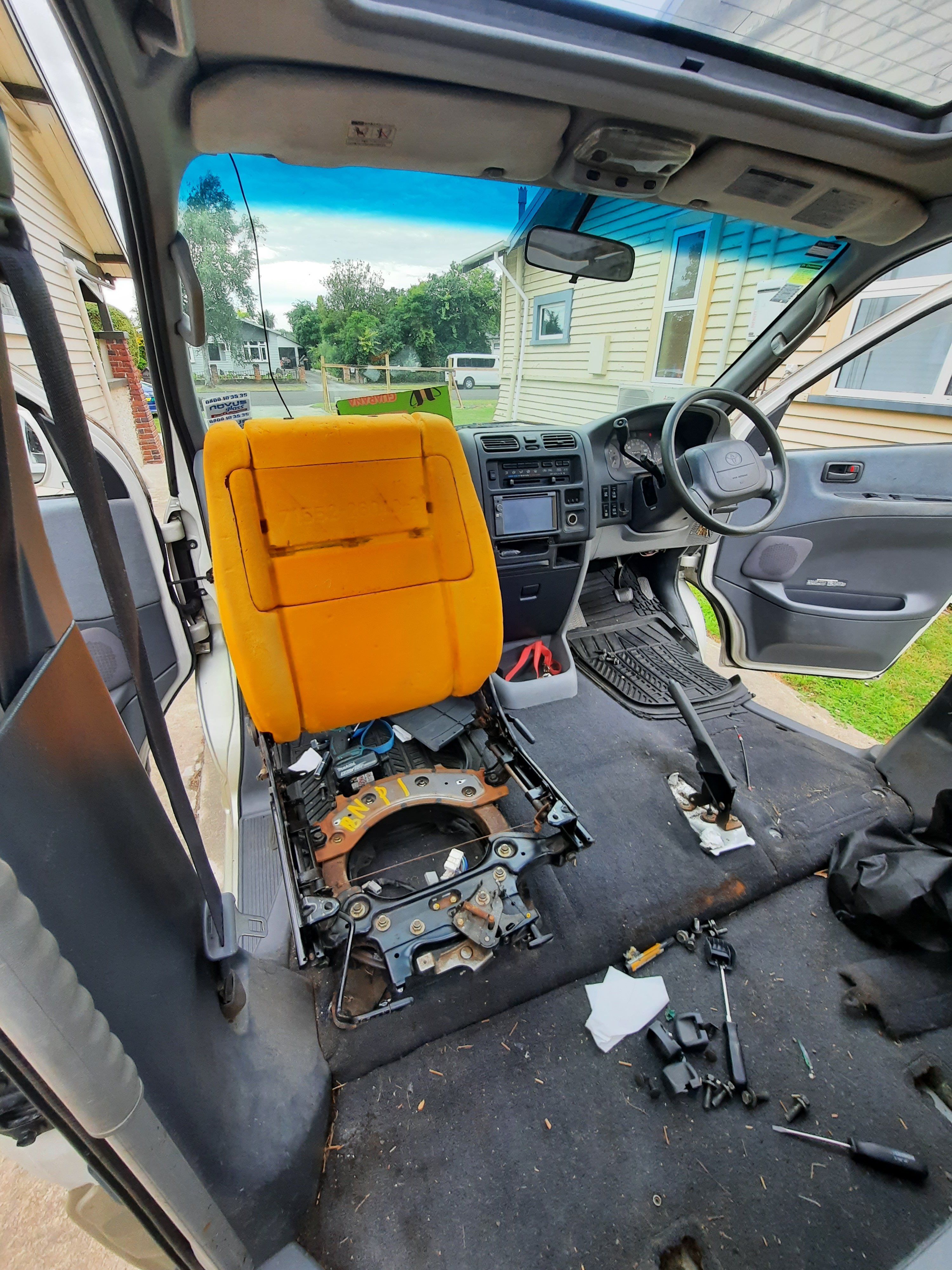

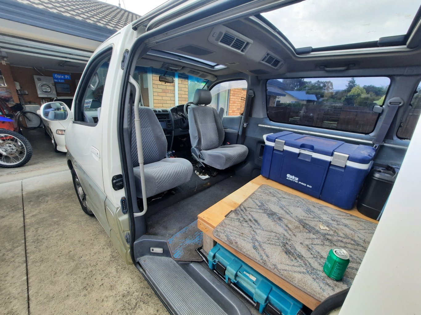

First job was seats. The Regius seats mount to the floor exactly the same as a Granvia, so doing a straight swap would be a piece of cake.

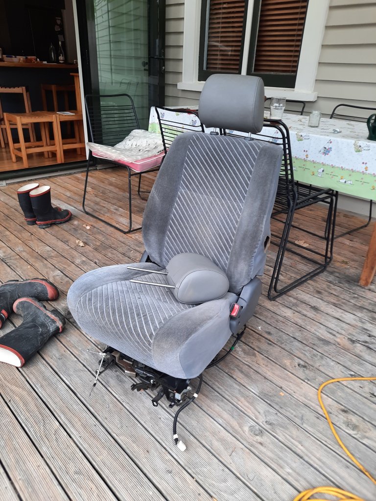

Unfortunately the seats I bought had ripped upholstery, and the seat rails mount to the bases slightly differently on these two models, so some mucking around was needed to make them fit.
Dad figured out that the seat backs are almost exactly the.same shape, so he  set to work swapping the covers over. The bases unbolt and mount the same between the two models. So after a bit of mucking around, we were left with rotating seats in Granvia trim colour:

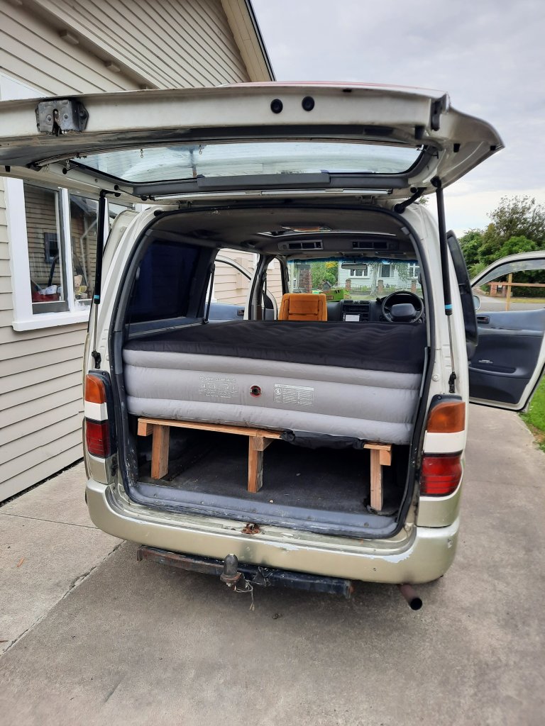

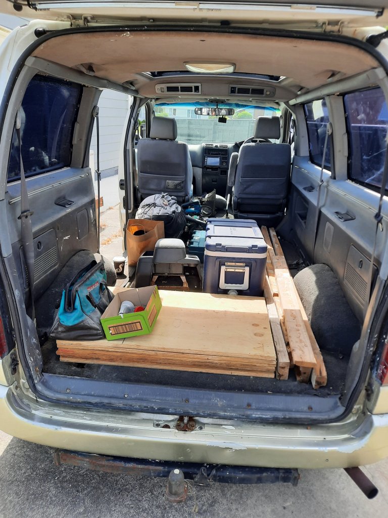

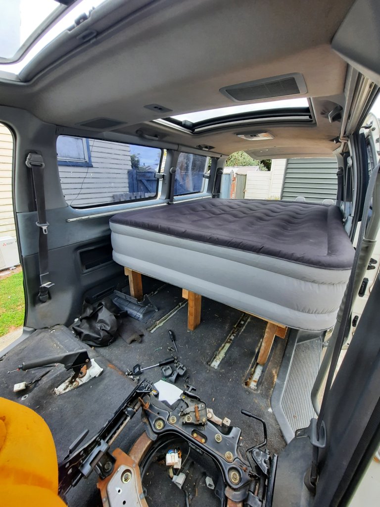

While Dad was doing that, I removed the fear seats and knocked up a quick bed base.
20231221_190343.thumb.jpg.14ab5356f8ac0111a2a462c0a2bee320.jpg It should be strong enough for a few acrobatic activities...
The captains seats are so lush.
Refitted the factory trims to make it look normal:

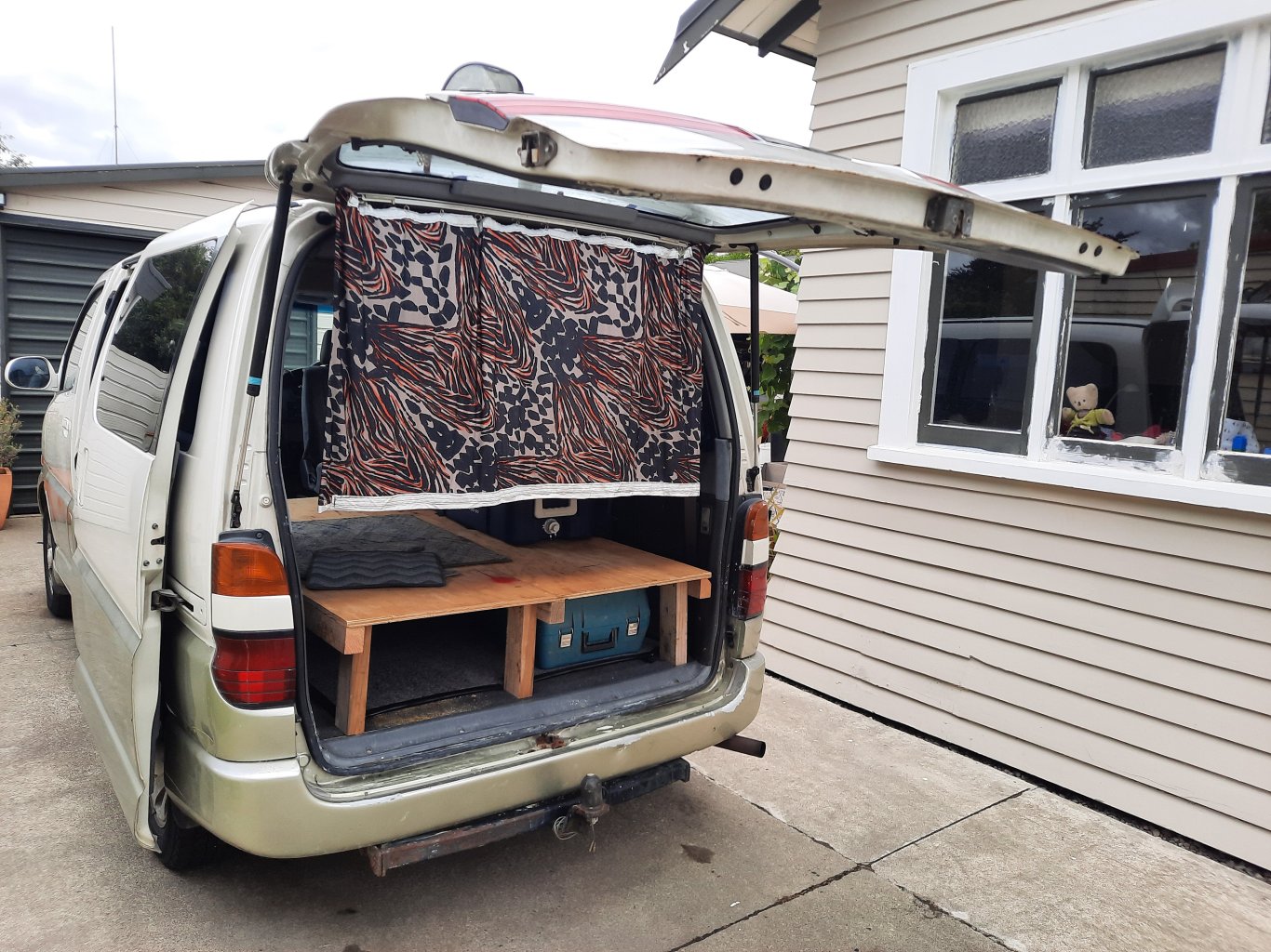

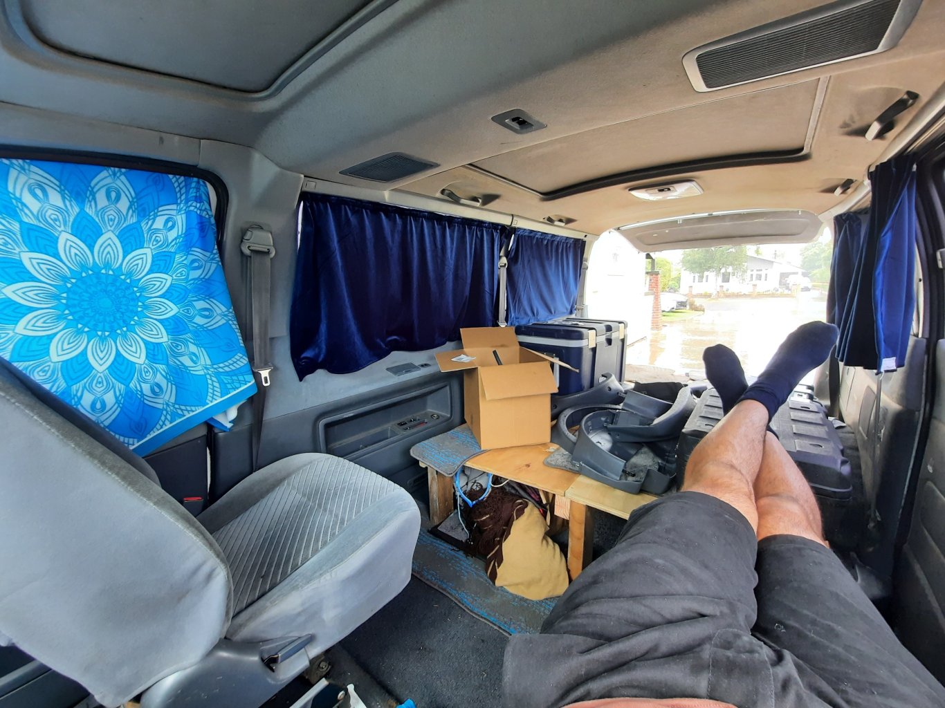

Next up was to get curtains into the thing. I'd been looking for a set of genuine ones, but they seem to be the first thing to sell from any wreck...
Mum came to the rescue and sewed up these lush velvet curtains using material she scored for $10 from a thrift shop.
Hey baby, want to stroke my velvet curtains?
We ran out of material, so the rear curtain is a vibe of it's own.

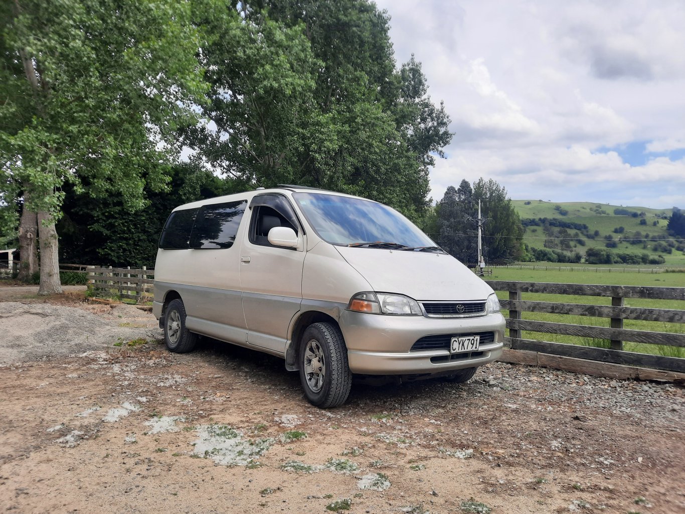

Aaaaand with that, it was time for the maiden voyage - a night mission from Palmy to Whangamata.
It felt slow and was struggling to kick down... it felt like the throttle pedal wasn't going all the way to the floor. It has thick universal floor mats, so I removed that at 100kph and boom, full power!!!
It goes great now.

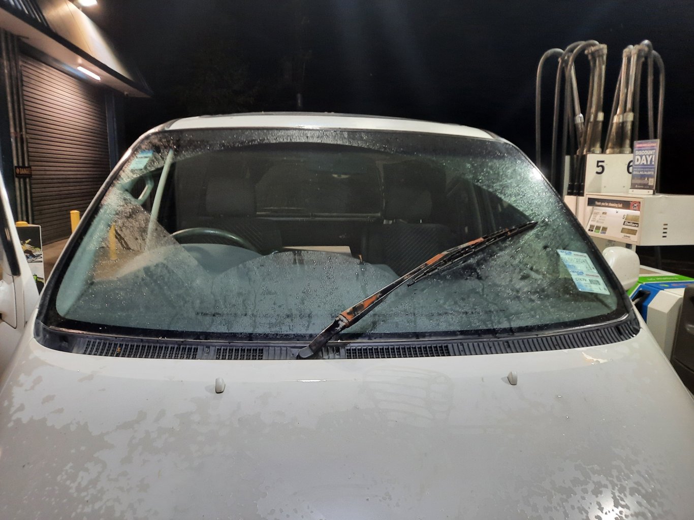

Heading through the Waikato my windscreen was fogging up. I eventually realised it was the OUTSIDE of the windows that were getting foggy. Wtf Waikato, why so moist?!?!?!?!
Also note: the racecar spec single wiper conversion. The drivers side spindle is so floppy that it wouldn't touch the windscreen over 80kph. The single works well enough for now.
Safely arrived in. Whangamata:
Pretty happy with it so far. The engine and transmission seem solid for a 300k+ van. I'm looking forward to adding some more goodness to it soon!
