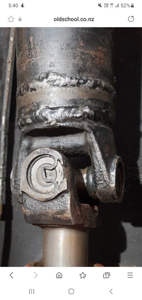

It's not exactly 'weld porn' but seems ok from what I could see. The car is probably stock height unless the rear springs are lowered. They are still at the stock eye setting and no blocks. It was a lot lower though as the guards are rolled and the sidewall damage would not happen at its current height.
  • Replies 61
Yes, this is what I'm getting at, the may have altered the driveshaft for max slam, also a bent driveshaft from being slammed and hitting a judder bar or even the body itself will cause severe vibration
Yeah that drive shaft is terrible
It shouldn't have that extra piece welded in , also there's some weirdness on the front yoke, some of it looks like it's been ground off? There's not much material around the bearing cup

I'll have to look at the drive shaft. I think it is a replacement after the first one shit the bed but who knows where they got it.

also driveshaft looks abit dodgy i would also pull it out and send to russell @ driveshaft specialists
Can anyone recommend a driveshaft guy out west? It is a bit of a hike for me to take a shaft east during work hours.
My other thing is I can sense some scope creep coming on. If I remove the shaft I'm going to dump a bunch of fluid so I may as well yank the trans and fix the leak and service it. While it is out of the way I'd like to fix the floor damage even though it is really only cosmetic. I also want an overdrive gear somehow eventually which would need a shortened driveshaft.... I'd prefer to limp along for a bit till I can do it all but I have a feeling one driveshaft has let go in the past and I have seen videos of driveshafts destroying trans output housings... Sometimes you shouldn't look too hard.
