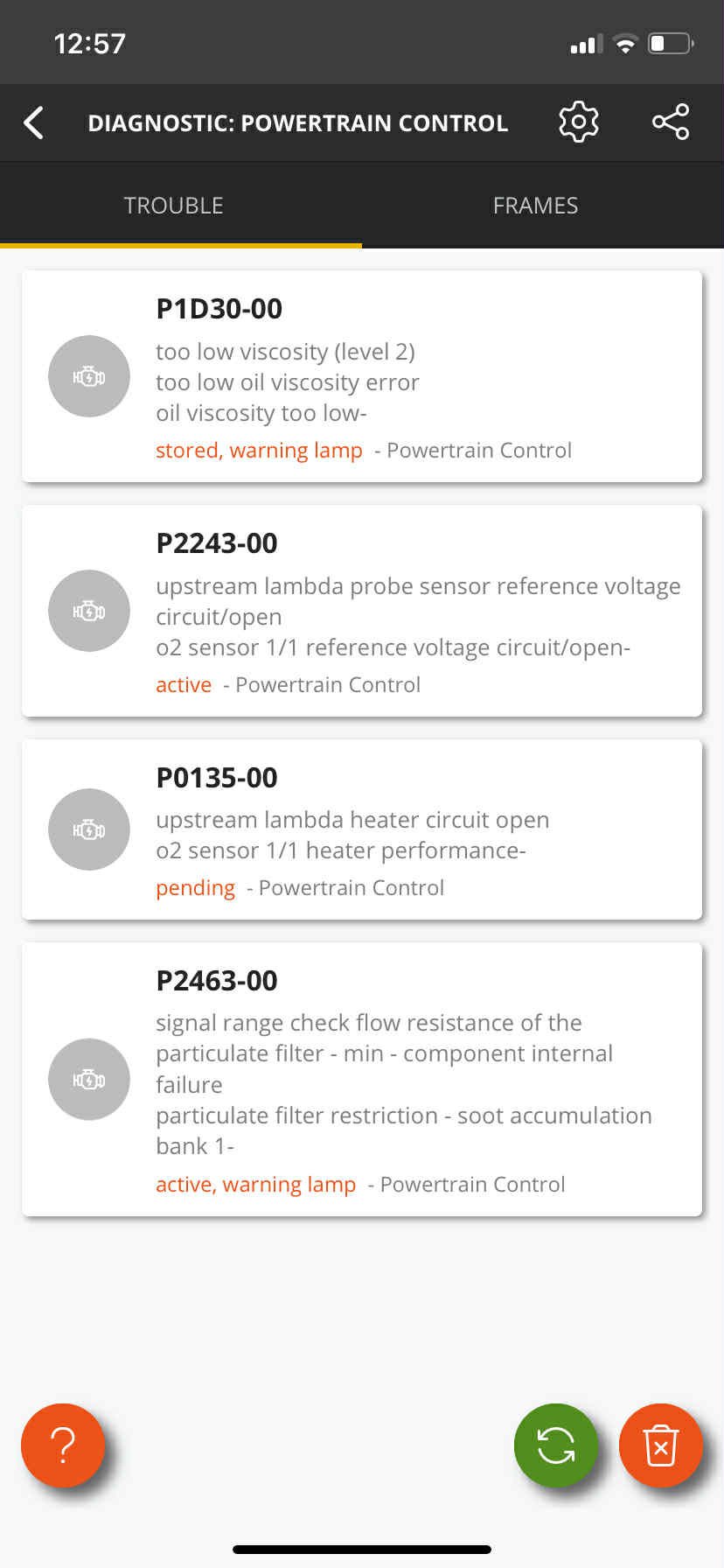

  14. Alrighty. My bluetooth OBDII tool arrived from China the other day, so I've been able to get a bit deeper into things. So it definitely appears that the oil viscosity code is more than likely being caused by the DPF, and that I really need to take it for a big long drive. I have also reset the oil change counter, so we can rule that out now. To complicate matters though... yesterday I got the Electronic Throttle Control light come up on the dash, which comes with a limp mode effect where it won't let me have most of the engine torques. So I'm not sure if it will do the DPF burn while that light is on I can't find a specific code or module related to that on JSCAN, but did find some other interesting codes hiding deep in the tool: It appears that one of the O2 sensors is unplugged or faulty. I asked Jeeves if this could cause the ETC (Electronic Throttle Control) fault, and it said yes it could mess with the calculations and put it into fault mode. So I'm going to start by checking the 02 sensor and see if I can solve that one. Any suggestions are welcome! I have no idea what I am doing.

  18. Been sitting for yonks. i have a filter kit for it. Just need to get it as far as my dads hoist…

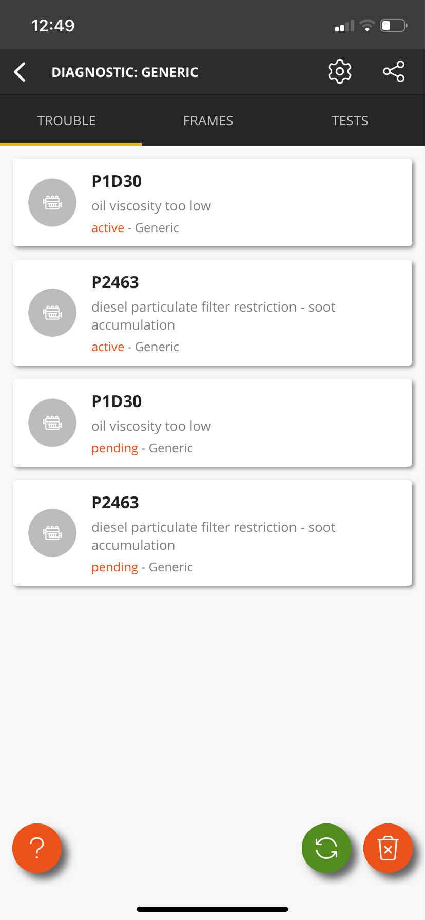

  20. @alfalfa keen to nearly freeze to death again?

  22. Yeah google had filled me in on this. And I think it may have been doing a regen when it first threw the code as I stopped and got out of the car to pick something up and all the fans were going hard, for seemingly no reason, a few minutes before the light came on. i thought changing the oil would have taken out the diesel though? It doesn’t get highway driven often these days so I might take it out for a run this afternoon. Would half an hour be enough?
