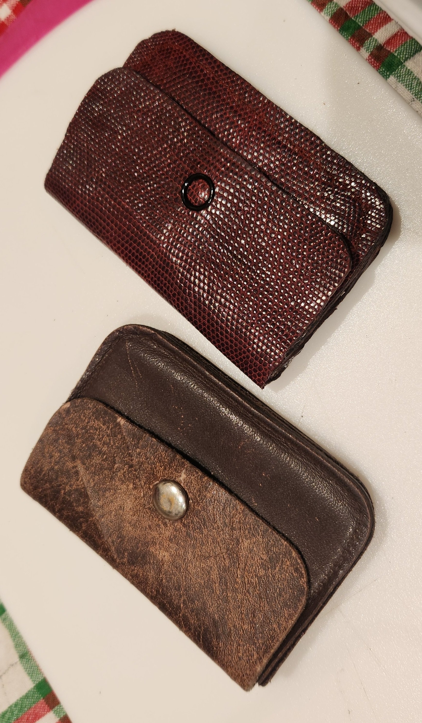

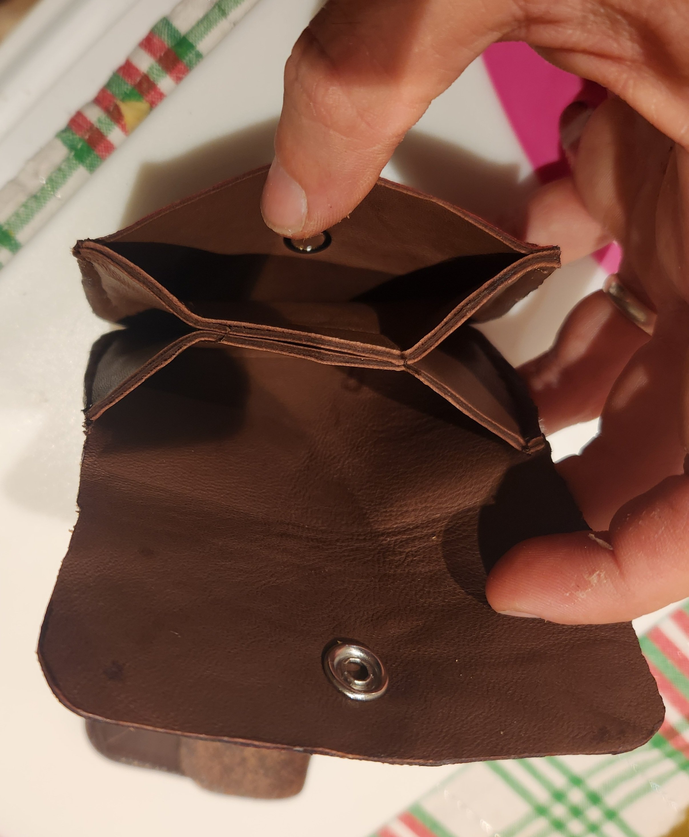

Popular Post tortron Posted May 17, 2024 Popular Post Posted May 17, 2024 I have, what is guess is, a coin purse from the 1950s. It's about 2mm too small to put a bank card in, and pull back out easy. So I made one slightly bigger, original has 3 sections, but I made this one 2. Just sealed the edges, will sand them down tomorrow to tidy them up Water lizard skin, with nz lamb interior. Aaaannnd wife has claimed it. So il probably make another just out of leather for me Sewed with my vickers machine. It flew through even the 4 layer bits like it wasn't there. 20 Quote

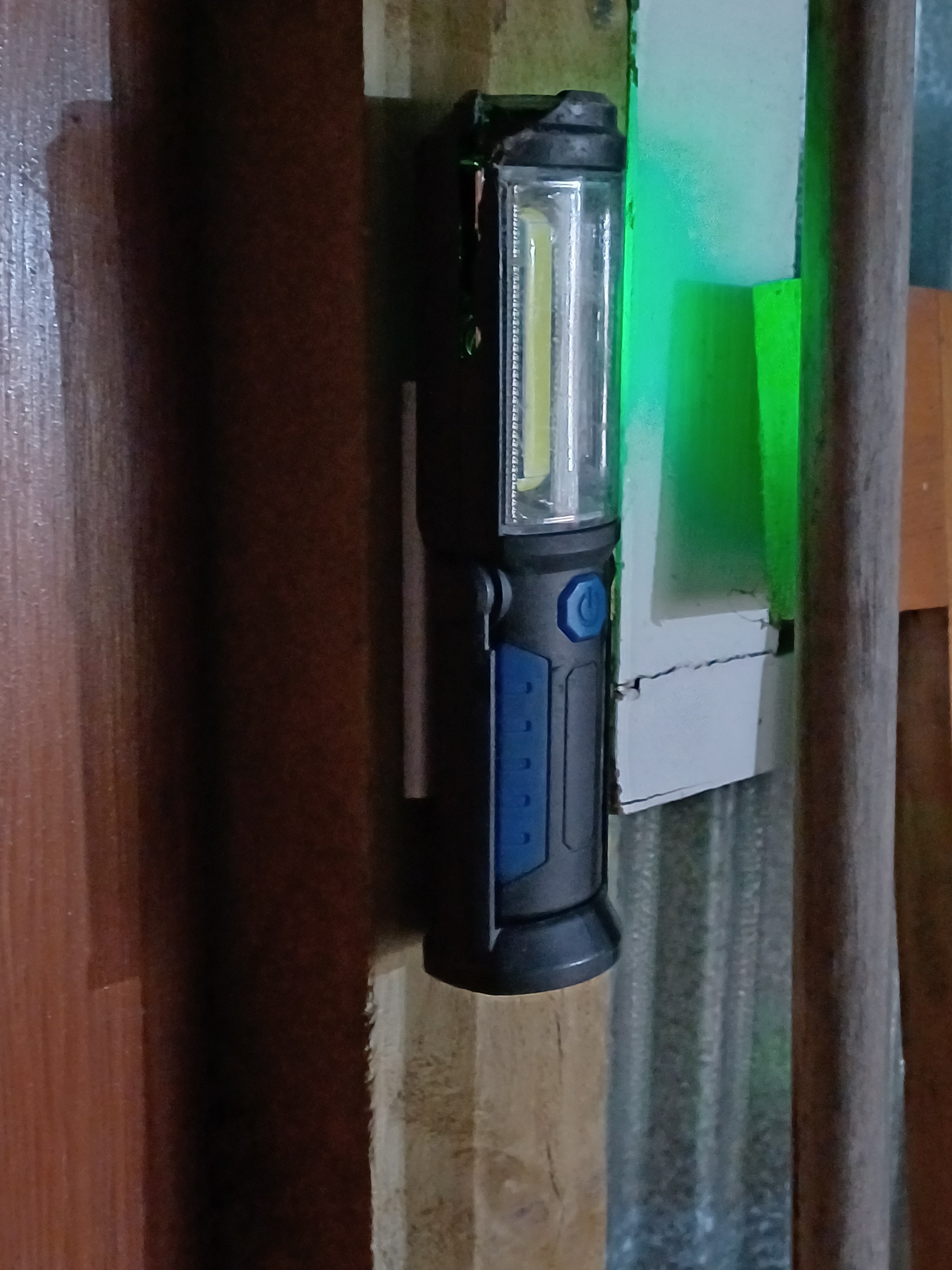

h4nd Posted June 11, 2024 Author Posted June 11, 2024 I stuck a wee metal plate to the wall just inside the garage door, so I could sick a torch to that, so I could keep ignoring the lighting wiring. 3 3 Quote

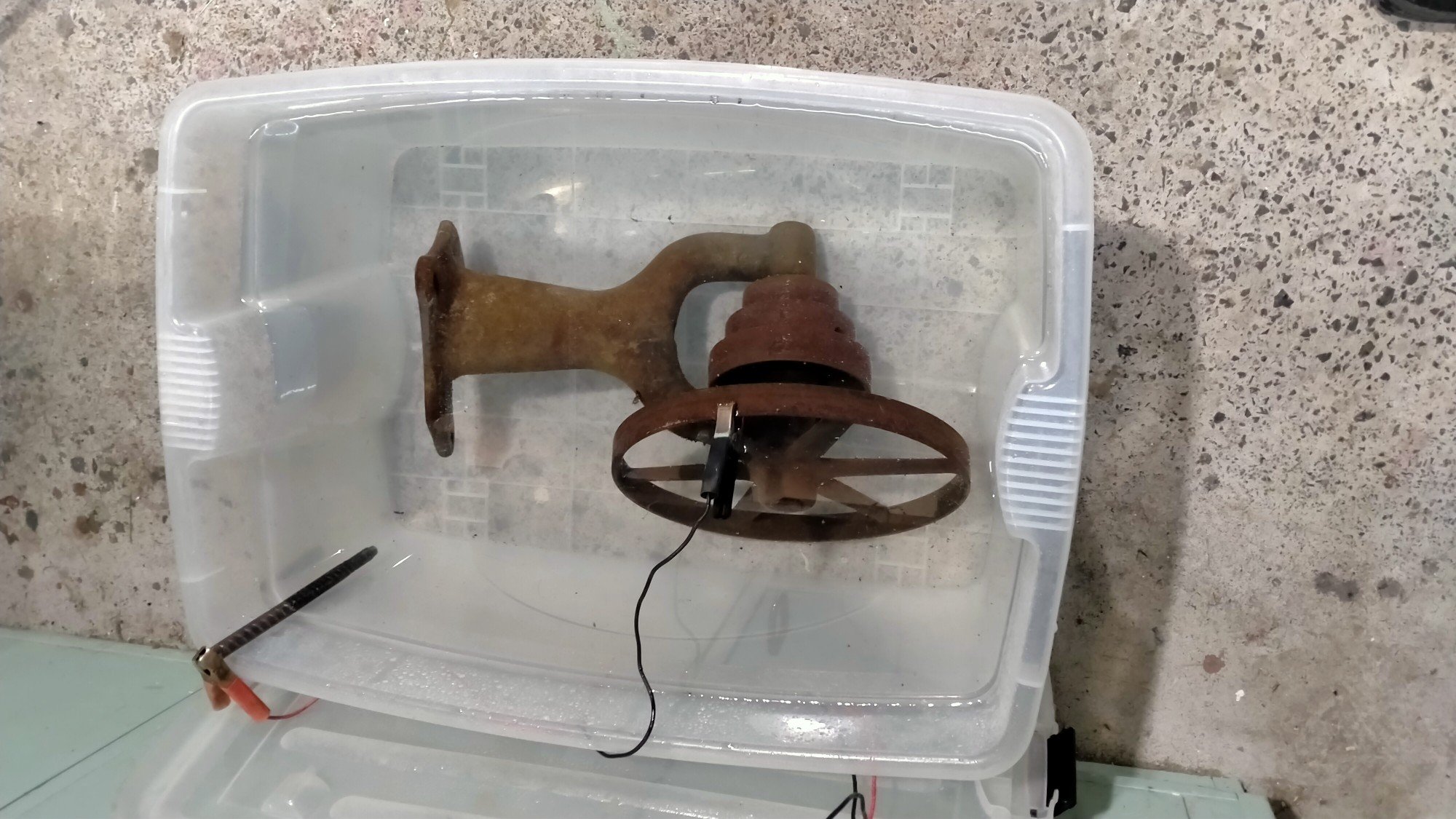

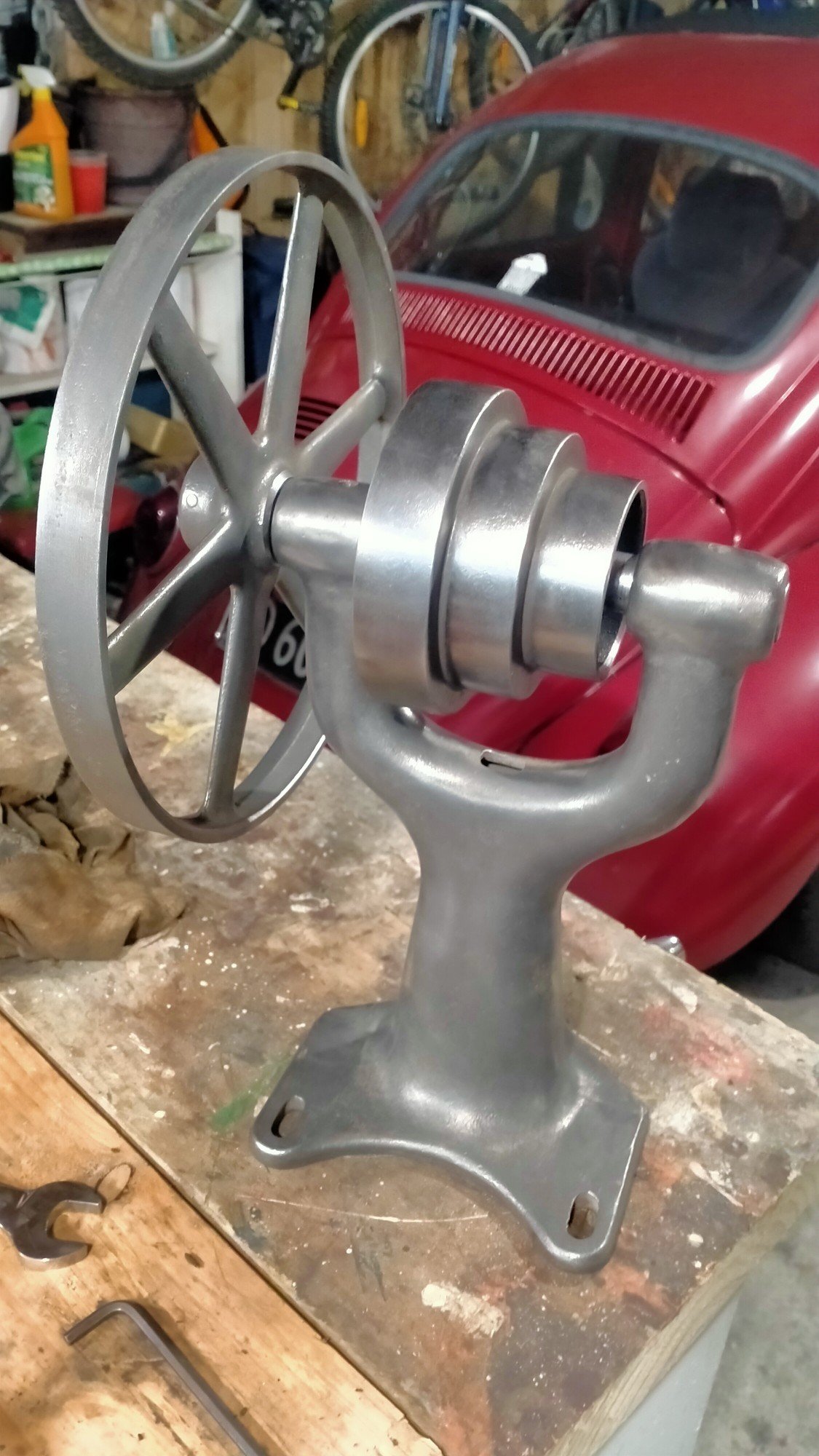

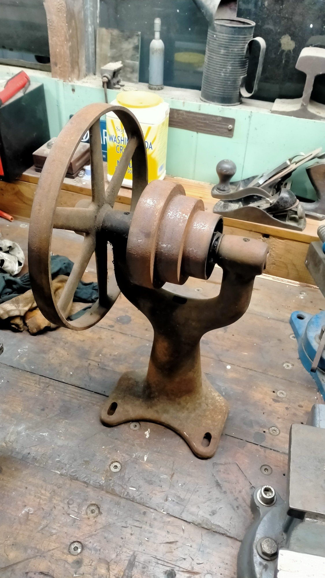

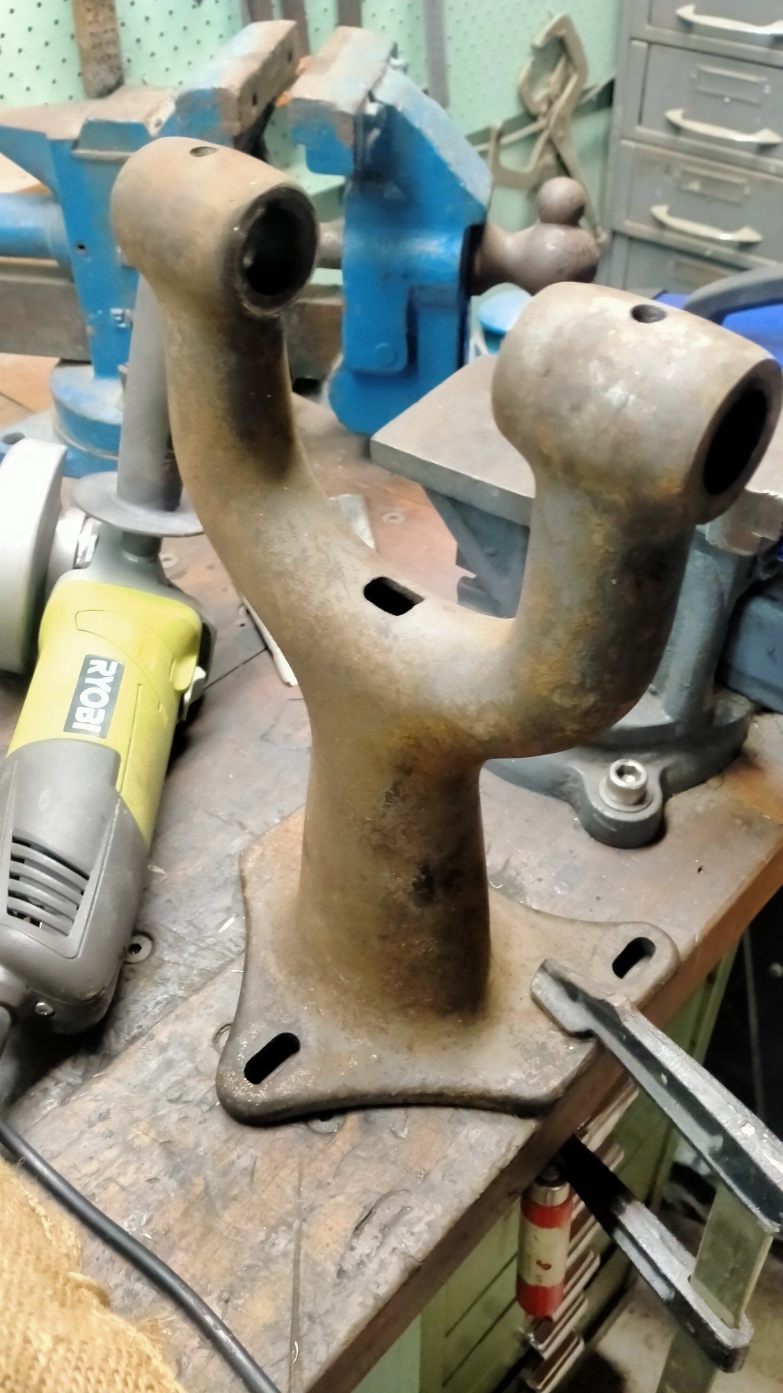

Popular Post 63Ragtop Posted June 17, 2024 Popular Post Posted June 17, 2024 Did some more electrolysis over the weekend, thought I'd pop it in this thread. One very old dirty greasy and rusty thing. Filled up the tub and then realised I should move it outside for the weekend, 60ltrs=60kgs! Looked like this after it's 48plus hour bath And shiny and chrome after a quick wire wheel, until I paint most of it tonight. 24 Quote

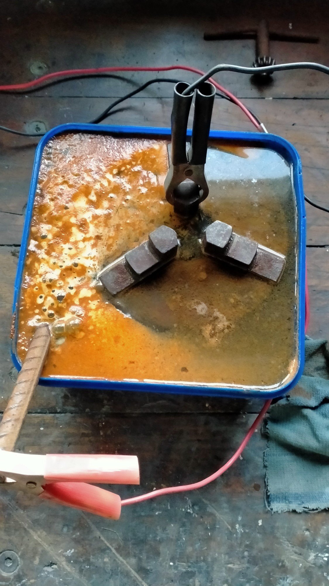

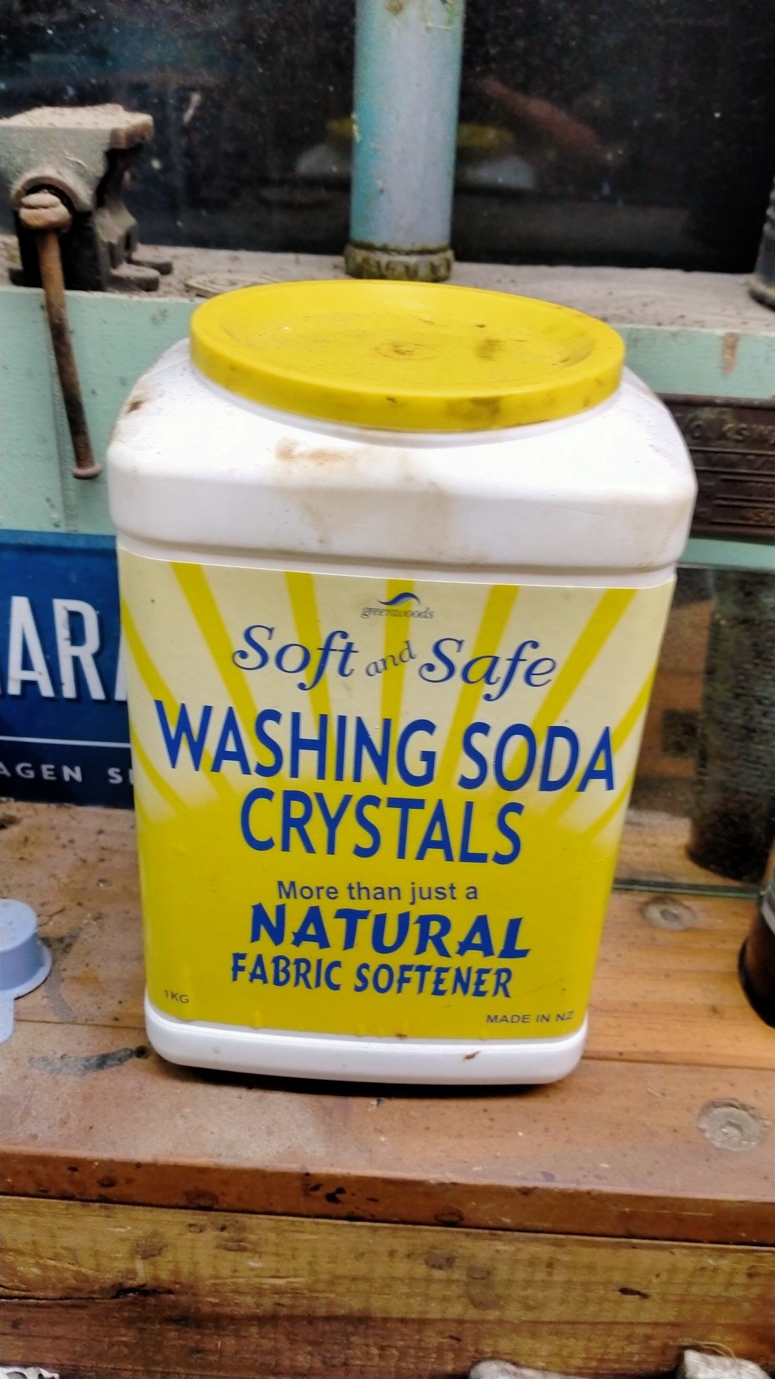

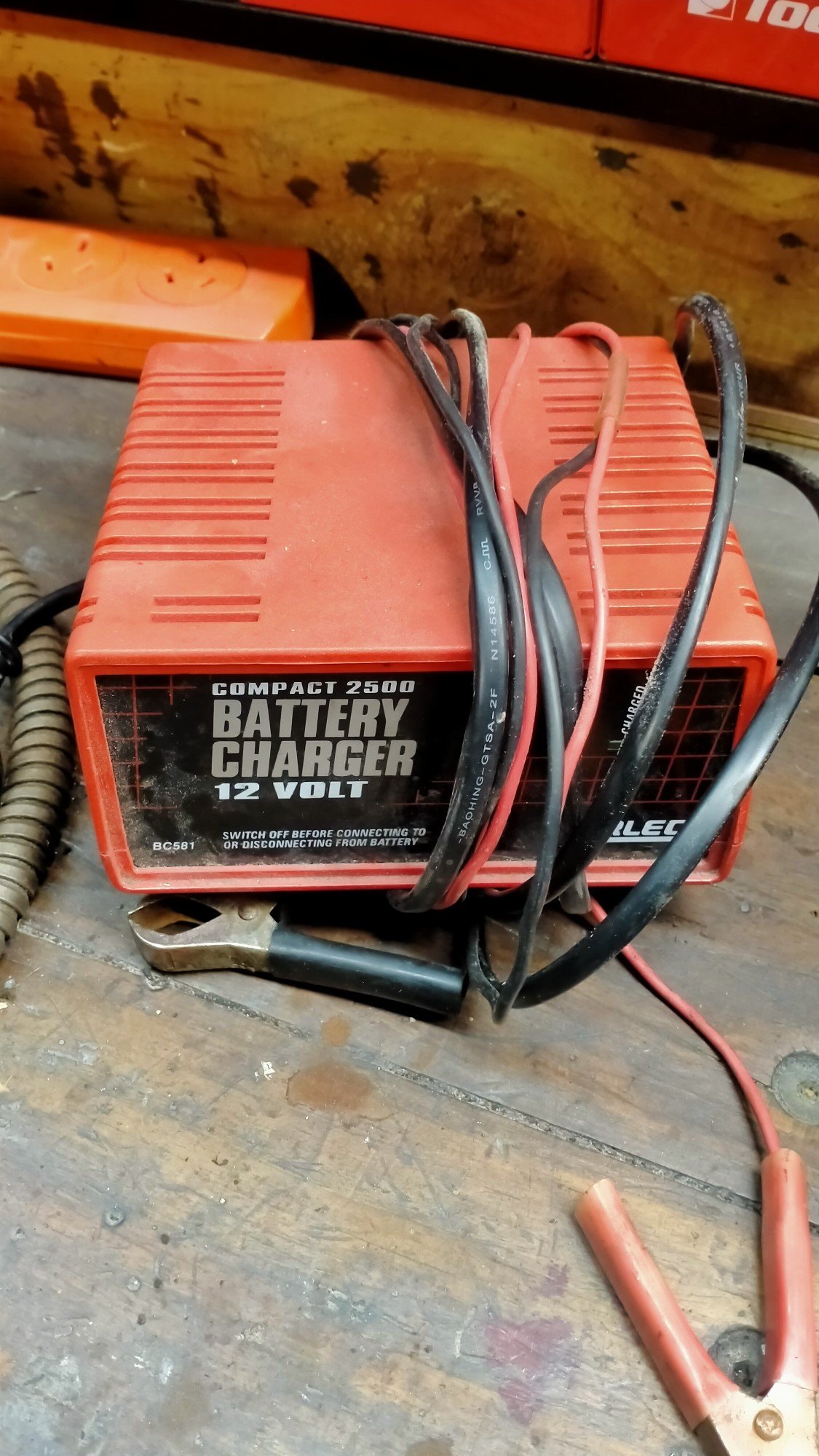

h4nd Posted June 17, 2024 Author Posted June 17, 2024 Neat! What's your electrolysis setup, pls? (Volts, solution, electrode, resulting amps?). TiA 2 Quote
63Ragtop Posted June 17, 2024 Posted June 17, 2024 Yeah it's quite effective as long as you're not in a rush. I dessove sodium carbonate, this stuff in the water to raise the ph. And just run this thing through the part and an old bit of rebar. This was the lathe chuck half way through, was quite a jump up to the 60ltrs. Didn't fizz as hard which is why I left it all night. 3 1 Quote
nzstato Posted June 17, 2024 Posted June 17, 2024 It’s a fun bit of electrochemistry just don’t be smoking or making sparks around the bubbles….. 2 Quote
63Ragtop Posted June 17, 2024 Posted June 17, 2024 Which is why I moved the big tub outside, I had visions of me walking out in the morning, pushing the door remote and sparking up a shed full of hydrogen! 4 Quote
