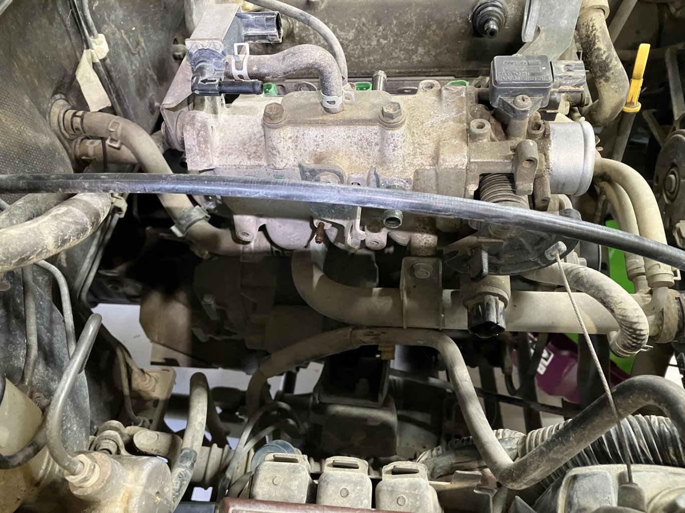

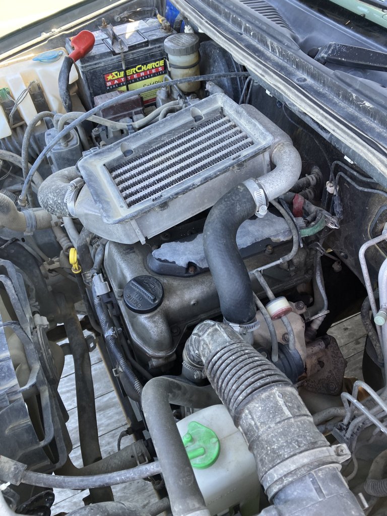

Part 2 of this update. So while running it in and driving around the block a few times (*filmed on a closed road), I was only using light throttle and not really letting it come on boost. But then bad things happened. As soon you as you gave it more than about 1/3 throttle it made unhappy noises from the turbo and it seemed really flat, like the turbo wasn't spooling as it should, or something was leaking. Back to the workshop to check over all the hoses, lines, etc. Nothing obvious. The engine itself is running sweet, idling nicely, cruising nicely on the road. So today I took the front intake off the turbo, compressor wheel was spinning fine (didn't look at exhaust side - so I'm assuming that is spinning too). Didn't have the necessary diagnostic equipment (a boost gauge and some tee pieces to see what the boost was doing) so just fiddled with it. No progress, so took it for another road test and came back to a lot of green water on the outside of the radiator. It has split the top tank. Yay! It may have always had a split in it (hence original BHG). Then I decided to go down a rabbit hole with on-board diagnostics so see if there was anything obvious with that, or to get a boost pressure reading from the ECU and sensors. This spec Jimny has an OBDII style connector port on it, so I mucked around with an old Android tablet and a China special ELM327 OBD dongle to get that going - except, this era of Jimny doesn't run OBDII, it has some proprietary protocol and you need an app called SZ Viewer to see it. It would connect poorly, and the info on screen didn't give me what I wanted. The scan refresh time was very poor and so after much mucking around, I gave up on that idea and went inside. -

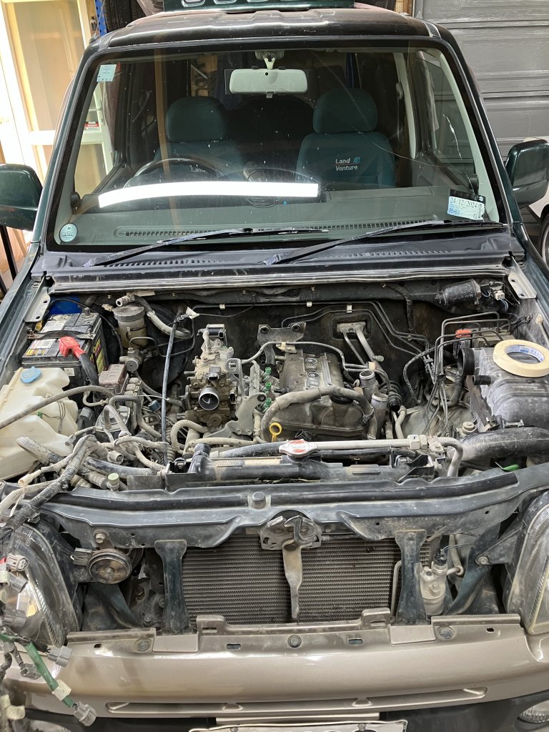

So, some progress so @johnnyfive is kept happy. For some reason I lost about 6 months worth of photos off my phone when it got upgraded by work last year, so not much to show. Engine came out Jan 2025 and it sat in my workshop for a few months because the engine rebuilder was a bit busy with summer race and speedway season and more important customers blowing their engines up. I took it in about March to get stripped down and rebuilt. While I was waiting for the engine rebuilder, I acquired all the bits I thought I needed. The K6A motor is very easy to get parts for off eBay, Amayama, etc. Stripped down, it had a bent rod, not sure how, maybe when it BHG'd or hydrolocked. I managed to find one single NOS OEM spec rod on eBay in the USA of all places (Ohio I think). It got rebuilt, and I brought it home again in about August from memory and promptly put it in the corner for when I was 'less busy'. Fast forward to October and I thought I should do something about it. Step 1 - clean engine bay before reinstallation. Step 2 - invite a mate over to assist with reinstallation. Make sure to put the engine and gearbox in and out of the car at least 3 times while you try to make the input shaft and clutch disc engage properly which you should have mocked up on the floor first. Nothing a flap wheel on the die grinder couldn't resolve. Step 3 - wait for at least 4 months, then plumb up and wire up everything that's left. Order some new drive belts locally, and new injectors off Aliexpress. Step 5 - fire it up, figure out why its running on only 2 cylinders - muck around with coils, etc and then it will run properly. Smoke out the workshop and driveway while it runs in. Road test with no bonnet, then reinstall bonnet. Step 6 - Apply Suzuki specific high-performance sticker acquired in Japan.- 9 replies

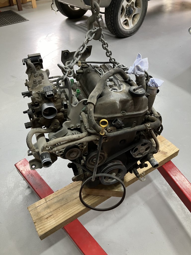

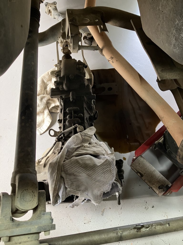

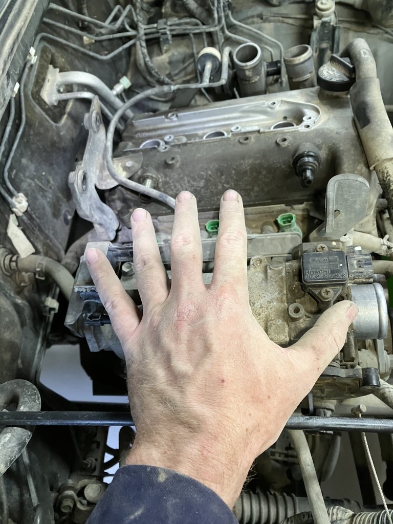

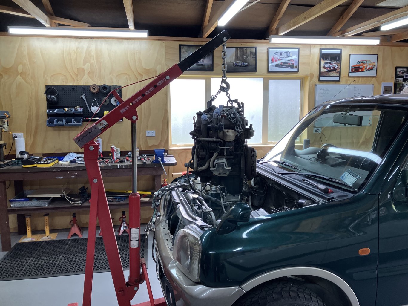

Having finished putting a new carpet in the white Viva, I could turn my attention back to this and get the engine out. I could have tackled the head gasket in-situ but decided to pull the whole lot out and see what else needed doing. Something was up with the oil as well, very fuelly smelling and higher than standard volume in the sump. Must have got a good dose of petrol through it - maybe a sticky/leaky injector? Interesting they run a single supply to the fuel rail with no return line so wonder if it has residual pressure which leaks via the injectors? Everything was easy enough to work on, the extra height made it easier on my back leaning in to disconnect everything, and didn’t need to jack it up to get underneath. Most of the heavy electrical stuff like alternator and starter was under the intake manifold and quite space constrained - even a 3/8” ratchet was a bit big - my hand can span the whole plenum for scale reference… Got everything disconnected and out it came - of course I always forget to unbolt the lower flywheel cover plate when splitting an engine and gearbox so a couple of 10mm bolts needed last minute attention, no wires or hoses though! I also dropped the gearbox out as well, decided to drop that out the bottom and risked it by not draining the oil out first. Well it got me… a small lake of delicious smelling gearbag oil needed mopping up (how good are painted floors!). Engine out, mess all cleaned up. Will strip it down at some stage and see what’s wrong with it.- 9 replies

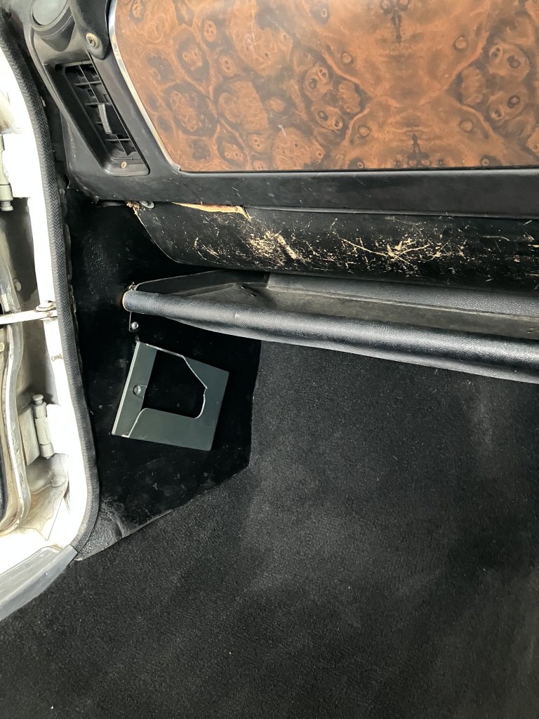

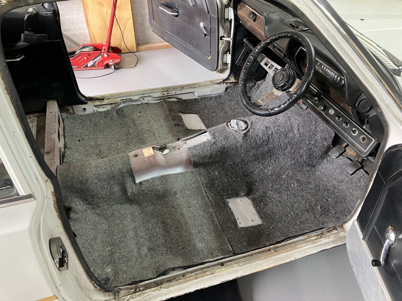

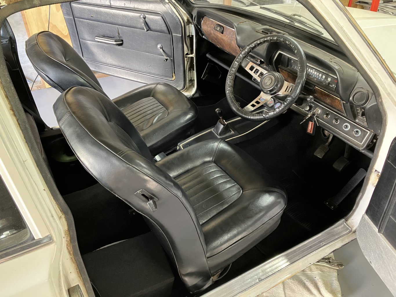

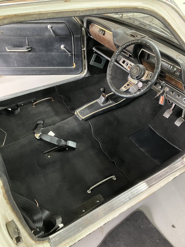

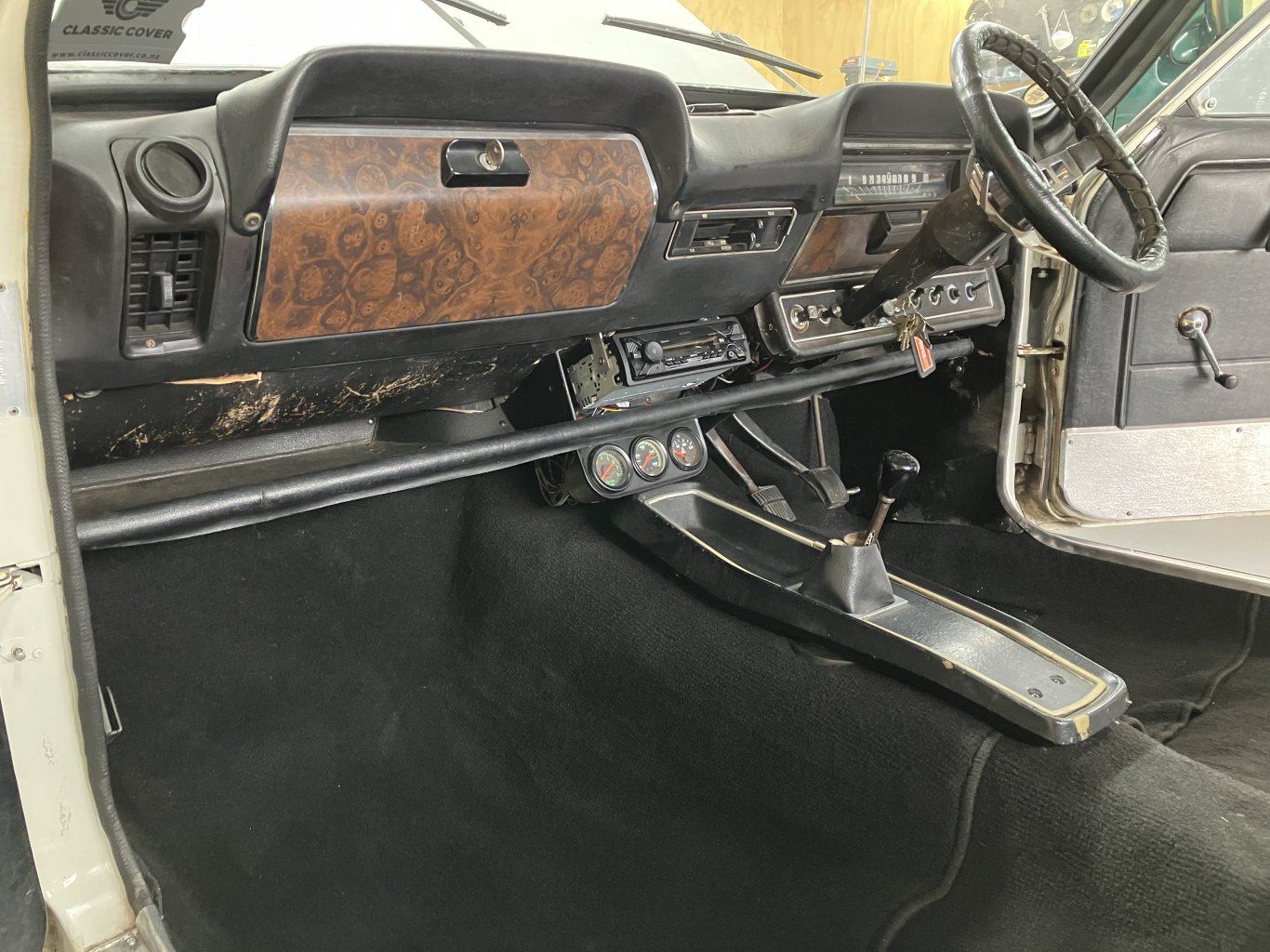

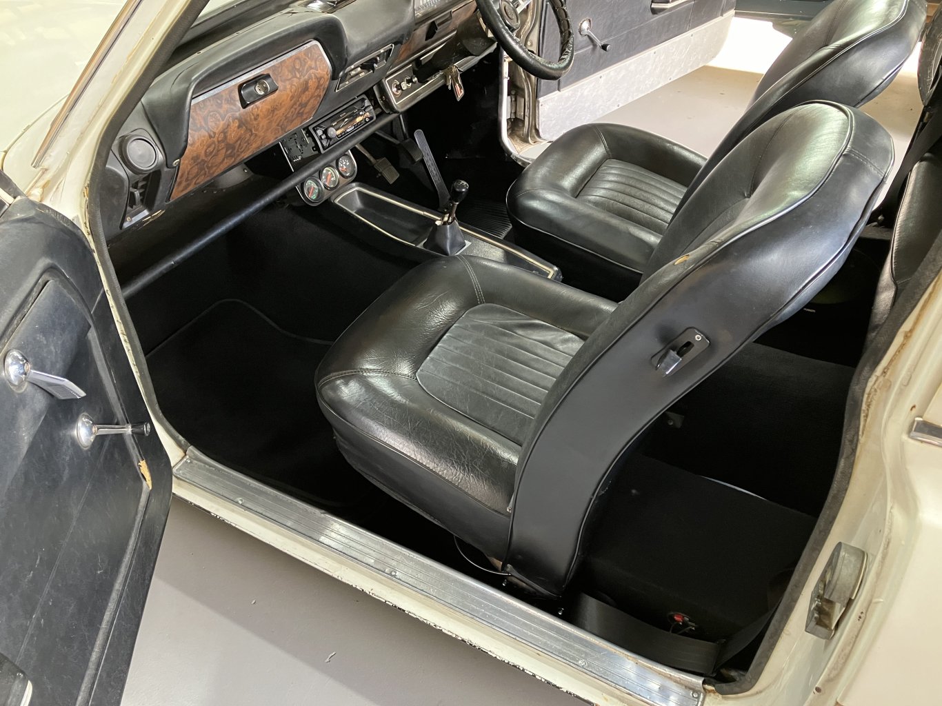

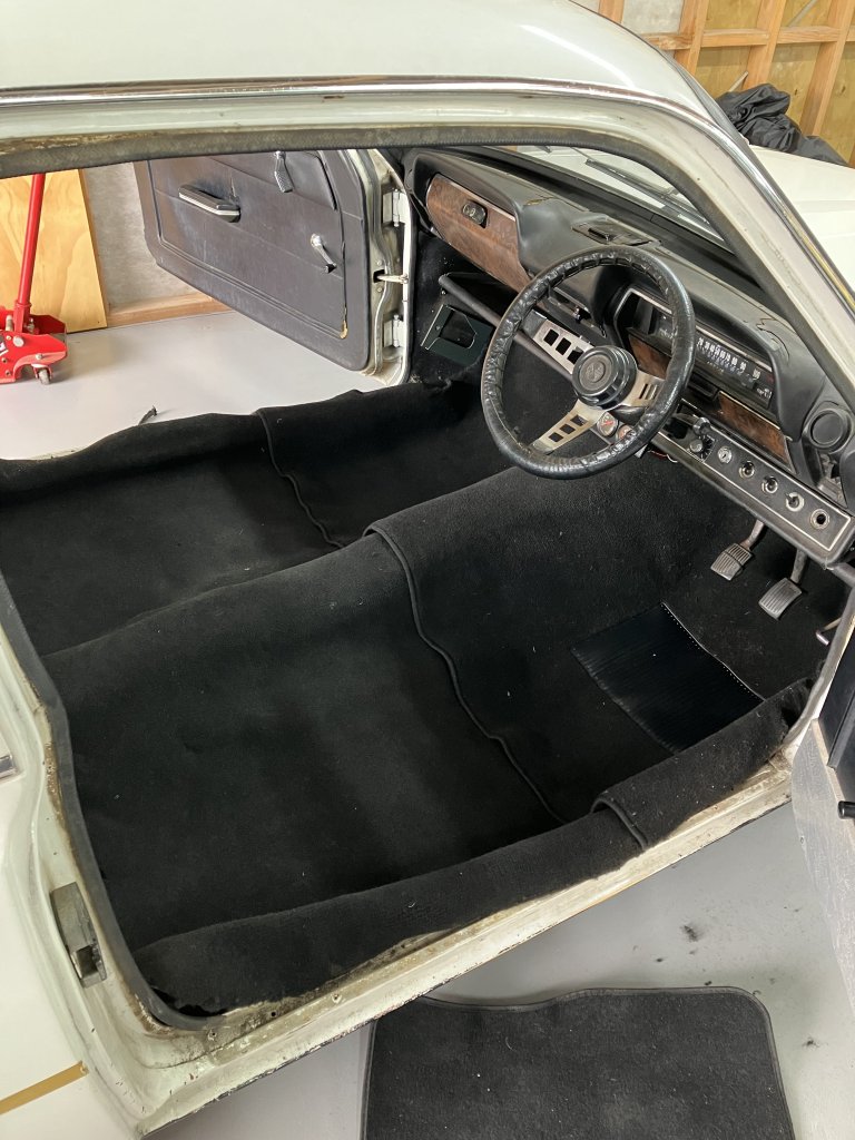

So the Christmas period got in the way of progress on this, but finished up most of it today. Prepped and painted patches of the floor pan which had old surface corrosion and then installed some underlay. Probably should have put down some Dynamat or Kilmat or similar. But didn’t. A bit of fine tuning of the carpet and got the rear section all fitted up nicely. The handbrake boot was attached to the old carpet so I’ll have to get an aftermarket one - can buy online when it’s not a holiday closedown period. I then removed the lower dash and kick panels to get the front fitment sorted. Also took the opportunity to tidy up a whole lot of dodgy and untidy stereo and gauge wiring from various past owners and myself. I also painted the kick panels but they are very worn and really need replacement. They are 2mm board, so not sure where to find that. Also in hindsight should have removed and painted the board under the top portion, it looks crap now. Got it all refitted and fixed up the edges and other fittings. Getting all the holes lined up and bolts/screws is a bit of a muck around… mostly a scriber poked up from below got the location sorted. Seats back in, and pretty much done. It took a bit more effort than originally thought, but came up pretty good and I used the opportunity to fix up other bits as I went. Not a bad way to spend a few days over the holiday break. I will order a handbrake boot and some new windlace to go around the doors. Then it’s fully done. Check back in 4 years for the next update!- 22 replies

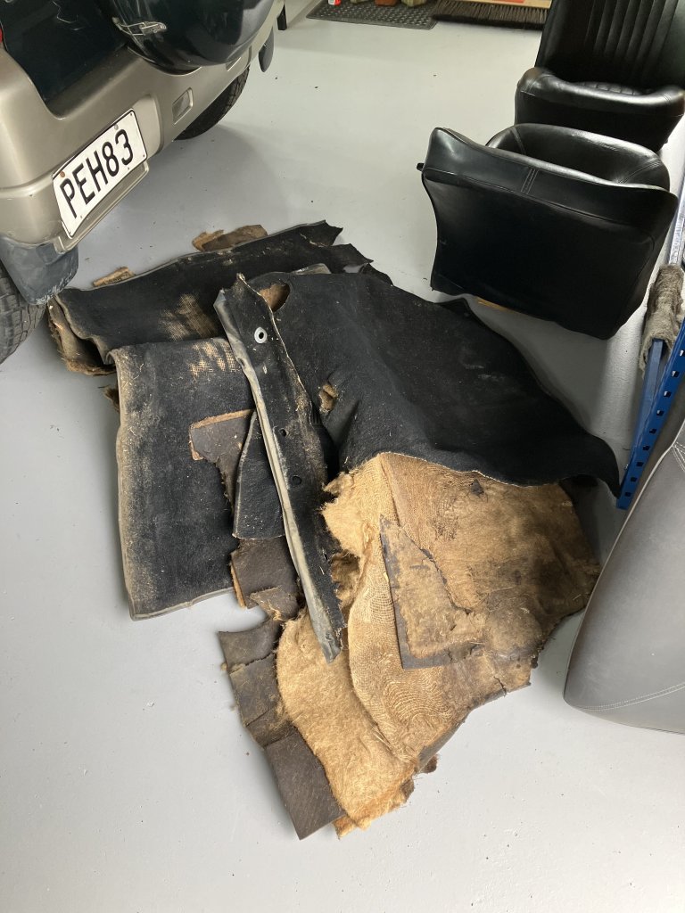

Oh yeah and a big pile of old carpet and lots and lots of underlay. So much dust and fibres, I’ll probably get some lung disease from it.- 22 replies

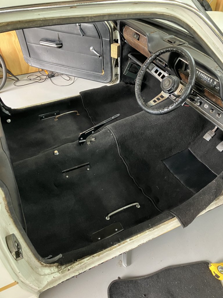

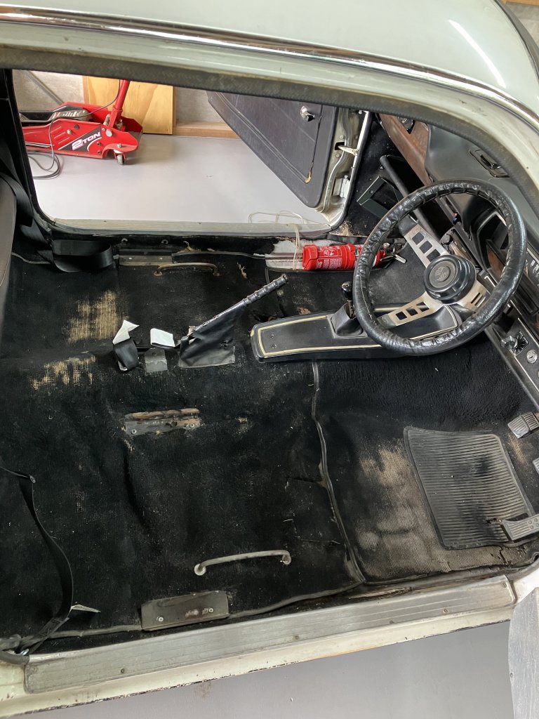

So yeah. I still have this and haven’t done anything of significance to it since my last post. I did convert the old generator to an alternator a couple of years ago. That’s about it. One job I’ve always been meaning to do is replace the carpet. It is threadbare, and the sides are worn so you can see the floor pan. I bought a moulded set from Knox Carpets in Australia because it’s the same floor pan as HB, LC and LJ Torana. It was also a very good price compared to sets available locally. It arrived just in time for a summer holiday project. Remove interior, remove carpet. It’s pretty grot. Cleaned up the floor pan a bit, and then did some test fits of the new pieces. Will need a bit of trimming and fine adjustment, but not bad really. Treated some surface corrosion where some damp underlay must have been sitting, and will throw a bit of paint on before fitting the carpets properly. Then a whole lot of faffing about to get all the holes in the right places.- 22 replies
