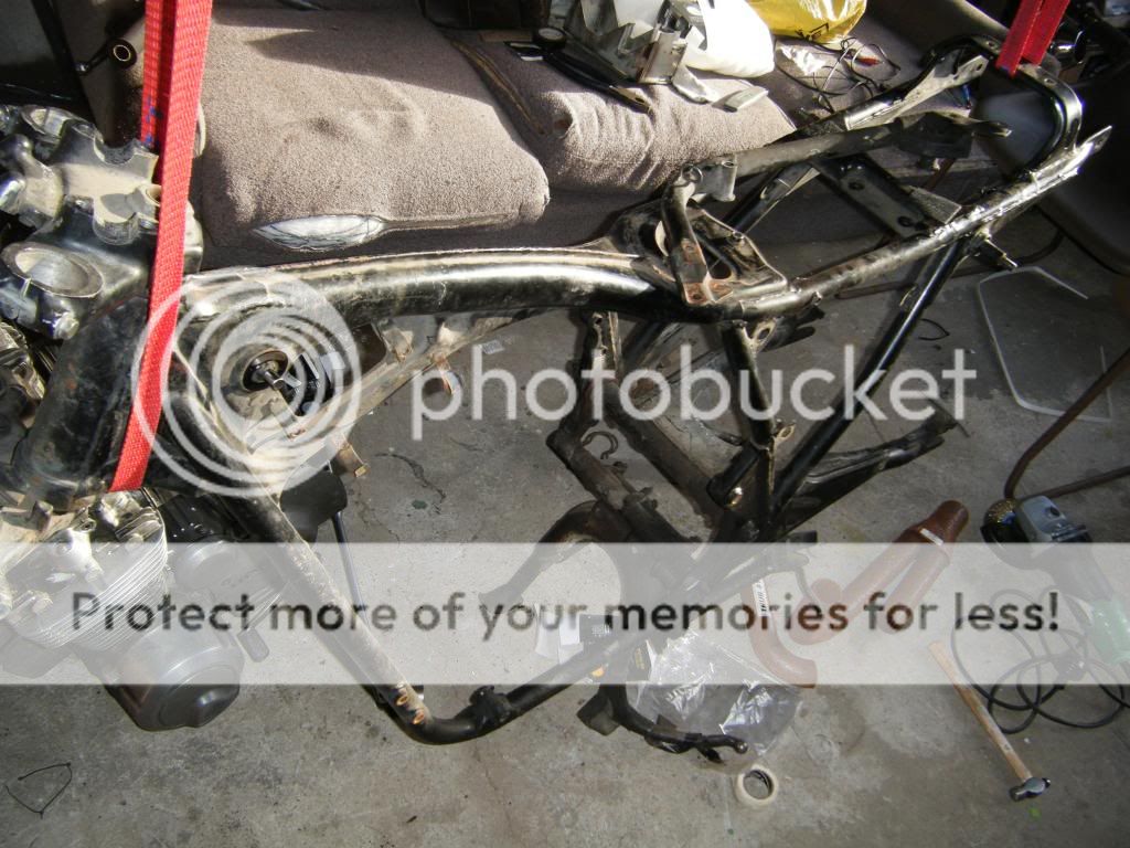

anglia4 Posted January 15, 2013 Author Posted January 15, 2013 I had been planning to cut off those old rear peg mounts, but looking at that photo, the return spring for the brake attaches to them, I think the boss for the brake lever pivot is also through it... Any ideas what to do there? Quote
ThePog Posted January 16, 2013 Posted January 16, 2013 Cut them off anyway, brakes are for hipsters Quote
anglia4 Posted January 17, 2013 Author Posted January 17, 2013 I got a bit carried away in the shed tonight. The CB is now stripped back to a bare frame :0 I'll do the cutting and welding on the frame this weekend and buff all the old paint off. That way it should be pretty close to ready to go away somewhere to paint early next week. I really need to find a solution to the rear brake return spring mounting. I want to cut off the passenger mounts this weekend but can't think of a solution yet Quote
kicker Posted January 17, 2013 Posted January 17, 2013 You could try fitting a torsion spring i.e. one of these Here's one on my rearsets Quote
anglia4 Posted January 17, 2013 Author Posted January 17, 2013 Thats the kind of next level thinking I was hoping for My mind was stuck on tension springs for some reason... was even thinking of making it cable actuated to incorporate a spring on that. Will look at doing a torsion spring tonight and then cut that fucker off! Quote

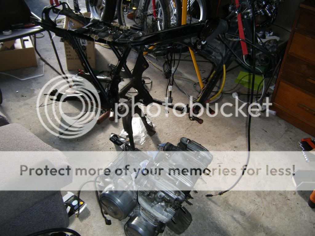

anglia4 Posted January 17, 2013 Author Posted January 17, 2013 Current state of play: Just ordered Jets for the pods and a brake caliper kit. Quote

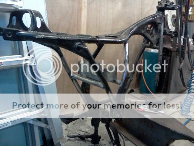

anglia4 Posted January 19, 2013 Author Posted January 19, 2013 Took the frame to work today and got one of the welders to fizz the battery box mounts on. He did a really nice job of it, stoked. Then I went mad with my grinder and made some irreversible changes. It is now a single seater forever, and it will never wear CB650 side covers again. Quote

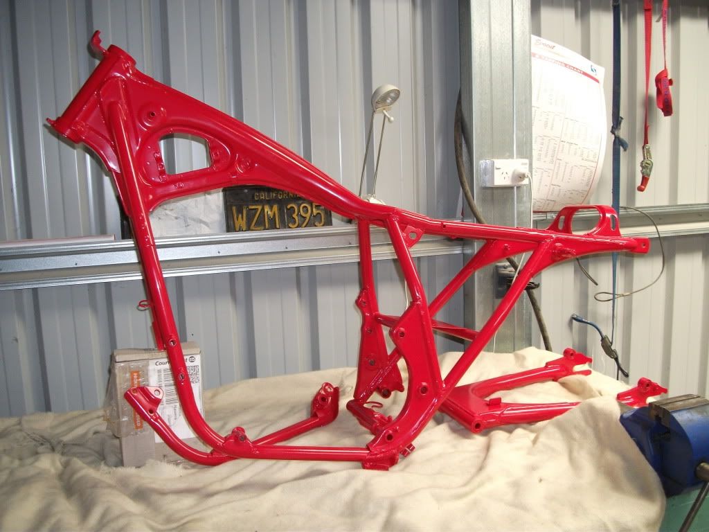

anglia4 Posted January 23, 2013 Author Posted January 23, 2013 I've got almost a whole CB650 in the boot of my Corolla at the moment haha. The frame is going to the powder-coaters this afternoon where it will be blasted and then coated in bright red. The engine is going to my parents where I can de-grease and clean it ready to take apart, do the leaky gaskets, make a few inspections etc and then paint it in black crinkle with polished fins Got plenty of painting to do in the near future! Quote
Duke Blackwood Posted February 3, 2013 Posted February 3, 2013 Behold the majesty... Anglia4's frame is back from the powder coater's and currently residing in The Blackwood Stable It looks really good, it will be a completely different bike after re-assembly. Battery box mounting platform and no sign of all the old side cover tabs Red bikes go fast, it's just science. Quote
