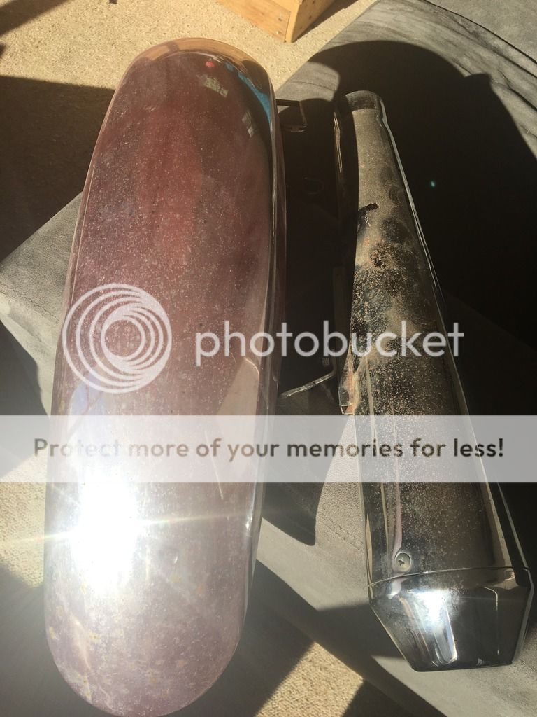

Poor old thing has been gathering dust for a while, the chrome on the guard and pipe is looking a bit sad so I'll take it to work and see if one of the SS polishers can give it a tickle.
