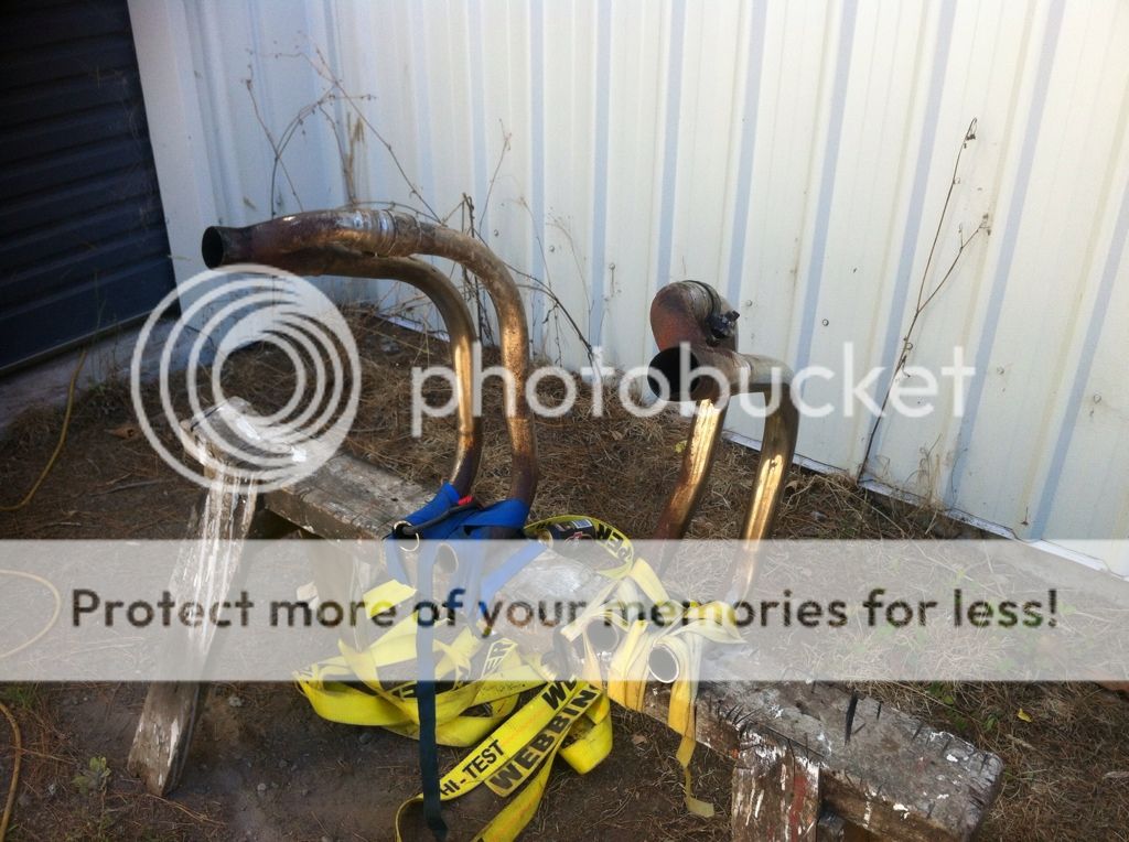

anglia4 Posted February 24, 2013 Author Posted February 24, 2013 Jigged up my exhausts on a sawhorse to make some mufflers had something to drink and then considered them muffled finger in photo fail... oops 1 Quote

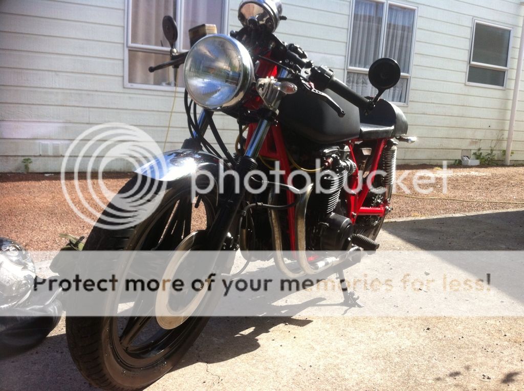

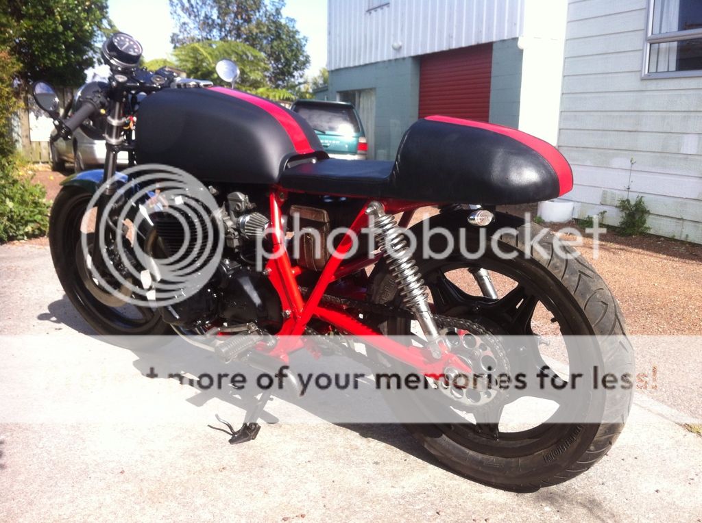

anglia4 Posted March 1, 2013 Author Posted March 1, 2013 Well its been a huge couple of days... Spent something like 12 or so hours in the shed yesterday with dad trying to get it ready for the poker run on the bikes blues and hot cars festival today. Got it close to going, just a few things to finish off this morning, couldn't get the new brake master cylinder to bleed up properly, think it might be the wrong size bore, so went back to the original, but it doesn't seem to be working that well now either. The open pipes are awesome, not stupid loud, but plenty roudy. Still a little bit of tuning to go for the pods, its not quite there on the pilot jet or screw, will tinker with that later. Anyway, pics since its mostly finished now 2 Quote

Chris.QCR Posted March 1, 2013 Posted March 1, 2013 Looking good. Paint that front guard tho. And maybe drop the speedo a bit lower Quote
BlownCorona Posted March 1, 2013 Posted March 1, 2013 looks awesome, im thinking that front guard needs to be black aswell, and also some sort of very thin red pin strip on the side of the tank, probably around the perimeter, looks a little empty at the moment. also, still interested in selling me those old bars? Quote
BlownCorona Posted March 1, 2013 Posted March 1, 2013 also the chain tensioner is a little messy, might be oil, but i say paint it black too Quote
flyingbrick Posted March 1, 2013 Posted March 1, 2013 Man that is really fucking sweet, good work. I like the front guard the way it is- but would look good painted too. I reckon red pinstripe around each wheel rim would tie them in Quote
anglia4 Posted March 2, 2013 Author Posted March 2, 2013 I don't quite think those photos do it justice, it all seems to work well in real life The speedo is a bit high but I can't get that one any lower, it kind of gives an effect all of its own though haha and gives me something to tuck in behind for the speed record attempts Only real cosmetic change from here is the exhaust wrap which I ran out of time to do and maybe one day change the speedo. Oh and a better brake lever and braided line. I got some pins for my denim vest yesterday at the festival, but my fiance has failed wife test number 4 and has no needle and thread to stitch on my patches... Quote
