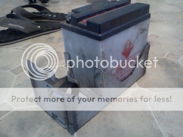

I got an old leather case from the swapmeet a few months back that I'm going to use as a battery box.

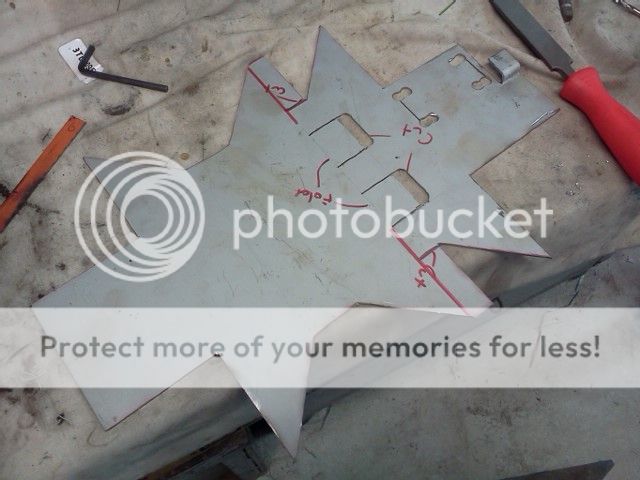

Since my fabrication skills aren't crash hot, I thought I better use the skills I do have to make it a bit easier, so I cranked up the solidworks sheet metal tool and designed a tray to go in the leather case. Folded it up today and I'm totally stoked with how it came out, fits snug as. It also has mounting tags folded into it for the indicator flasher and starter sollenoid.

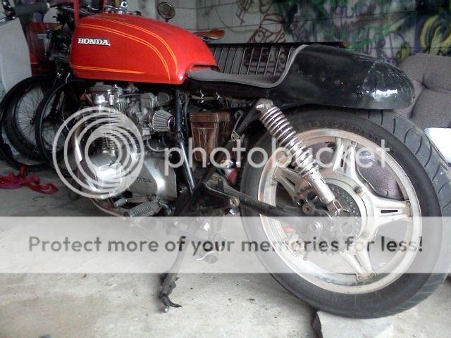

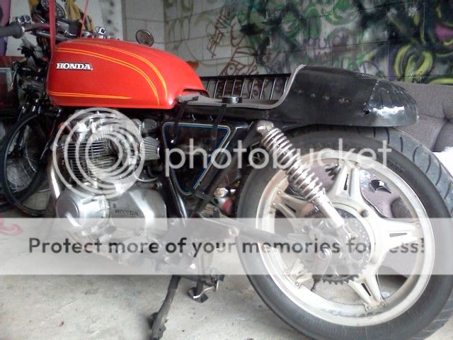

I also got some pod filters, they are a bit big but look like they should be ok.
I picked up some GS side covers a while back before I was going to use the pods. Can't decide which looks better, GS side covers or open. I like the idea of it being open but like the look of the side covers. Thoughts?

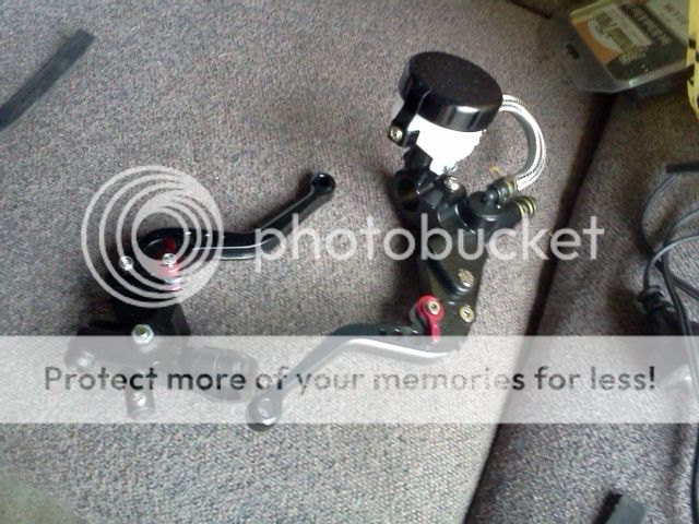

Also my new levers arrived, and once again, don't really fit nicely with my flatbars and forks. So i've ordered some clip ons and will mill the handlebar mounts off the tripple tree when I get it so I'm happy with it. That will also allow me to pull the forks through a little bit :)

Open for sure. Also giz.

All finished and welded. Proud to say, start to finish I have made that part 100% on my own.

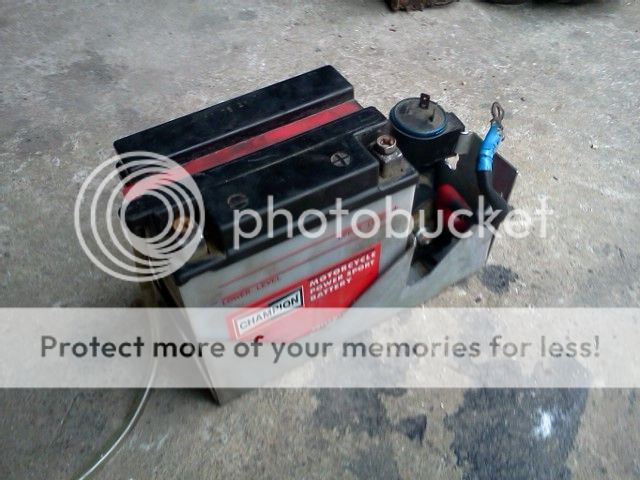

Now I just have to make the bracket on the frame for it. Have borrowed some 3/8" pipe from work to make a couple of rails to go across the frame and then will put a small platform across them to sit the battery tray/leather case on. Stay tuned while I fuck up a perfectly good CB650 frame. Not sure how yet, but I'm sure I'll fuck something up. Already have to weld up a cut where I went a little far with the grinder...
