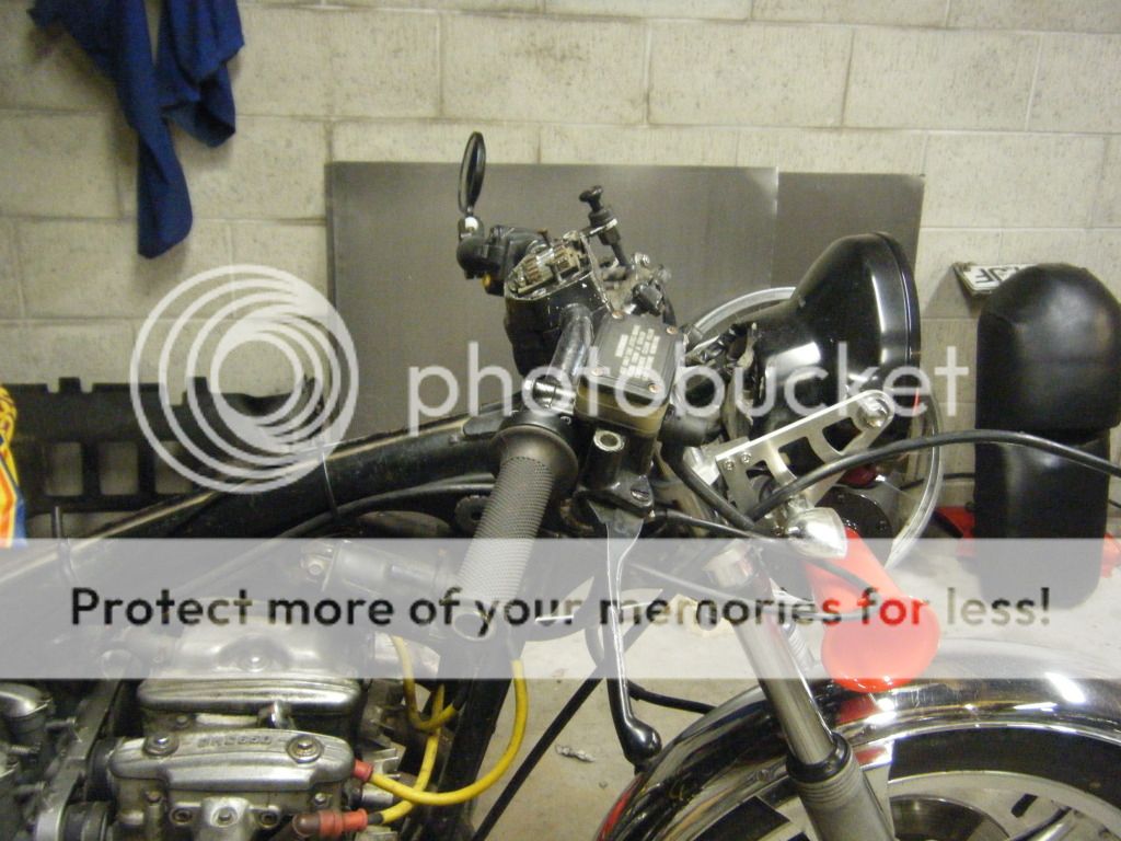

Got a present in the mail today in the form of a bare bones push pull throttle assembly :o
Bought it off ebay, wasn't quite sure what mods it would need to fit but turns out its a direct replacement for old honda's! Hopefully grant has the same luck when he goes to put his on the NV750.

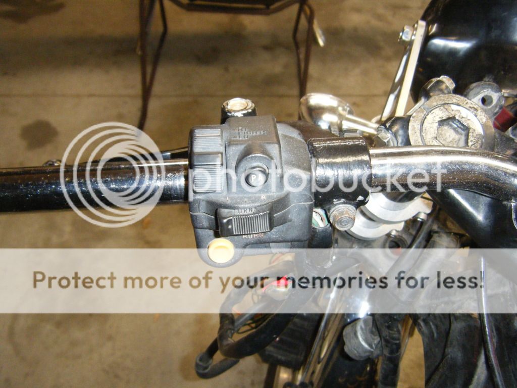

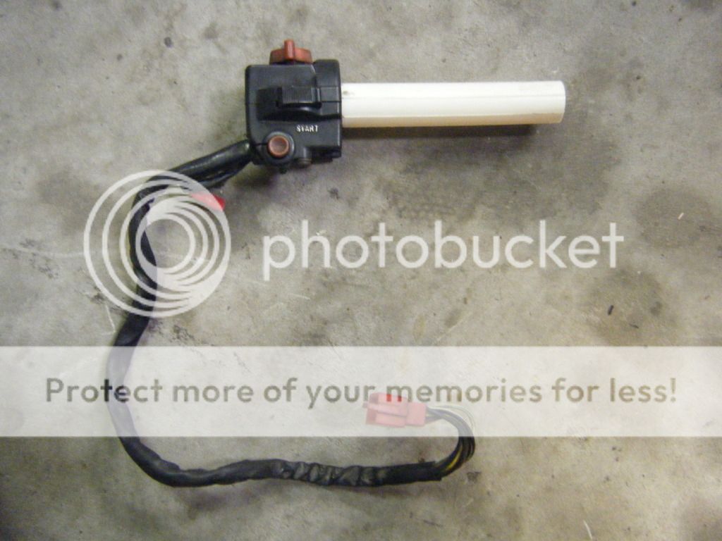

What this allows me to do is say "Fuck off" to this massive piece of shit and all its wiring:
Letting me move the master cylinder further out so I can tilt the bars down to where i want them. Stoked.
Current state of the bike:

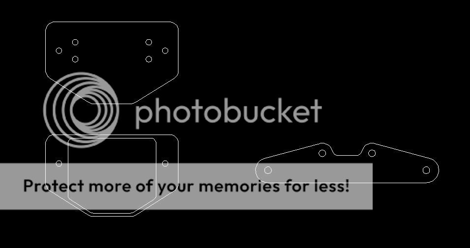

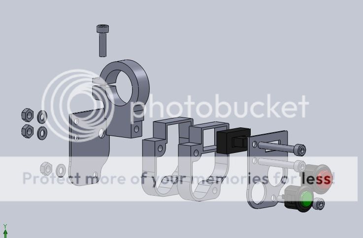

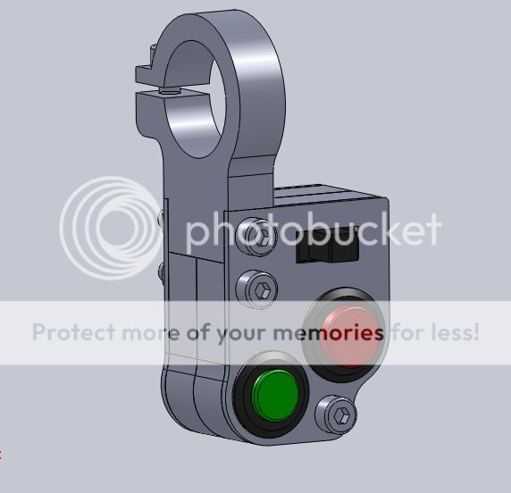

Also, drew these up last week and am going to see about getting them laser or water cut.
The two bits on the left are two aluminium parts to replace the one plastic one as the fuse box/handlebar clamp cover. The 4 holes nearer the inside are for some of these guys as idiot lights
The bit on the right is aluminium and is to mount just the original speedo without the tacho low, close to the clamp and in the center front of the bike. Should look sawheeeeet 8)
EDIT: the bit on the right is actually steel. Dunno what I was thinking when I wrote that ^

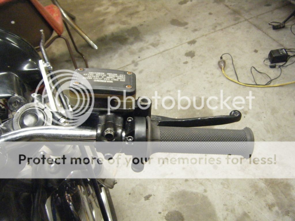

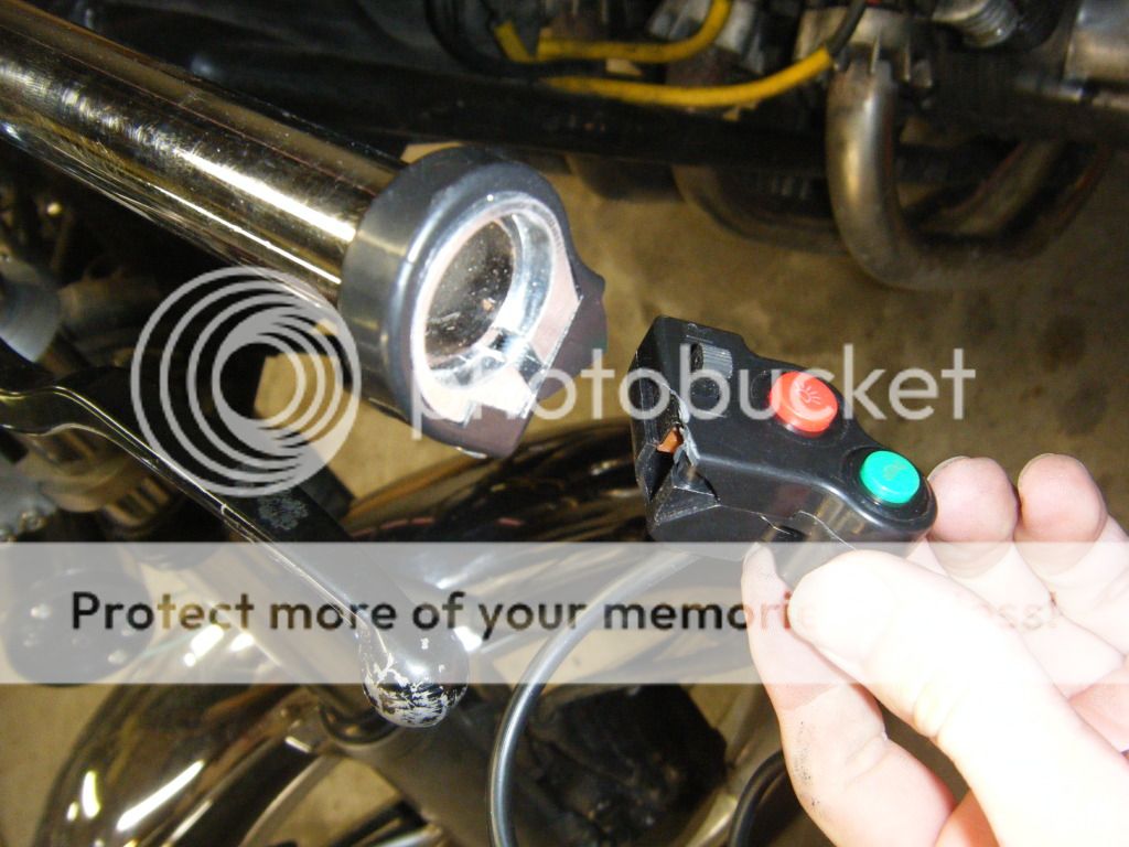

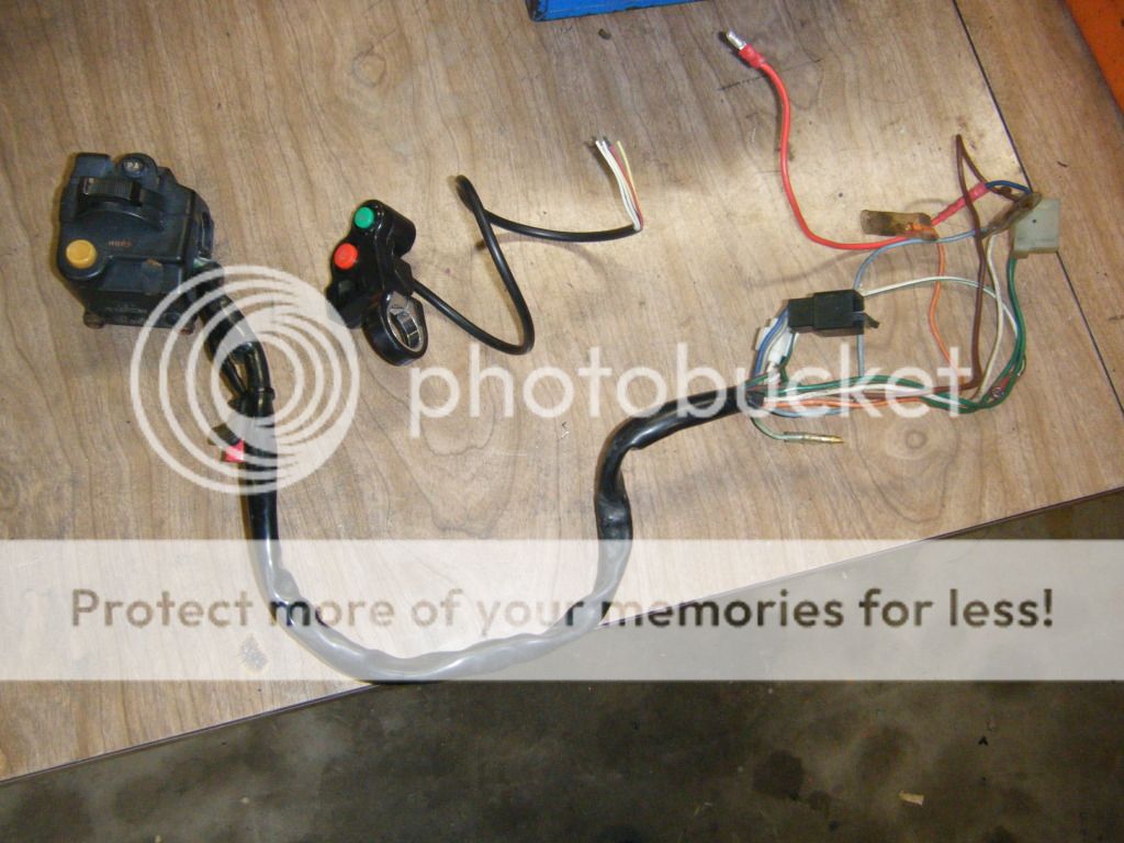

So my bike used to have this big ugly thing:

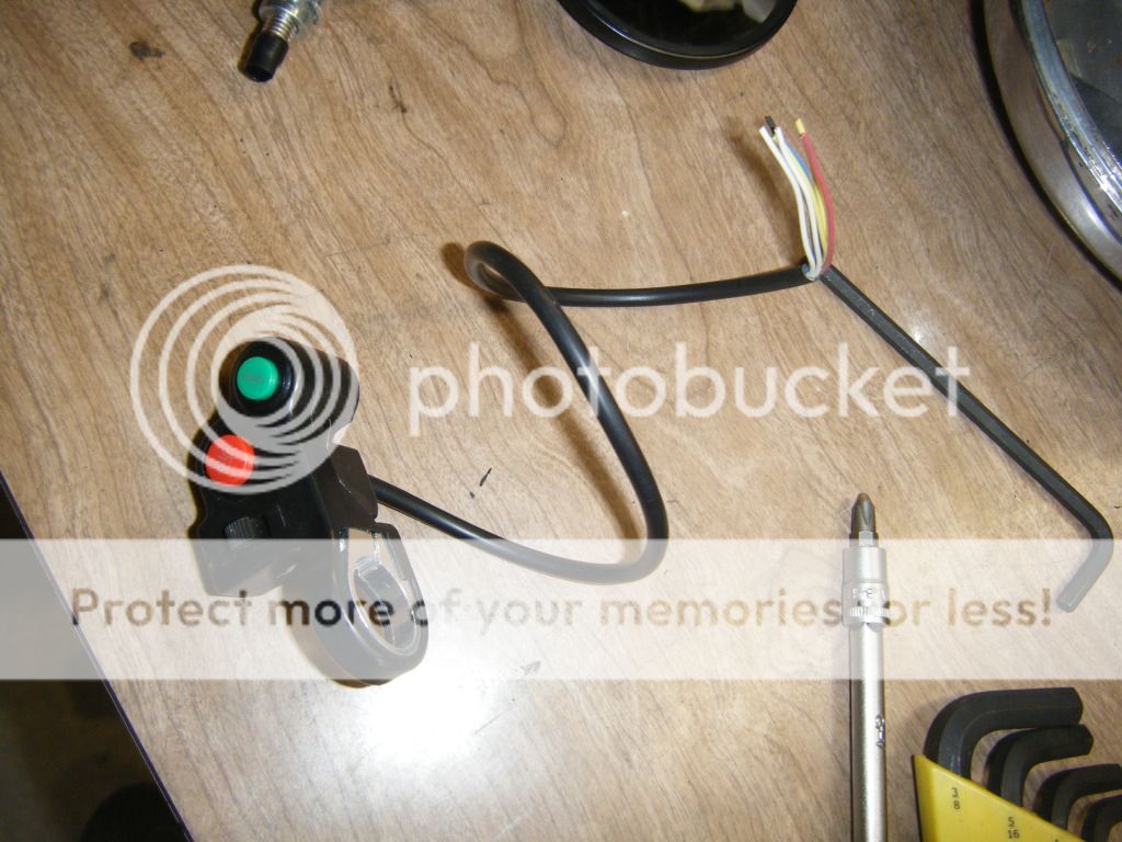

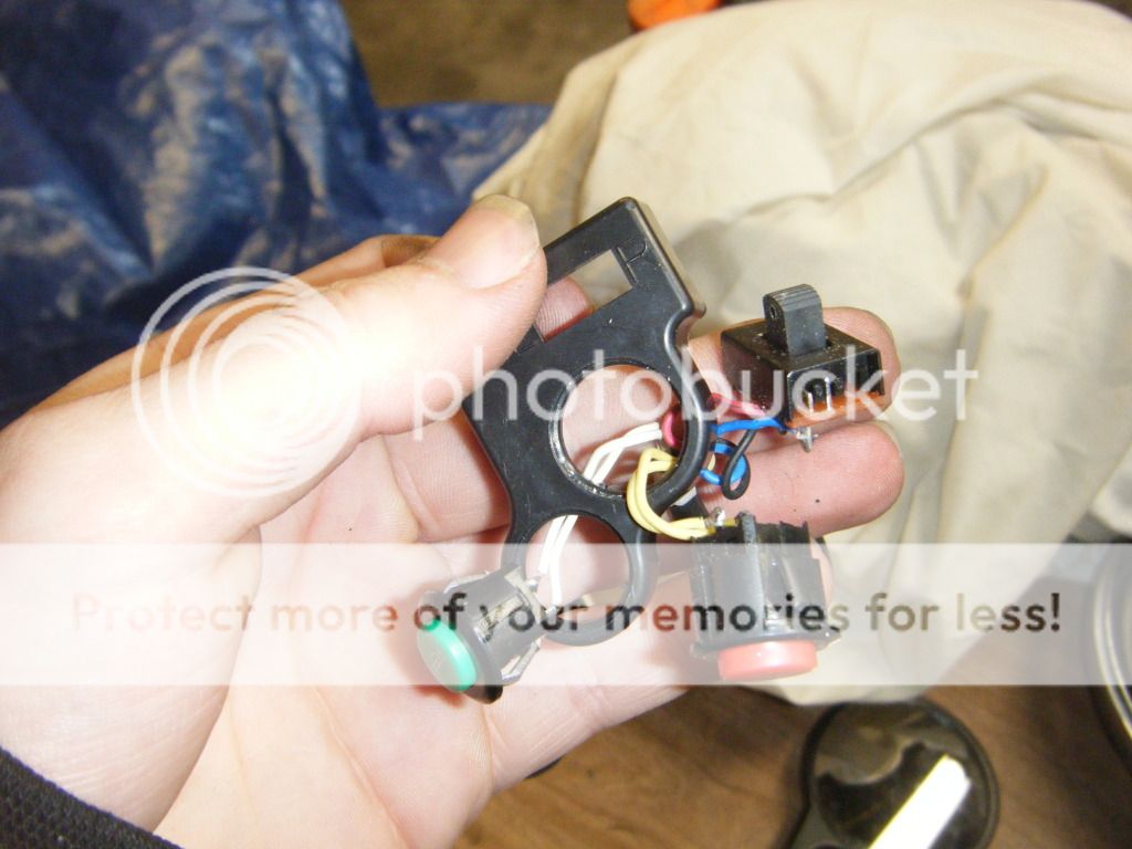

But today this arrived in the mail:
But then I did this to it:
The mark-up must have been high because I paid something like $6 for it from china and I don't quite think it was $6 worth of chinese quality. Nevertheless, now I have this:
Which is some pretty reasonable looking switches and a decent layout to work from. I'll cad something up at some stage to give the water jet man some more work :D Then I will have a sweet sweet aluminium one.

Will be 3 pieces cut from 10mm alloy and 2 pieces cut from 1.5 on the water jet machine. I will have to drill one hole and drill and tap another. Job done. (plus re-soldering the wires)
I'll use nice stainless cap screws and dome headed nuts to keep it looking sweet.
EDIT: Epoxy glue will also help keep the corners down and the indicator switch in place.
That graphic is really impressive, you've got skills man. It looks like a lot of work though just to mount some switches? You might have been better off just splashing out on a full set of more modern controls. I hope all that front end work is leading to a new master cylinder as well, the one on it is like an olympic pool.

Nah man its hardly any work.
The water jet machine will buzz out all those shapes in about 2 minutes. Then all I have to do is drill the two holes in the part that clamps to the bars (cos they are in the wrong plane for the water jet machine to get at) and bolt it together.
It is quite intricate parts to cut though, with a few piercings so I'm worried that it might be quite expensive to get cut. Will see what happens.

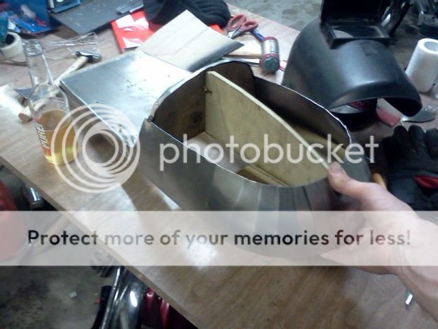

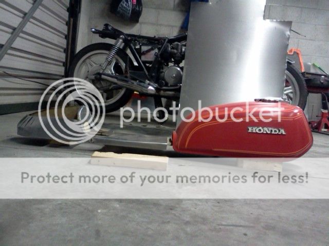

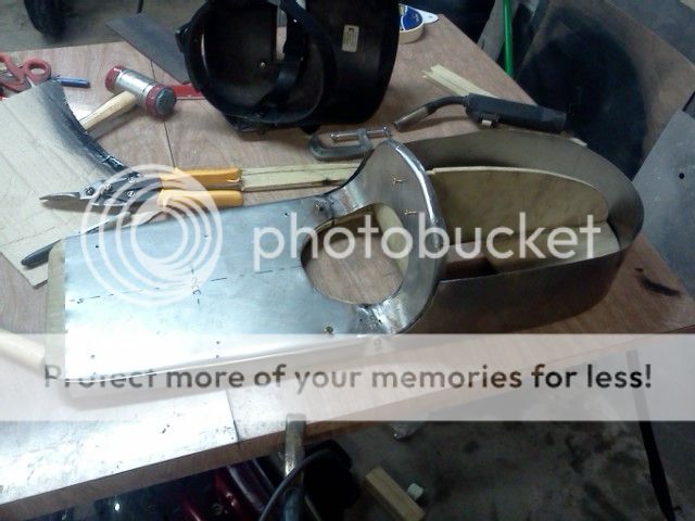

Bit more progress tonight.

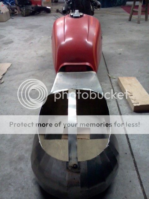

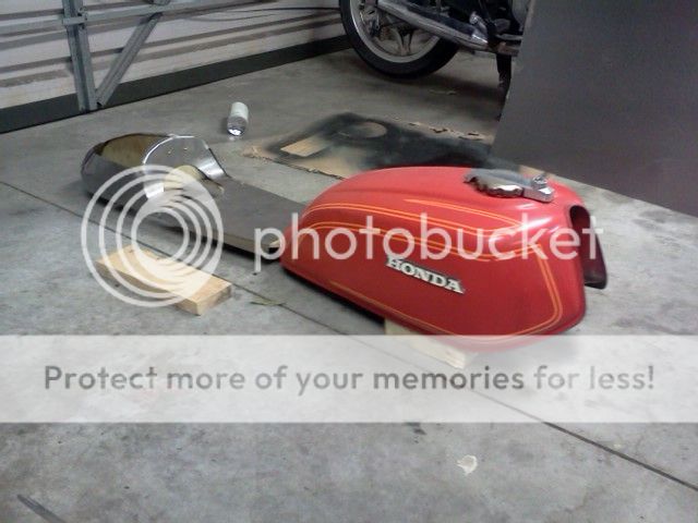

I started by cutting a big long strip and then folding 10mm over along one edge. Then wrapped it around the rear of the seat.
Then had a much around with the tin snips and it pretty much fell into place. I'm thinking I will just overlay the edges like this to make it easier to weld with my poor set-up. Still alot of shaping to go to get it to where I'm happy but thats what hammers and filler are for :lol:
Pretty happy with how its going so far though!
