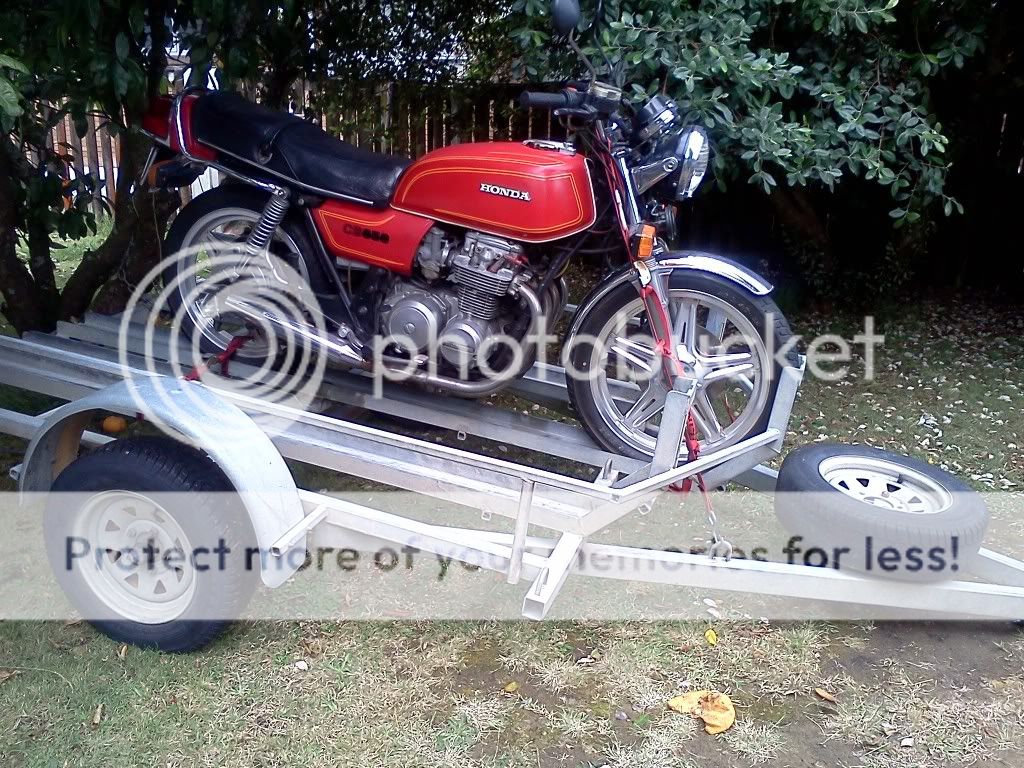

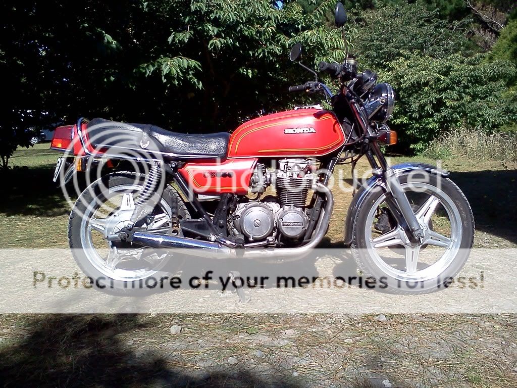

anglia4 Posted March 21, 2012 Posted March 21, 2012 I have been looking around at getting an old bike for a while now and just before christmas came across this old 1983 cb650 in vegas that I picked up for $900. Trailered it home cos the guy said it wasn't running right, seemed like it was most likely just a blocked jet as it had been sitting for a while. When I got it home I cleaned out the carbs which made it run better but it kept cutting out if you tried to go higher into the revs. I talked to the mechanics at the local honda shop and they thought it would most likely be a carb balance issue so in it went for a tune which was just meant to be a couple of hundy bucks. They rang me a day or so later and said that the ignition modules were knackered so we replaced them ~$450... Then they found it still wasn't running properly so they started messing with the carbs and found a few bad o-rings etc. In the end I picked up my bike in bits on the trailer with an $1100 bill! Since then I have rebuilt the carbs myself with all new needles, jets etc, between that and the new ignition modules it has solved the plug fouling issue that it had but it still won't rev. It rides really nice and I'm really happy with the overall condition of it otherwise though, its pretty tidy, just a few things to tidy up. Here is a few pics of the beast Out on a ride with my brother and dad My steeds I have big plans for it, the picture below is of the rough shape that I want, in paint I have dropped the bars, lowered the headlight and cluster and changed the rear end. I have already bought some rear-sets from an old GSXR which I will adapt to the CB. I want to paint it black with a white stripe or maybe a chequered white stripe down the middle of the tank and tail section. I want to come up with a really cool retro cafe-racer style logo for "Dixon Performance" to go on the spine of the tank. I'm also toying with the idea of getting a front disc set-up from a late model single disc bike and adapting it to this bike, that would allow me to have a drilled disc, modern levers and a nicer master cylinder than the monstrous thing on there at the moment. Bars will be either the flat/drag style bars or clubmans depending on how the riding position looks, gonna get some bar end mirrors and get rid of those huge indicators quick as I can If I am still enjoying it in a couple of years when I'm actually earning money and haven't sold if for a Ducati then I will invest in some wire spoked wheels for it too 1 Quote

felixx Posted March 23, 2012 Posted March 23, 2012 she looks boss. the wheels look the business. They look strong! The bike looks great, your plans look even better Quote
BlownCorona Posted March 23, 2012 Posted March 23, 2012 agree on the wheels, current ones look sweet. maybe consider hitting them with some form or black? maybe satin? Quote

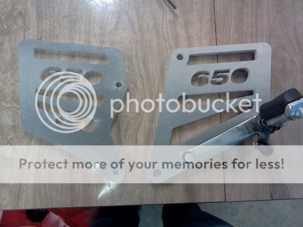

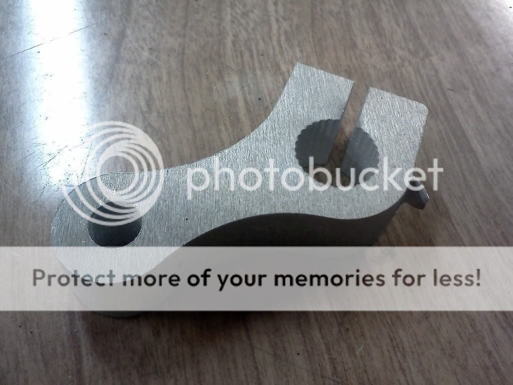

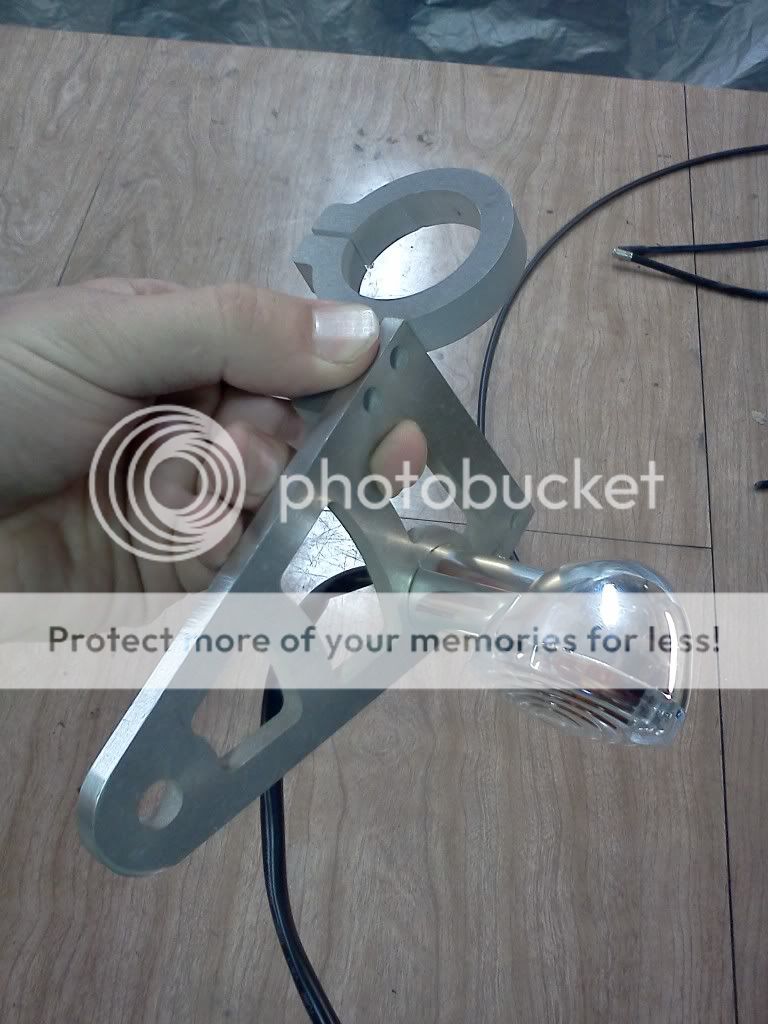

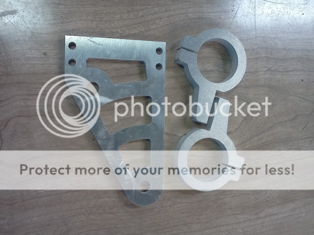

anglia4 Posted April 24, 2012 Author Posted April 24, 2012 I got some parts back from the Water Jet cutter last week: Which becomes: There is 2 clamps per side which clamp onto the forks, then the triangle part will bolt to them and become the mount for the new indicators and also the original headlight I also got me rear set mounts made up: They are a bit bigger than I had intended to make them but I was running out of time and rushed them a bit. And the gear change linkage: Can you see the spline? I've got some drilling and tapping to do to finish them all and I also have quite a bit more to make up for the rearset mounts. In other news I have got it running pretty well at the moment. The engine not revving out turned out to be pretty simple, I set the float bowl level properly and since then its been running pretty good. I rode it to Taupo from New Plymouth and it was running a bit rich and kept fouling plugs, I haven't had time to split the carbs to adjust the needle height so in the mean time I have taken off the air box cover and replaced it with duct tape with a slightly larger than standard intake hole Works sweet as! I also managed to ride it to Christchurch from New Plymouth on Sunday! Was a long way and got seriously cold south of kaikoura at about 9pm. I did notice along the way a bit of a missfire , seemed like an electrical miss so I think I might replace the spark plug leads soon. Quote

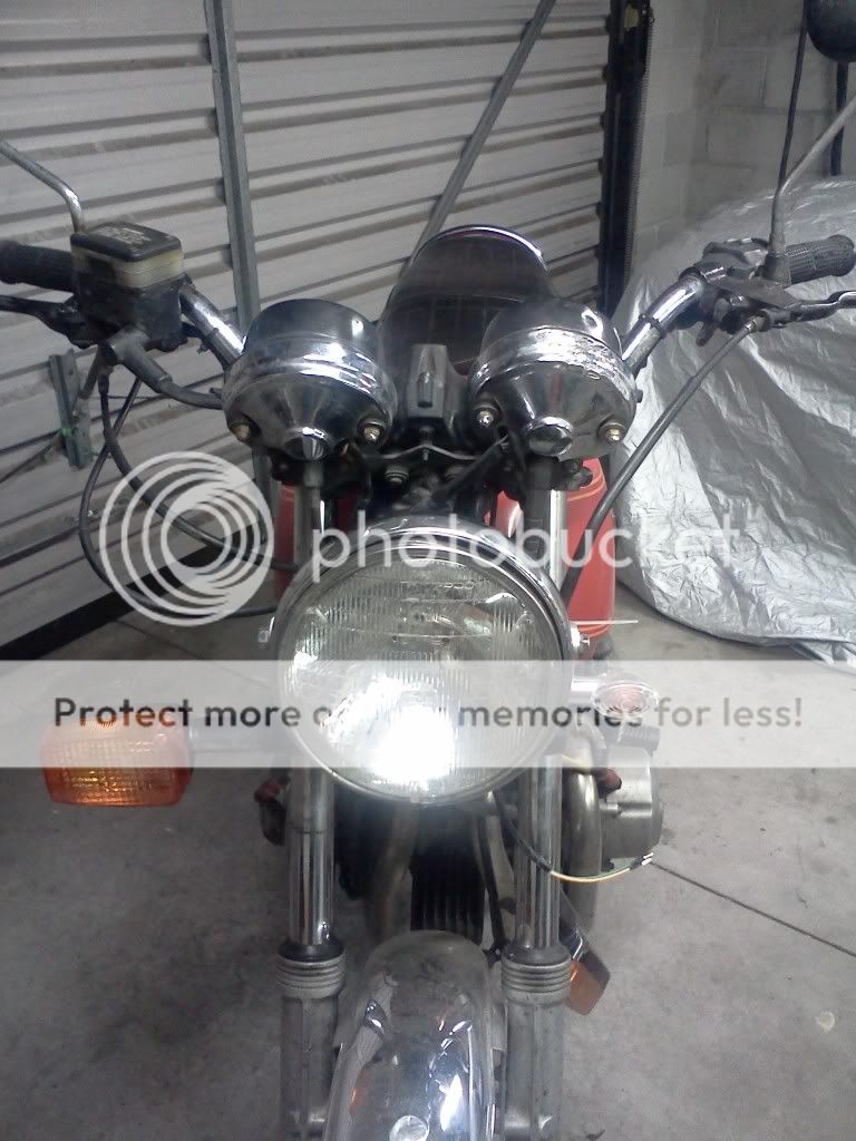

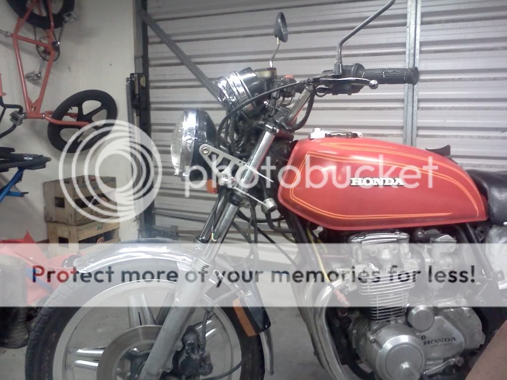

anglia4 Posted May 6, 2012 Author Posted May 6, 2012 Got into the shed this weekend and had a bit of a tinker with the bike. I pulled out the old headlight mount and mocked up my new one: I've got the headlight sitting quite a bit lower than standard and have lowered the gauges by about an inch-inch&ahalf. I'm not happy with how it looks like that, there is too much mess in between with all the wiring and it just doesn't suit the shape of the gauges. I'll decide what height to set it at once I have my new bars. For the above reasons, I have added some of these to my shopping list: The set of gauges is less than NZD$250 landed and a nice sleek headlight like that is about a hundy. Between replacing them and offloading all the wiring it should tidy it up really nice. I am really happy with the improvement the new indicators have made though! And I have just ordered this kit: which should be here in time for the kaikoura camping trip. I've also had a re-think about the foot peg mounts, the ones I had cut are just too big and don't look right. More on that later though. Quote
