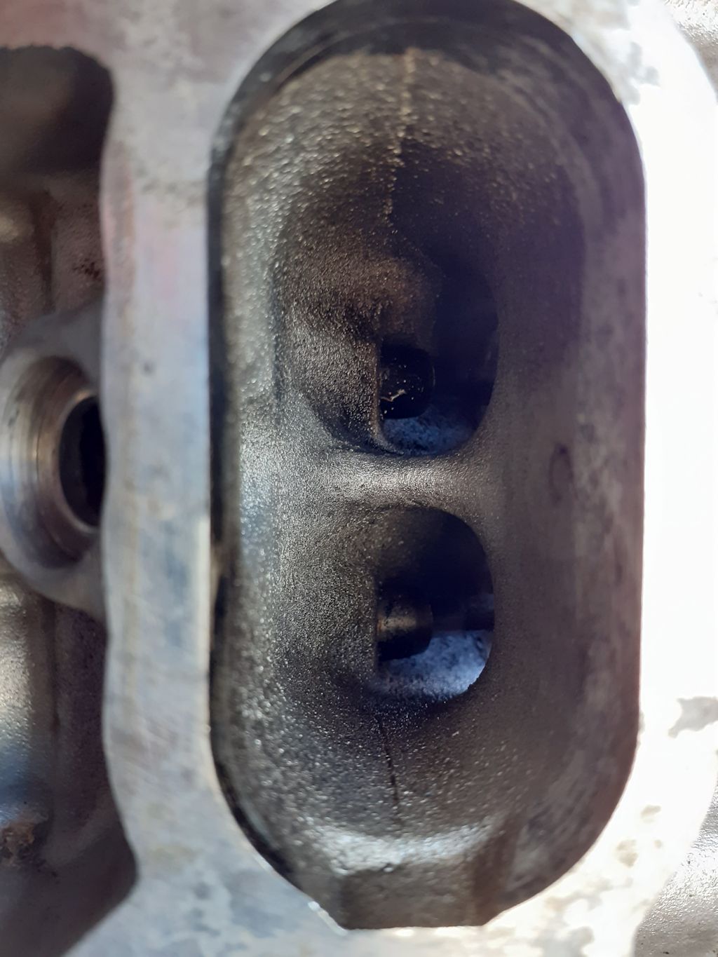

kpr Posted January 4, 2021 Posted January 4, 2021 So Ive always turned my nose up at anything that isn't a smallport 4age. But since everyone jumped on the smallport wagon. I thought i would attempt to make bigport great again @kyteler the gc sent me some horrible bigport stuff along with an ae82 bluetop head. I also had a bigport head thats been hanging around forever that i dug out. so... soon as i put the 2 together, it seems all bigport heads weren't created the same. first difference; the top one is obviously a rwd one and bottom fwd. as the top head doesn't have the fwd mount cast into it head on left is the "rwd head" the port entry is slightly smaller, but not a lot different further down the port are where things change a lot "rwd head" below Ae82 head. the port is much bigger most of the extra area is made up by having a lower port floor. but this also make it have a shittier short turn radius So, questions i have Are all rwd heads like this. or did they go to the bigger casting when fwd/mr2 4age became a thing? Bluetop cams. do they actually exist ? has anyone personally measured some up? the cams out of the ae82 head measured the same as smallport cams. so either its not a bluetop head. or only rwd bluetops got bigger cams. or said cams dont exist, and that billzilla guy tricked the whole internet. although they do have a different part number I haven't decided which head sucks less as is. I cant really be assed dyno testing both of them, but might have to happen. the rwd item is my pick to modify If you dont have any answers to my questions. At least entertain me with some sweet sharns of yesteryear how hard your bluetop kicked with tvis 5 Quote

jakesae101 Posted January 4, 2021 Posted January 4, 2021 From memory there was 2 versions of bluetop big ports the early ones having smaller mains and big ends ect possible that there was some casting revisions between the two. Quote
xsspeed Posted January 4, 2021 Posted January 4, 2021 I thought all bluetops were equal and the revision came with the 2nd gen bigport that was in early ae92s This had the bigger crank, could it be that @kytelers head was actually a 2nd gen? Would more likely explain the intake difference to me In4bluetopnangs 1 Quote
Spencer Posted January 4, 2021 Posted January 4, 2021 The MR2 early ZE had the bigger bottom end which leads to confusion? The worst engine for sure is the second gen bigport in early AE92's, I would guess that is what we are seeing above? Anyway we can all agree that the AE82 FXGT is the best config 4AGE that existed. Lightest chassis and those early big port revs all day (until you run big ends) you need a fresh one though, I have driven a bunch and some go way harderer than others. /ling 2 1 Quote
kpr Posted January 4, 2021 Author Posted January 4, 2021 I assume the ae82 used those mounts on the head? which were made in back in 83 along side ae86's. which means the "fwd" casting would have had to be made back then. So maybe the 2 different heads were being produced at the same time. doesn't seem like a toyota move though. Quote
xsspeed Posted January 4, 2021 Posted January 4, 2021 I have no e80s to look at anymore for reference lol. You'd have thought I'd remember. Drivers side mount on ae82 is definitely different to e90, possibly was off the block (rings a bell) I'll look at some old pics Quote
xsspeed Posted January 4, 2021 Posted January 4, 2021 https://www.toymods.org.au/forums/threads/28455-I-D-this-4AGE/page4 is this what you've got? edit: yup Quote
Spencer Posted January 4, 2021 Posted January 4, 2021 Yeah done a bunch of A series fwd cam belts and the mount is on the block? otherwise it would be all fucked up for single cam and FE stuff? memory is hazy though. Edit: yeah as per the link its a radiator hose thing which not all FWD used. I would put money its a late vs early bigport thing. Quote
kpr Posted January 4, 2021 Author Posted January 4, 2021 3 minutes ago, xsspeed said: https://www.toymods.org.au/forums/threads/28455-I-D-this-4AGE/page4 is this what you've got? ah yeh that makes more sense. I just looked up some part numbers and found 3 different numbers for bigport heads. Quote
xsspeed Posted January 4, 2021 Posted January 4, 2021 so likely a ae92 bigport/2nd gen AE82 fxgt at least didnt have those mounts, was single piece rad hose around cambelt side of block. Can't speak for AW11 though Quote
xsspeed Posted January 4, 2021 Posted January 4, 2021 fuck me what a bigport barry, this thread is bad for my health 1 2 Quote
kpr Posted January 4, 2021 Author Posted January 4, 2021 ae86 and ae82 have different part number head. but that could mean anything. So thats why redtop 4ages suck so much. they made the ports screwed up put smaller cams in and heaver rotating assembly could be worse, could be talking 20v's Quote
