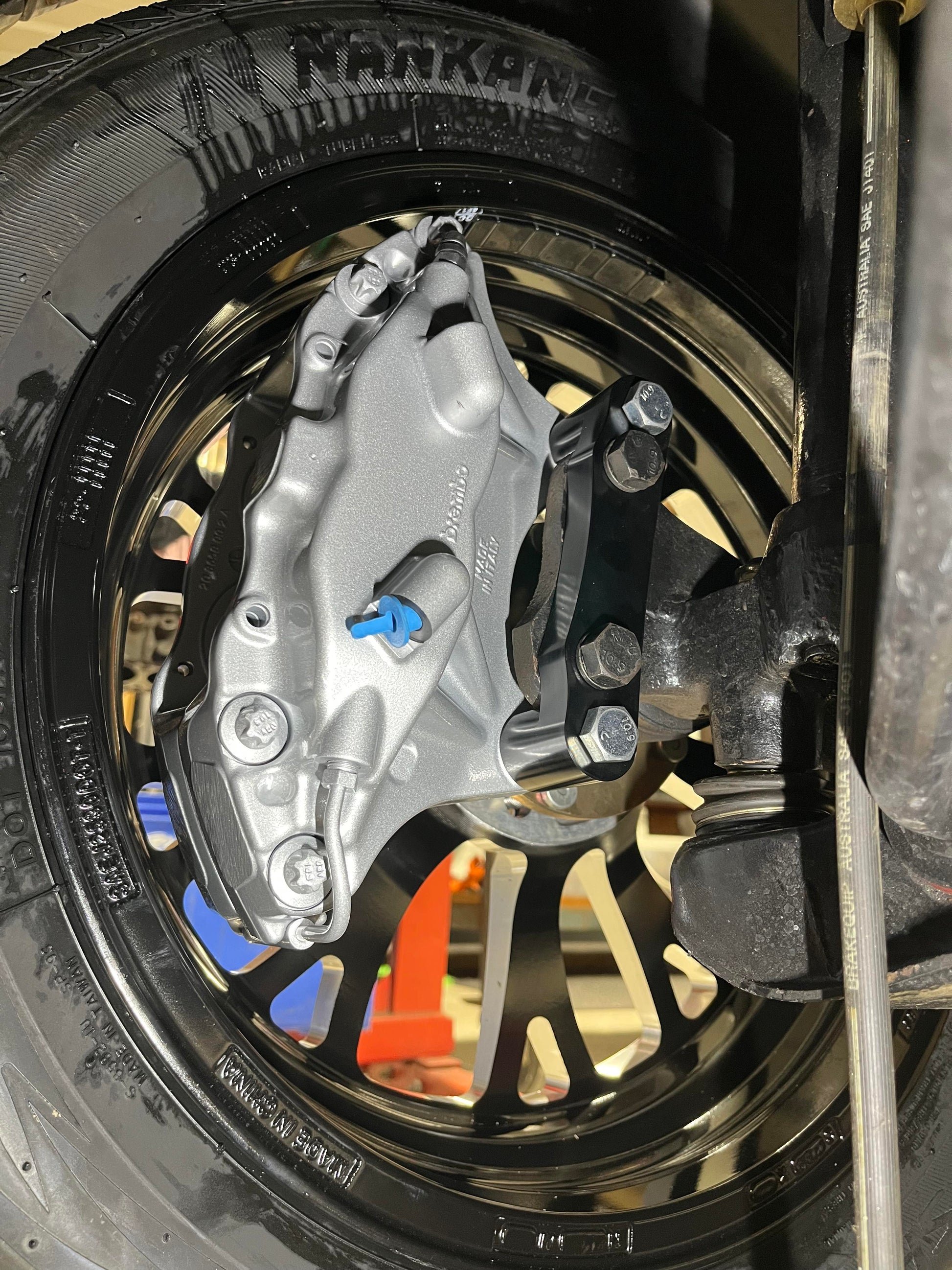

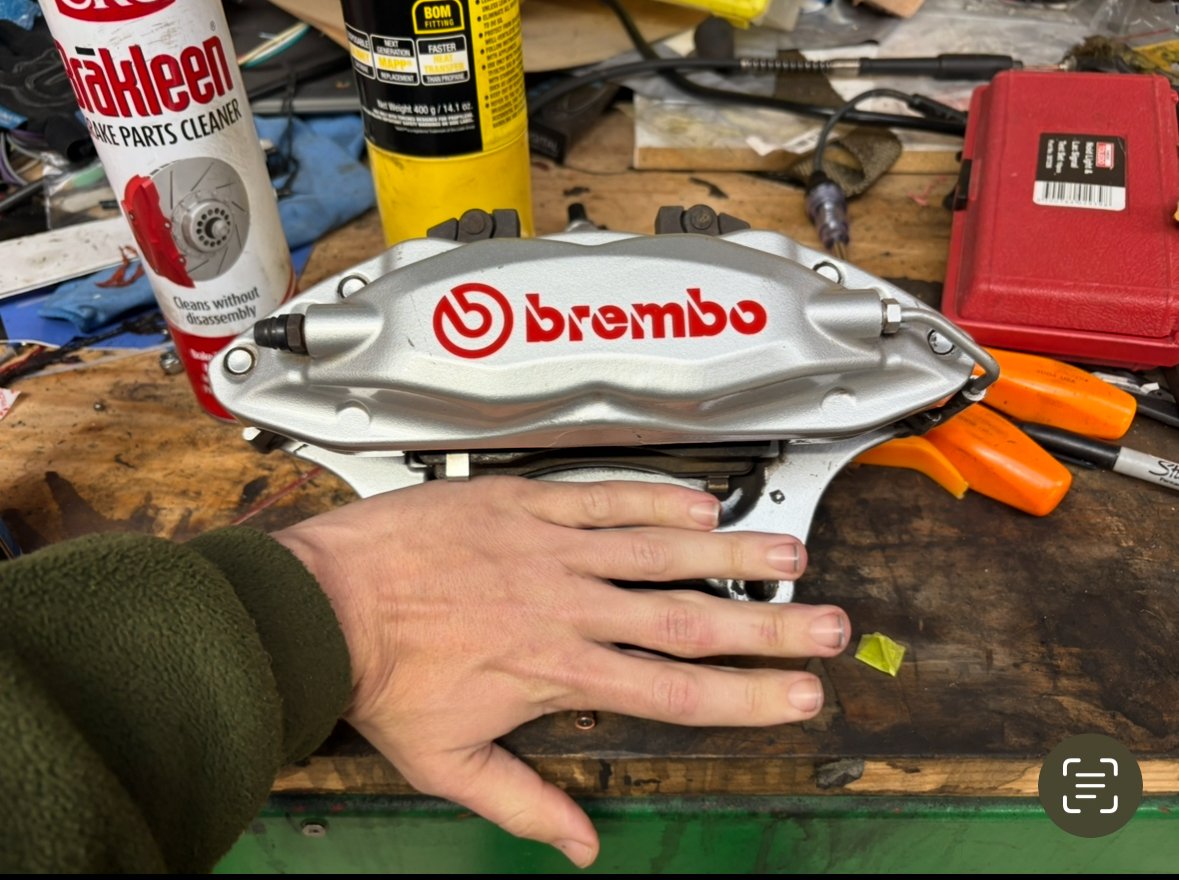

I have a bit of experience with my one to know what helps ive just gone to a 30 profile also 245/30/20 all round tho. Mine is N/A ls1 with a lot of stuff done but making 305kw at the rears Just about ready for cert , just waiting on the last bits to fit the vf 4 pot brembos ive been rocking clubsport bigger brakes for a while but its time for some real ones!- 739 replies

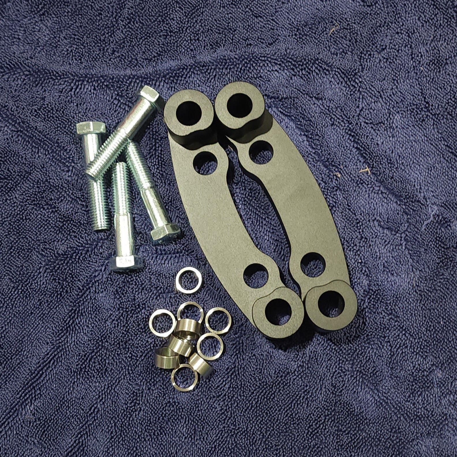

@cletus I have a brake query, I want to convert my VZ commodore to running VE brembos In aussie they machine the centre of the rotor out a couple of mm to fit the vz hubs and run a 2mm spacer that fits in the stud holes (m12 vz m14 ve) as I understand it now we can't modify rotors anymore. I know a few of these kits have been certed here but unsure what to do now. Leon at LVVTA has confirmed that the brackets themselves comply in terms of material and thickness. but im unsure what to do about the rotor situation.
