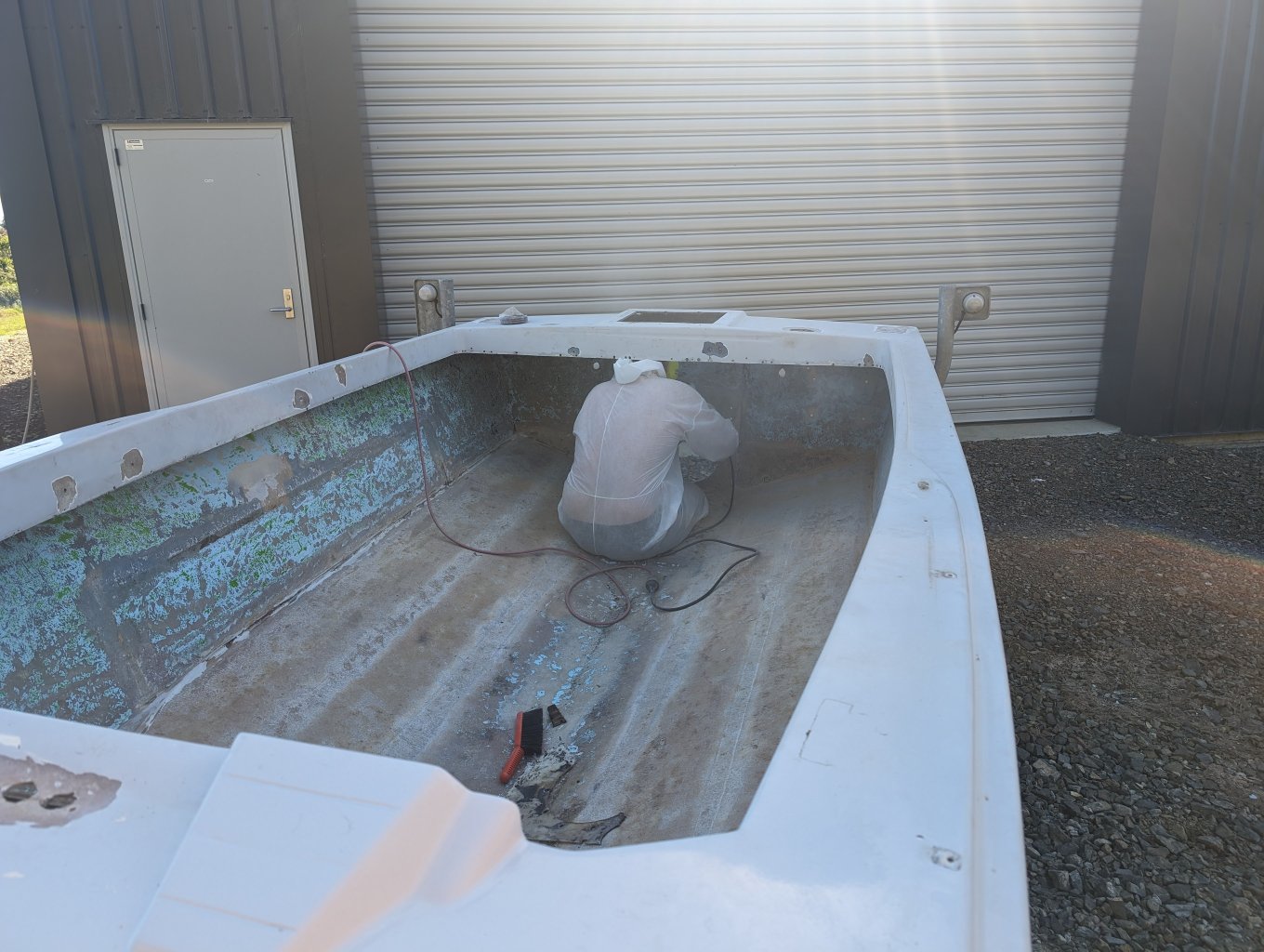

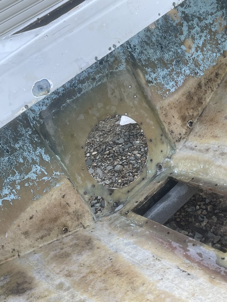

sentra Posted January 12, 2024 Author Posted January 12, 2024 17 years after its last birthday, it’s time for another The floor was dubious the first time around, wood is a terrible product. All wood to be removed this time. Stringers, beams and transom. A very happy @Tumeke helping with the misery is it time for a barra 1 Quote
sentra Posted January 14, 2024 Author Posted January 14, 2024 @Ned came and scanned the floor to be able to make new beams and a new floor, Also fanboat Brian came over and convinced me to stop being a weaner and cut the last peice of wood out of the back. all the serious misery work is done for now, will make up new beams and floor panels then probably get a friendly boatbuilder to glass them with a chopper gun as it’s not a performance machine. 2 Quote

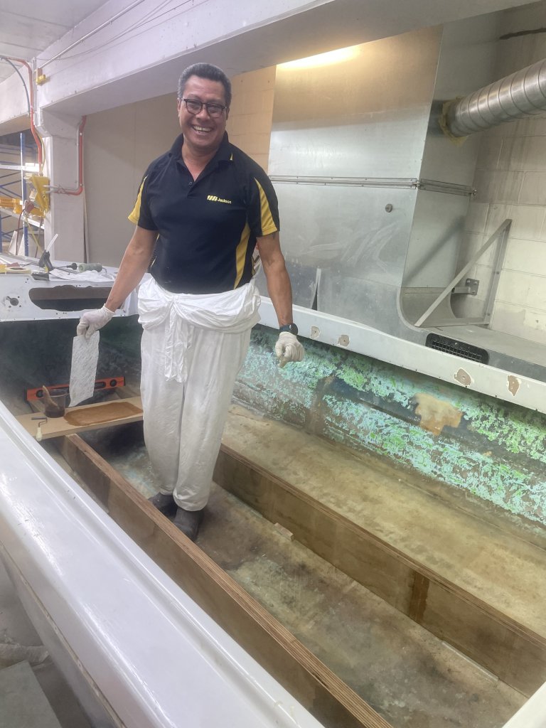

sentra Posted April 3, 2024 Author Posted April 3, 2024 New beam’s laminated and machined from @Ned’s 3d scans, amazing outcome for such a big surface and “low cost” scanner Realising I don’t have enough talent for structural fiberglass work, talented uncle Neemia from work took over and is doing an excellent job, a layer of glass is over the inside of the hull and the beams bonded in place to be laminated over the top of. 2 Quote
