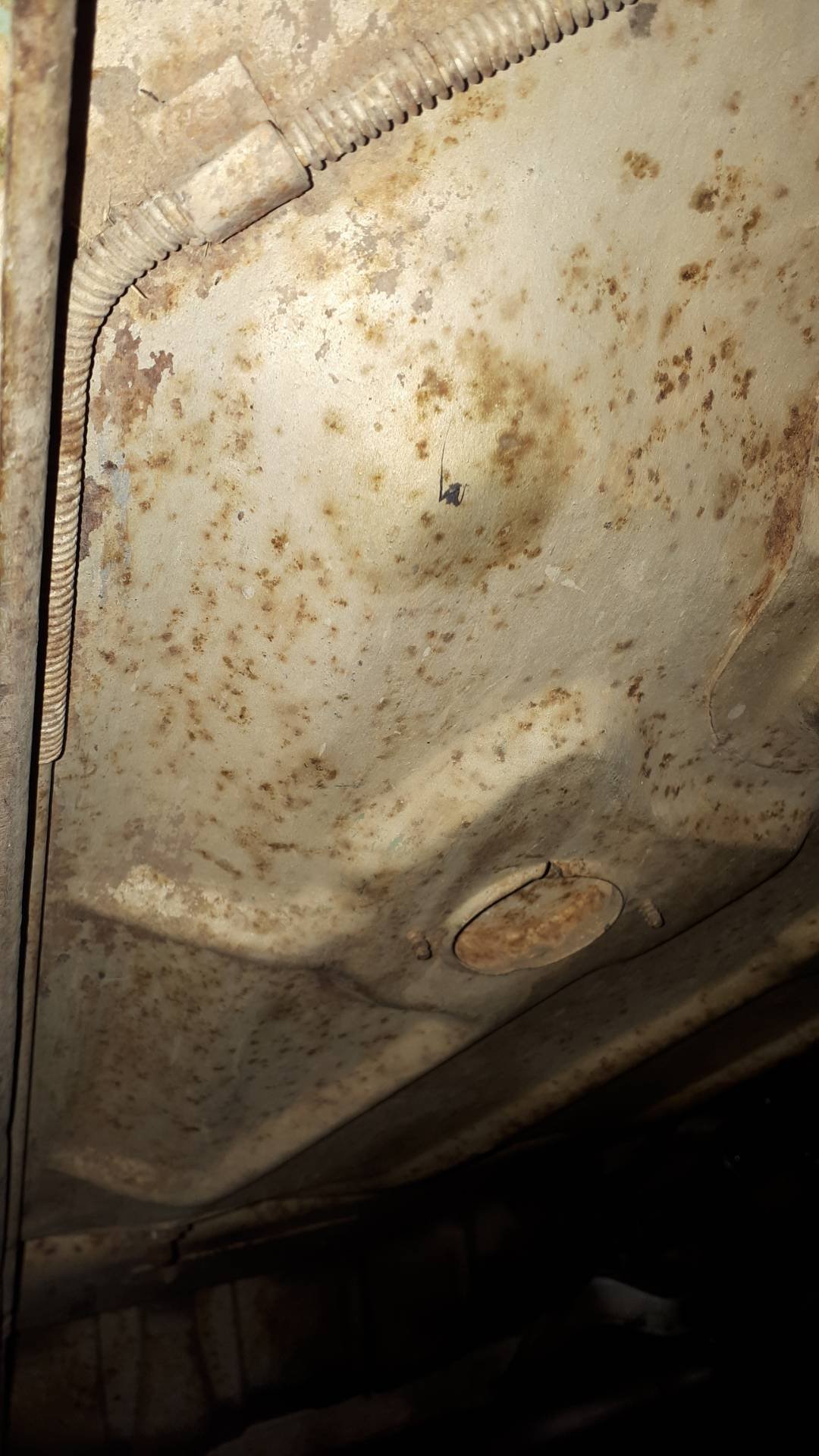

rusty360 Posted April 26, 2020 Posted April 26, 2020 I wouldnt mind cleaning up the underside of my wagon and preserving it with a lick of paint. It's just surface rust.at this stage. Sandblast then epoxy would be the ultimate, but what else would hold the rest back. Steam clean then wire wheel, treat, paint? Quote
Bling Posted April 26, 2020 Posted April 26, 2020 Decent wire wheel on the grinder will get rid of all that. Then 2k epoxy primer / underseal I imagine. Mine looks similar to that, but i'm not that motivated to actually sort it due to nowhere to make that much mess. 1 Quote
Carsnz123 Posted April 26, 2020 Posted April 26, 2020 Would pay to get a quote for sandblast. Make sure its a company familiar with doing cars. Youll get 20 min into it with the wire wheel and realise its a massive ball ache. 2 Quote
rusty360 Posted April 26, 2020 Posted April 26, 2020 @Carsnz123 I hear ya wire wheeling will be zero fun under there. Auto blast was about 1600 for memory Quote

yetchh Posted April 27, 2020 Posted April 27, 2020 Just now, rusty360 said: Only prob is once it blasted there's sand everywhere in the springs, bushes you name it! What about a soda blast, gets the paint and shit off so you can target the surface rust separately, then prime and underseal. Quote
Spencer Posted April 27, 2020 Posted April 27, 2020 I Imagine any blasting would charge 100 an hour? a stripped out shell is easy, more surface area but less prep just roll it in the room and go. To do a good job you would want to mask shit off under the car and do the job on a hoist? I would think you wouldn't get much change from $1000 or more, $1600 seems in the ball park? You have to weigh how much bullshit you will put up with to save $1000, if you have free time and some determination lay under the car for 2 days and save some coin. 3 Quote
cletus Posted April 27, 2020 Posted April 27, 2020 1 hour ago, rusty360 said: @Carsnz123 I hear ya wire wheeling will be zero fun under there. Auto blast was about 1600 for memory I got a similar quote from them on a stripped car to blast and paint, just the black normal paint not the zinc stuff someone else I asked reckoned they could do it for $600 but I wanted to see how good they are first, ive seen some really shit work by underbody blast guys on imports 2 Quote
Evan Posted April 27, 2020 Posted April 27, 2020 Autoblast from memory are $275+ GST/ hr. I got a text from them last month saying they were doing 15% off their rustproofing system for the month of March, if you go that way might be worth asking if they’ll still honour that. 1 Quote
