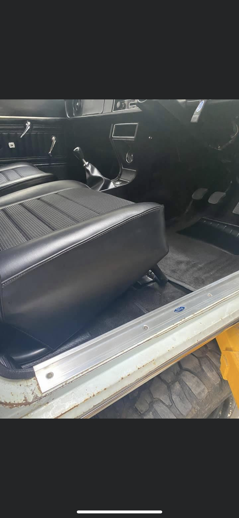

Banga Posted March 11, 2021 Posted March 11, 2021 I’m looking to swap out the bench front seat in my Cortina with a pair of GT Cortina bucket seats. The issue being that they only mount at the front and the rear slides to give forward/back adjustment- you can set the vinyl patches under the rear in the pic where the rear slides. The front seat mounts have a stopper built in so they can’t flip forward. My read is that I might have issues getting these certified as the way they mount wouldn’t really give the same level of strength as a modern production vehicle? 2.8(2) Quote

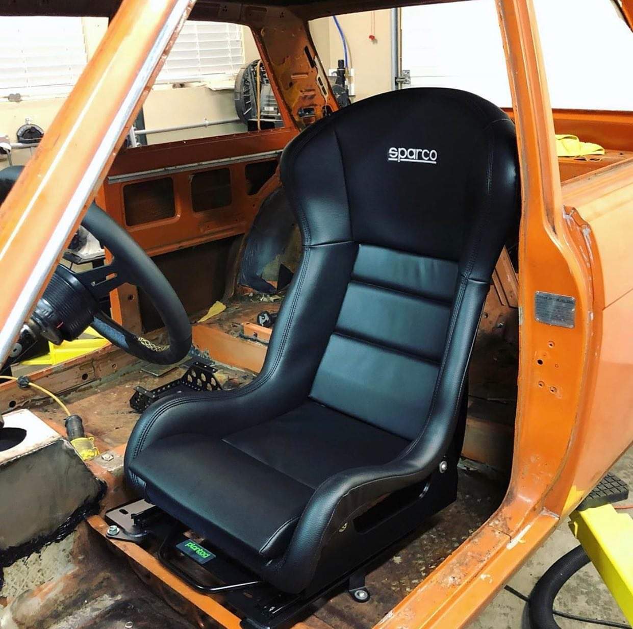

zep Posted March 25, 2021 Posted March 25, 2021 I'm quite keen on these new Sparco Stradale seats for "oldschool aplications". Issue is that they have no head rest. Is this going to cause an issue? For reference, my current Racepro seats are 810mm on the F dimensions. Here's the only pic of them in a car (Datsun 510) that I can find: Quote
KKtrips Posted March 26, 2021 Posted March 26, 2021 6 hours ago, zep said: I'm quite keen on these new Sparco Stradale seats for "oldschool aplications". Issue is that they have no head rest. Is this going to cause an issue? If you have anything hard within 300mm of the back of the seat then yes you will need a headrest, I suspect the cage will be your nemesis. Quote
zep Posted March 26, 2021 Posted March 26, 2021 16 hours ago, KKtrips said: If you have anything hard within 300mm of the back of the seat then yes you will need a headrest, I suspect the cage will be your nemesis. Ah yep. I imagine even the b pillar would be within 300mm. There are a severe lack of new retro inspired buckets that look good. Quote
KKtrips Posted March 27, 2021 Posted March 27, 2021 B-pillar wouldn't be a problem, more what is within headstrike distance. Quote
cletus Posted March 27, 2021 Posted March 27, 2021 A head rest doesnt have to be part of the seat, it could be attached to something else, it is reasonably common for hot rods to have them attached to things like the roll bar or to the body Quote
zep Posted March 27, 2021 Posted March 27, 2021 4 hours ago, cletus said: A head rest doesnt have to be part of the seat, it could be attached to something else, it is reasonably common for hot rods to have them attached to things like the roll bar or to the body Do you have any examples of this? Could that just be roll Cage foam? Quote
