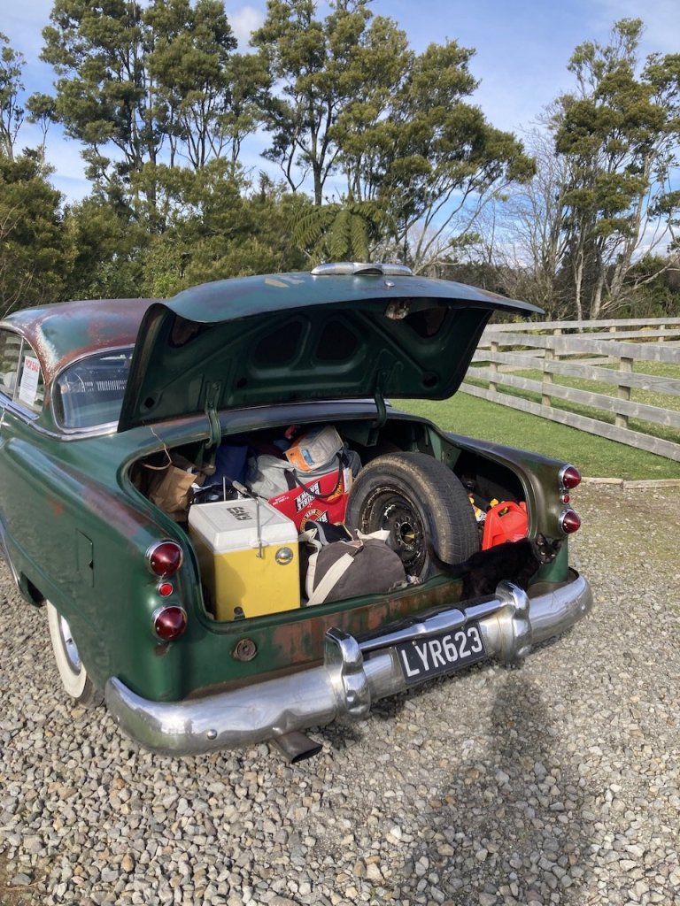

Bistro Posted January 17, 2025 Posted January 17, 2025 seems to go all good on the painted parts - I did the whole car. It gives a semi wet look to the paint this sort of shows the reflection of the gravel 4 Quote
