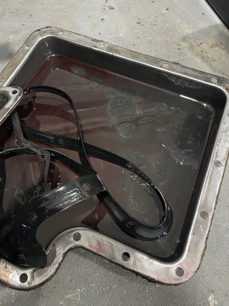

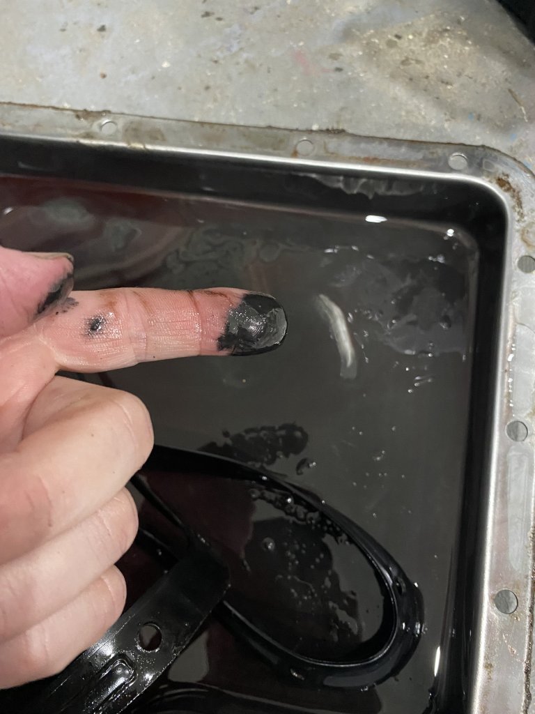

anglia4 Posted July 20, 2025 Author Posted July 20, 2025 How much shit is usual in an old trans like this? Quote
anglia4 Posted July 20, 2025 Author Posted July 20, 2025 it kinda looks worse in the photos than what it is. But there is a thin layer of black shit (friction material I guess) across the bottom. I’m ready with new filter and fluid, but don’t want to waste the fluid if this is a clear sign that it’s shagged. thoughts? Quote
anglia4 Posted July 20, 2025 Author Posted July 20, 2025 Ignore the grit, that’s off the outside of the gasket Quote
440bbm Posted July 20, 2025 Posted July 20, 2025 Clean it and send it. no drain on the pan? likely scenario its never had a service because of this... If its shagged, then you can reuse the spendy oil if you pass it through a nice filter to remove chunks. doubt it will get burnt in a short enough time to work out if the trans is no good. 1 1 Quote
anglia4 Posted July 20, 2025 Author Posted July 20, 2025 Nah no drain on the pan. I would say its unlikely to have been serviced. I have been leaning towards the clean and send approach. I'll put it back together tonight. 2 Quote
Lord Gruntfuttock Posted July 20, 2025 Posted July 20, 2025 I found quite a few bits in my C4, new filter and fluid and all good. Put a cast alloy pan on it with a drain plug. Are you using the Type F Ford fluid? I had to go to a speed shop to find it... Quote
Lord Gruntfuttock Posted July 20, 2025 Posted July 20, 2025 Not even sure what that is, or what trans you have, C6, FMX? Just as long as it's suitable... Quote
cletus Posted July 20, 2025 Posted July 20, 2025 i pulled the pan off my trans which had been recently built, there was a surprising amount of shmutz in there, trans guy said yep thats normal when you think about how a trans works it makes sense that all the bits of clutch and bushes etc has to go somewhere 3 Quote
