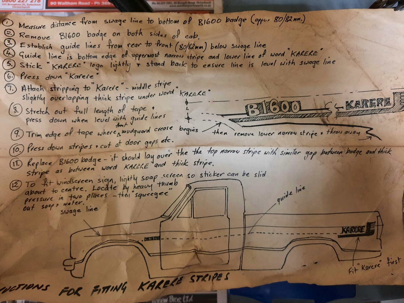

waspman Posted November 10, 2023 Posted November 10, 2023 You could always add in the Karere stripes, this was the factory supplied diagram on how to apply them, from memory they also rolled white steel rims Quote
shizzl Posted November 10, 2023 Posted November 10, 2023 8 minutes ago, waspman said: You could always add in the Karere stripes, this was the factory supplied diagram on how to apply them, from memory they also rolled white steel rims I’ve never seen one of those, would be cool to see what it looks like on a ute Quote

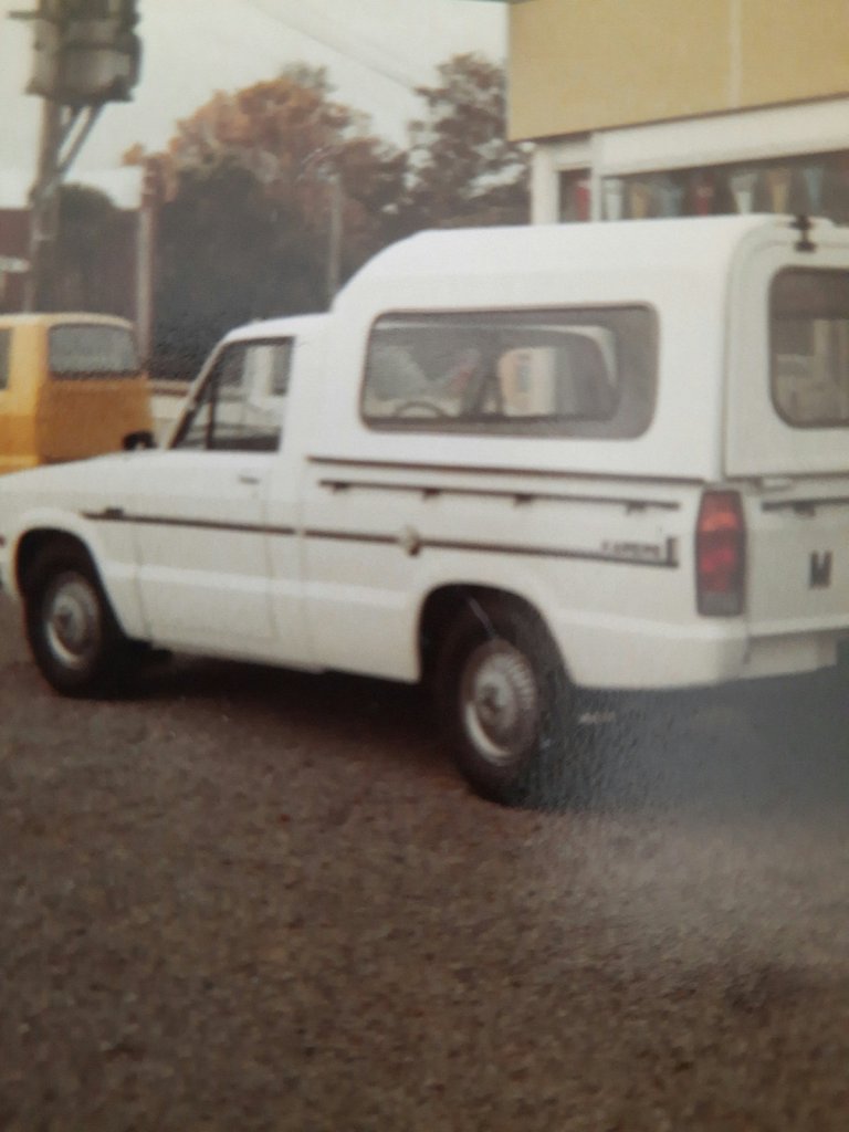

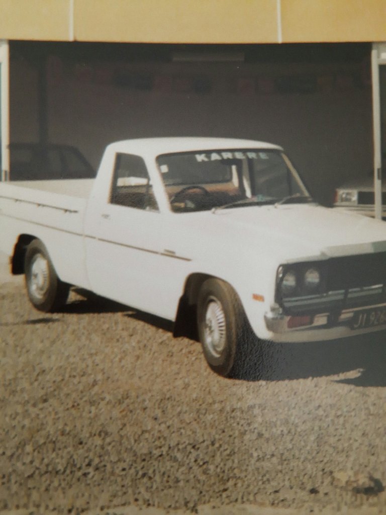

waspman Posted November 11, 2023 Posted November 11, 2023 These are some shit images on a white ute, I have some of a yellow version with mag wheels that looks heaps better, just can't find them Quote
waspman Posted November 11, 2023 Posted November 11, 2023 Also this version from Gulf Mazda, note the early version of a double cab Quote
shizzl Posted November 11, 2023 Posted November 11, 2023 Double cab looks awesome, looks like repu rear arches too Quote
