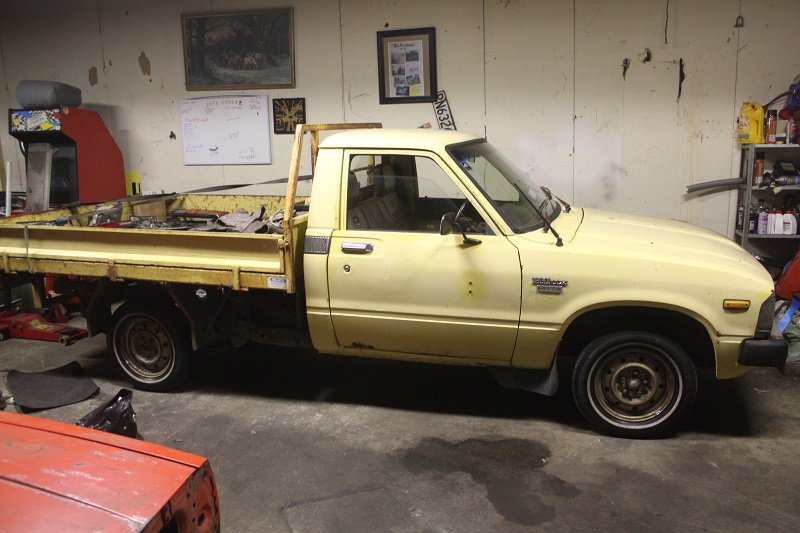

Popular Post Seedy Al 18,027 Posted September 25, 2018 Author Popular Post Report Share Posted September 25, 2018 First Up is My Hilux I have been campaigning for a while. Long Story short it was super Barry Farmer spec and stayed that way for some time. Then I parked it @Goats place for like 8 months while I did other things, and needed a bunch of stuff to get back on the road, which spurred me into Making it into the shop truck it is now. This thing was just getting ready to be for sale, and then Struck a case of Diesel run away on me from a down a hill, which was fucking pretty hard on the nerves. So I have decided I dont want to kill anyone, so its getting pulled down for a re-ring and head over hall to sort all the blow by and smoking issues. So anyway, heres a bunch of useless pics of the evolution of the Hilux 13 Quote Link to post Share on other sites

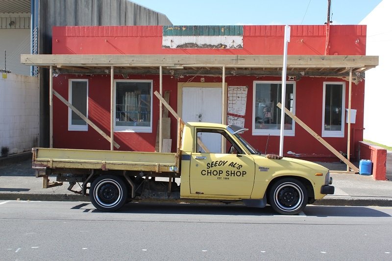

Popular Post Seedy Al 18,027 Posted September 25, 2018 Author Popular Post Report Share Posted September 25, 2018 as been mentioned a few times, Huge thanks to @Archetype for helping me out with the sign writing. Was achieved by making a low tack stencil and then applying plasti dip, to give it a more realistic and weathered look. 24 Quote Link to post Share on other sites

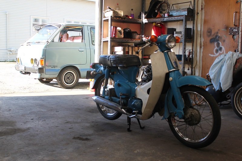

Popular Post Seedy Al 18,027 Posted September 25, 2018 Author Popular Post Report Share Posted September 25, 2018 I also have a bunch of push bikes, but they are fairly mundane And also Scooters!!!!!!!!! I own 4 scooters 2 C-50's, one fairly OG, for now, which I bought off @Chris.QCR long time ago and have only used one lol, and the other I bought as a going concern with a skyteam 125 in it. The OG one is going to get a 110 motor in it for summer rides, and the Skyteam one will get built into something better as its current style is not my style. And have a Honda Eve with a Dio motor I got off @RUNAMUCK And a Honda Nifty Fifty thats going to also get a Dio motor, along with a bunch off stuff I have bought off @Raizer Anyway thats it for now. Hilux repair is my current concern so scooters are just back burner stuff till thats done, 20 Quote Link to post Share on other sites

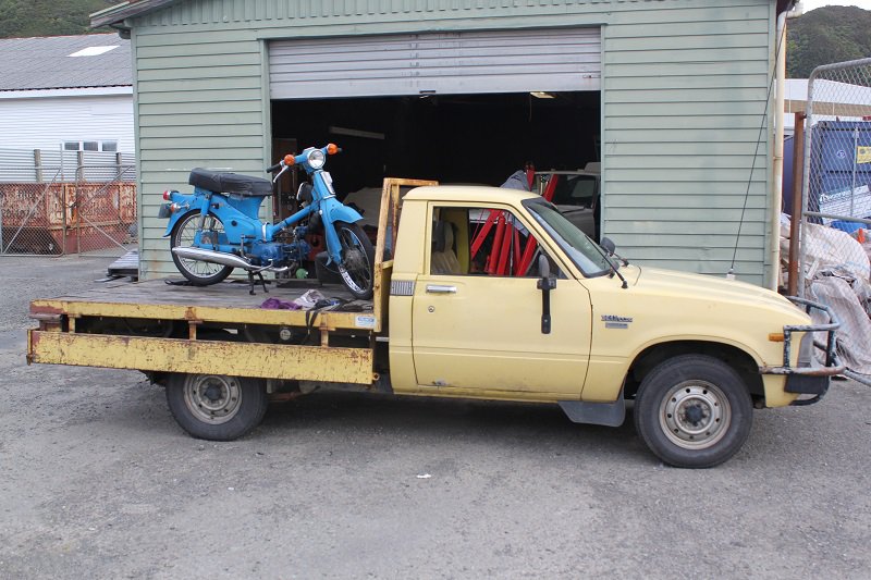

Seedy Al 18,027 Posted September 26, 2018 Author Report Share Posted September 26, 2018 continuing on from the scooter talk. In the pictures below you can make out the Honda Pax on the back of the hilux, I have been rolling this for a few weekend rides, seems pretty reliable with the Dio motor in it. Cant wait for more sun hours and will ride this to work which isnt to far away. Does good Job And the others are of My nifty I just received on Monday, after being stored in Auckland for some time. It matches everything I own, ratty and rad. Cant wait to eventually get into it. Currently waiting for the key to turn up so I can actually start the thing, then rego and it can be a fun little smoko runner or something, 7 Quote Link to post Share on other sites
Seedy Al 18,027 Posted September 26, 2018 Author Report Share Posted September 26, 2018 And That besides, I have been campaigning on my Hilux pulling apart the motor. Really want to get the head off so I can see what the shit I'm dealing with. Have been so obsessed with trying to get the crank pulley bolt off, that I completely didnt even consider that the Pulley wont come off. Sigh, will try dig out a puller at work tomorrow and then try again, worst case I will be making one which is mega dumb. In the good news, I am super stoked it has adjustable tappets lol, as that means its one less thing I need to try and do slash pay someone to sort. lovely. 8 Quote Link to post Share on other sites
Seedy Al 18,027 Posted September 30, 2018 Author Report Share Posted September 30, 2018 Well now, After a bunch of fluffing around with people trying to actually Buy a new puller as works ones were missing a bunch of bits etc. I finally got the front crank pulley off Much Excitement! Then the head removal was a piece of cake from there. However, after inspecting the head for any sort of damage and concluding the head looks lash as shit, I moved on to the block WOH woouup. Shits fucked. The step on the bores is fucking massive, and the bores look like they have been polished by a professional No wonder this thing had some blow by. So, my dreams of a simple Re-ring and valve stem seal job are down the drain, along with my hopes and dreams of getting most of my cars sorted this year to buy a house. Lets just say I'm a little bit dark today... Anyway, next step is to figure out what I'm going to do about this thing and the rest of my life lol. So, it will get strung back together enough so it can be pushed, and will start thinking of options. These probably range from, Doing a full re-build on this motor, which seems like a total waste of money or time, Finding some form of replacement motor, Fitting the 1kz setup I have kicking around, Fitting the 1UZ setup I have been saving for my Cressida Or Even fitting the 3rz Setup that @Bistro has sitting at my lock up. Anyway, stayed tuned for the Next Installment! Where I find out if Niki's Slash @Mourning Cupcake s Daily Mazda needs a new LH rear caliper ora rebuild as I noticed its leaking brake fluid On Friday! FML lol 4 1 5 Quote Link to post Share on other sites
