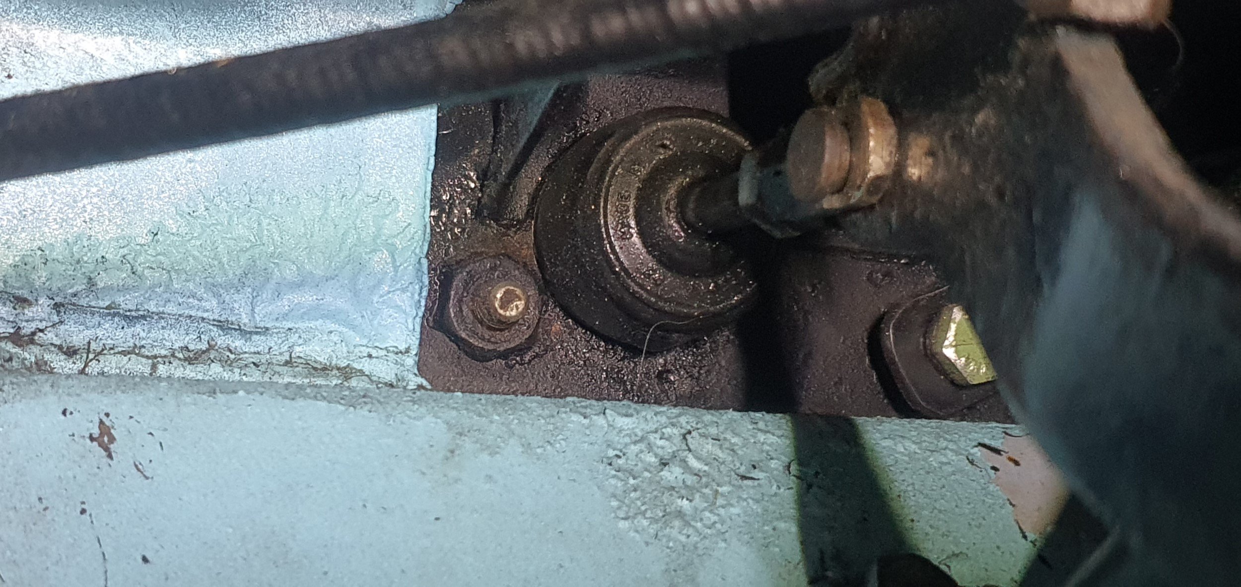

yoeddynz Posted June 24, 2024 Author Posted June 24, 2024 Thanks Ben! I'll certainly come visit you once I'm confident with its longer range hooning abilities. I've looked at the M/C and it had a big drip of fluid hanging off the rubber boot. Paint has all lifted below it. I suspect it is very tired and has been for a while... Quote

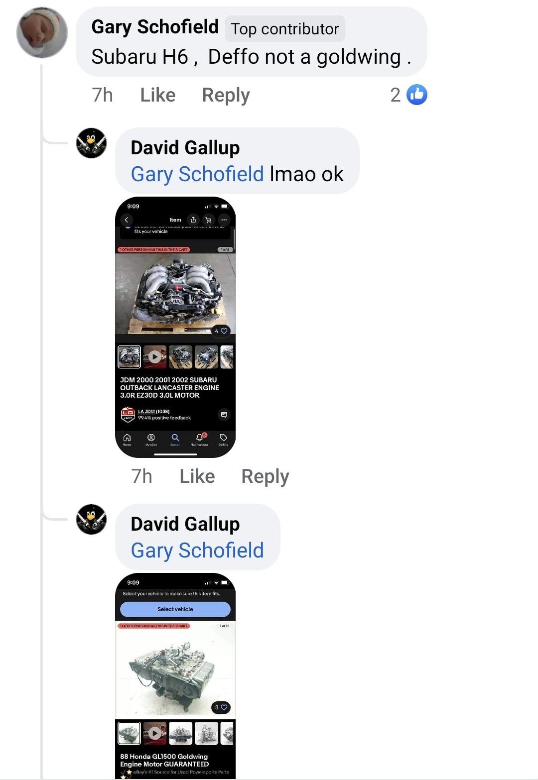

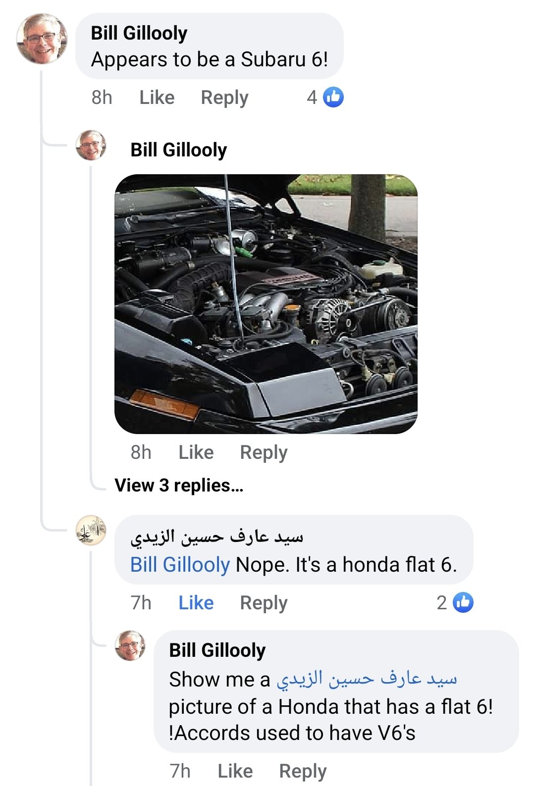

Popular Post yoeddynz Posted June 24, 2024 Author Popular Post Posted June 24, 2024 Also.. Seeing various car barries argue over what the engine is from is fun to watch... ...and.. 23 Quote
tortron Posted June 25, 2024 Posted June 25, 2024 M8 it's 2 A series, put together and a cylinder chopped off. Just listen to the valve clatter, I'd know that anywhere 1 3 Quote
igor Posted June 25, 2024 Posted June 25, 2024 There's an idea for your next project Alex. An all mowog V8. Quote

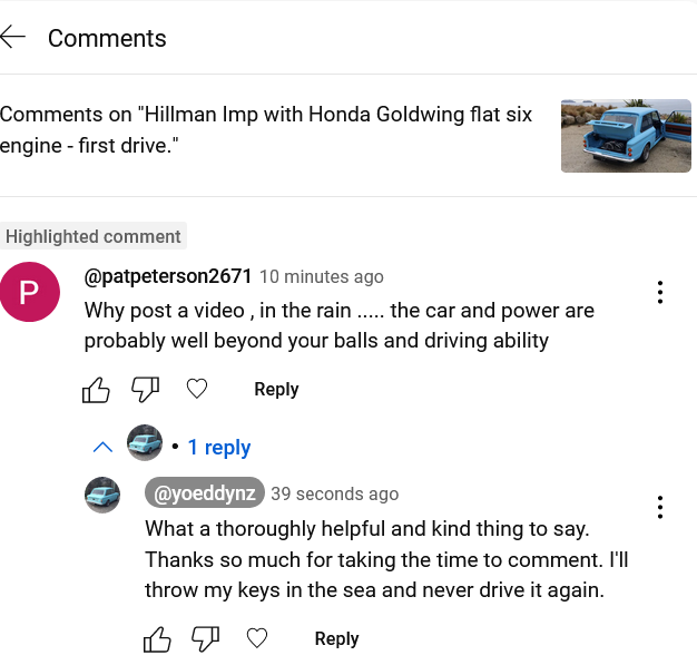

Popular Post yoeddynz Posted June 28, 2024 Author Popular Post Posted June 28, 2024 Some people .... 2 18 Quote
ThePog Posted June 28, 2024 Posted June 28, 2024 You should ask him to post a link to the first drive of his custom build. 4 2 Quote
tortron Posted June 28, 2024 Posted June 28, 2024 I liked the guy saying you cant drive in the rain because it will overheat 4 Quote
igor Posted June 28, 2024 Posted June 28, 2024 That doesn't even make sense. What reality do these people live in? 1 Quote
yoeddynz Posted June 28, 2024 Author Posted June 28, 2024 22 minutes ago, tortron said: I liked the guy saying you cant drive in the rain because it will overheat I saw that one bit I couldn't decipher what he was trying to say. Thanks for clearing it up and it'll be duly noted. No driving in the rain. No driving with small balls. 4 Quote
