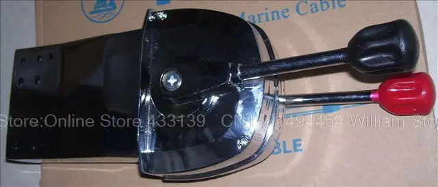

flyingbrick Posted July 15, 2018 Posted July 15, 2018 1PC Universal Boat Outboard Engine Motor Kill Stop Switch Safety Tether Lanyard Motorcycle Accessories Motorcycle Switcheshttp://s.aliexpress.com/Q7zqANFv?fromSns=Copy to Clipboard Love this thing so much. You could easily draw up and laser cut the two throttle levers from aluminium:-D 1 Quote
Muncie Posted July 15, 2018 Posted July 15, 2018 I have 2 electric scooter throttles if you could use them your welcome to them Twist grip style around 40mm wide. Would serve as deadman as well if you left the return springs in. 1 Quote

kempy Posted July 16, 2018 Author Posted July 16, 2018 21 hours ago, Muncie said: I have 2 electric scooter throttles if you could use them your welcome to them Twist grip style around 40mm wide. Would serve as deadman as well if you left the return springs in. Thanks for the offer, I'd like to go down the sliding throttle path though as there's other controls that also need to be incorporated That postie bag idea certainly has me pondering the idea, all the electronics, fuel etc could be stuffed into each bag 1 Quote
