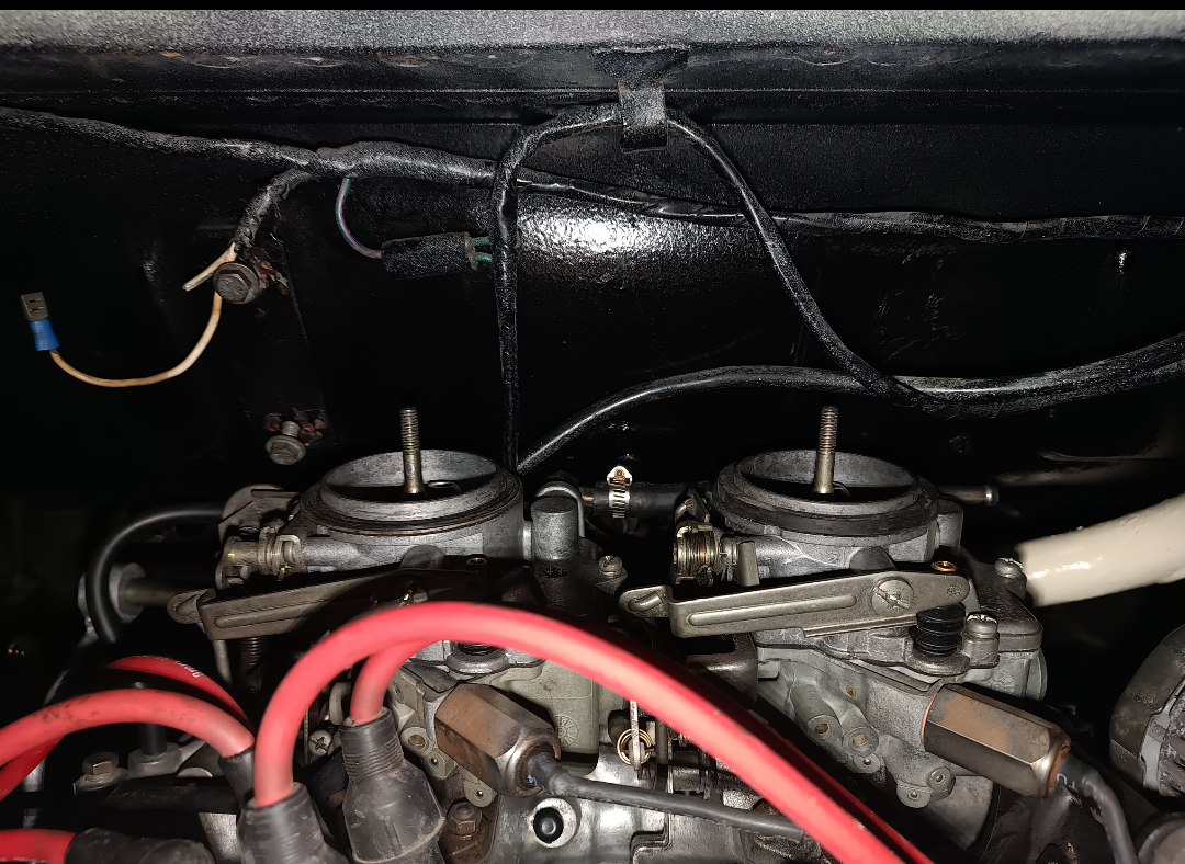

Hoping the brains trust can help me. The only air filters I can find are pit bike ones on a 45 degree angle.
It is 60mm id. I could possibly get a 45 degree reducer to 50mm and then use some VW beetle aftermarket chrome ones.
I do have one ramflo but it wont fit without some pipe cut at an angle between.
Open to ideas.
