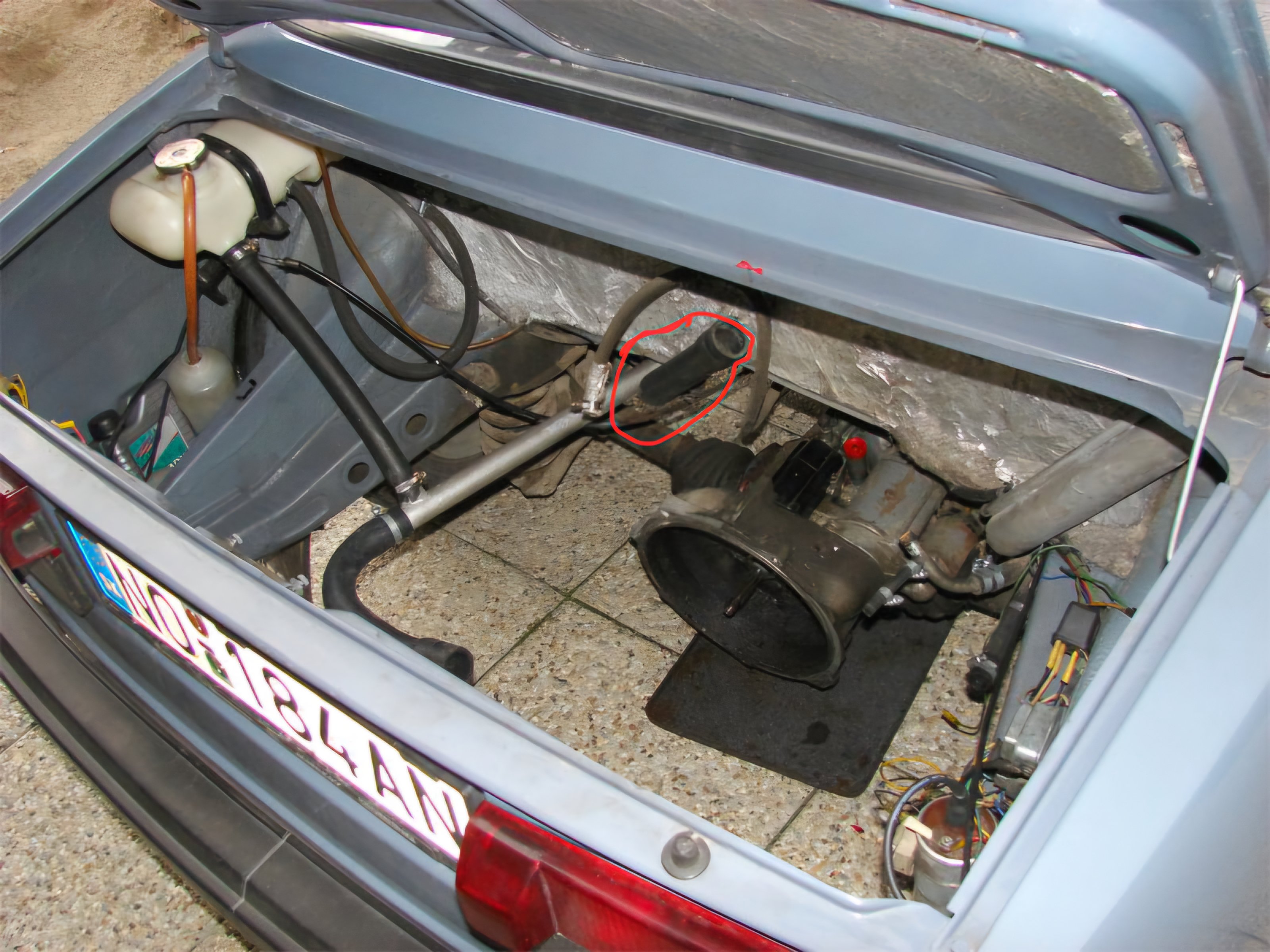

Alfashark Posted February 24, 2025 Posted February 24, 2025 The layout in the back goes - Expansion/header tank connected to the main hardline that has the elbow on the end to the water pump. The black hose circled in red, comes off the thermostat housing at the back of the block and joins onto the other hardline to the front of the car. 1 1 Quote
dmulally Posted February 25, 2025 Posted February 25, 2025 On 24/02/2025 at 19:58, Alfashark said: The layout in the back goes - Expansion/header tank connected to the main hardline that has the elbow on the end to the water pump. The black hose circled in red, comes off the thermostat housing at the back of the block and joins onto the other hardline to the front of the car. Cheers. Do you know what that smaller line goes to from the expansion tank? Quote
Alfashark Posted February 26, 2025 Posted February 26, 2025 The thin black one at the front of the expansion tank? Just had a quick look through a manual, it says it's a bleed line off the thermostat housing. If that's the case, it's been twisted up and out of the way for engine removal. 1 Quote
dmulally Posted February 26, 2025 Posted February 26, 2025 Yep. Whilst I'm waiting for the filler neck to come in from overseas I might go to the wreckers and look for a header tank like that one. I always run an external expansion tank anyway but could put me back on the road faster so I can test on it some more. Sucks seeing it ready for a drive and not being able to. 1 Quote
Alfashark Posted February 26, 2025 Posted February 26, 2025 VW group ones are common, a nice round globe shape and consequently don't take up much room. 1 Quote

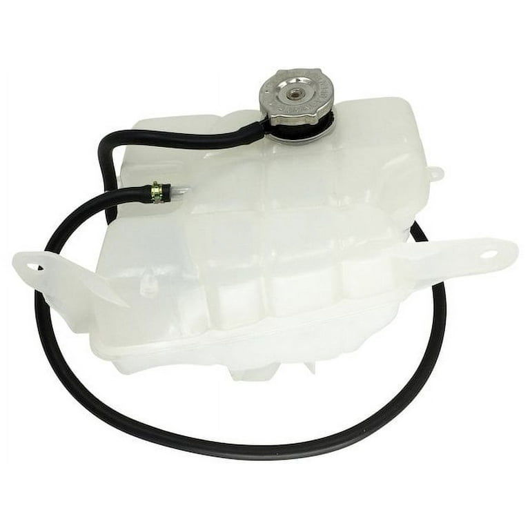

dmulally Posted March 10, 2025 Posted March 10, 2025 On 07/03/2025 at 19:06, yoeddynz said: Gary has cute little paws. He has thumbs! Anyway I managed to nab one of these: I'll T piece into the main hose line and block off the heater. Similar to the question above, my car doesn't have a thermostat bleed line. Anybody know if I can plug it off or should I put a T piece in the hose line to the T piece on the main hose line such as this: Not sure there is anything on the block I can take it from. Quote
Bearded Baldy Posted March 10, 2025 Posted March 10, 2025 Cap it off at the tank will be fine. Some of the euros come like that, same bottle for multiple vehicles so just cap or uncap as needed. 1 1 Quote
