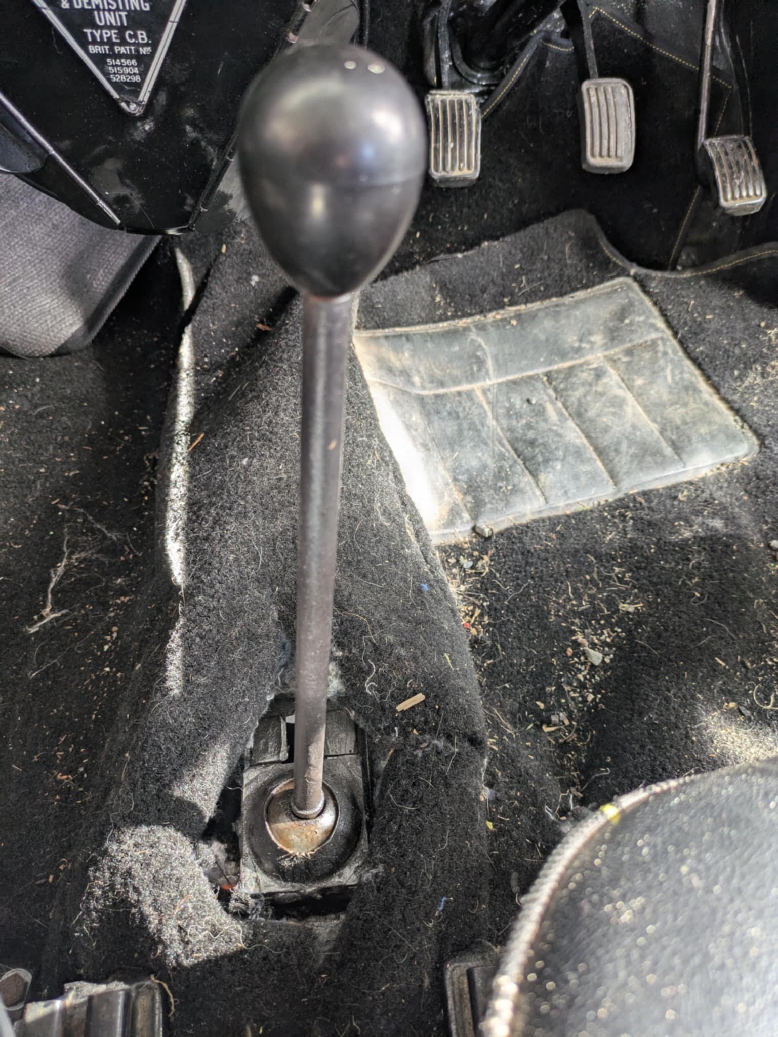

dmulally Posted May 15, 2025 Posted May 15, 2025 Next item on the agenda. Has anybody ever made a shift gate before? There is about a bee's dick between reverse and 4th. Meaning I can't find first unless I come to a complete stop and find second beforehand. Also from 3rd to 2nd I hit reverse at times. Anybody ever made a shift gate that works? 3 Quote
VitesseEFI Posted May 16, 2025 Posted May 16, 2025 Are you sure you don’t want to revisit the linkage geometry to widen the gate a little first. Making a gate is easy enough…. Making the gears fit in it probably not so much 🤔 Quote
dmulally Posted May 16, 2025 Posted May 16, 2025 1 hour ago, VitesseEFI said: Are you sure you don’t want to revisit the linkage geometry to widen the gate a little first. Making a gate is easy enough…. Making the gears fit in it probably not so much 🤔 I already had a bit of a play with that to get it to sit properly between the seats without fouling anything. Quote
