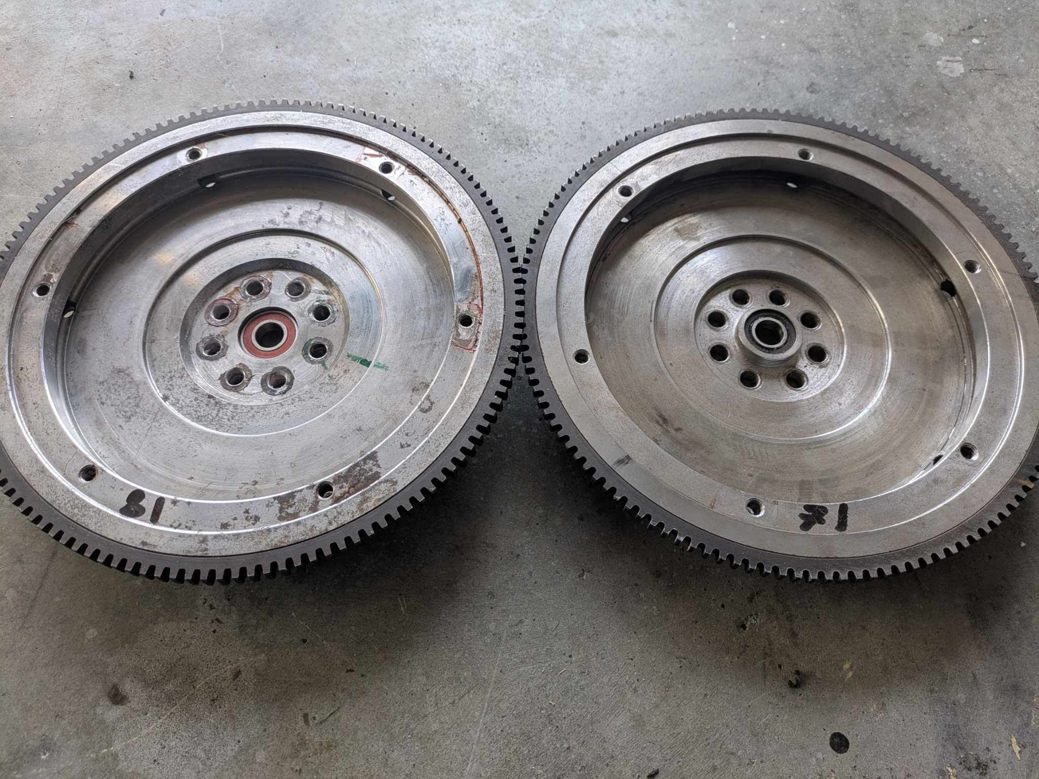

So old mate fucked up the EA71 adapter and with the EA81 going in it wouldn't be another day in paradise if this adapter wasn't fucked up too.
First the flywheel had the wrong bolt PCD. So the machine shop had to weld it all up and redrill it correctly. Annoying.

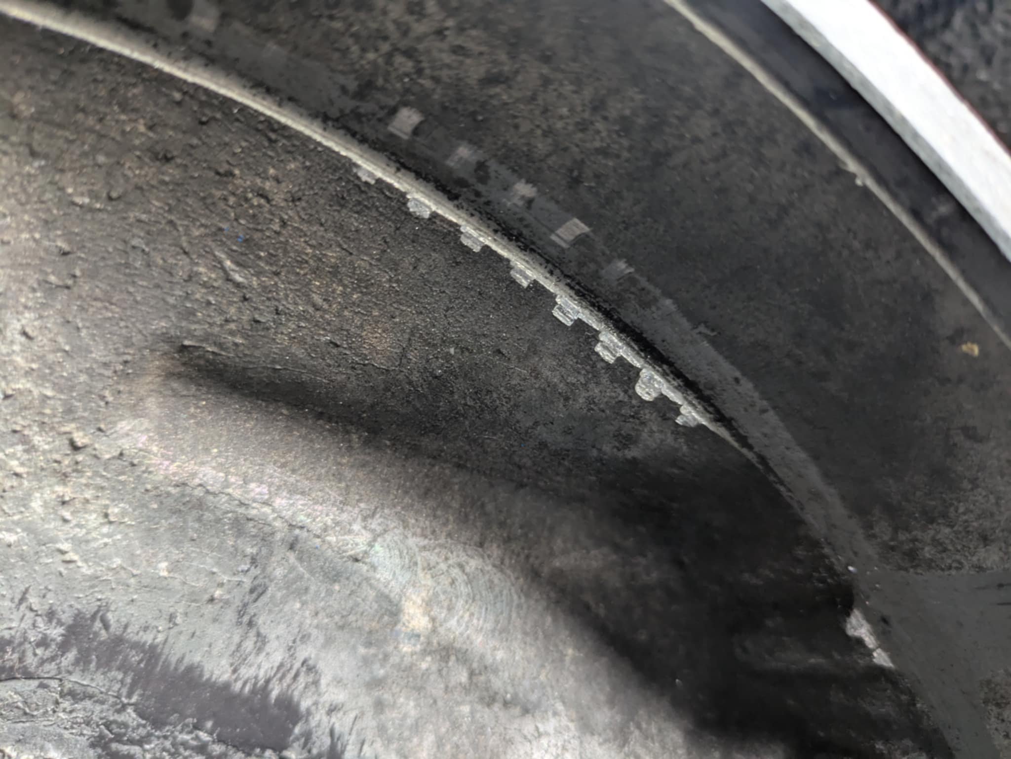

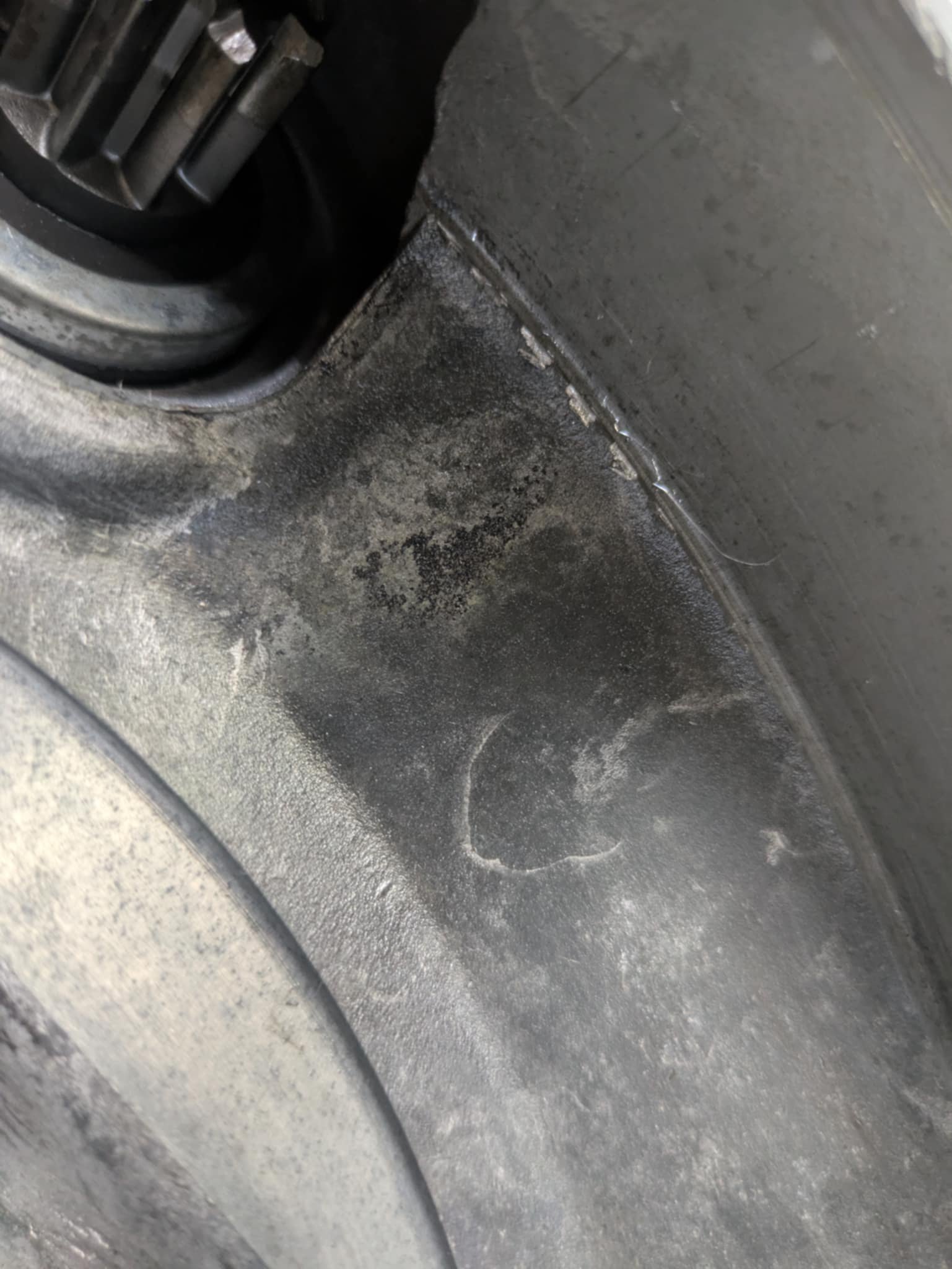

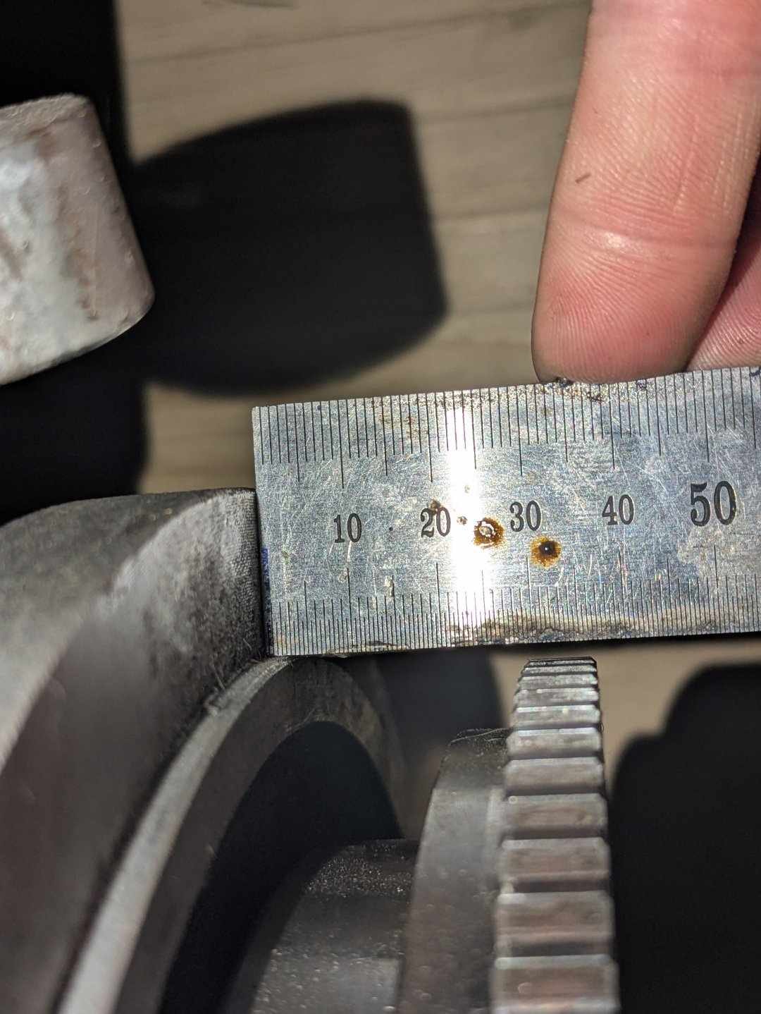

Next issue I'm having is the ring gear now fouls the bellhousing. Arrrgh.
Might need some help from the brains trust as to what to do next.
You can see the score mark here. I turned the crank bolt to feel the grindy goodness.
Messenger_creation_3FE7FAC7-990E-45F3-951B-562B203C8338.thumb.jpeg.a00baa54e4e777601d24b705c2857d24.jpeg
Messenger_creation_0B5AAE54-0EA3-49EF-8070-337C8762B9C1.thumb.jpeg.ec32d9622641606c2f806315a9b695ad.jpeg

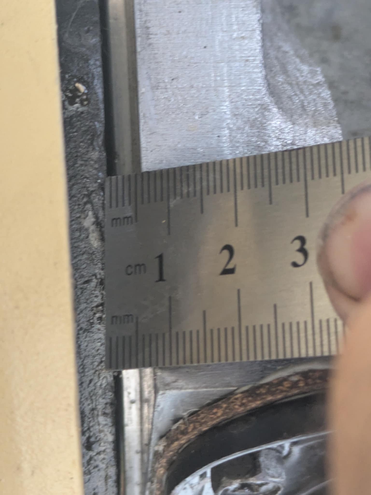

Looks like there is 5mm to go until the adapter plate is locked into the bellhousing.
Messenger_creation_2BAB5931-37E6-477B-A370-A3D1A2D1099C.thumb.jpeg.3629fbd993e92ee2eeee45db3d44a4e8.jpeg

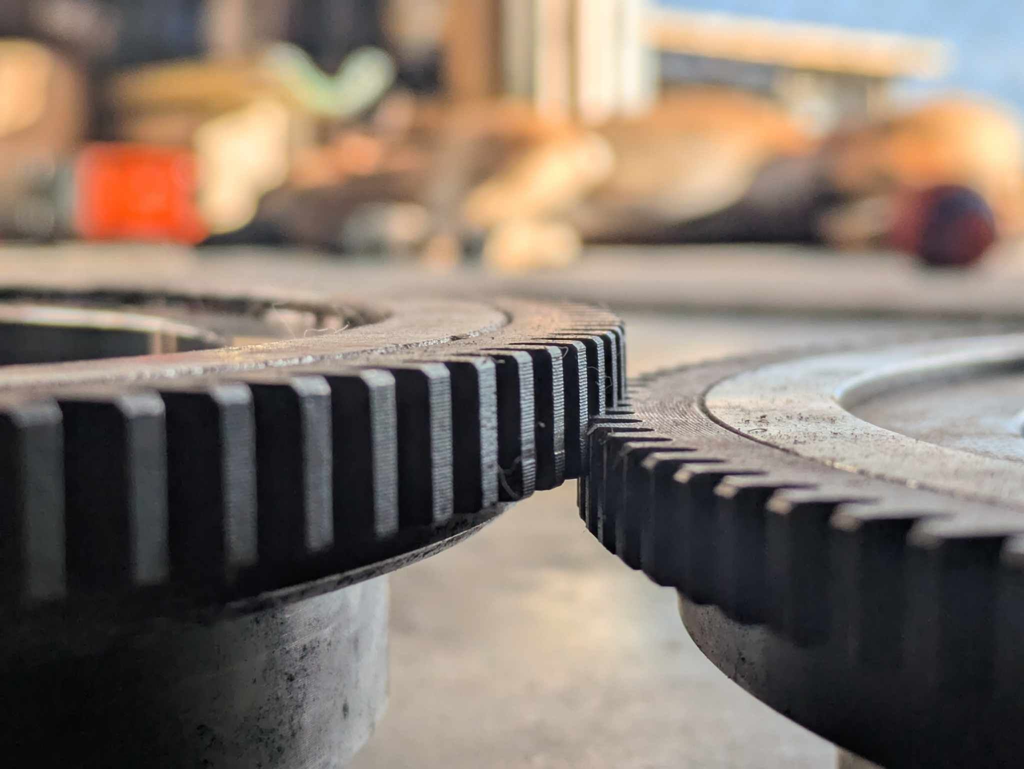

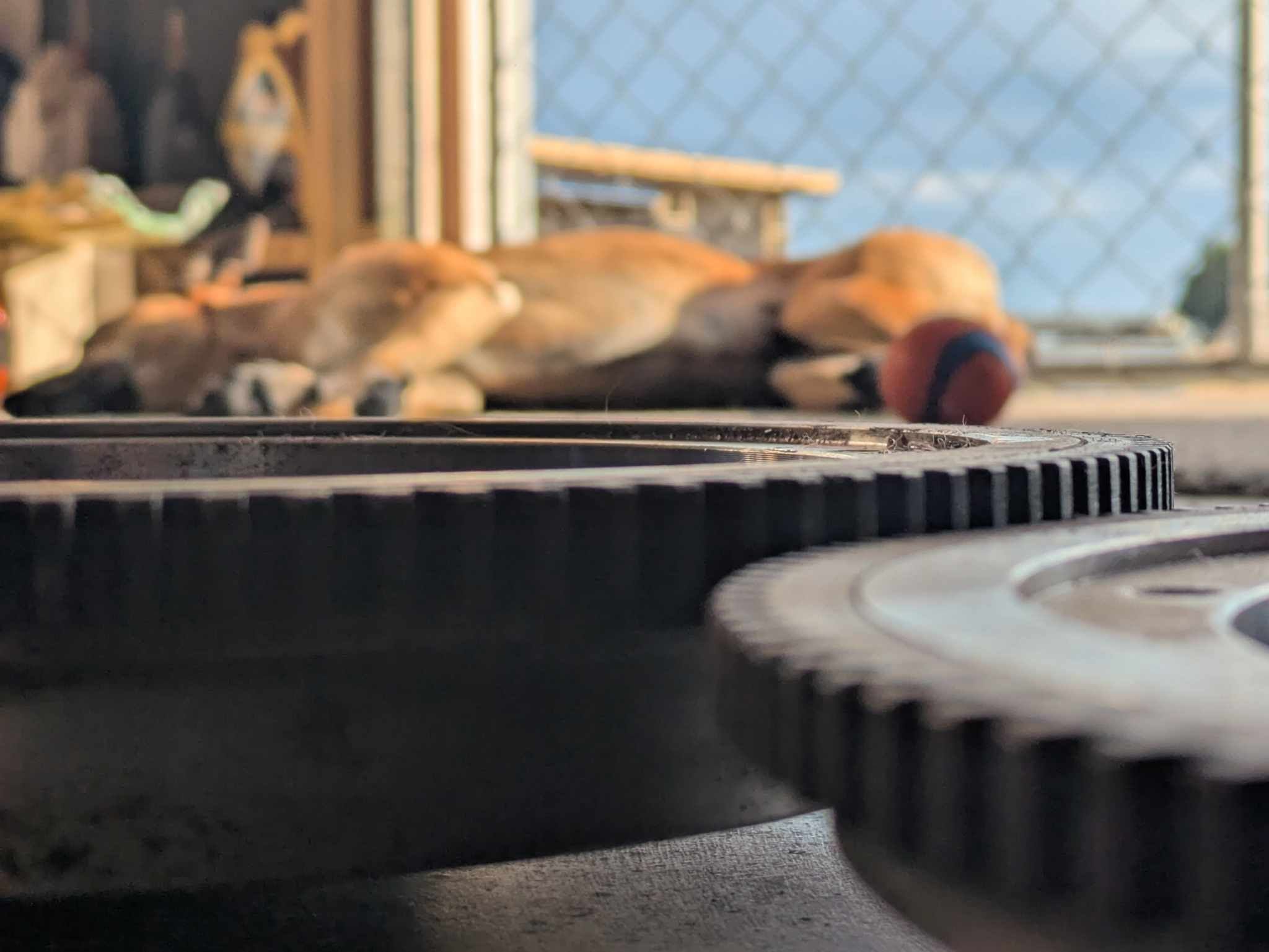

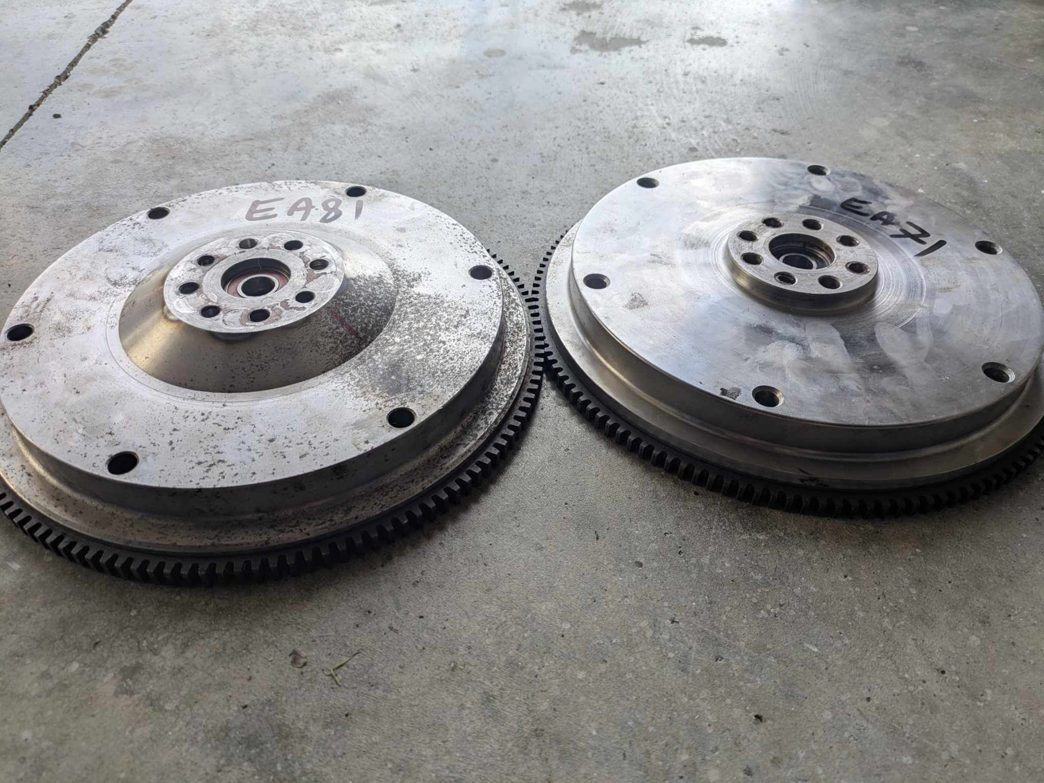

Some differences between the two adapters:
Rear of flywheel to front of ring gear:
EA71 = 34.5mm
EA81 = 36.5mm
Ring gear thickness
EA71 = 8mm
EA81 = 9.5mm
Adapter plate face (not locking tab) to edge of ring gear:
EA71 = 37mm
EA81 = 41.5mm
So what should I do to fix this never ending nightmare of a project?
1. Burn it
2. Push it back into the shed and put a tarp over it for 6 months
3. Find a clapped out VW buggy and take the datto/toyota from that and sell the Subie engine (worth more than the car)
4. Machine the ring gear down/back
5. Put in a 10mm spacer (plenty of meat on the bellhousing/adapter bolts to do this)
6. Grind the bellhousing inside (not keen)
7. Machine the crankshaft facing side of the flywheel which means less meat but should move it back some.
8. Drop it all off at the machine shop when he is out grabbing lunch and deal with the fallout later.
Open to other ideas logical or otherwise.

56 minutes ago, yoeddynz said:
how much meat is there on the flywheel hub ? A bit off that and a bit off the wider ring gear and seat would give you the room?
Through the bolt hole to the face the 81 has 18mm and the 71 has 11mm.
Seems the easiest way would be to hack off some at the back of the flywheel and then step it so it remains the same diameter of the crank.
I'm not sure that even my 4 jaw would hold that flywheel in order to machine the boss down. I have no faceplate either.  @HumberSS do you know anyone with a machine shop/large lathe?......:thumbright:
I fortunately I'm in the same boat. Sold big lathe. Instantly regretted. 250 diameter is about my max
A lathe is the logical choice but could you machine it down in a mill or similar as you would a block or head? I was also thinking you could mount it up using a destroyed subbie crank by cutting off the rear main journal and where it mounts to the flywheel but you want to get at that part to thin it out...:oops: You might be able to finish it off that way if necessary?

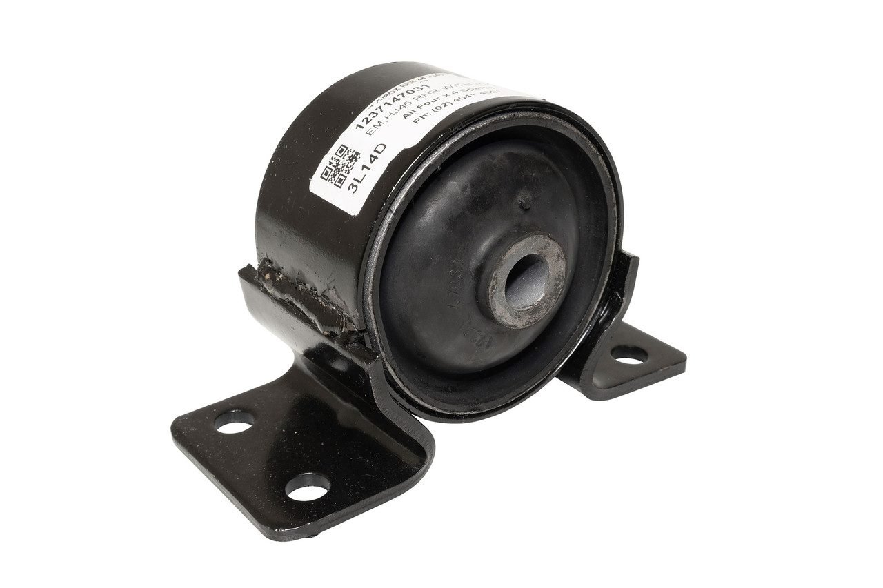

Can anybody think of an engine mount that isn't as heavy duty as a land cruiser that is similar to the below? The smaller the better really.
I want to put them around here. That way I can weld in a crossmember to the side plates which will help stiffen the rear up.
gallery carousel 1
Volvo make one that is much cheaper. Plus here is a picture of my twin and I in front of a Volvo so that's the sort of engineering calculations I can get behind.
No description available.
