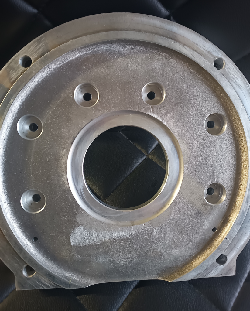

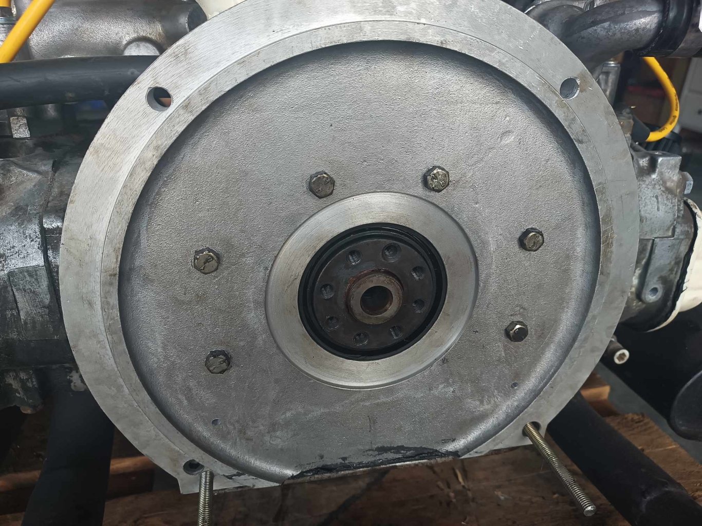

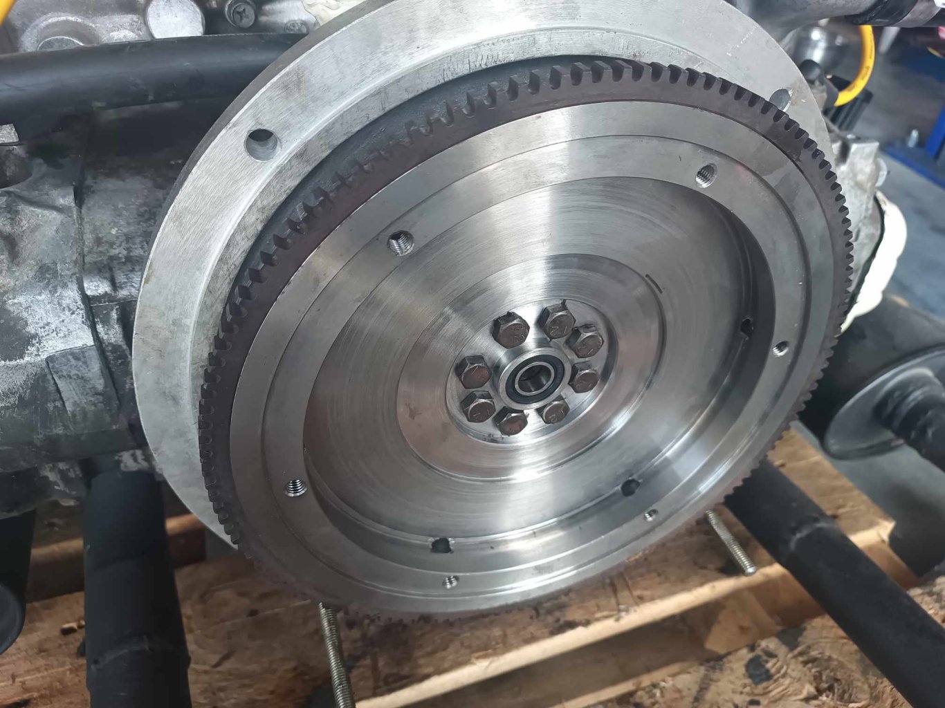

So having a bit of a drama fitting the adapter plate for the VW gearbag. The bolts that attach the plate to the block are fouling the flywheel. Am I missing a trick here?
The holes aren't counterbored which would have solved that problem. I went to my normal bolt supplier and their low profile cap screws are the same height as a normal hex head at 5mm. Countersunk screws I'm not sure will have the surface contact area I need.
I'm unsure if a button head screw would be too high a profile also. Google brings up space saving bolt head items from places in Asia which I'm not interested in as it'll take three months to arrive.
Any ideas? Torque the bolts down and grind them lower in situ?

That sort of adaptor uses countersunk screws normally don't they?
Most of the force on the gearbox would be torque/rotation so the mounting bolts will be loaded in shear so should be fine.

Every one I have used has always been countersunk. This one isn't.
I'll do a quick check for low profile screws/bolts but if nothing doing Ill just grind them down until it clears.

So old mate fucked up and forgot to counterbore the mounting holes.
Ffs. Im one stubbed toe away from this being put under a car cover and put in the big shed at the back.
This is how it was supposed to be done but I guess he forgot.

Ended up getting it machined locally. Frustrating but what can you do really.

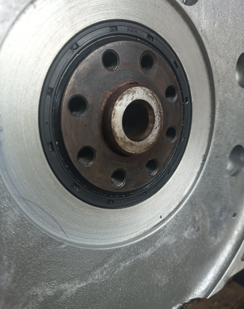

Can anybody let me know if the rear main seal is the correct way round please? I'm second guessing myself. The hollow part faces the front of the engine.
Yes oil pressure pushes the seal lips against the crank.

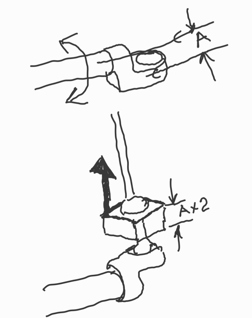

@dmulally like I said this morning on the reverse gearstick anonymous phone call, you don't have to make it as poncy as mine. Just rotate your under tunnel shaft 180 degrees so flipping the forged socket to the top and raise the gear stick fulcrum the required amount (30mm iirc), so reversing your across gate movement....
I had a look through the spares bin and found half a shaft (you have the front part) and most of a shaft setup. Ill have a bit of a play.
I'll still see if I could be bothered though. Anything I do make will be rough enough to make a David Brown owner blush.
What does A mean in your CAD drawing above?
'A' is just the distance between centreline of shaft and the centreline of the socket.
You'll need to raise the gearstick fulcrum twice that distance once you have turned the shaft around.
