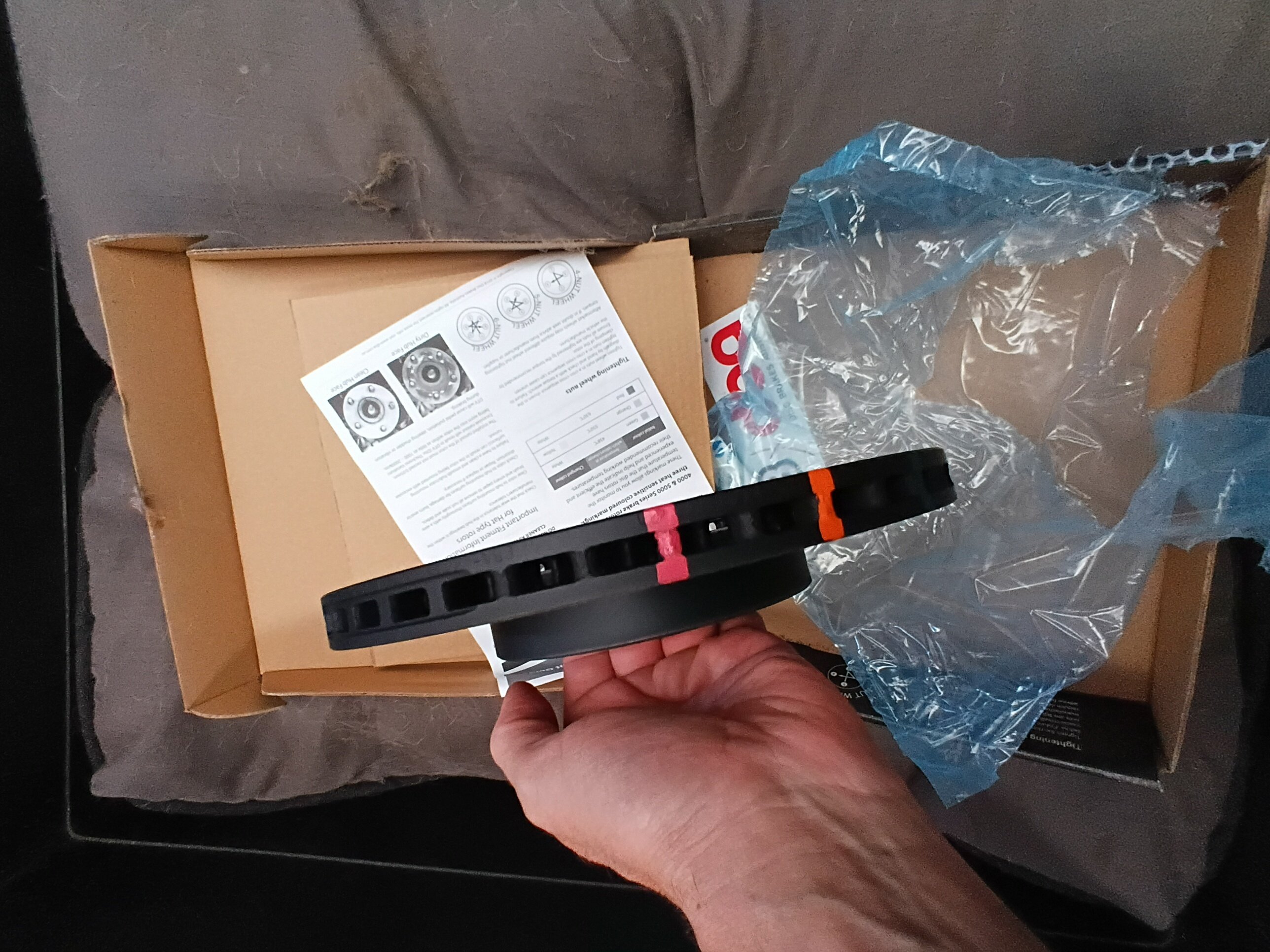

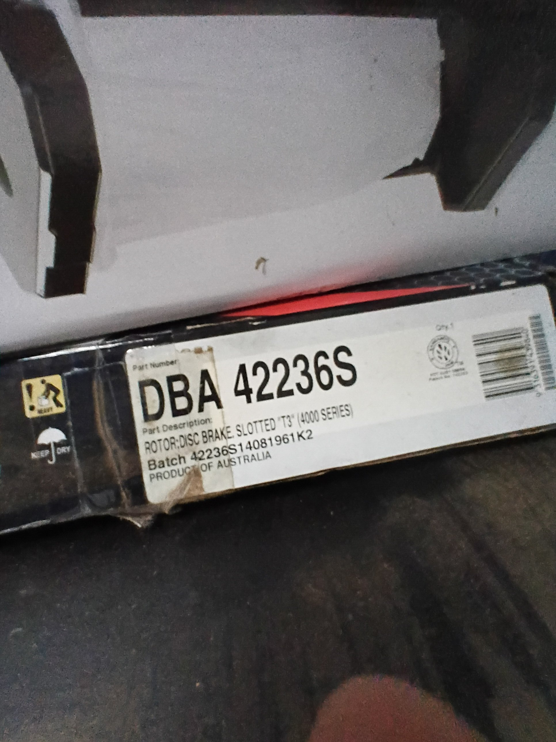

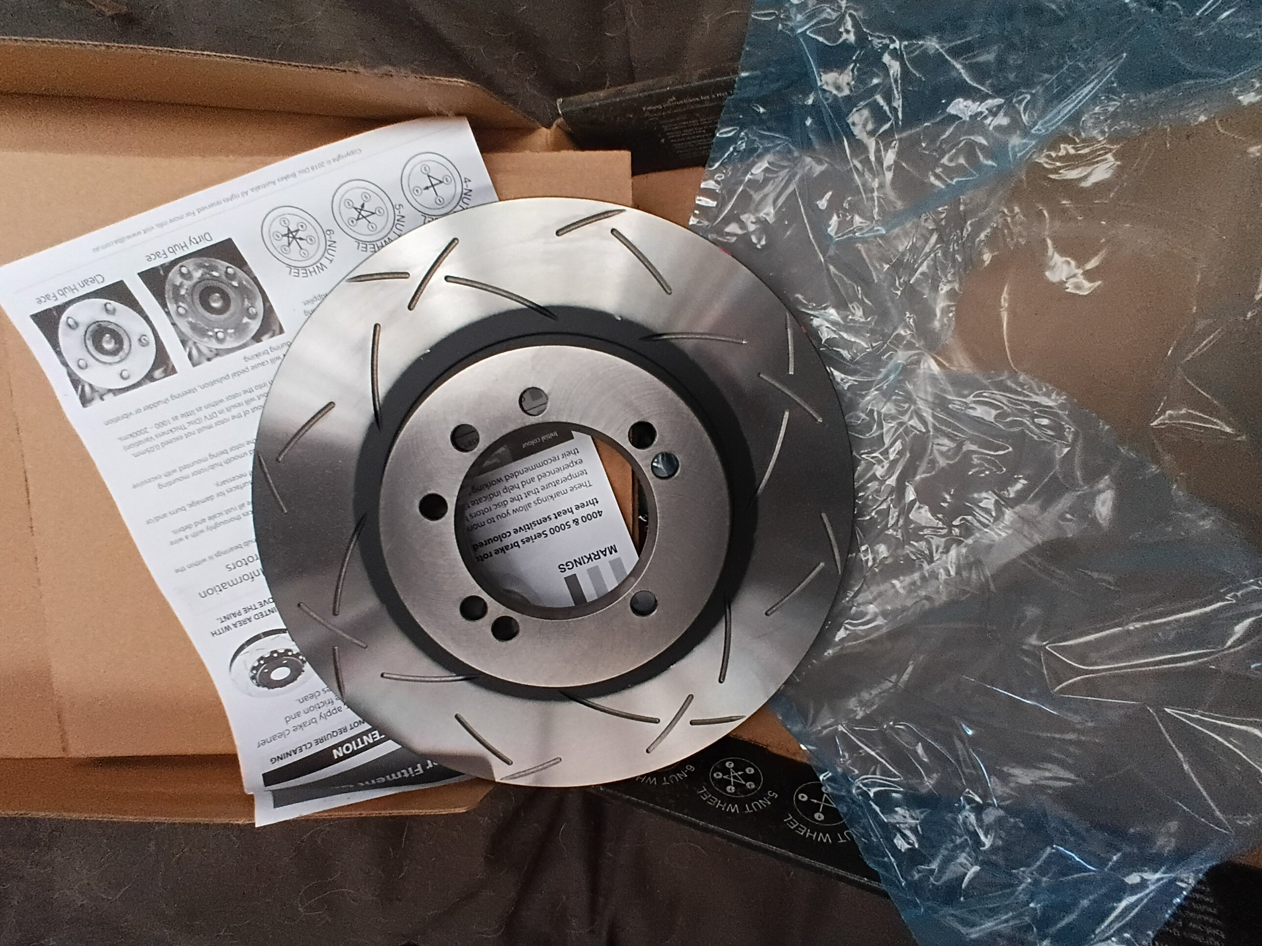

  3. Re brake upgrade. 504? Peugeot discs and hulux 4pots bolt on. 20mm vented disc. Downside was because the peugeot is so obscure the discs were hard to get. @sheepers gave me the name of some parts store in aussie that had DBA cast a whole lot mainly for crown conversions, cant recall the name sorry

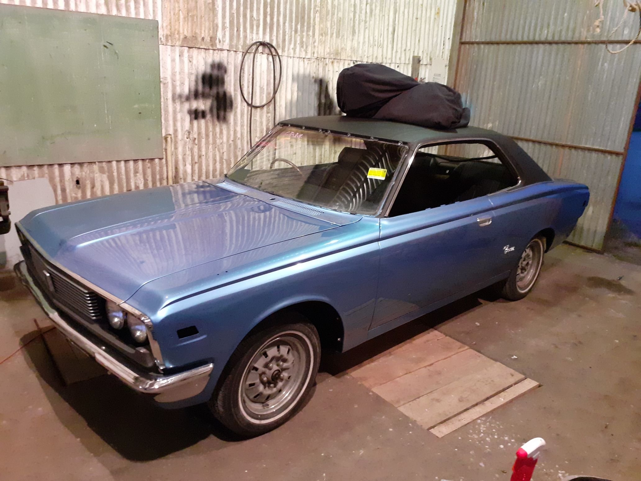

  12. Hadn't really done much with this. Mostly because it was just rubbish to drive. Bit the bullet and got stuck into doing an engine transplant. Brought a well used ms123 crown for the running gear. Gave the engine a paint job rebuild and proceeded to fit it into the coupe. For the most part it bolted in. Had to modify the crossmember and make a new driveshaft as the transmissions are a different length. Lots of small things need modifying as the coupes engine bay is about 100mm narrower and a 100mm shorter then the doner crown. Biggest battle was getting the wiring loom intergrated into the existing car loom, definitely not one of my strong points but muddled my way through. Replaced the steering box with a new one I got off yahoo,so stoked, made all the difference to the feel of how it drives. Happy days
