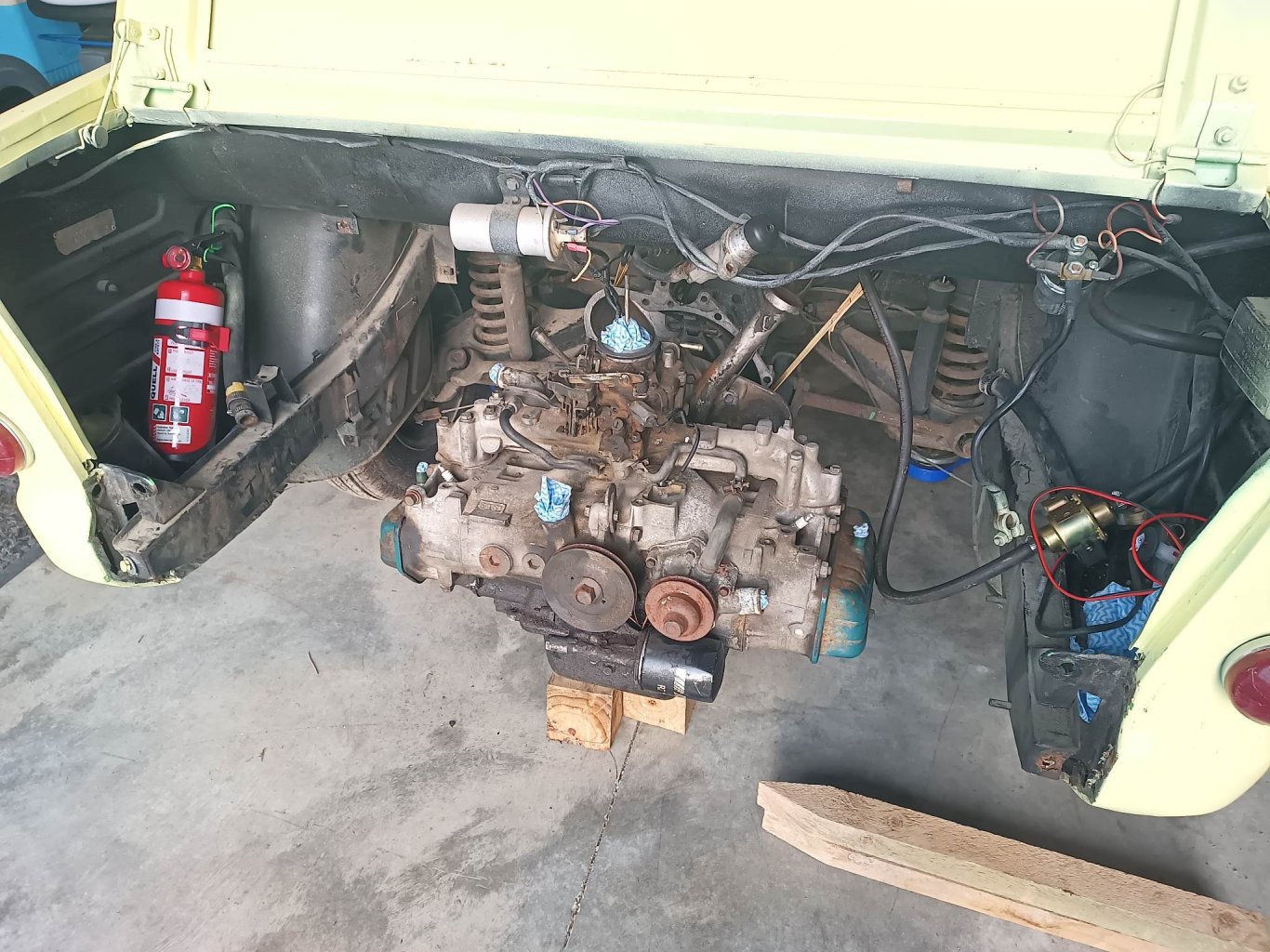

I tried fitting the Honda V twin bike engine I had in the parts bin but it is too long. Something I've never had to worry about in my life :(
Not sure. He posted it up on the nz impers facebook group ages back. I don't know if he's got any further than sitting it on a bit of wood and taking a photo. But yeah- lots of room.  Looks like some sort of quad bike diff in front?  How do leafs go in reverse- I presume the motor just runs in reverse?

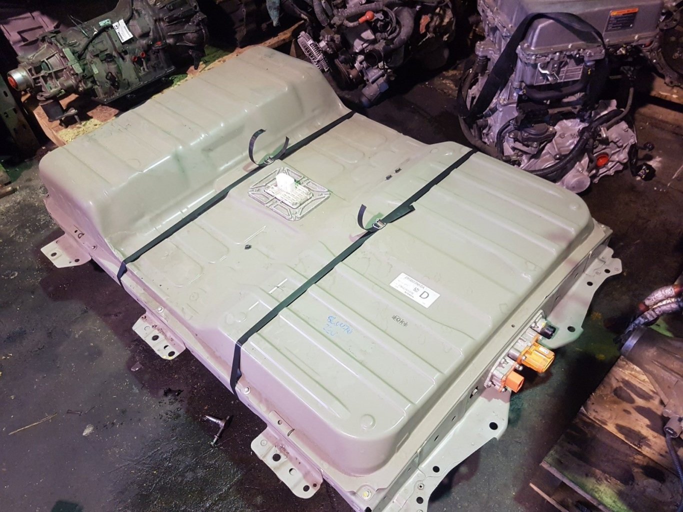

Being an electric motor I assume you could just flip a switch and make it go the other way. With the Thunderstruck control unit that is possible.
I think the bigger issue would be battery physical storage. Unless the Leaf batteries can be pulled apart and repackaged or it could take aftermarket batteries it would be hard to fit.

Nissan leaf battery on trade me.
I could park two imps on that!
More if they would start to be able to drive onto it.

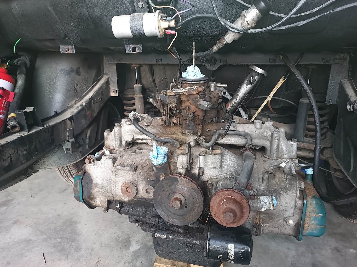

So the subie EA18 fits nicely. Only mods required looks to be the air filter/carb arrangement and the oil filler tube. Thankfully the tube is mild steel so I can shorten it and face the correct direction rather easily.
That inlet manifold needs a bit of a trim with all the extra lumps and bumps sticking out of it as well as I don't need all the vacuum ports and whatnot. Interestingly the original heater pipes on the EA18 are a similar diameter to the Imp front radiator tubing so I can still use that. But the diameter for the original outlets for the radiator are far larger. I'll have a think about it but perhaps having a radiator front and rear could be handy. I could also gut the subie water pump and just use the davies craig one I'll be installing shortly for the Imp engine. See how I go I guess.
Gearbox will be a VW freeway flyer IRS box (3.8/0.82). I've already ordered that as well as an adapter for the subie to VW. I think the one main thing I'll need is a starter but I'll wait until I have the ring gear in hand to check what I have.
