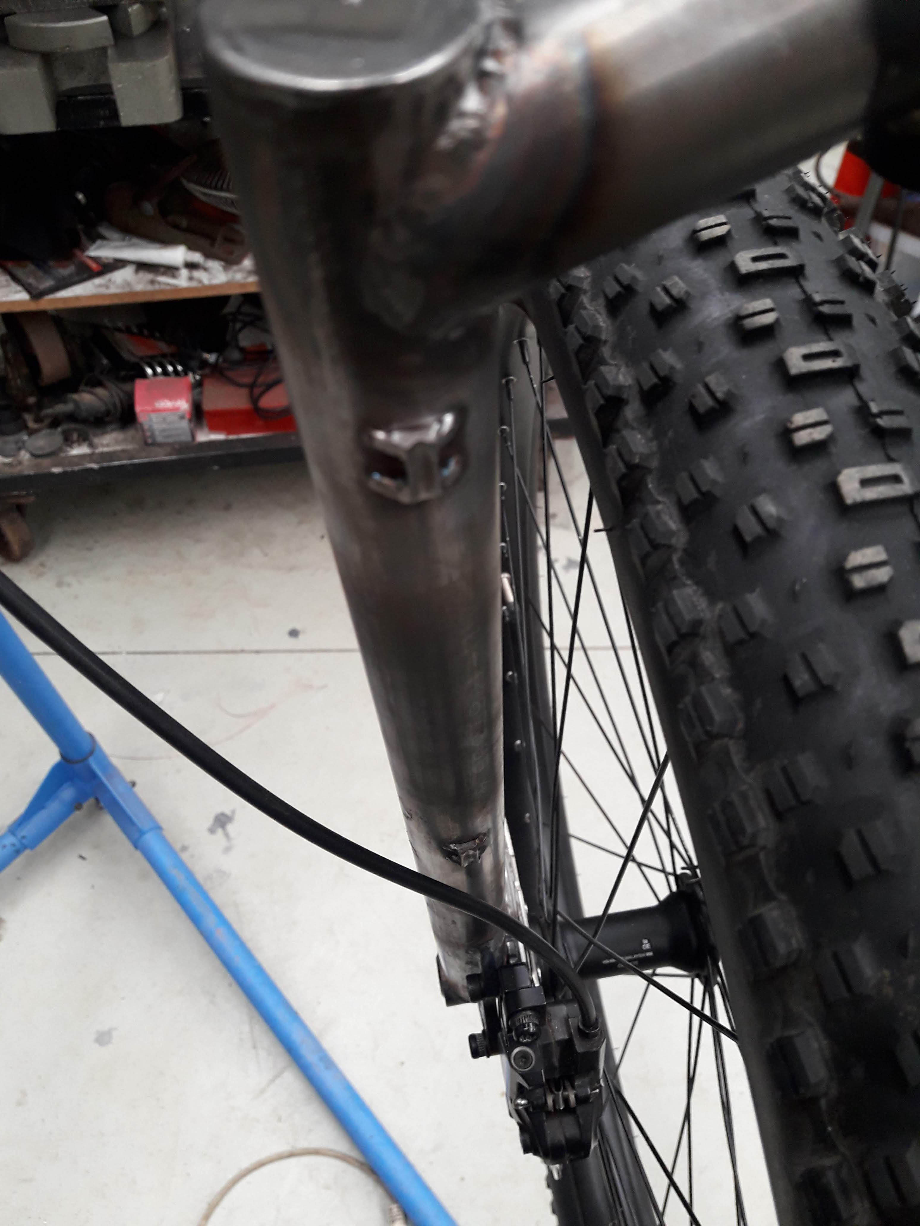

So this is about when lockdown happened. I was contemplating buying cable guides/ braze ons or whatever, but never got around to it and now I have plenty of time on my hands and no cable guides. So I had a look at the general design of the cable tie type hose guides and tried to to think of how I could make something like that using the lathe and not much else.
I started off by making a spool/cotton reel shape with a 5mm hole through the centre like this:
and then filed a mitre into the rim with a round file:
And then cut out with grinder or hacksaw. I found grinder made for less cleanup work afterwards
First and second guides in place:
These 2 are a little on the low side and will probably end up with the paint underneath them rubbed off when the frame is done but most of the other cable guides I have put on have adequate clearance

There's not much left to go! First up was a bit more cable routing, I made a few more cable tie hose guides and popped them on for the derailleur and the front brake hose

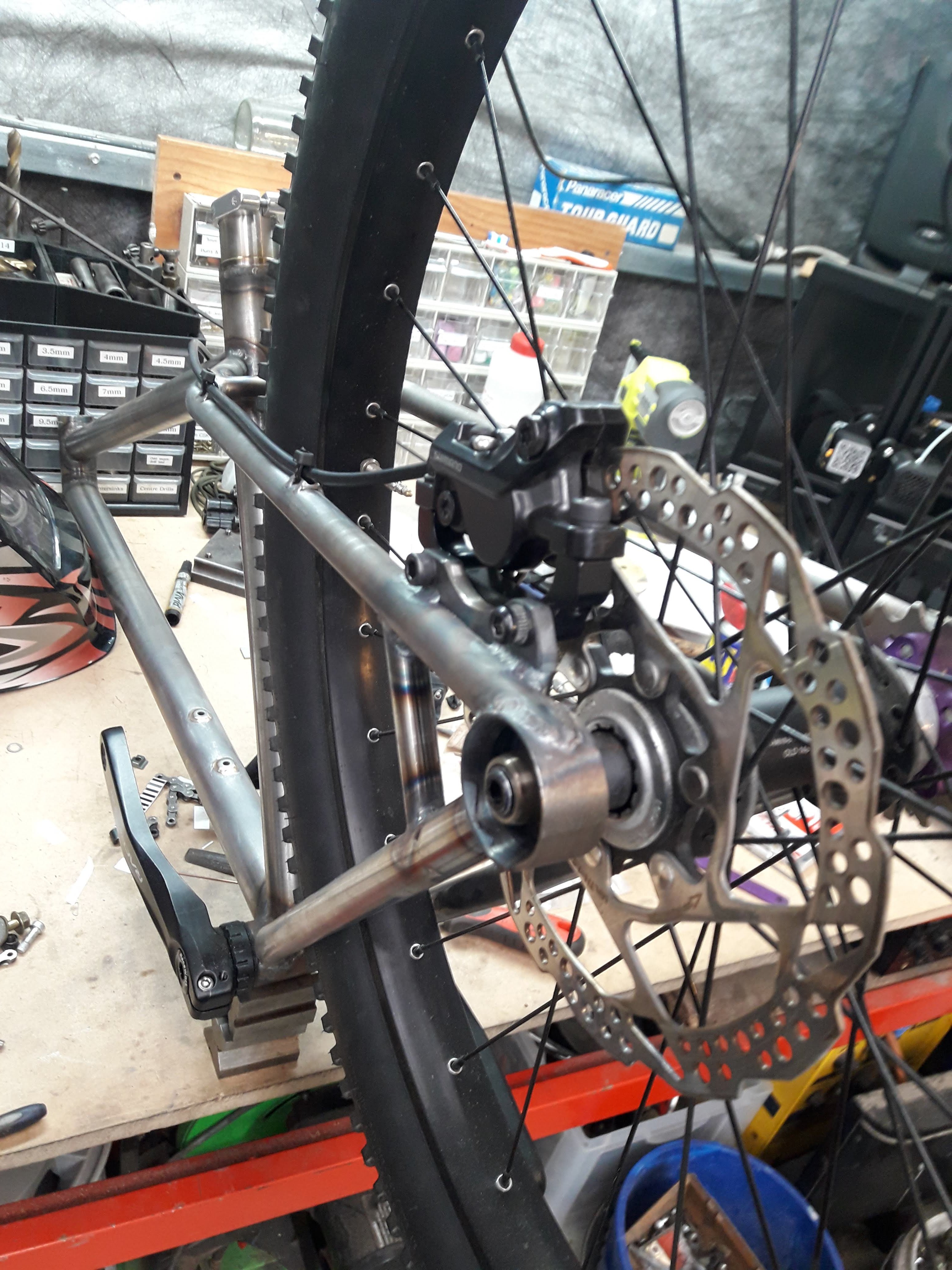

I put couple of coats of 2k primer on the frame (no colour coat yet) and after looking at it sitting in the corner of the lounge for the working week dreaming and pretending to ride it much to the amusement of @hampie, Friday came around. I don't work Fridays so I was free for the day, so I took stock of what I needed to get the bike all together and all that was left was a length of shift cable. So I made a click and collect order and popped down to Te Awamutu and came back and got everything all assembled.
Sorry pics are fuzzy, crappy cellphone life.
The drivetrain is a deore 11 speed, it's actually destined for a different bike but for now it can go on this one. There are some issues around shifting I think partially due to the B screw end point pawl on the hanger being too far to the rear of the bike. I have shortened it a bit since my first ride and it has improved a bit, I think I probably need to check the hanger alignment again as well. Also, there's a weird combination of boost standards with a 68mm bb shell so I think the chain line needs a bit of attention.
