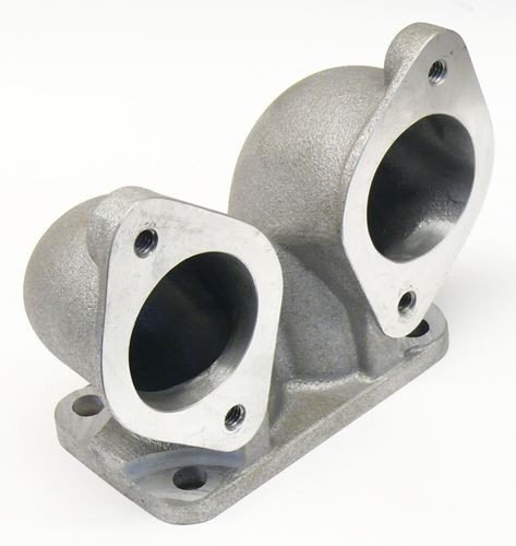

Otodat Posted March 8, 2020 Report Share Posted March 8, 2020 Option 4 seems like the easiest/cheapest way to go. Could you maybe put efi or throttle body injection on to save room, a lot of fafing about though. Or another option could be a right angle from the manifold to the front or back and put a su carb on? Anyways, keep at it, like where you’re headed with this. 2 Quote Link to comment Share on other sites More sharing options...
Nominal Posted March 8, 2020 Report Share Posted March 8, 2020 26 minutes ago, Otodat said: Option 4 seems like the easiest/cheapest way to go. Could you maybe put efi or throttle body injection on to save room, a lot of fafing about though. Or another option could be a right angle from the manifold to the front or back and put a su carb on? Anyways, keep at it, like where you’re headed with this. I like the way you are thinking - an SU on either a right angle adapter or a pipe manifold should be able to be tucked in somewhere. Quote Link to comment Share on other sites More sharing options...
Flash Posted March 8, 2020 Author Report Share Posted March 8, 2020 Good thoughts fellas. I remember those right angled adapters for putting a side draft in place of a Weber downdraft. Looked like this. An SU could be an option. Thanks for sharing. 4 Quote Link to comment Share on other sites More sharing options...
CUL8R Posted March 9, 2020 Report Share Posted March 9, 2020 + 1 for the SU, someone else beat me to it. That or you could run a right angle adapter and have a sidedraught sitting "ontop" of the motor... 2 Quote Link to comment Share on other sites More sharing options...

Flash Posted March 9, 2020 Author Report Share Posted March 9, 2020 2 hours ago, CUL8R said: + 1 for the SU, someone else beat me to it. That or you could run a right angle adapter and have a sidedraught sitting "ontop" of the motor... Thanks, I really need to do more homework on the SU option. Good suggestion regarding the right angled adapter too. I need to try to dig up some dimensions for the "off the shelf" adapter to check that it will clear the rocker cover. 1 Quote Link to comment Share on other sites More sharing options...
