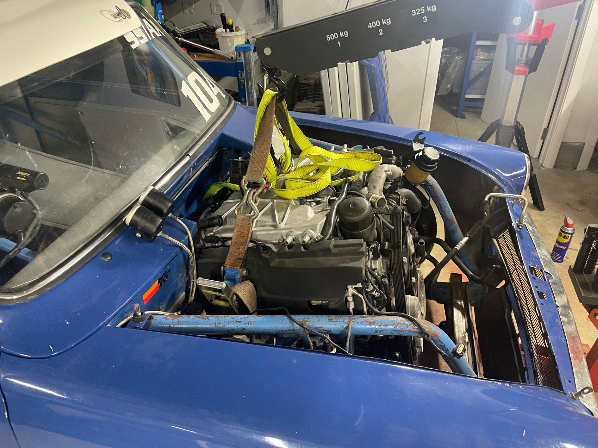

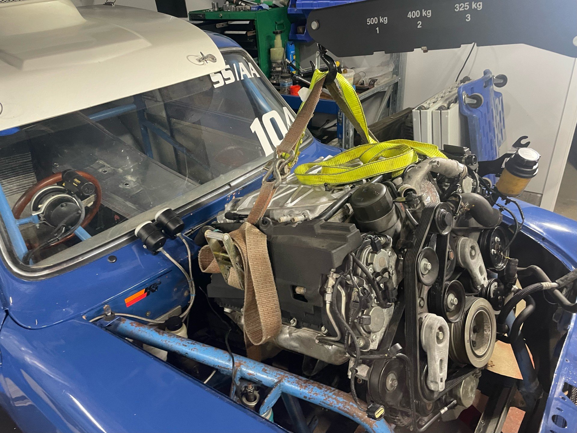

had a few spare hours the other night, so thought I would see if the spare "Ford built" V8 would fit. After a bit of lifting, craning, pushing and shoving, removing a few parts which were in the way I got it most of the way in. Sump would not go down past front crossmember, so will need to remove that first, lift the car on stands, then try again. Looks like it will fit without any surgery though, so that's a plus. Should have got a bigger shoehorn. It's off to Cletus in a week for a "pre-certification" inspection, and that will help me decide if I want to make it street legal again. Lots of ugliness has been uncovered, but it is mostly small shit that is fairly easy to sort. As long as there aren't any large fundamental changes required, such as remove the rollcage and do it all again, then I think we will be okay. Fingers crossed!
