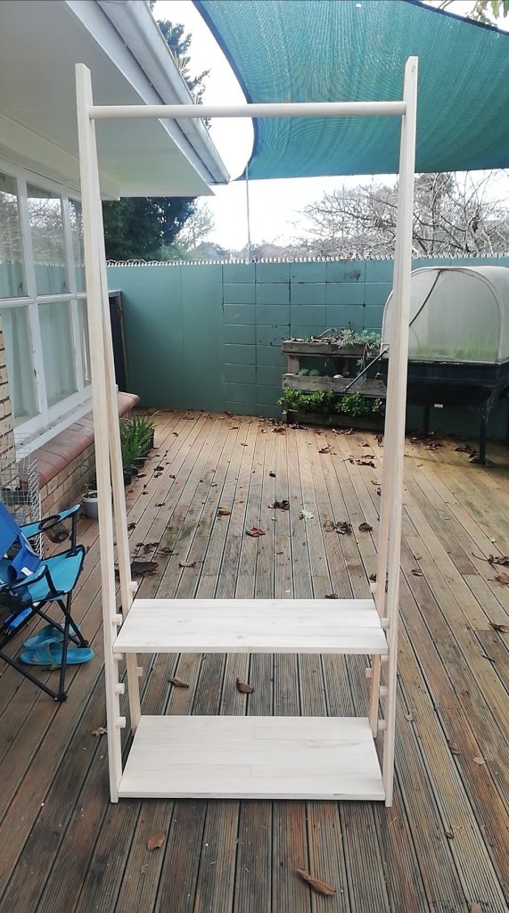

Popular Post tortron Posted June 14, 2020 Popular Post Posted June 14, 2020 Wife sent me this picture a few days ago I told our neighbor you would make this for her. No, just buy one, it will be cheaper Apparently none available. So today they are getting this She wanted a removable shelf, so I went one better and made it adjustable 18 1 Quote

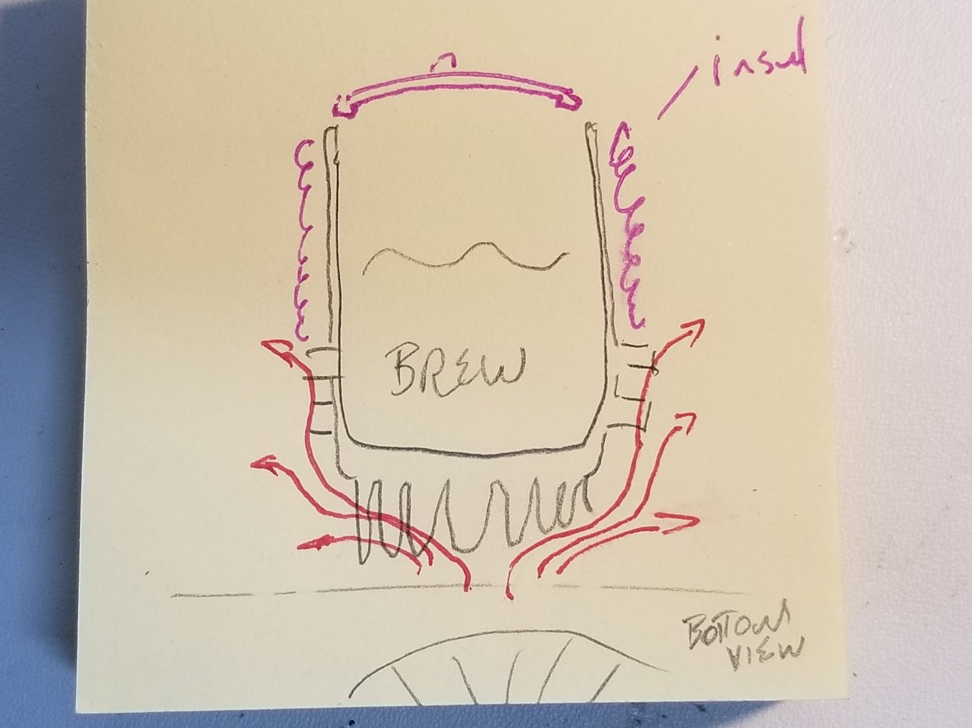

h4nd Posted June 14, 2020 Author Posted June 14, 2020 On 06/06/2020 at 09:32, Willdat? said: https://www.gearshop.co.nz/products/jetboil-micromo-cooking-system?variant=29523955286114¤cy=NZD&utm_medium=product_sync&utm_source=google&utm_content=sag_organic&utm_campaign=sag_organic&gclid=CjwKCAjw2uf2BRBpEiwA31VZjxNWWOzPDchYBoT78rTMf3xuWrTjfx5RqIjrt58LbRz92Lf6rA69XRoCbc8QAvD_BwE I have one of these, 12L /100g and boils 500mL in 2 mins. I was super cynical until a guy next to me set up, cooked, ate and cleaned up before I'd even boiled with my meths burner. Cool. It looks like 80% of the benefit is using a heat-sink in the base in reverse to couple the flame heat into the liquid, and also insulating the sides. I wonder if it'd be worth passing the exhaust up the side a bit, too Or something like this: https://www.wired.com/2014/07/a-jet-engineer-designs-a-saucepan-that-heats-up-super-fast/ Maybe even with a shroud up around the gas to keep it in to the sides of the pot, during the windy. Step one, glue 486 heatsink to bottom of pot? 1 Quote
tortron Posted June 14, 2020 Posted June 14, 2020 MSR make/made these copper heat exchangers The problem being it's actually quite a niche market. Most hikers won't hike long enough to get the fuel benefit of carrying it. Easier to carry an extra boils worth of fuel. Takes a while for the weight to pay itself off. Most useful when you are melting a shit tonne of snow for water, so the market is extended mountain climbing for groups 5 Quote

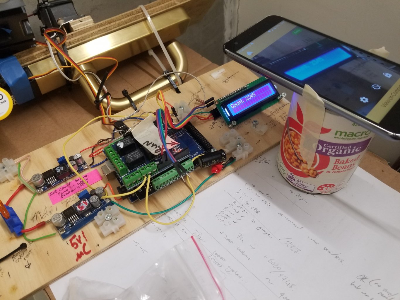

h4nd Posted June 15, 2020 Author Posted June 15, 2020 Back on topic, nerds I made a test jig out of bean tins, RC servos and spit. It worked great: 3 Quote

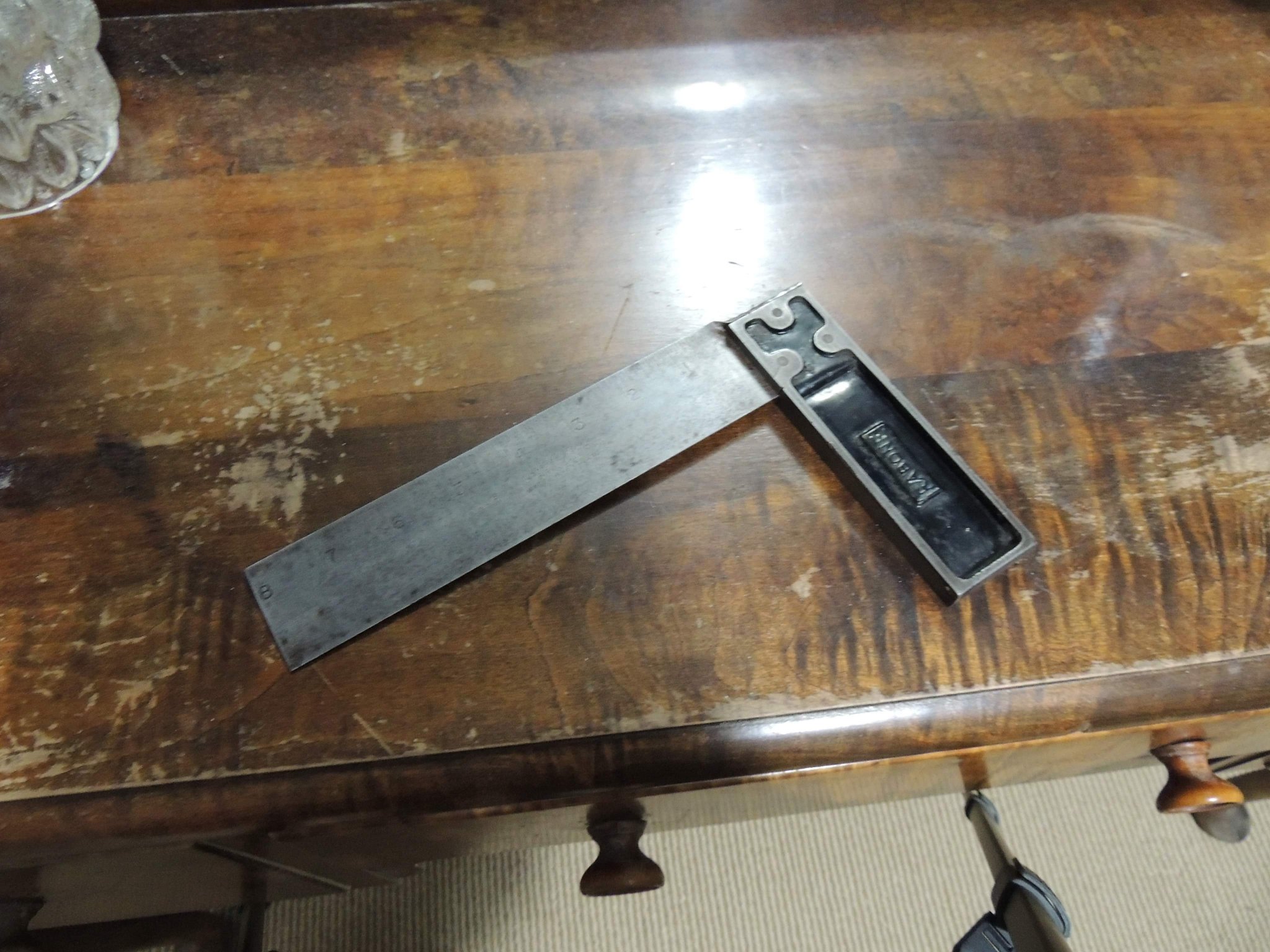

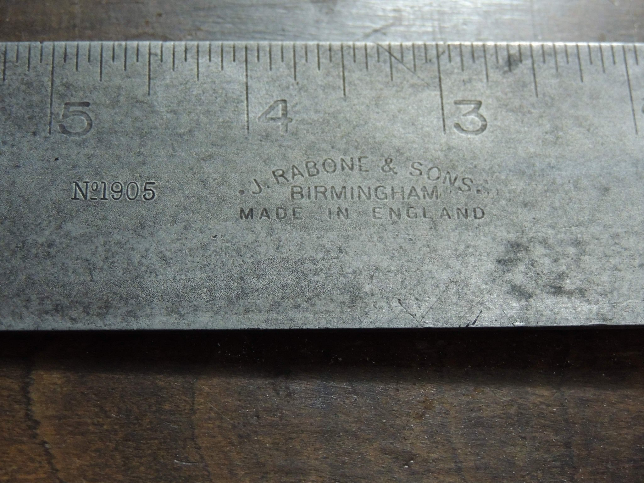

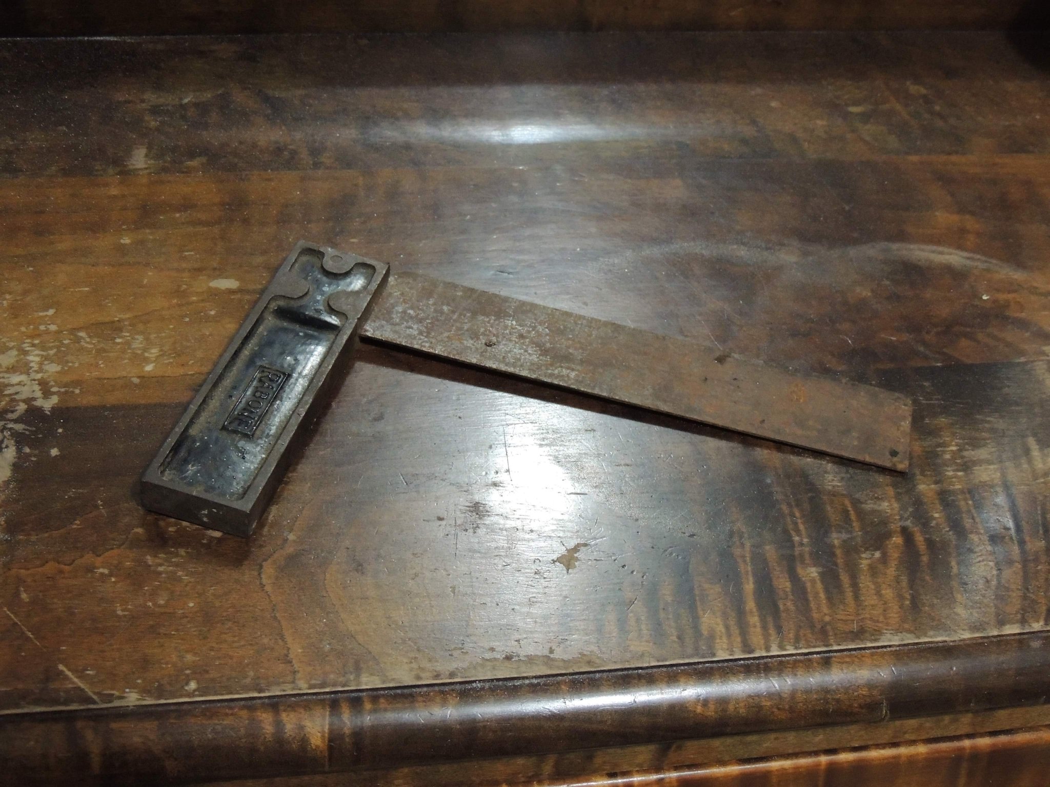

Popular Post MightyJoe Posted June 28, 2020 Popular Post Posted June 28, 2020 I bought this and a trowel today for $3 . Didnt expect much but it had weight to it. An hr with some wet and dry and it turns out its got some age and was a good make in the good old days. 'Rabone no1905 8". ' 13 1 Quote

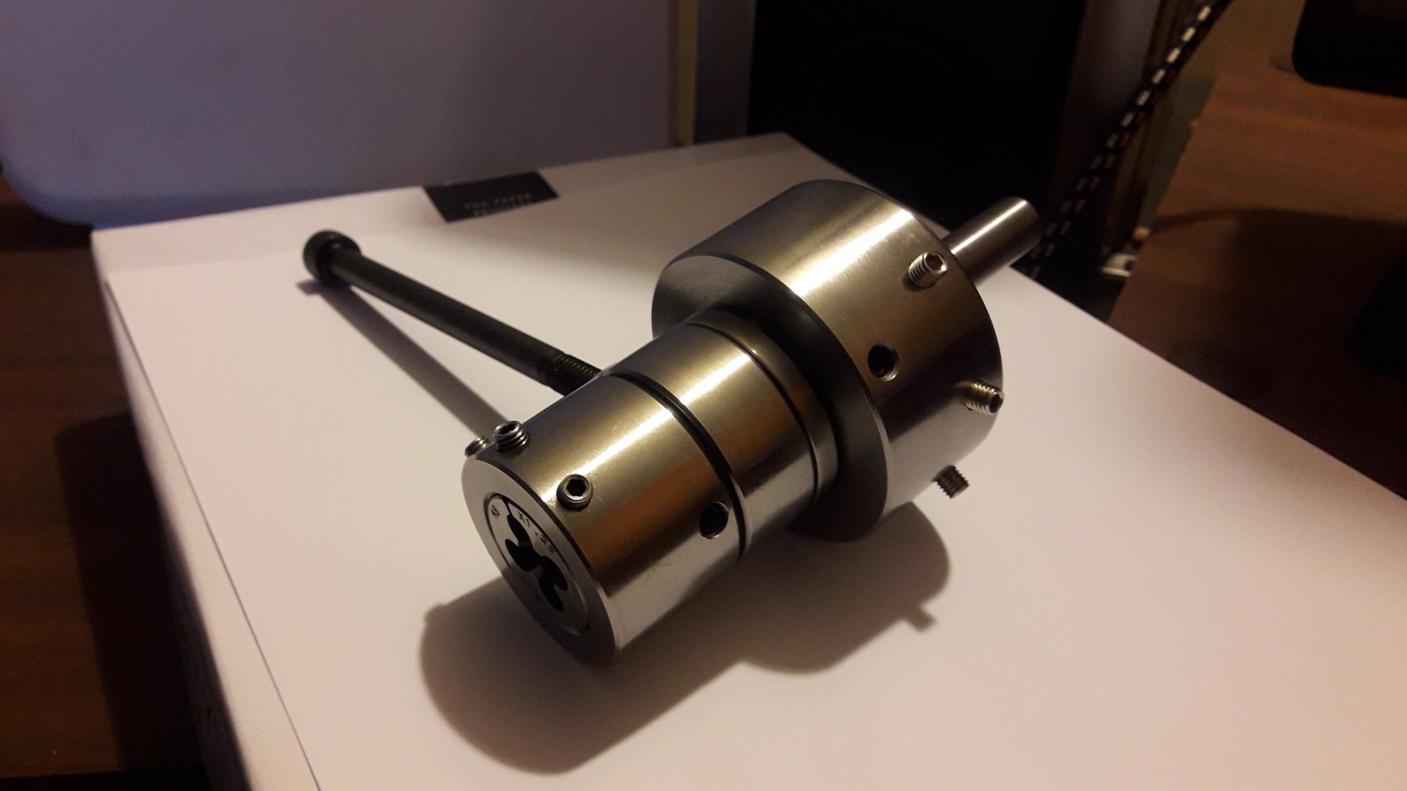

Popular Post ajg193 Posted June 30, 2020 Popular Post Posted June 30, 2020 Here's a tool I've been making recently. I still need to make a good handle for it, but to be honest the cap screw is probably stronger than any handle I could make. The clutch in the middle is hardened to reduce the risk of galling when it slips (adjustable preload, allows slipping when die binds or you hit a shoulder) 19 Quote
