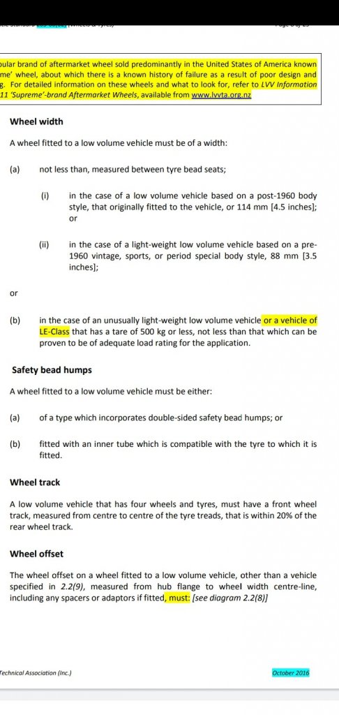

JoKer Posted January 23, 2020 Posted January 23, 2020 2020 thread update : here's current file on the LVVTA site https://www.lvvta.org.nz/documents.html#thresholds Quote Info 01-2009 - Tyre Size to Rim Size Compatibility Guide (V3, released December 2016) https://www.lvvta.org.nz/documents/infosheets/LVVTA_Info_01-2009_V3_Tyre_Size_to_Wheel_Size_Compatibility_Guide.pdf Quote INFORMATION SHEET # 01 - 2009 (V4 March 2018) Page 1 of 7 Tyre Size to Rim Size Compatibility Guide Background: The purpose of this LVV Information Sheet is to provide a complete source of information regarding tyre and rim size compatibility to LVV Certifiers. It was found that the original version of this info-sheet was very narrow in its scope, and was largely directed at vehicles which had been modified in a particular style. This fourth version has been released in order to give a greater range of fitments and options, and should give LVV Certifiers a helpful tool to ensure wheel & tyre compatibility on most commonly available types of passenger vehicle. Legal Requirements: Paragraph 2.6(1)(b) of Low Volume Vehicle Standard 205-00 (Wheels & Tyres), states that tyres must be an appropriate selection for the type and width of wheel to which they are fitted. Compatibility Tables: The information contained in the following tables has been provided by tyre manufacturers and tyre experts. These tables don’t cover all possible tyre sizes, but should cover most common fitments. Where the tyre size is not listed, the general patterns found in these tables should be followed to determine the correct fitment range. We ask all LVV Certifiers who are presented with a vehicle with tyres that appear to be too narrow or too wide for the rims, to check these tables to ensure that the tyre size is compatible with the wheel-rim size. Individual Tyre Manufacturer’s Variations: Whilst we have made every reasonable effort to ensure that the information contained in this information sheet is correct, specifications regarding tyre size and fitment vary between tyre manufacturers. Where our sources have provided us differing specifications in compiling this info-sheet, we’ve broadened the range to encompass the minimum to the maximum rim width, allowing for the broadest possible fitment range. Additionally, where an LVV Certifier is presented with a wheel & tyre combination which is outside the scope of the tables in this info-sheet, LVVTA requires that the guidelines of the tyre manufacturer in question are followed, and verification from the tyre manufacturer is provided by the LVV Certifier when forwarding the LVV plate application. LVVTA Information Sheet # 01-2009 (V4) Page 2 of 7 Passenger Car 10 Inch – Passenger Car Tyre size Rim width (inch) 145/70R10 4.0 – 5.0 145/80R10 3.5 – 5.0 155/70R10 4.5 – 5.5 155/80R10 4.0 – 5.0 165/70R10 4.0 – 6.0 12 Inch – Passenger Car Tyre size Rim width (inch) 145/70R12 3.5 – 5.0 145/80R12 3.5 – 5.0 155/70R12 4.0 – 5.0 155/80R12 4.0 – 5.0 165/60R12 4.5 – 6.0 165/70R12 4.0 – 5.5 165/75R12 4.0 – 6.0 175/70R12 4.5 – 6.0 13 Inch – Passenger Car Tyre size Rim width (inch) 145/70R13 3.5 – 5.0 145/80R13 3.5 – 5.0 155/65R13 4.5 – 5.5 155/70R13 4.0 – 5.5 155/80R13 4.5 – 5.0 165/65R13 4.5 – 6.0 165/70R13 4.0 – 6.0 165/75R13 4.0 – 6.0 165/80R13 4.0 – 5.5 175/60R13 5.0 – 6.0 175/70R13 4.5 – 6.0 185/60R13 5.0 – 6.5 185/70R13 4.5 – 6.5 205/60R13 5.5 – 7.5 215/50R13 5.5 – 8.5 215/60R13 6.0 – 7.5 225/55R13 6.0 – 8.0 225/60R13 6.0 – 8.0 235/60R13 6.5 – 8.5 14 Inch – Passenger Car Tyre size Rim width (inch) 145/80R14 3.5 – 5.0 155/80R14 4.0 – 5.0 165/55R14 4.5 – 6.0 165/60R14 4.5 – 6.0 165/65R14 4.5 – 6.0 165/70R14 4.0 – 5.5 165/80R14 4.0 – 5.5 175/60R14 5.0 – 6.0 175/65R14 5.0 – 6.0 175/70R14 4.5 – 6.0 175/80R14 4.5 – 6.0 185/55R14 5.0 – 6.5 185/60R14 5.0 – 6.5 185/65R14 5.0 – 6.5 185/70R14 4.5 – 6.5 185/80R14 4.5 – 6.0 195/45R14 6.0 – 7.5 195/55R14 5.5 – 7.0 195/60R14 5.5 – 7.0 195/65R14 5.5 – 7.0 195/70R14 5.0 – 7.0 205/55R14 5.5 – 7.5 205/60R14 5.5 – 7.5 205/70R14 5.0 – 7.0 215/65R14 5.5 – 7.5 225/55R14 6.0 – 8.0 235/60R14 6.5 – 8.5 245/50R14 6.5 – 9.5 245/60R14 7.0 – 8.5 255/55R14 7.0 – 9.0 255/60R14 7.0 – 9.0 265/50R14 7.0 – 10.0 265/60R14 7.5 – 9.5 275/60R14 7.5 – 9.5 LVVTA Information Sheet # 01-2009 (V4) Page 3 of 7 15 Inch – Passenger Car Tyre size Rim width (inch) 155/80R15 4.0 – 6.0 165/65R15 4.5 – 6.0 165/80R15 4.0 – 5.5 175/60R15 5.0 – 6.0 175/65R15 5.0 – 6.5 185/55R15 5.0 – 6.5 185/60R15 5.0 – 6.5 185/65R15 5.0 – 6.5 195/45R15 6.0 – 7.5 195/50R15 5.5 – 7.0 195/55R15 5.5 – 7.0 195/60R15 5.5 – 7.0 195/65R15 5.5 – 7.0 195/80R15 5.0 – 6.5 205/50R15 5.5 – 7.5 205/55R15 5.5 – 7.5 205/60R15 5.5 – 7.5 205/65R15 5.5 – 7.5 205/70R15 5.0 – 7.5 215/55R15 6.0 – 7.5 215/60R15 6.0 – 7.5 215/65R15 6.0 – 7.5 215/70R15 5.5 – 7.0 225/50R15 6.0 – 8.0 225/55R15 6.0 – 8.0 225/60R15 6.0 – 8.0 225/75R15 6.0 – 7.5 225/80R15 6.0 – 7.5 235/55R15 6.5 – 8.5 235/60R15 6.5 – 8.5 235/75R15 6.0 – 8.0 245/60R15 6.5 – 9.5 255/55R15 7.0 – 9.0 255/60R15 7.0 – 9.0 275/55R15 7.5 – 9.5 275/60R15 7.0 – 9.5 295/50R15 8.0 – 10.0 295/60R15 8.0 – 9.5 315/60R15 8.5 – 11.0 345/55R15 10.5 – 12.5 16 Inch – Passenger Car Tyre size Rim width (inch) 165/80R16 4.0 – 6.5 185/55R16 5.0 – 6.5 195/45R16 6.0 – 7.5 195/50R16 5.5 – 7.0 195/55R16 5.5 – 7.0 195/80R16 5.0 – 6.5 205/40R16 7.0 – 8.0 205/45R16 6.5 – 7.5 205/50R16 5.5 – 7.5 205/55R16 5.5 – 7.5 205/60R16 5.5 – 7.5 205/65R16 5.5 – 7.5 215/40R16 7.0 – 8.5 215/45R16 7.0 – 8.0 215/50R16 6.0 – 7.5 215/55R16 6.0 – 7.5 215/60R16 6.0 – 7.5 215/65R16 6.0 – 7.5 215/70R16 5.5 – 7.5 215/80R16 5.5 – 7.5 225/45R16 7.0 – 8.5 225/50R16 6.0 – 8.0 225/55R16 6.0 – 8.0 225/60R16 6.0 – 8.0 225/65R16 6.0 – 8.0 225/70R16 6.0 – 8.0 235/60R16 6.5 – 8.5 235/65R16 6.5 – 8.5 235/70R16 6.0 – 8.0 235/80R16 6.0 – 8.0 245/50R16 7.0 – 8.5 245/60R16 7.0 – 8.5 245/70R16 6.5 – 8.0 255/50R16 7.0 – 9.0 255/60R16 7.0 – 9.0 255/65R16 7.0 – 9.0 255/70R16 6.5 – 8.5 265/50R16 7.5 – 9.5 265/70R16 7.0 – 9.0 275/60R16 7.5 – 9.5 LVVTA Information Sheet # 01-2009 (V4) Page 4 of 7 275/70R16 7.0 – 9.0 285/60R16 8.0 – 10.0 295/50R16 8.0 – 10.5 17 Inch – Passenger Car Tyre size Rim width (inch) 185/70R17 4.5 – 6.0 195/40R17 6.5 – 8.5 195/45R17 6.0 – 7.5 205/40R17 7.0 – 8.0 205/45R17 6.5 – 8.0 205/50R17 5.5 – 7.5 205/60R17 5.5 – 7.5 215/35R17 7.0 – 8.5 215/40R17 7.0 – 8.5 215/45R17 7.0 – 8.0 215/50R17 6.0 – 8.0 215/55R17 6.0 – 7.5 215/60R17 6.0 – 7.5 225/35R17 7.5 – 9.0 225/45R17 7.0 – 8.5 225/50R17 6.0 – 8.0 225/55R17 6.0 – 8.0 225/60R17 6.0 – 8.0 225/65R17 6.0 – 8.0 235/40R17 8.0 – 9.5 235/45R17 7.5 – 9.0 235/50R17 6.5 – 8.5 235/55R17 6.5 – 8.5 235/60R17 6.5 – 8.5 235/65R17 6.5 – 8.5 245/35R17 8.0 – 9.5 245/40R17 8.0 – 9.5 245/45R17 7.5 – 9.0 245/50R17 7.0 – 8.5 245/70R17 6.5 – 8.5 255/40R17 8.5 – 10.0 255/45R17 8.0 – 9.5 255/60R17 7.0 – 9.0 265/40R17 9.0 – 10.5 265/35R17 9.0 – 10.5 265/55R17 7.5 – 9.5 265/70R17 7.0 – 9.0 275/35R17 9.0 – 11.0 275/40R17 9.0 – 11.0 275/50R17 7.5 – 9.5 275/55R17 7.5 – 9.5 285/60R17 8.0 – 10.0 285/65R17 8.0 – 10.0 295/40R17 10.0 – 11.5 335/35R17 11.0 – 13.0 18 Inch – Passenger Car Tyre size Rim width (inch) 205/40R18 7.0 – 8.0 205/55R18 5.5 – 7.5 215/35R18 7.0 – 8.5 215/40R18 7.0 – 8.5 215/45R18 7.0 – 8.0 215/55R18 6.0 – 7.5 225/35R18 7.5 – 9.0 225/40R18 7.5 – 9.0 225/45R18 7.0 – 8.5 225/50R18 6.0 – 8.0 225/55R18 6.0 – 8.0 225/60R18 6.0 – 8.0 235/40R18 8.0 – 9.5 235/45R18 7.5 – 9.0 235/50R18 6.5 – 8.5 235/55R18 6.5 – 8.5 235/60R18 6.5 – 8.5 235/65R18 6.5 – 8.5 245/35R18 8.0 – 9.5 245/40R18 8.0 – 9.5 245/45R18 7.5 – 9.0 245/55R18 7.0 – 8.5 245/60R18 7.0 – 8.5 255/30R18 8.5 – 9.5 255/35R18 8.5 – 10.0 255/40R18 8.0 – 10.5 255/45R18 8.0 – 9.5 255/55R18 7.0 – 9.0 255/60R18 7.0 – 9.0 255/65R18 7.0 – 9.0 255/70R18 6.5 – 8.5 LVVTA Information Sheet # 01-2009 (V4) Page 5 of 7 265/35R18 8.5 – 10.5 265/40R18 9.0 – 10.5 265/55R18 7.5 – 9.5 265/60R18 7.5 – 9.5 275/35R18 9.0 – 11.0 275/40R18 9.0 – 11.0 285/30R18 9.5 – 10.5 285/35R18 9.5 – 11.0 285/55R18 8.0 – 10.0 295/30R18 10.0 – 11.0 295/35R18 10.0 – 11.5 295/40R18 10.0 – 11.5 305/60R18 8.5 – 11.0 315/30R18 10.5 – 12.5 325/30R18 11.0 – 13.0 335/30R18 11.0 – 13.0 345/35R18 11.5 -13.5 19 Inch – Passenger Car Tyre size Rim width (inch) 215/35R19 7.0 – 8.5 225/30R19 7.5 – 9.0 225/35R19 7.5 – 9.5 225/40R19 7.5 – 9.0 225/45R19 7.0 – 9.0 235/35R19 8.0 – 9.5 235/55R19 6.5 – 8.5 245/30R19 8.0 – 9.0 245/35R19 8.0 – 9.5 245/40R19 8.0 – 9.5 245/45R19 7.5 – 9.0 245/55R19 7.0 – 9.0 255/30R19 8.5 – 9.5 255/35R19 8.5 – 10.0 255/40R19 8.5 – 10.0 255/60R19 7.0 – 9.0 265/30R19 9.0 – 10.0 265/35R19 9.0 – 10.5 275/30R19 9.0 – 10.5 275/35R19 9.0 – 11.0 275/40R19 9.0 – 11.0 275/45R19 8.5 – 10.5 285/30R19 9.5 – 10.5 285/35R19 9.5 – 11.0 295/30R19 10.0 – 11.0 295/35R19 10.0 – 11.5 305/25R19 10.5 – 11.5 305/30R19 10.5 – 11.5 315/25R19 11.0 – 12.0 345/30R19 11.5 – 12.5 355/25R19 12.5 – 13.5 20 Inch – Passenger Car Tyre size Rim width (inch) 225/30R20 7.5 – 9.5 225/35R20 7.5 – 9.0 235/30R20 8.5 245/30R20 8.0 – 9.5 245/35R20 8.0 – 9.5 245/40R20 8.0 – 9.5 245/45R20 7.5 – 9.0 245/50R20 7.0 – 8.5 255/30R20 8.5 – 9.5 255/35R20 8.5 – 10.0 255/45R20 8.0 – 9.5 265/30R20 9.0 – 10.0 275/25R20 9.5 – 10.5 275/30R20 9.0 – 11.0 275/35R20 9.0 – 11.0 285/25R20 10.5 285/30R20 9.5 – 10.5 285/35R20 9.5 – 11.0 285/50R20 8.0 - 10.0 285/55R20 8.0 – 10.0 295/25R20 10.0 – 11.0 295/30R20 10.0 – 11.0 305/25R20 10.5 – 11.5 325/25R20 11.5 – 12.5 335/30R20 11.5 – 12.5 345/25R20 12.0 – 13.0 21 Inch – Passenger Car Tyre size Rim width (inch) 245/35R21 8.0 – 9.5 245/40R21 8.0 – 9.5 LVVTA Information Sheet # 01-2009 (V4) Page 6 of 7 255/30R21 8.5 – 9.5 255/35R21 8.5 – 10.0 265/40R21 9.0 – 10.5 275/40R21 9.0 – 11.0 275/45R21 8.5 – 10.5 285/30R21 9.5 – 10.5 285/35R21 9.5 – 11.0 285/45R21 9.0 – 10.5 295/25R21 10.0 – 11.0 295/30R21 10.0 – 11.0 295/35R21 9.0 – 10.5 295/40R21 10 – 11.5 325/30R21 11.0 – 12.0 22 Inch – Passenger Car Tyre size Rim width (inch) 235/30R22 8.5 245/30R22 8.0 – 9.0 255/30R22 8.5 – 9.5 255/35R22 8.5 – 10.0 265/30R22 9.0 – 10.0 265/35R22 9.0 – 10.5 275/35R22 9.0 – 11.0 275/45R22 8.5 – 10.5 285/25R22 10.0 – 11.0 285/30R22 9.5 – 10.5 285/35R22 9.5 – 11.0 285/45R22 9.0 – 10.5 295/25R22 10.0 – 11.0 295/30R22 10.0 – 11.0 295/40R22 10.0 – 11.5 305/40R22 10.0 – 12.0 305/45R22 9.5 – 11.5 325/40R22 11.0 – 13.0 23 Inch – Passenger Car Tyre size Rim width (inch) 275/30R23 9.0 – 10.0 305/25R23 10.5 – 11.5 305/30R23 10.5 – 11.5 305/35R23 10.0 – 12.0 315/25R23 11.0 – 12.0 315/40R23 10.5 – 12.5 24 Inch – Passenger Car Tyre size Rim width (inch) 255/30R24 8.5 – 9.5 275/25R24 10.0 275/30R24 9.0 – 10.0 295/30R24 10.0 – 11.0 Four Wheel Drive & SUV Guide 14 Inch – 4X4/SUV Tyre size Rim width (inch) 27X8.5R14 6.0 – 7.5 15 Inch – 4X4/SUV Tyre size Rim width (inch) 195/70R15 5.0 – 6.5 205/70R15 5.5 – 6.5 215/70R15 5.5 – 6.5 215/75R15 5.5 – 7.5 215/80R15 5.5 – 6.5 225/75R15 6.0 – 7.5 235/70R15 6.0 – 8.0 235/75R15 6.0 – 8.0 265/70R15 7.0 – 8.5 30X9.5R15 6.5 – 8.5 31X10.5R15 7.0 – 9.0 32X11.5R15 8.0 – 10.0 33X12.5R15 8.5 – 11.0 16 Inch – 4X4/SUV Tyre size Rim width (inch) 185/75R16 5.0 – 6.0 205/80R16 5.0 – 7.0 215/65R16 6.0 – 7.5 215/70R16 5.5 – 7.0 225/70R16 6.0 – 7.5 225/75R16 6.0 – 7.5 235/70R16 6.0 – 8.0 235/85R16 6.0 – 8.0 245/70R16 6.5 – 8.5 245/75R16 6.5 – 8.5 255/65R16 7.0 – 9.0 LVVTA Information Sheet # 01-2009 (V4) Page 7 of 7 255/70R16 6.5 – 8.5 265/70R16 7.0 – 9.0 265/75R16 7.0 – 9.0 275/70R16 7.0 – 9.0 305/70R16 8.0 – 9.5 17 Inch – 4X4/SUV Tyre size Rim width (inch) 225/60R17 6.0 – 8.0 225/65R17 6.0 – 8.0 235/65R17 6.5 – 8.5 245/70R17 6.5 – 8.0 255/60R17 7.0 – 9.0 265/65R17 7.5 – 9.5 18 Inch – 4X4/SUV Tyre size Rim width (inch) 225/55R18 6.0 – 8.0 235/55R18 6.5 – 8.5 235/60R18 6.5 – 8.5 255/55R18 7.0 – 9.0 265/60R18 7.0 – 9.5 285/60R18 8.0 – 10.0 19 Inch – 4X4/SUV Tyre size Rim width (inch) 255/50R19 7.0 – 9.0 285/45R19 9.0 – 10.5 20 Inch – 4X4/SUV Tyre size Rim width (inch) 245/45R20 7.5 – 9.0 255/50R20 7.0 – 9.0 265/50R20 7.5 – 9.5 275/45R20 8.5 – 10.5 275/55R20 7.5 – 9.5 295/45R20 9.5 – 11.0 305/50R20 8.5 – 11.0 33X12.5R20 8.5 – 11.0 22 Inch – 4X4/SUV Tyre size Rim width (inch) 265/35R22 9.0 – 10.5 305/40R22 10.0 – 12.0 305/45R22 9.5 – 11.5 24 Inch – 4X4/SUV Tyre size Rim width (inch) 295/40R24 10.0 – 11.5 305/35R24 10.0 – 12.0 If you have any queries or require any further clarification relating to this information sheet, or if you would like to help us improve this document by reporting any errors or omissions, please feel free to contact the technical team at the Wellington office on (04) 238 4343. LVVTA would like to acknowledge the technical expertise and assistance provided by Goodyear & Dunlop Tyres (NZ) Limited (http://www.goodyeardunloptyres.co.nz), and BG Marketing (www.bgworldwheels.co.nz) in compiling this LVVTA Information sheet. All information used within this document is reproduced with the permission of the abovementioned organisations. LOL Copy & paste didnt work (usually keeps format / tables) you'll just have to D-load the PDF Quote
Mark_Fleming Posted January 23, 2020 Posted January 23, 2020 can somebody confirm the minimum width allowable in the 15-inch rim size? I thought it was 4.5".....that new chart mentions a 4.0" size at the top of the 15-inch list.... Quote
