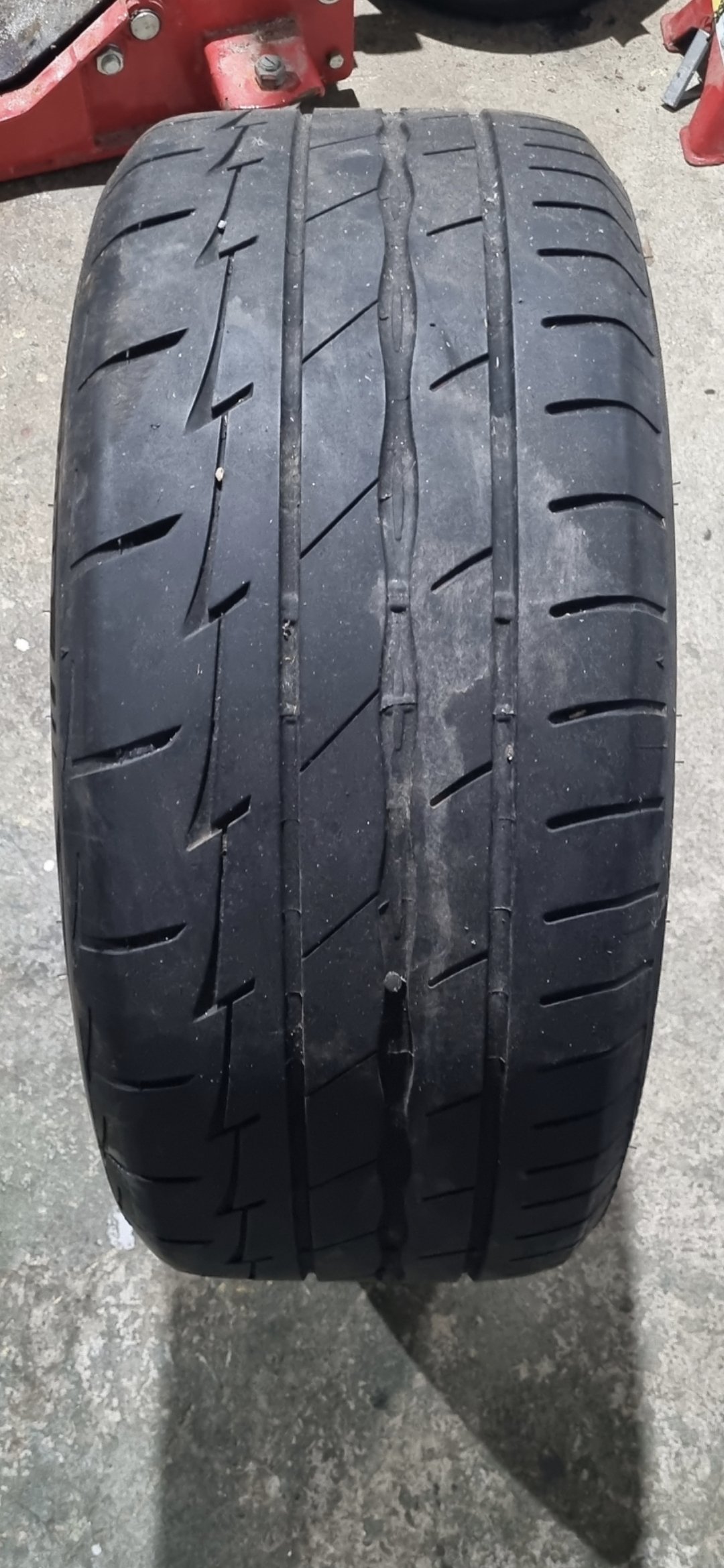

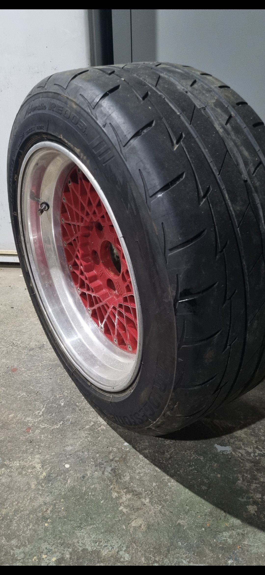

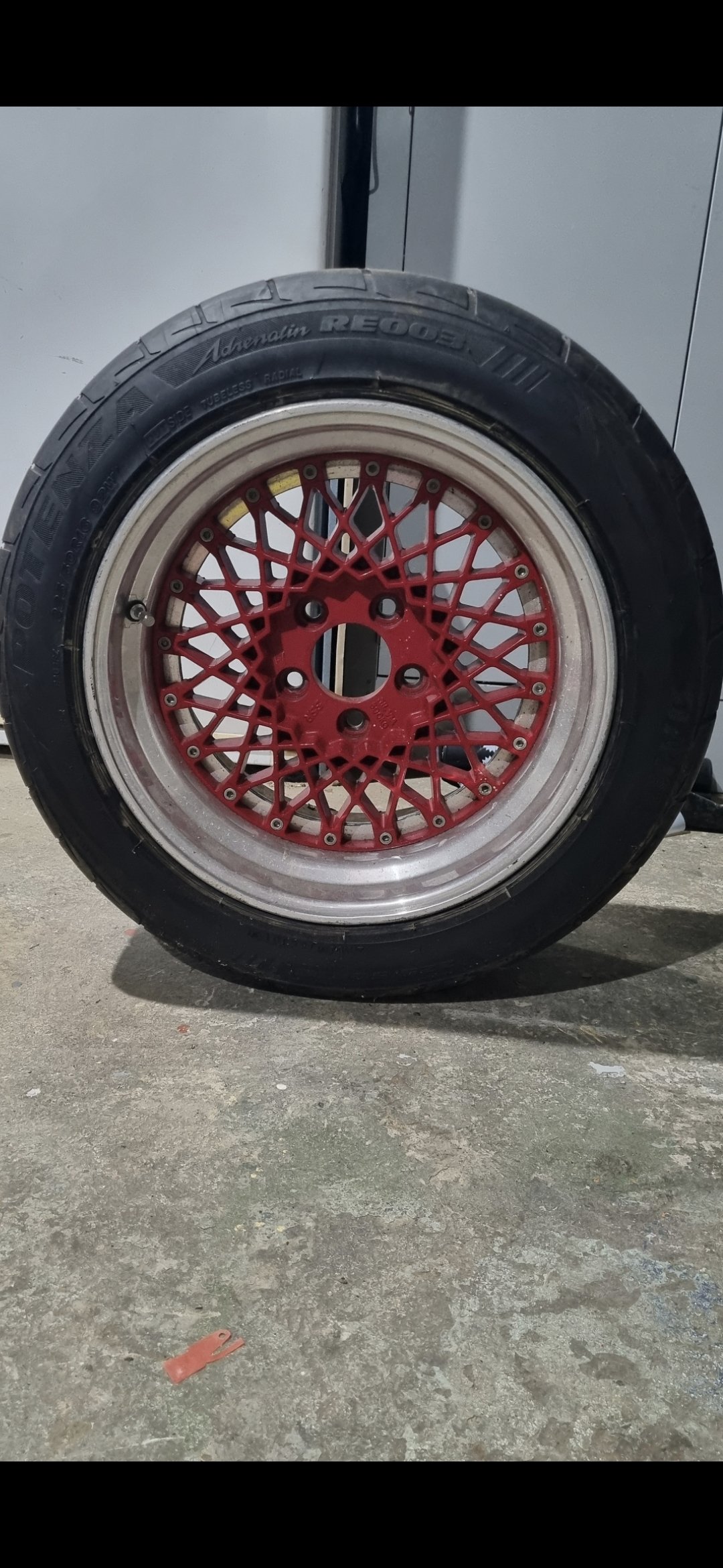

xsspeed Posted June 25 Posted June 25 I'll grab a Pic tonight, I put some that should be illegal on my 16x9s for test fit purposes only and I'd be keen to get your opinion @AllTorque based on that comment lol, they don't look suuuuuper stretched to me at all 1 Quote

Snoozin Posted June 25 Posted June 25 2 hours ago, AllTorque said: As a WOF guy I have seen stretched tyres that I thought would fail, but were ok according to the LVVTA tyre chart, so if they are outside of the tyre chart specs they must be obviously super stretched and you should fail. Bloody kids these days. Get off my lawn. 1981 Toyota Starlet KP61 4AGE (341)-Edit by Richard Opie, on Flickr I present to thee, a fine example of a super scary, gonna crash and kill a busload of nuns, 'stretched' tyre fitment. 3 1 Quote
AllTorque Posted June 25 Posted June 25 Thins angle shows the ‘stretch’ better. I suspect most wof inspectors wouldn’t think there was a problem there. 1 1 Quote
