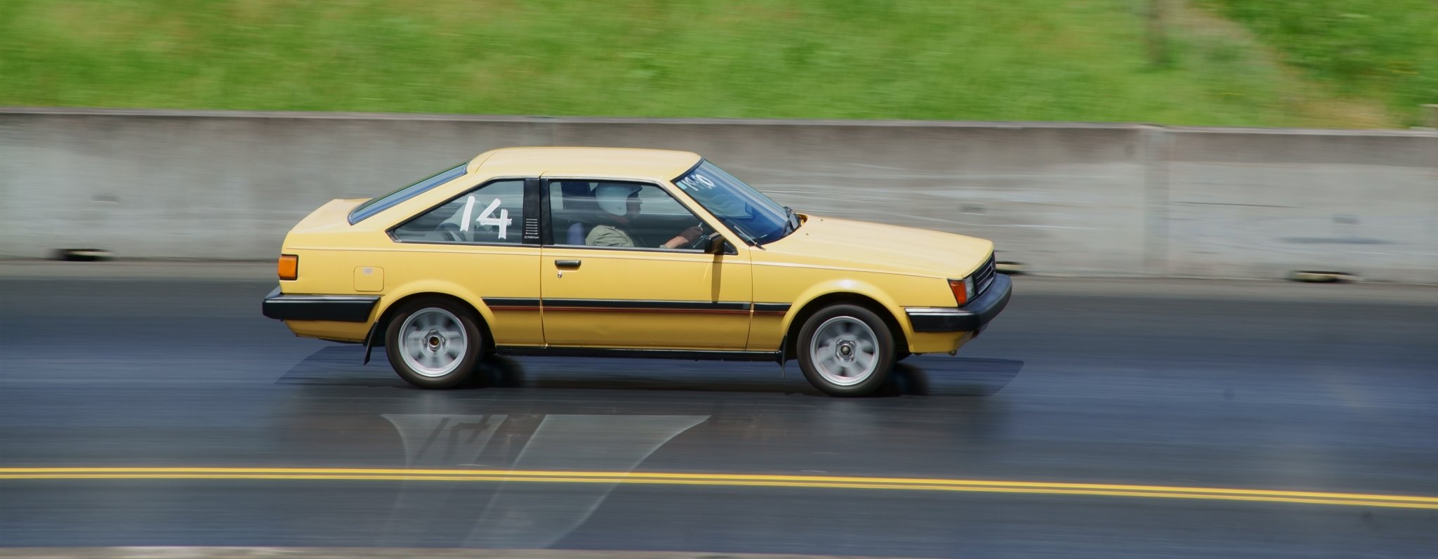

Roman Posted February 10, 2023 Posted February 10, 2023 Yeah I understand that sentiment. However one thing about that, is my car is a budget spec one that was pretty bottom of the barrel in terms of original features. Preserving it as a 3AU 4 speed car might sooth some purists but its not much fun to take on a track, or do the other things I want to with it. The interior in my car was quite shit, and after years of looking I gave up on trying to find nice parts. Until I bought a second car for parts to make this one nice - But then found that the spare parts car was way to nice to part out haha. So now my Dad owns it, and loves it. 3AU that fires up first pop, worlds smoothest T50 gearbox and everything's great. Has been driven in our family all the way from bottom of South Island to Cape Reinga. So this car stays as is. Sometimes I've pined for a factory AA63 model, but then... what would I actually do with it? As completely stock it would be a bit boring. Not keeping it stock, and eventually I'd want to scope creep it away from a 4AGE or whatever anyway. Here's a pic of Dads car at one of the oldschool drag events. Was awesome fun. 7

HumberSS Posted February 10, 2023 Posted February 10, 2023 True, the poverty spec ones certainly weren't worth preserving as stock, unless you had a minter like your dad's one. Cool build mate
