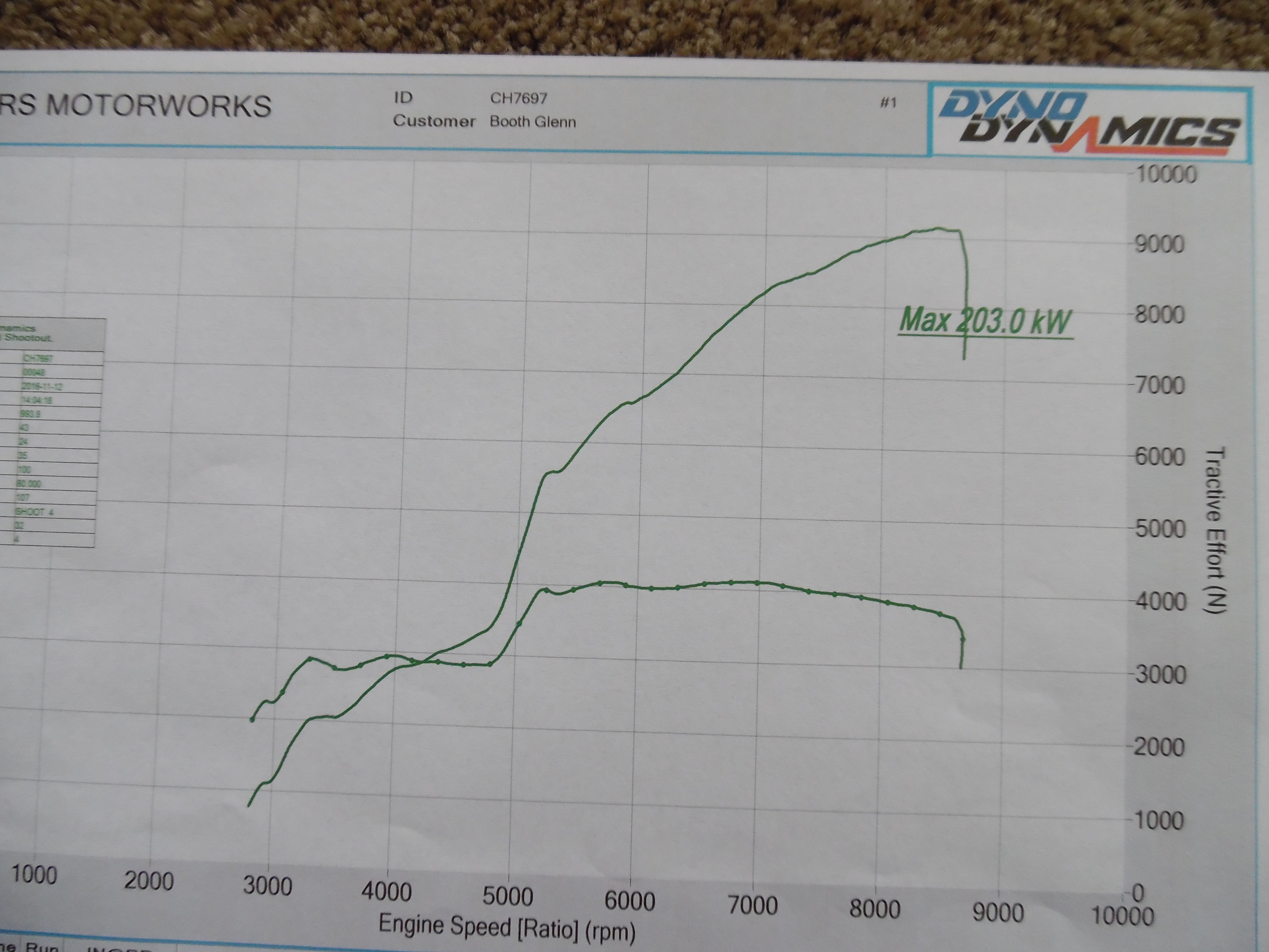

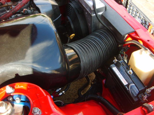

Celica RA45 Posted February 14, 2019 Posted February 14, 2019 this is my air box with 150mm dia intake and my curved ram tubes that are in my air box ..i also meant too show you my new dyno run here
Celica RA45 Posted February 14, 2019 Posted February 14, 2019 might be better pics of my curved ram tubes here 1

Roman Posted February 16, 2019 Posted February 16, 2019 On 14/02/2019 at 18:50, Celica RA45 said: this is my air box with 150mm dia intake and my curved ram tubes that are in my air box ..i also meant too show you my new dyno run here Thats some sweet power, love the airbox setup! Do you know how long your total intake length is, down to the valves? Also interesting that with an engine with totally different (everything) it still comes on power at around ~5300rpm.
