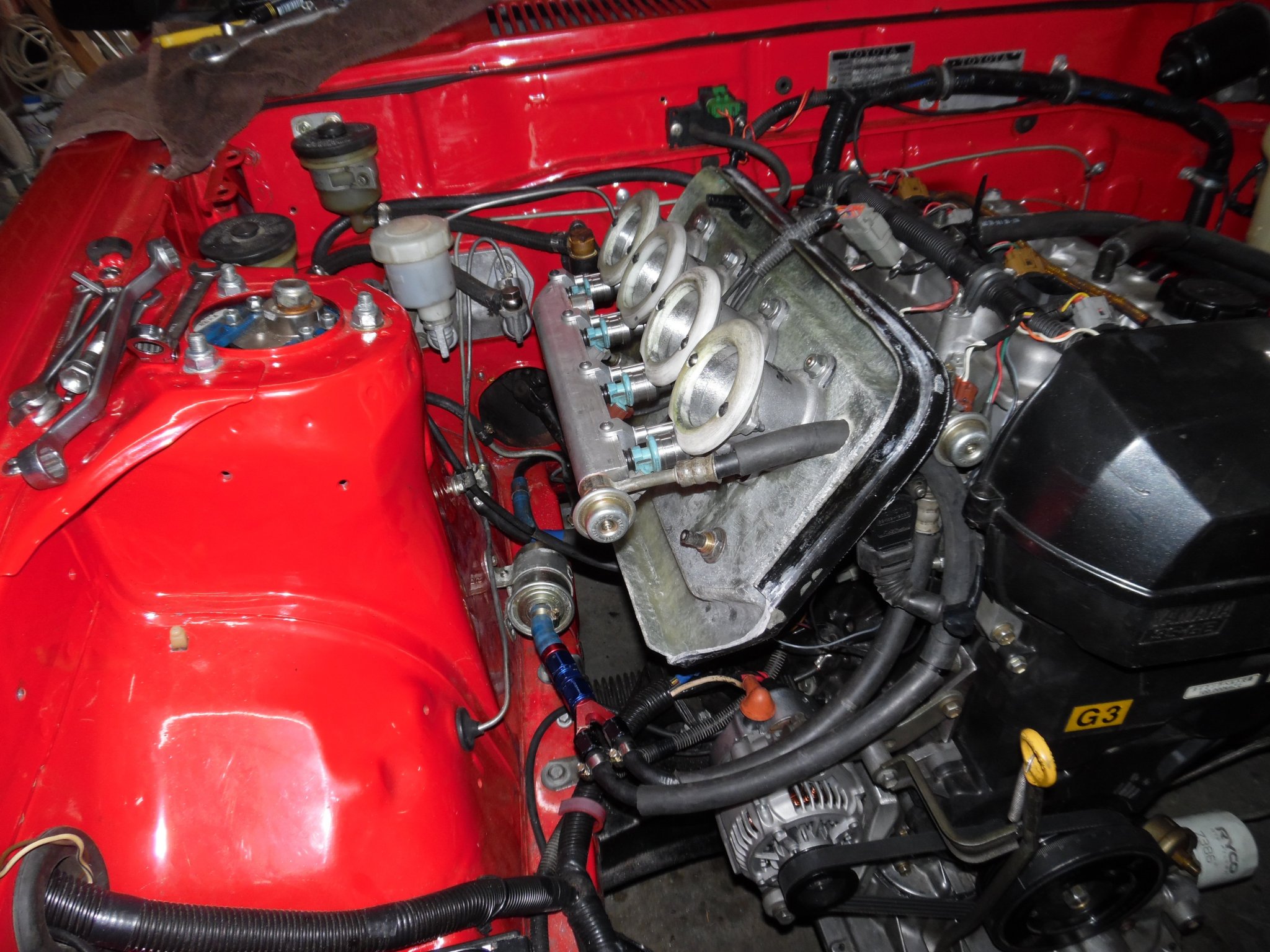

  5. in the pic you can see the map sensor hose and air temp
  6. its a pity you cant move them back another 230mm away from the std spot like this here
  7. you can cheat ,how many injectors are you using at the moment
  8. and iii will show pics
  9. and here these are fixed but gives you a idea
  10. have a look here
