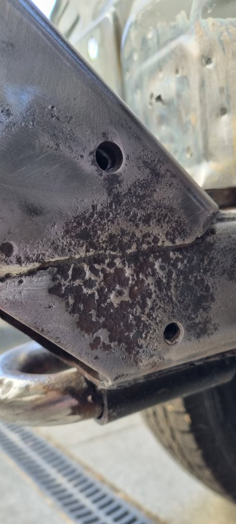

lowlancer Posted January 7, 2025 Posted January 7, 2025 Got some hearty as pitted rust going on with this chassis leg. Have tried grinding/sanding/evaporust/phosphoric soaking and this is as good as I seem to be able to get it. Short of cutting this portion out, is it even possible to neutralize this before painting? Spent a long time on this, keen to get some paint down. Quote
Nominal Posted January 7, 2025 Posted January 7, 2025 Wire brush on a grinder might get in there. 1 Quote
440bbm Posted January 7, 2025 Posted January 7, 2025 nominal called it. cup brush on ya grinder. Quote
lowlancer Posted January 7, 2025 Posted January 7, 2025 14 minutes ago, Nominal said: Wire brush on a grinder might get in there. Tried that, no joy. It seems to be rock hard, almost like weld splatter but inverted. Quote
Nominal Posted January 7, 2025 Posted January 7, 2025 OK, so sandblasting would probably work. I've tried picking at the rust with a scriber or something else sharp and hard. Or get the grinder out and cut/replace that piece. It looks the pitting is quite deep and might be weakening the rail. Another hack would be to zap up the pits with a mig then grind flat. 2 Quote
440bbm Posted January 7, 2025 Posted January 7, 2025 13 minutes ago, lowlancer said: Tried that, no joy. It seems to be rock hard, almost like weld splatter but inverted. steel wire not that soft goldy coloured shite? i had rust much worse than that on my container roof, in corten steel that was actually the full depth of the material thickness that the proper cup brushes stripped back. so you sir are unlucky if whatever you are using isnt good enough. like this. knotted cup brush. 3 Quote
lowlancer Posted January 7, 2025 Posted January 7, 2025 34 minutes ago, 440bbm said: steel wire not that soft goldy coloured shite? i had rust much worse than that on my container roof, in corten steel that was actually the full depth of the material thickness that the proper cup brushes stripped back. so you sir are unlucky if whatever you are using isnt good enough. like this. knotted cup brush. Ah I see - just needed the pic to understand. Will go grab one this arvo. Thanks team. 2 Quote
dmulally Posted January 7, 2025 Posted January 7, 2025 Is it worth filling that whole line with mig blob and grinding smooth? 1 Quote
lowlancer Posted January 7, 2025 Posted January 7, 2025 1 minute ago, dmulally said: Is it worth filling that whole line with mig blob and grinding smooth? Probably - will see how deep this goes after the above treatment. 1 Quote
440bbm Posted January 7, 2025 Posted January 7, 2025 48 minutes ago, lowlancer said: Ah I see - just needed the pic to understand. Will go grab one this arvo. Thanks team. all good. i'll be very surpised if it doesnt work. just be fucking carful to wear good PPE. they flick shit everywhere and espcially little wire bits into ya clothing. and hang the fuck onto it when youre gettin on it. they work so bloody good but will give ya arms/wrists a workout. Quote
440bbm Posted January 7, 2025 Posted January 7, 2025 take ya grinder in with you. but if its a standard 5" it will be m14 thread. 1 Quote
lowlancer Posted January 7, 2025 Posted January 7, 2025 3 minutes ago, 440bbm said: take ya grinder in with you. but if its a standard 5" it will be m14 thread. Sweet got three grinder so will surely fit one 1 Quote
