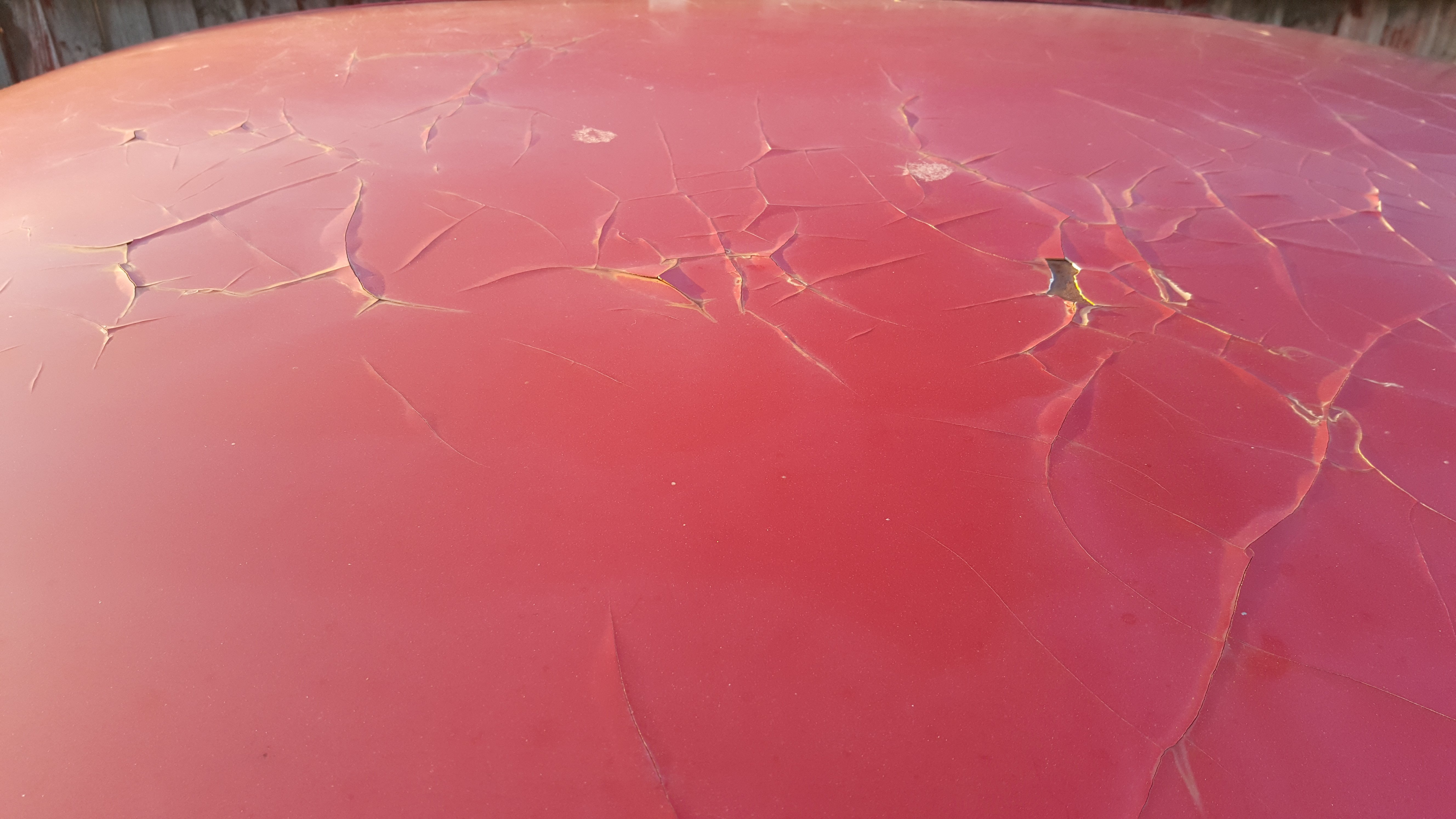

IvyMike Posted September 6, 2018 Posted September 6, 2018 So this is the roof of my daily. I bought the car about four years ago and the clear began to peel, slowly deteriorating into this state. Anyone know what could cause this? I know the car has had some crash work done at some point. I'm just wondering what corners were cut in order for this to happen. I'm about to tear into it this weekend but thought I'd ask because I haven't seen paint do this otherwise. Quote
IvyMike Posted September 7, 2018 Posted September 7, 2018 Probably bang on the money. The fact they went to such lengths makes me a little uneasy about what may lurk beneath. On 29/07/2018 at 11:59, kws said: I actually came here to ask about this. Has anyone used the Supercheap Lyndar paint matching thing? Keen to get a couple of spray cans of matched paint for the Mini, but its not your usual paint colour. https://www.youtube.com/watch?v=z2Jo5Fh2ZiY I've been watching this guy for a while, have learnt quite a bit from him. He just released this video on using aerosol based paints at home. There's a couple vids on prep preceding it. Might be worth checking out if you're game enough. I think he said the stuff SCA provided him with is Concept NO MIX as opposed to Lyndar but I'd imagine they're similar. I've only used Lyndar primer and found them to be overly thin at the prescribed mixing ratio. Quote
