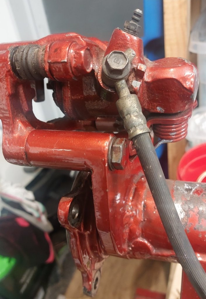

RXFORD Posted September 22 Share Posted September 22 Eww, cal brackets welded to cast/forged flanges. 1 Quote Link to comment Share on other sites More sharing options...
440bbm Posted September 22 Share Posted September 22 yeahh yuuuuk thats not good.. have you got any of your brake kits left @RXFORD for those Quote Link to comment Share on other sites More sharing options...
dabuzz Posted September 22 Author Share Posted September 22 Yup, not great, I can make do with them as they technically work, hopefully they'd pass again (?) - but ideally id like to cut them off and get proper bolt on brackets for the P11 calipers, I've done a bit of a search but most brackets seem to be for U13 Nissan, not the P11. Quote Link to comment Share on other sites More sharing options...
tortron Posted September 22 Share Posted September 22 4 minutes ago, dabuzz said: I've done a bit of a search but most brackets seem to be for U13 Nissan, not the P11. What brackets do you need? I have a few from my Nissan brake investigations Quote Link to comment Share on other sites More sharing options...
dabuzz Posted September 22 Author Share Posted September 22 31 minutes ago, tortron said: What brackets do you need? I have a few from my Nissan brake investigations P11 Primera to Hilux Quote Link to comment Share on other sites More sharing options...
dabuzz Posted September 22 Author Share Posted September 22 Unless someone has some U13 calipers for sale, and then I can get brackets easily, and ill redo the handbrake cables while I'm at it as I'm not overly happy with those either Quote Link to comment Share on other sites More sharing options...

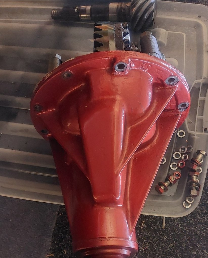

dabuzz Posted September 22 Author Share Posted September 22 Also, regarding diff, can get a 5.1 Hiace open head which I could possibly swap my LSD centre into, but head is a different shape to my hilux, is this just an early Vs late thing? I assume it should just all swap in ok? Quote Link to comment Share on other sites More sharing options...
RXFORD Posted September 23 Share Posted September 23 The carrier differences are to do with the pinion locations being slightly different, but other than that, I don't believe there are any other differences. The flange pattern to housing will be same, spline count will be same. Open vs Lsd sometimes have difference axles, you will need to measure the spline engagement. There are 2, maybe 3 different pinion flange bolt pattern aswell, so you will need to check that, or may be able to swap your orig flange onto the 4.8 pinion. Pm me some pics of the Calipers you have with a centre-centre measurment of the mounting bolts. I may have a cad file for those brackets. 1 Quote Link to comment Share on other sites More sharing options...
Tiger Tamer Posted September 23 Share Posted September 23 If you are getting new rear flexible brake lines made up you can get Banjo fittings exit is angled up instead of being straight out like in your pic. Might help in that situation. 1 Quote Link to comment Share on other sites More sharing options...
dabuzz Posted September 23 Author Share Posted September 23 I'll def look into that, thanks, just need to confirm cert wise whether I can use the existing caliper bracket or not first Quote Link to comment Share on other sites More sharing options...

cletus Posted September 24 Share Posted September 24 it can get murky. in an ideal world= the car is certed for a, b and c mods the cert is done properly the first time now has d and e mods added a certifier only has to assess the new mods, the others are covered by the previous cert. you get a new cert and carry on with life however, especially with the new photo based system, this is often not that easy, and a large can of worms can be opened, often a recert can turn into a fucking nightmare due to previous certs being done poorly, things being missed the first time, the old plates not being big enough to fit everything on, the expectation of what should be certified on a car changing over time, people adding or changing stuff that fits within the limited description that fits on a old style tag and even just trying to figure out what was acceptable at the time when it was first certed. this all takes time, emailing back and forth with lvvta etc it always takes me longer to do than just starting a new cert on a freshly modified car for example, the welded caliper brackets on @dabuzz car, if i was re doing the cert, normally that would be a no go, cant do that, but it already has a cert for disc brakes on the rear,so i can just write down "previously certified" however i dont know if the previous certifier went to lvvta to get an exemption because it was already done or did he not notice at all or did he notice and choose to ignore it or has someone changed it since it was certed so ive got to take a photo of that mod for the new cert, and say yep thats good, its on the cert with my name on it, so everyone that looks up that cert from here on, sees that i did the cert so to cover my arse, id have to go to lvvta and explain the situation, and get the OK from them, this might take a while because they would likely recall the paperwork and see what it says it might say that there was a NDT for the weld and it was welded with a low carbon rod to a cast steel bearing housing and there was a exemption given at the time, in which case it is ok or it might just have a tick in a box next to 'car has brakes' in my opinion if you are changing the calipers or are unhappy with it, just cut all that shit off and make a bracket that bolts on to the ends with the calipers you want 6 3 Quote Link to comment Share on other sites More sharing options...
