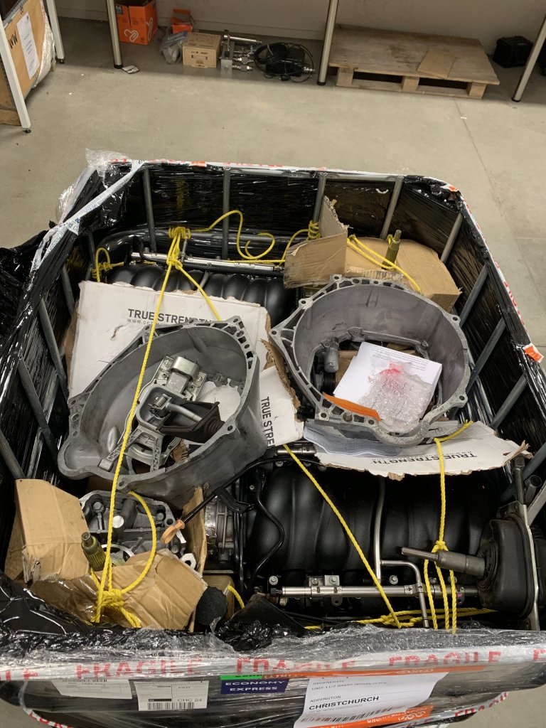

Popular Post spanners Posted June 15, 2019 Author Popular Post Posted June 15, 2019 Finally, engines have arrived! 25 Quote

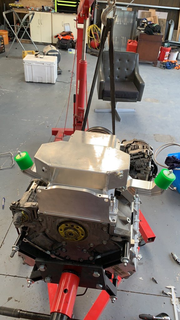

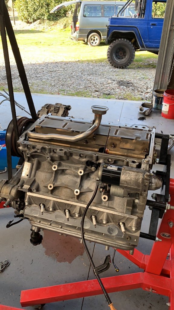

spanners Posted June 29, 2019 Author Posted June 29, 2019 What were you driving? Cheers for the pic! Sorry for driving like a 15yo. Me and a mate swapped cars for a bit and I broke his 500+hp evo! Crank pulley exploded and let the belts go. Overheated it. Considering it’s a 2.4 stroker that’s quite new I really hope I didn’t kill it. Slapping engine together at the moment for the TYRBBQ. So far it’s been a bit of a cluster but nothing too major. The oil pickup tube fouled the plate that sits under the crank, so the die grinder sorted that out. Frustrated that the fucking pickup tube hits the sump though so will need to be modified. I bought them all off the shelf from Sikky and I would expect it to just work! Also the engine guy wrecked the water jacket bung by cross threading it. What a munter, I’m gonna have to go and find an m28x1 tap to clean it up. Got really hammered last night so progress is slow. 8 Quote

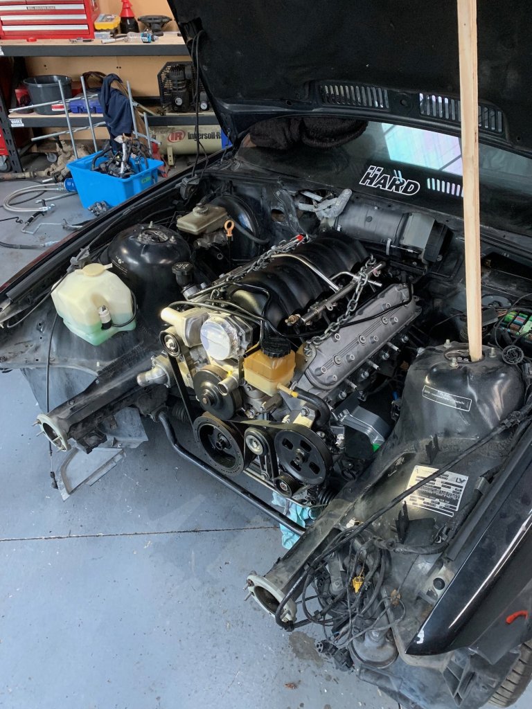

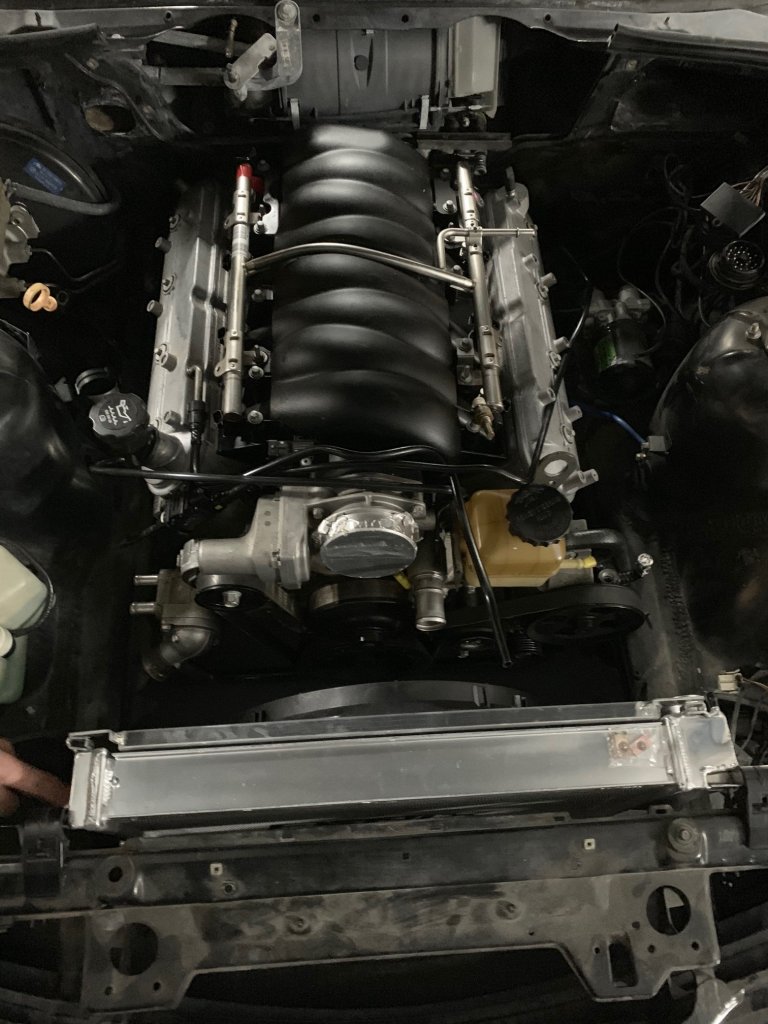

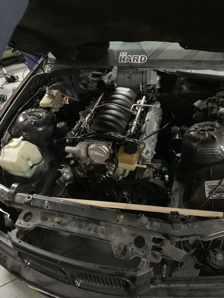

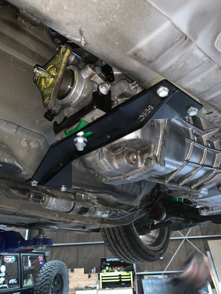

Popular Post spanners Posted July 6, 2019 Author Popular Post Posted July 6, 2019 On 04/07/2019 at 21:13, BlownCorona said: so thats why that thing was so fucking fast..... Yeah it’s mental. At the top of fourth it finally gets its legs and snaps your head back in the seat! It’s a weird sensation when something pulls harder and harder through the gears. Especially considering it’s got fuck all lag. Anyway today was a good day! Engine and box are sitting in the car and fit well. Gearbox mount is for a T56 but fits close enough. Will space it up so gbox sits a lot higher. Shifter will be a bit of a dick so I’m going to have to fagricate up a shorter mount and linkage. I think standard position sits about 5” back from the current hole. I was tempted to move the hole but then have to ruin trim and move my hydro and handbrake back and I want the interior to look pretty standard. best thing is the huge amount of room available at the front! I have a Fenix M3 radiator coming for the gap, straight bolt in... and that should provide heaps of cooling. It’s what all the USA people are using (M3, not Fenix) with no trouble. I’m not keeping AC and theres a big daddy oil cooler to compliment it. Still weighing up an oil thermostat but almost think the added complexity isn’t worth it. Headers on drivers side are going to be a real cuntflap. Writing this in the bath, hoping I don’t drop the phone. Too many diesels! Nek steps are to make new steering shaft, move ABS pump or delete it, get driveshaft made, and send loom off to the pros. I’d really like to sneak this up to Raglan but it’s not old and won’t be finished! Wish I still had an E30 10 Quote

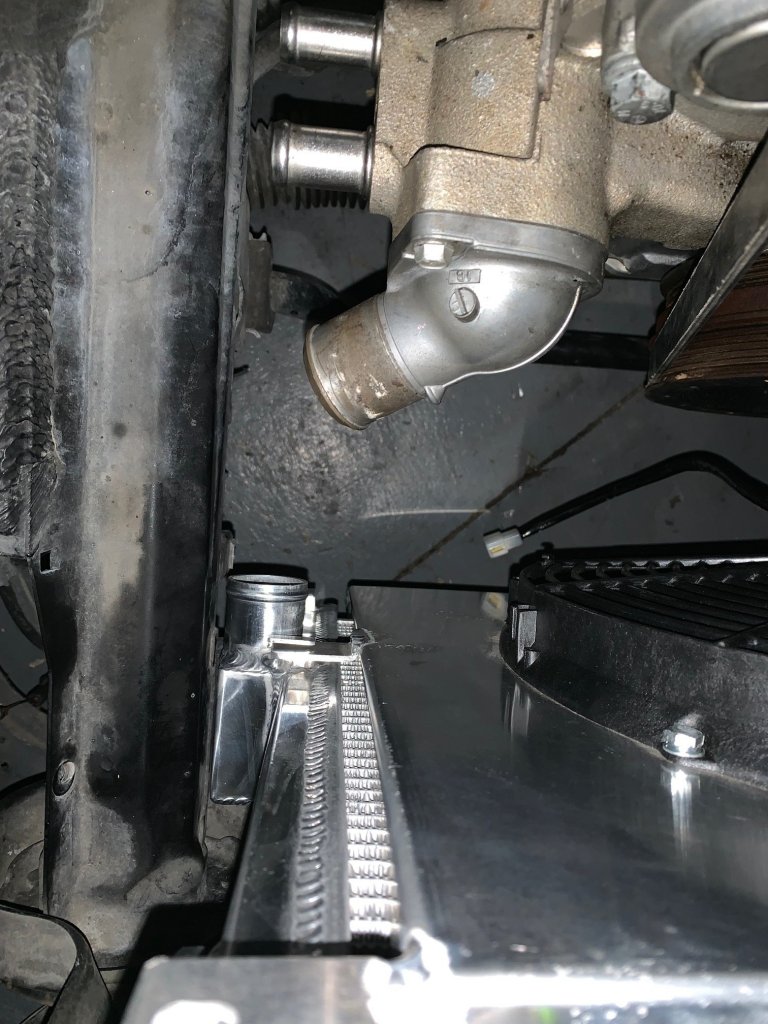

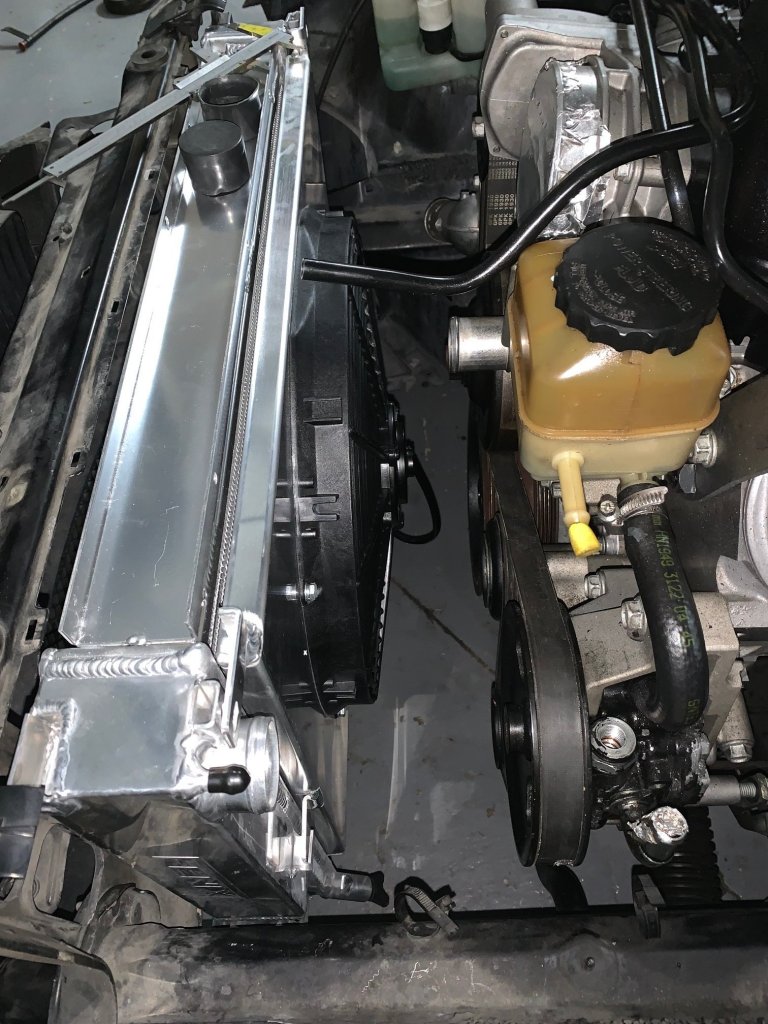

spanners Posted July 18, 2019 Author Posted July 18, 2019 Got my high quality Fenix radiator and shroud today. I suspect they’ve never test fit one into a car but I can make it work. Didn’t come with a filler neck / cap which is a bit gay cos I need to weld one into the end tank. Looks good tho 6 Quote

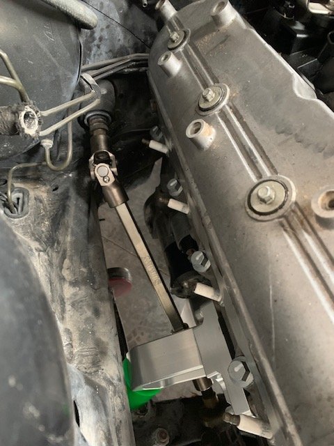

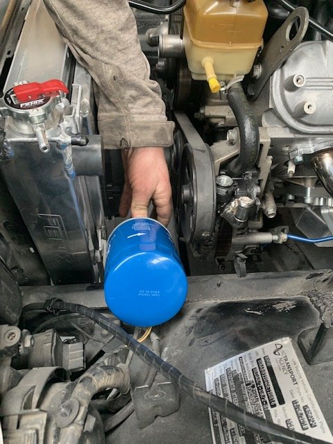

spanners Posted October 6, 2019 Author Posted October 6, 2019 Got underway with the exhaust. Off the shelf headers fit mint on passenger side. Sadly drivers side isn’t so easy! I have an aftermarket steering shaft which makes more room, but still gonna be a cunt. Passengers Drivers Anyone got an opinion on mounting an oil filter upwards? Trying to keep it super accessible while not scraping the ground. Is the oil pouring out at oil change time going to ruin my life? Was thinking about here. Otherwise I can flip it upside down. Also fine to run on an angle? I chucked on e46 330i front discs and calipers for a bit more meat in the anchor department, and matched it with e46 328i rears. Thankfully my hawk pads fit the rear calipers but I’ll have to buy new ones for bigger front stoppers. Will probably end up buying slotted discs too for 100% wank factor. Is a bit sad to sell my other slotted discs after only a couple of thousand ks but I guess with the extra horses I’m gonna need the best brakes I can afford. Obligatory hoist shot. Fuck I can’t wait to detail this car, it’s looking pretty rough at the moment. Also I noticed my vert tyres were bald so I bought some 19s off a commodore. Never had a wheel that big before, actually drives better than before (I think the less offset means correct scrub radius cos it’s much less twitchy). Send flaming about hideous wheel choice to ialreadyknow@hotmale.cunt Vert is actually for sale now which makes me sad, but building a big shed so need to stop throwing $$ at too many cars! Also have to give the moto a bday which will cost a few bucks. About to chuck motard wheels on for summer, keen to do some wheelies. 6 Quote
