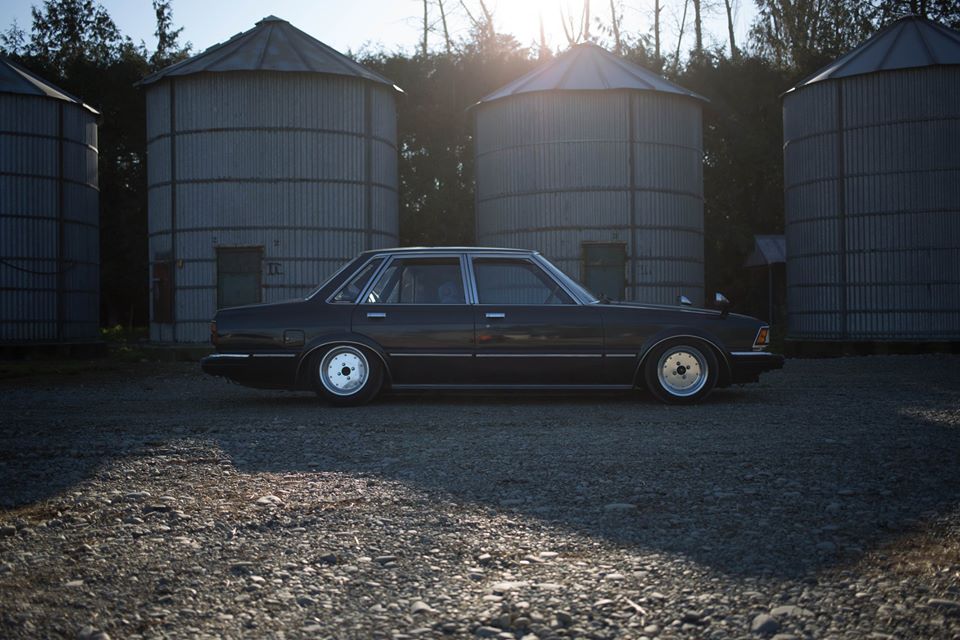

Time To Upgrade So It failed its next WOF on the front shocks ad ball joints, which I knew was coming. So it was time to start spending some cash money, and finally get the thing low. I will keep all the old parts so if for some odd reason i want it stock height again it can be returned simply. dspec_tt131 from here posted he was parting out his GX61. So I jumped on his modified S13 BC gold struts, to cut out the hassle of building my own. They also came with some RCA's. These have since also been crack tested and are ready for cert. I also managed to get a brand new pair of MX73 BC gold rear struts and springs. dspec_tt131 GX61 I have also pulled apart the front suspension and tidied it up. Replacing ball joints, tie rods, sway-bar links, and bushes. The wheel arches also got hit with some CRC Proseal. Two months till Toyota Fest….. It’s going to be close. -

Toyota Fest 2016 I was getting fond of the stock look. Deep Down I wanted it to be Low and on some Wide 14s. But I couldn’t force myself to commit just yet. I planned to drive it to Cromwell for Toyota Fest in March 2016. A week out when I was cleaning it I realised my WOF had just run out. Took it in and bingo failed on rear struts. Managed to get these two days before leaving and got the WOF the next day. This would be it first "big drive" since the cambelt incident, so was hoping everything would run smothly. It loved to drink the fuel however and it didn’t like going over the Lindis Pass. Think it slowed down to 40km/h at one point. Had to let all the angry people in their big SUVs past once I reached the top. Anyway Toyota Fest was a success even got to throw it round 2 laps of Highlands to show its killer body roll. Goal is to get it ready For Toyota Fest March 2018 at Cromwell again. -
