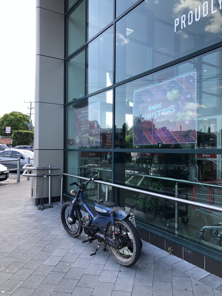

Vintage Grumble Posted December 16, 2018 Author Share Posted December 16, 2018 So J5 sent me a link to an old Cub, and for reasons unbeknown to myself, I purchased it. I collected it today, turns out it's a C90, and @Raizer mentioned it's a deluxe. I have no idea what year it is (would quite like to know out of interest if anyone knows how to tell?) I don't really have any plans, mebbe slap another motor in it, powder coat the wheels and leave the rest ratty? It was last registered in 88, so would assume the plate is no longer in the system, and it's old enough not to have a VIN number, so I wonder if it could be registered as a classic scooter? 7 1 Quote Link to comment Share on other sites More sharing options...
Raizer Posted December 16, 2018 Share Posted December 16, 2018 That is a sweet C50 Deluxe! Was keen as on it myself lol 1 Quote Link to comment Share on other sites More sharing options...

GuyWithAviators Posted December 16, 2018 Share Posted December 16, 2018 9 minutes ago, Vintage Grumble said: Ha, strangely enough the engine number is very close to what I can see of the frame number. Guess I'll clean the rust up as best I can, and see what I can see. I guess re-registering it would be the logical first step in the project. Hopefully they don't let it go through, and then send me a letter demanding I de-register it, like they did with the GT50. Mind you, C50s should be in the NZ system as scooters. Nice score on this. I saw the advert and was tempted but I don’t need 2. I’m just about finished building this one, same as yours; C90 Deluxe. With the form filled out correctly and some stickers it became a C50 Deluxe. They’re exactly the same frame after all, and I’ve repowered this with a 49cc* Lifan. With slightly different to stock gearing it’ll pull me up to 95kph. You’ll enjoy this project. 5 1 Quote Link to comment Share on other sites More sharing options...
Vintage Grumble Posted December 16, 2018 Author Share Posted December 16, 2018 Excellent. May I ask where you got the stickers? @GuyWithAviators Quote Link to comment Share on other sites More sharing options...
GuyWithAviators Posted December 16, 2018 Share Posted December 16, 2018 Those are actually Honda 50 Magnets that @mo999 got made for his one and sent a spare set to me. Just slapped over top for now. I will eventually yarn to @Archetype about some real stickers that match the age of the bike. 2 Quote Link to comment Share on other sites More sharing options...
